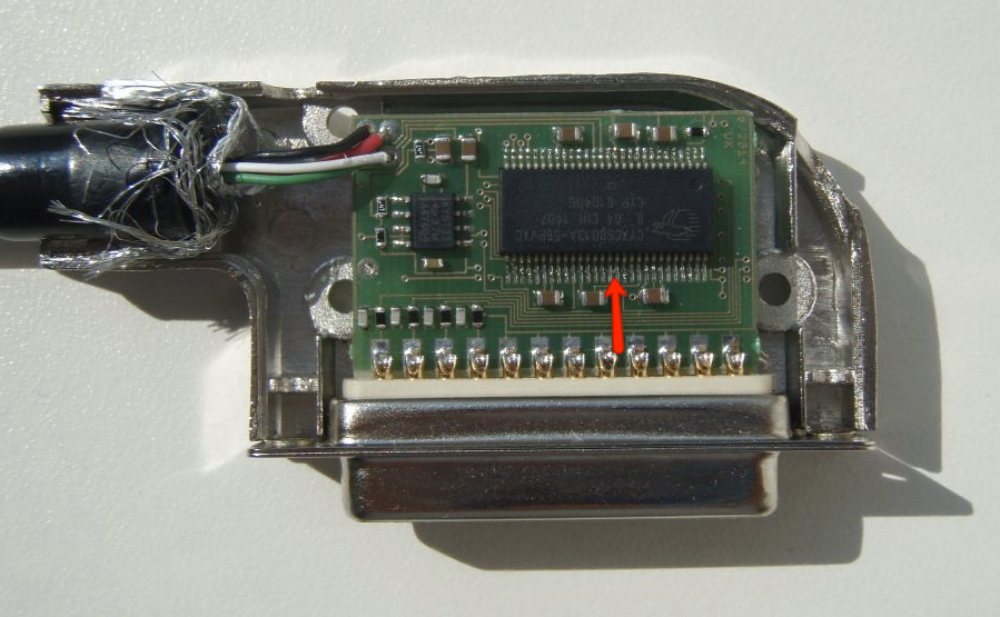

Udo,
Beautiful work so far! 🙂
Not being critical at all, but when I was looking at the pics of your board I noticed what *might* be a solder bridge. I figured I'd post you a pic of what I noticed just in case you happen to find something not working as planned when testing.
Again, AWESOME job!
Again, AWESOME job!
