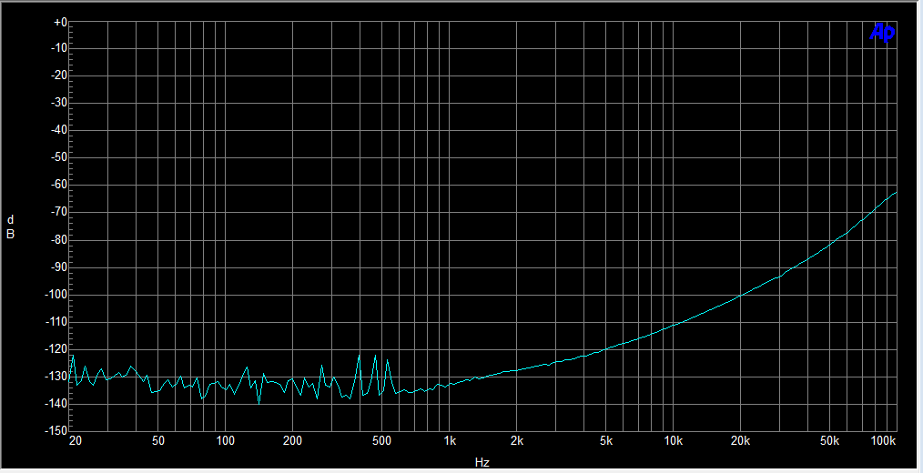

Modified the regualtor and this is the results I get.
It seems the noise is approaching the limit of my test setup. High frequency the regulator could be doing better. I will look into that tomorrow.
Look at OLG curves. At 100 kHz, AD825 & AD817 have about 60 dB (for 30V supply). OPA187 has 15 dB.High frequency the regulator could be doing better.
you are correct. I have had many stability issue with opamps with larger OLG at higher frequency. Apparently, adding a 120-200uF cap at the output is mandatory for stability.
AD825 (JFET) has 45dB OLG at 100KHz (similar to OPA140 I ordered and will try today)
While the AD817 sports a whopping 60dB but the phase rapidly decreases just right around unity gain so I can see it very prone to oscillation

Very frustrating night, I cannot get stability with any opamp with decent OLG at high frequency only with OPA187. It must be something with my layout for sure. I thought I had studied carefully GND strategy, apparently not enough.
Below is the captured noise floor of the regulator and next to it the input. Given I have not the ability to change layout right at this point, I can work around using OPA187 and trade off some high frequency noise rejection.

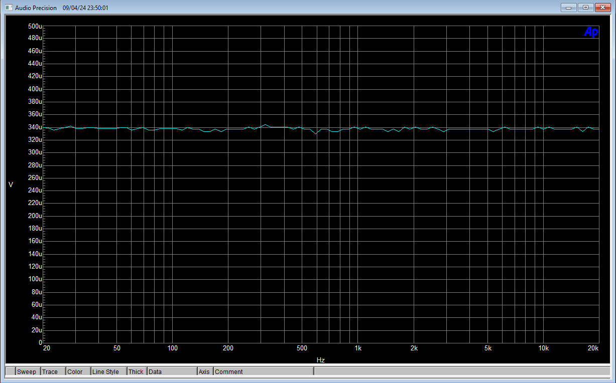

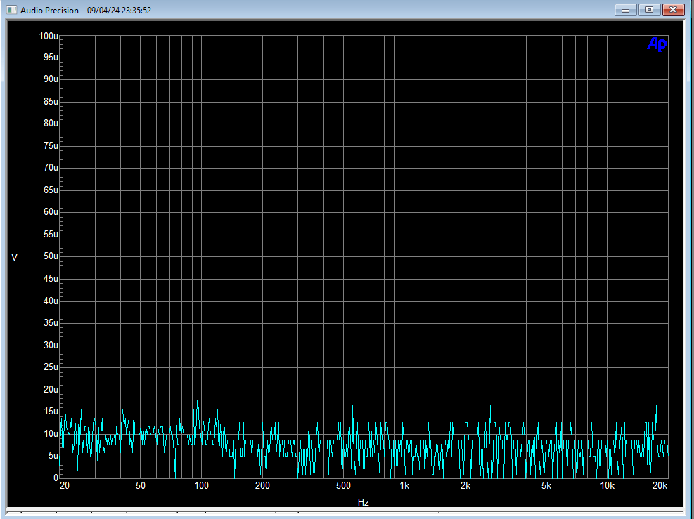

When you graph noise, assuming you have the DSP analyzer, you should use the AP Macro "FFT Scaling for Noise". This will yield noise per root hertz.
If you are using Analog Analyzer, Sweep use the Bandpass Function ... download the data into Excel, divide by the square root of frequency and the bandpass filter factor -- this will also give you voltage noise per root Hertz. The two methods give similar results.

Yes, I have the 2522A so it has DSP. I will use the FFT Scaling Feature and replot this."It oscillates, now what?"

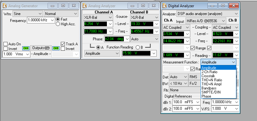

I can't see the scaling feature, how do I enable it?
maybe you are referring to a pre-built test. Let me look in the folder for this particular test.
Found the macro, but it is unfortunately for the AP2700 I am running AP2.24. If I want to run AP2700 I need to buy the USB interface. Given I have just bought this AP plus the Interface and also the omicron Line Injector, I would like to work around with AP2.24, at least for now, then maybe later on I can get the AP USB interface since I have the 2522, but I also would like to get SYS-2722 ahahaha,"It oscillates, now what?"

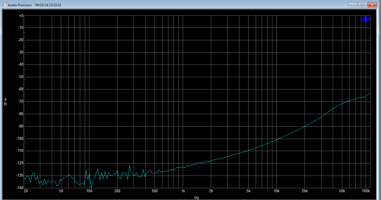

OPA180 stable Rejection improved up to 20Khz below graph using DSP analyzer
. Below analysis up to 100KHz with the analog analyzer I did not expect the OPA180 to rise given it has higher OLG at 100KHz. However, in the audio band it has higher rejection.
