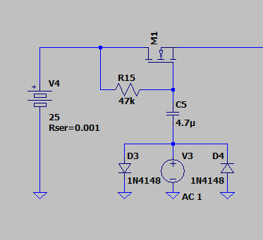

I will use IRF610 since I have it on hand I will compensate with the PSU in for the loss on the Mosfet.

There is a way of using a gate driver IC to create the Vgs on the MOSFET. Otherwise you lose that voltage across the MOSFET. Choose a MOSFET with low-ish Vgs(th)

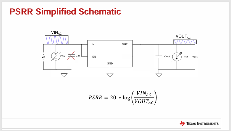

Best practice during test is to remove input capacitor, if regulator is stable without and expected PSRR doesn’t rely on that capacitor. If not, then to try with smallest capacitor that provides stable operation.

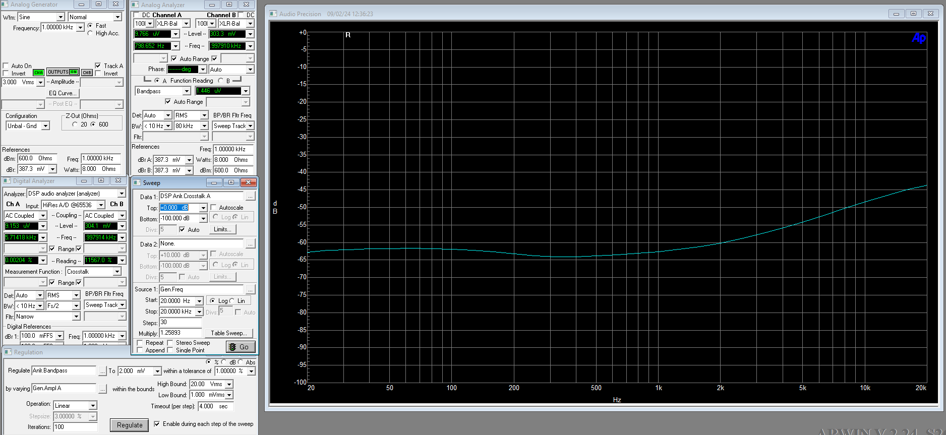

Last measurement of the night as it's past midnight. As I am measuring the LM7815 to baseline my measurements, I obtain this ugly plot

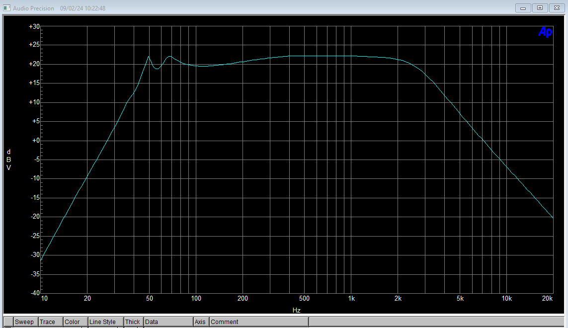

Long story short, as I am debugging these results, I find out that the response of the amplifier is very NOT linear at all which is affecting dramatically the results.

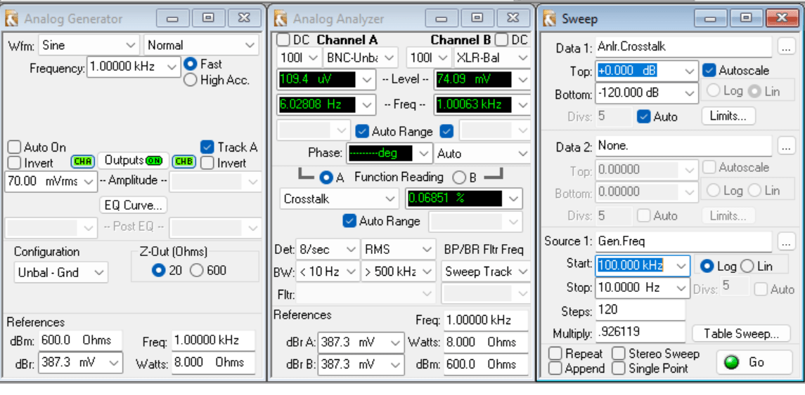

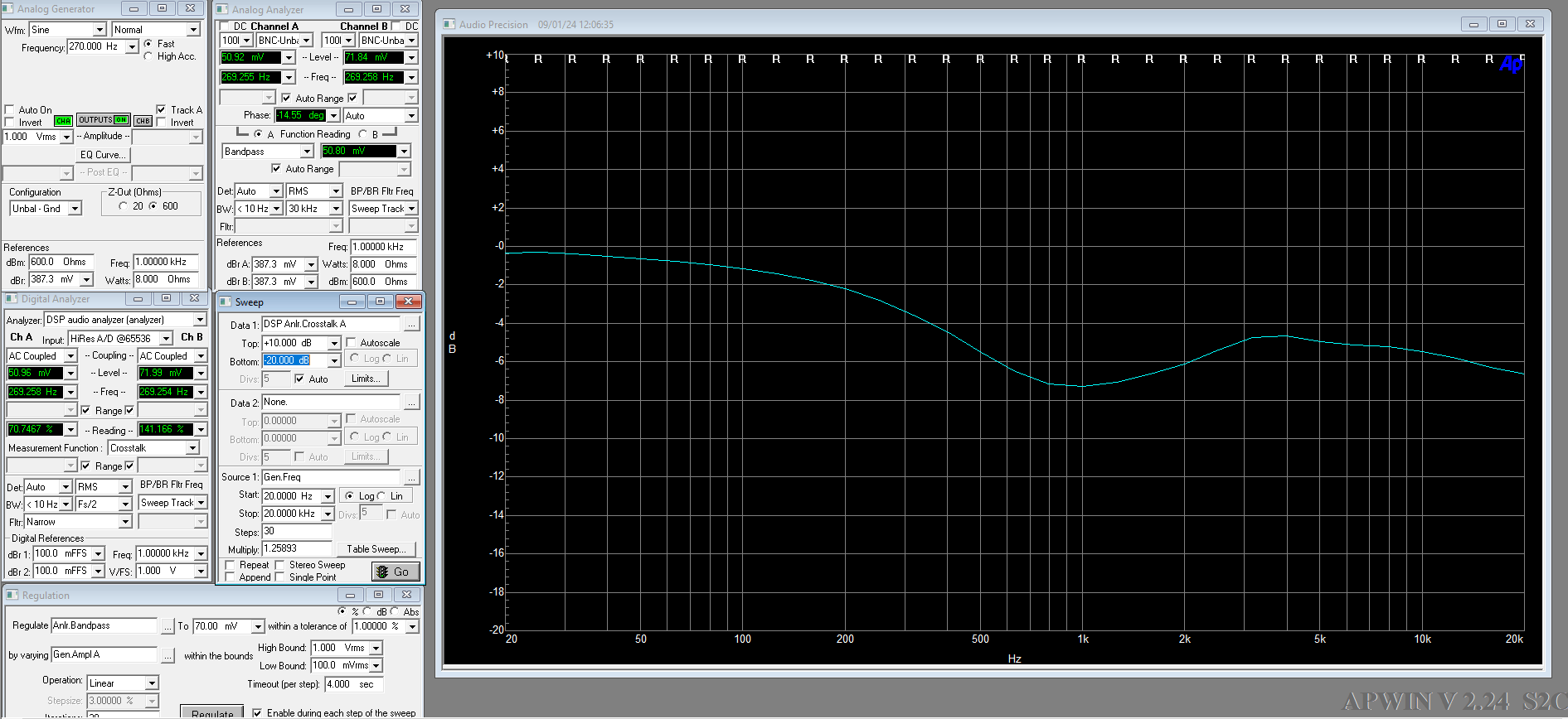

Look at the many 'R' characters at the top of the graph.
That indicates that the regulation has not been completed for that step.
(A 'T' would indicate a time-out).

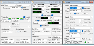

It seems there is a problem with the test setup.
Is that sweep setting for Data1 correct?

Texas Instruments suggests eliminating the electrolytics in front of the regulator if you want to see the DUT doing its thing.I tried the circuit but unfortunately it doesn't work. I am assuming the high output impedance of this stage makes it unsuitable to drive the low impedance supply rails of the regulator which has several electrolytics.

Thanks for the input. Now I do understand what R and T means. It cannot regulate because the retarded amp I picked up at goodwill has two outputs for low and high and the response of the amp on the lows is this thus the reason it cannot regulate.

I tried with the mosfet injection and while the closed loop system can regulate, there is self-oscillation that is skewing measurements. BTW I will go return the "amp" at goodwill as it is only taking space ahahahLook at the many 'R' characters at the top of the graph.

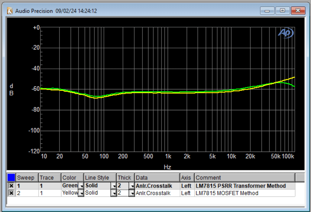

thanks for the info, I have added 2.2uF at the output of the regulator for stability I go with the regulation feature (only one point it couldn't regulate within 1% but the graph matches yours very closely. Thank you again. I use the DSP simply because I can set the bandpass for more accurate reading I can see it is not necessary.

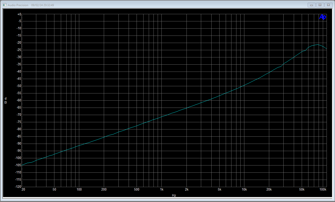

Finally, I was able to measure of the Jung Regulator on board with the electrolytic removed, I need to figure out why I have worse performance with the electrolytics connected.

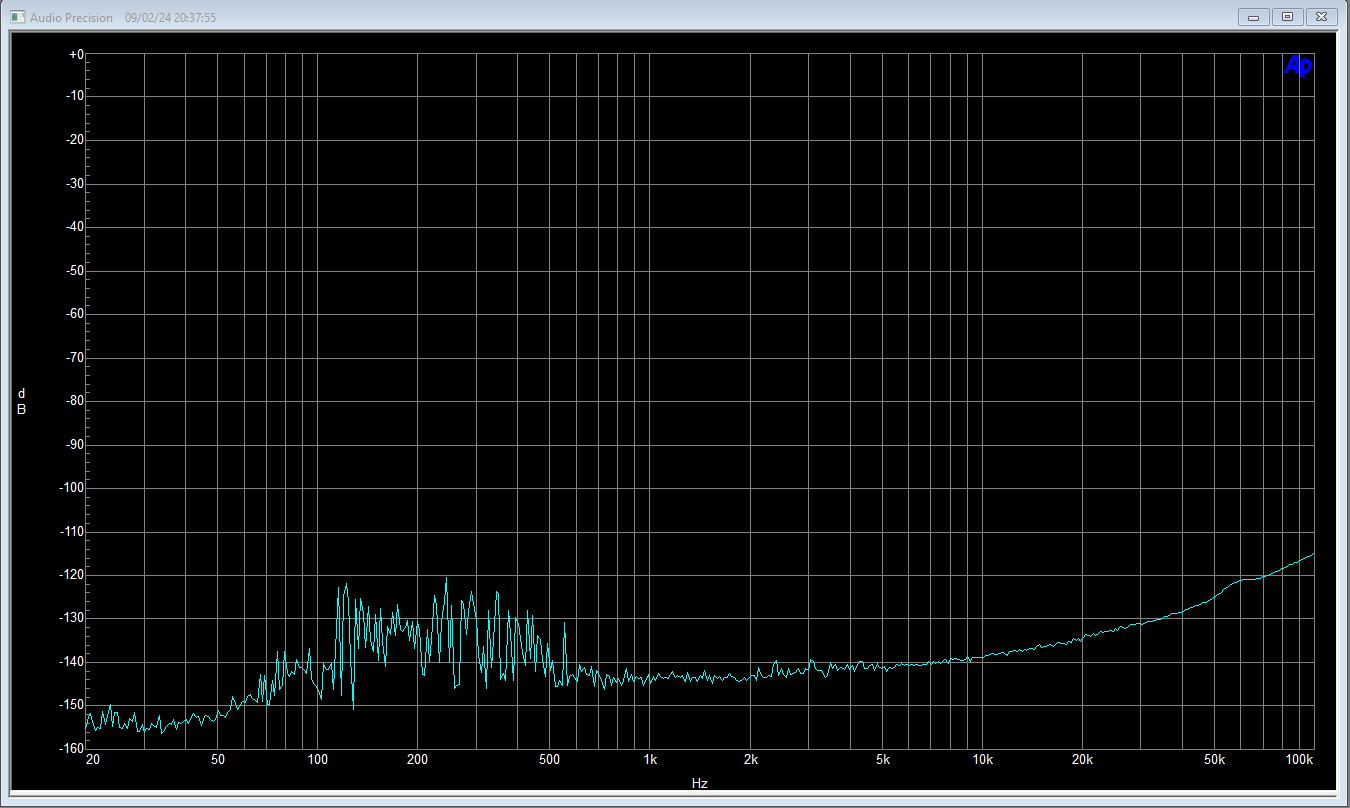

This is the noise floor of the setup I am having, which seems pretty adequate to measure the regulator.
