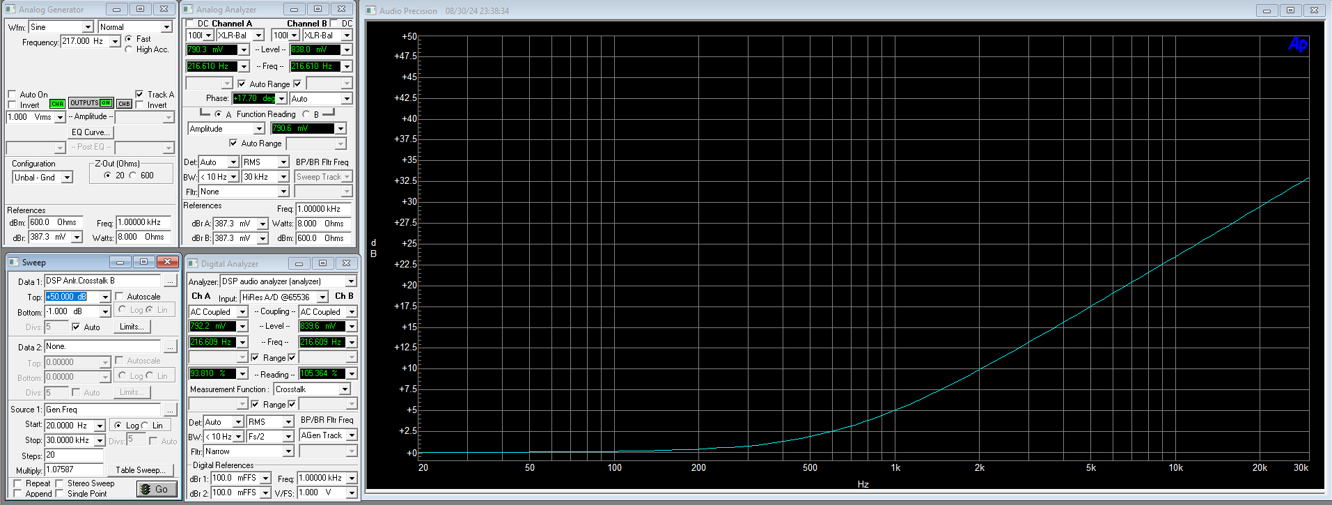

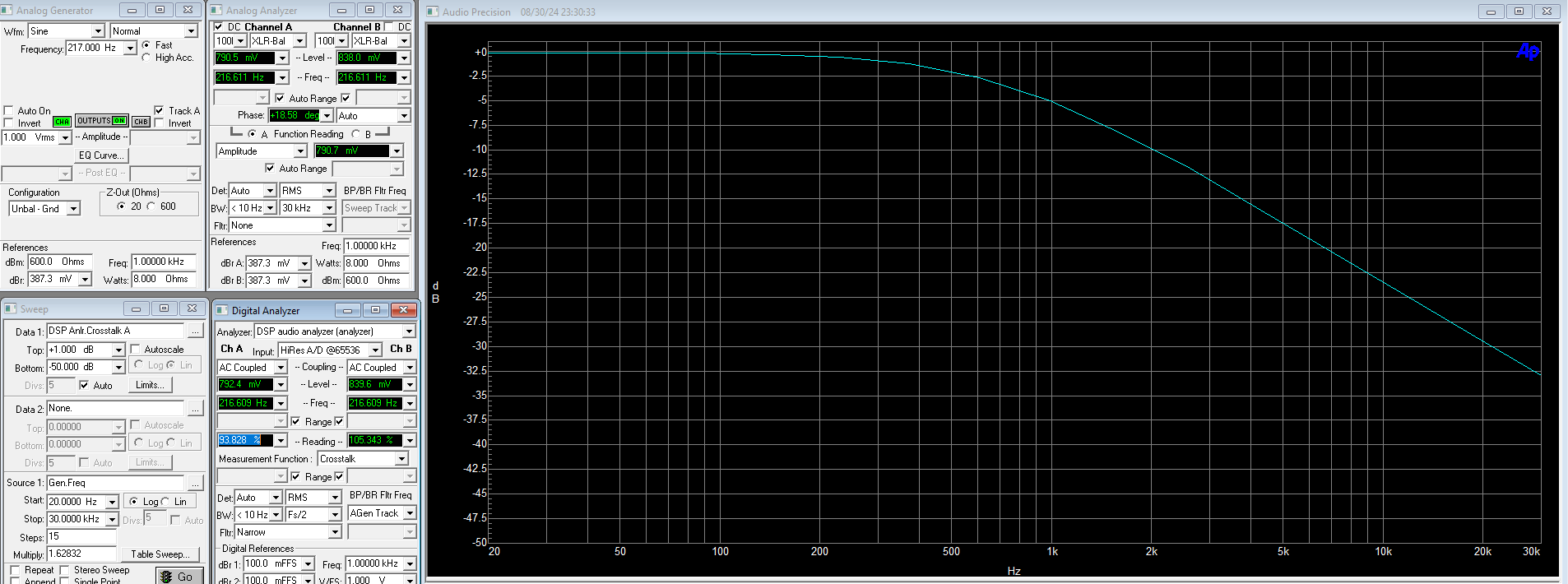

As I am trying to figure out how to measure the PSRR on the unit I am developing for the regulators I am using for the power supply, I am testing how to setup the body plot of the a given trasnfer function, so fort the case I have setup a low pass filter and when I go and plot I get this nice wavefor:

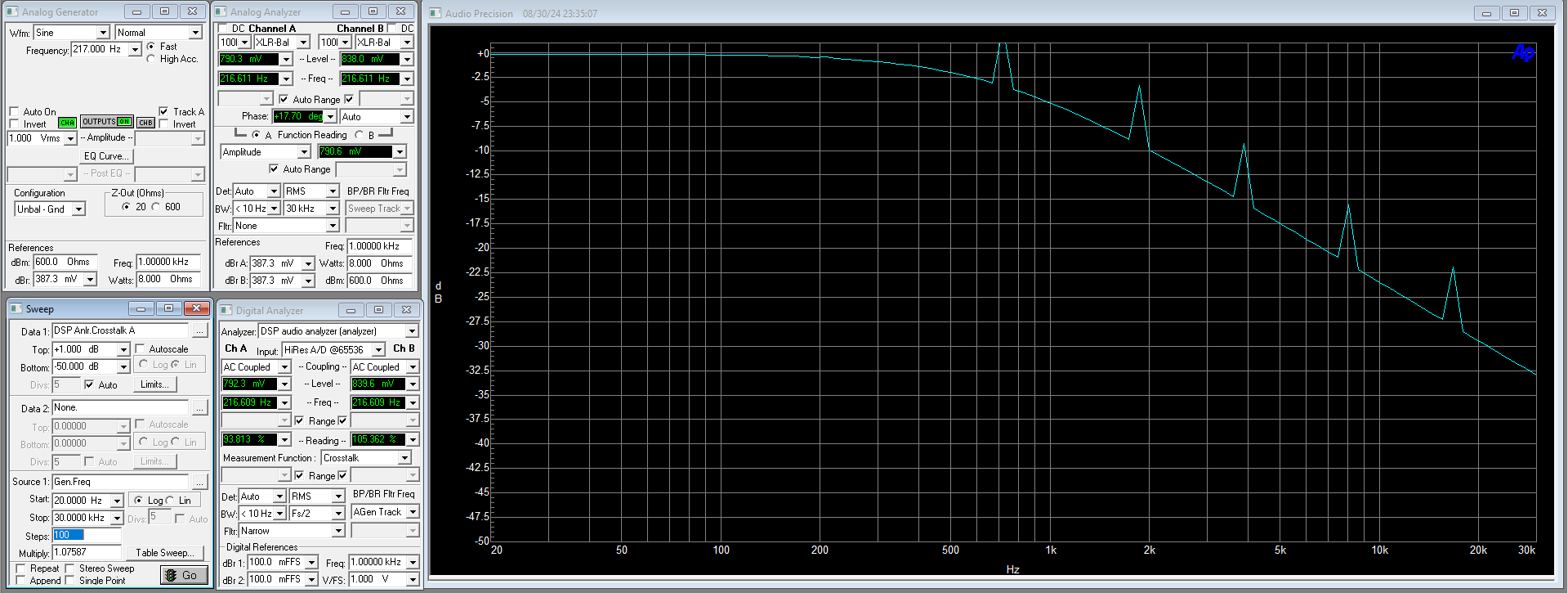

UNFORTUNATELY, when I deselect DC coupled option I get this horrible waveform:
Which I have no idea why and where these peaks come from, they happen in conjunction with the autorange switching on to adjust the signal level. While you would think there could be a problem somewhere, the funny part is when I reverse the settings to do instead of output divided by input and calculating the body plot, but I do input divided by output as effectively the inverse of the trasnformation.....surprise!!
The autorange click same way but there is no glitch displayed. This is most likely a bug on the SW. Was this ever fixed on the AP2700 version?

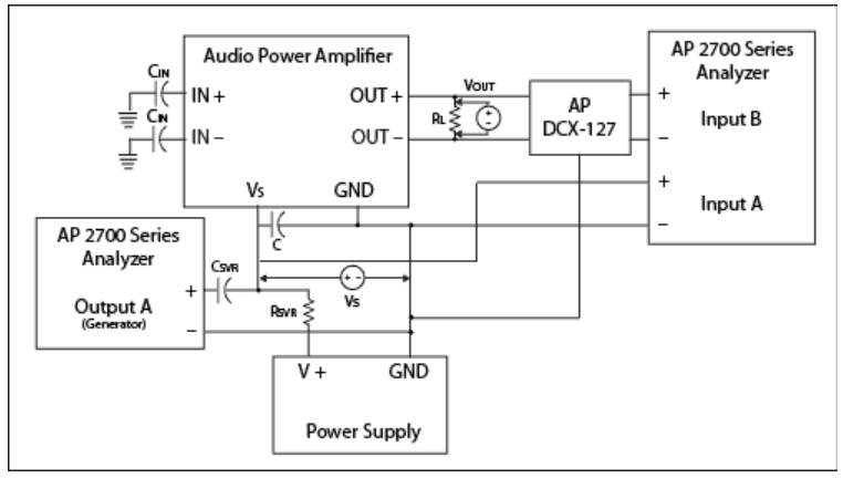

right now I am using a simple low high pass filter config as show in the AP app note
However, I am getting a curve that is different from what I would expect, and I don't know if it has to do with the injection method, in fact due to the low impedance nature of the power supply, the injected signal is about 30-40mV pk-pk even though I have 500mV or so at the input 20ohm gen output.
I am considering the picotest J2120A line injector.
Do you know if there is a simpler way to build a line injector for the PSU bus voltage? I know signal transformers are used for many AC injecting on control loop, but they are not tolerant to any DC current, so to my knowledge, they are not an ideal candidate for voltage bus's application.

Will post a schematic tomorrow. What is the quiescent current running through the V+ of the power supply?Do you know if there is a simpler way to build a line injector for the PSU bus voltage? I know signal transformers are used for many AC injecting on control loop, but they are not tolerant to any DC current, so to my knowledge, they are not an ideal candidate for voltage bus's application.
thank you very much Duke for the explanation!!! So perhaps the artifact I see it a little bug on the APWIN perhaps which is not a big deal anyway. I am trying to measure the PSRR of the PSU module, I am having quite a bit of trouble without a signal injector.The AP System Two’s DC on the Analyzer is used for bypassing the input coupling capacitors. DC mode is not for measuring DCV only lower frequency fixed range.

Thanks a lot! I am having a lot of issue injecting the signal without loading the generator. The quiescent current is about 100mA.Will post a schematic tomorrow. What is the quiescent current running through the V+ of the power supply?
I will look forward to seeing your schematic. I am completely stuck at this point without a signal injector.
BTW I have been reading a TI article, they are using a lot of extra HW to achieve the measurement.
https://www.ti.com/lit/an/slyt547/slyt547.pdf?ts=1725088745924
In the meantime you can read Walt Jung’s 1995 article « High Performance Regulators » in which he describes a high performance injector. The article us archived on his website

BTW in AC coupling mode, I can still see those glitches I showed few posts above. It seems to be level dependent but not sure why in DC mode it's gone.
This works quite well, minimal parts. You don't want to suffer the unfortunate consequences of placing a large DC signal on the Analog Generator of the AP.
There is a way of using a gate driver IC to create the Vgs on the MOSFET. Otherwise you lose that voltage across the MOSFET. Choose a MOSFET with low-ish Vgs(th)
