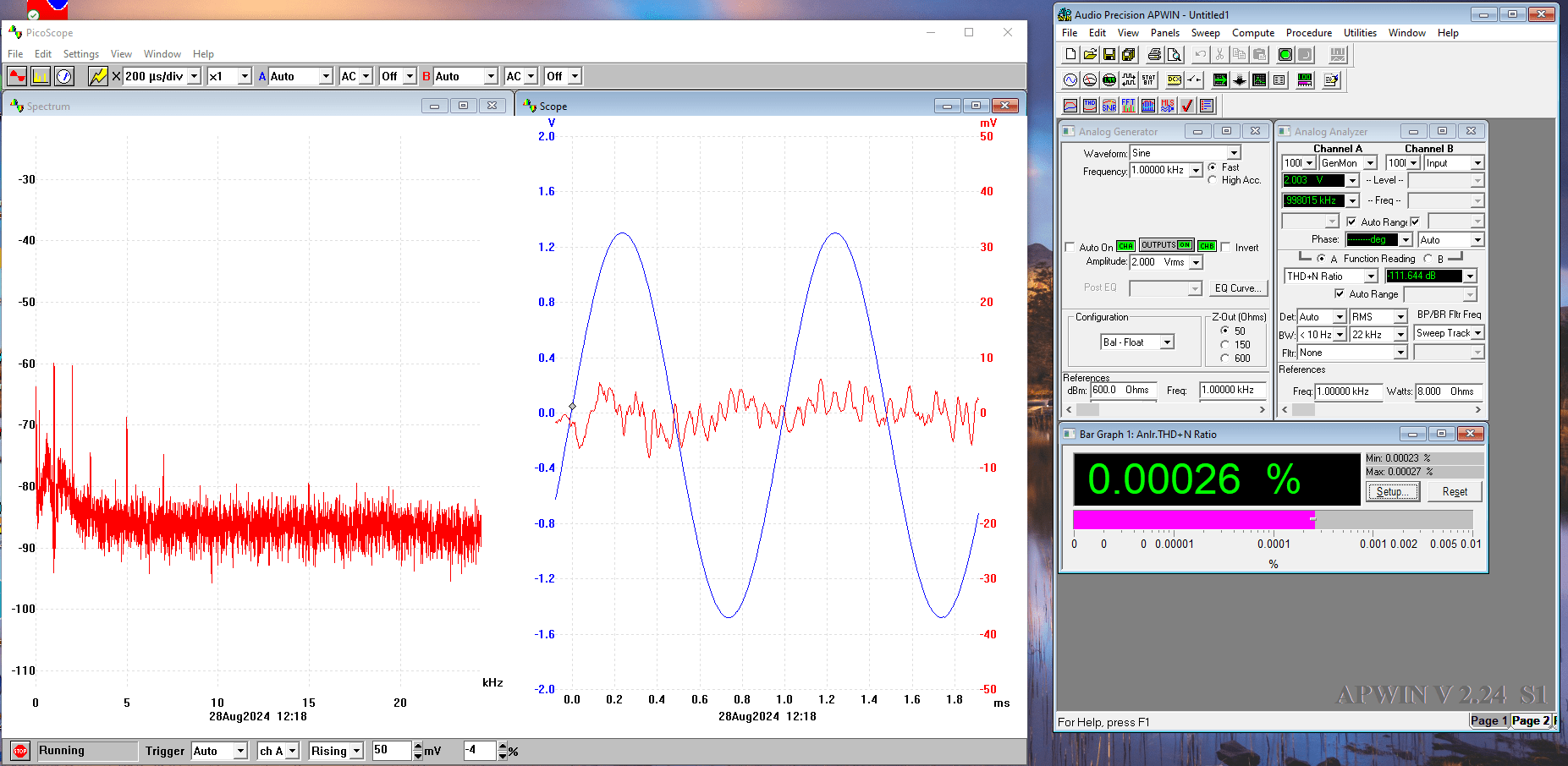

I thought sharing what I'm using might help. Its an AP S1 (without digital) with the IM, Wow and Flutter, and Burst options. Its working fine (I had to replace some parts fried by a previous user). Its connected to a PC running win 10 32 bit. Along with a vintage picoscope (parallel port interface). With this vintage setup (basically 20 years old) I can get good insights into almost any audio device. For digital I have an EMU 1212 in the same box. All up it might cost $1400 for the hardware (and hours of fiddling to get it working). The AP S1 performance is limited by the JFet switches. The later AP's use relays. Its not a big enough issue for me to replace it.
It doesn't do much that a QA403 would do, even the Wow and Flutter analysis can be had with a QA403 I believe.
If the hardware were not given to me I would be using a QA403 or similar. The large waveform and spectrum are nice after using 7" tek scopes.
I have both a Shibasoku 725 and a Cosmos ADC if I need to look at lower distortion. And if really important I have the Radiometer CLT-1 with a -170 dB distortion residual. Nice but not useful or important for normal work.

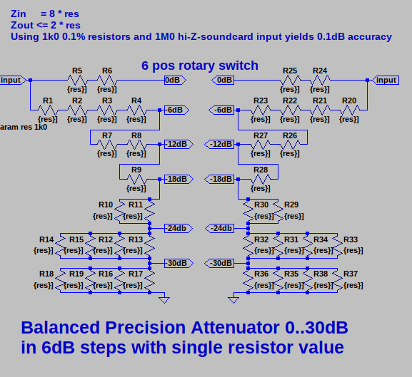

This prompted me to think about some protecting attenuator I will attach to my sound card in the near future.I blew up the input of the sound card when I forgot, for the first time in years, to disconnect it when I powering down the phono prototype!!
This is the idea:.
Obviously good idea to add attenuators to protect the input of your sound card. Problem with that the, one source impedance grows thus noise goes up, also impedance changes and your measurement levels get out of calibration. But for rough measurements and protection is a good simple solution.
Thanks for sharing!!! That’s a very good thd+n figure. In fact even S1 holds down wonderful specifications even though it’s an even older piece of equipment. Truth is, low noise was handled already in the 80s, in fact, the best semis with lowest distortion and noise were made back then. Nowadays only opamps which have gotten good but still discrete circuit with the hitachi BJTs will have the edge.I thought sharing what I'm using might help. Its an AP S1 (without digital) with the IM, Wow and Flutter, and Burst options. Its working fine (I had to replace some parts fried by a previous user). Its connected to a PC running win 10 32 bit. Along with a vintage picoscope (parallel port interface). With this vintage setup (basically 20 years old) I can get good insights into almost any audio device. For digital I have an EMU 1212 in the same box. All up it might cost $1400 for the hardware (and hours of fiddling to get it working). The AP S1 performance is limited by the JFet switches. The later AP's use relays. Its not a big enough issue for me to replace it.

What is the FFT on the left?
Not necessarily a real problem. The source impedance is in my example <2k for the soundcard and could be optional reduced by choosing other resistor.Problem with that the, one source impedance grows thus noise goes up, also impedance changes and your measurement levels get out of calibration. But for rough measurements and protection is a good simple solution.
The noise contribution is neglible compared to the intrinsic noise of the Codec.
At least in the case of my Motu M4 with heavily modified input stage.
Its the Picoscope. Its an 8 bit 100 MHz PC scope with parallel port from 1998 or so. Its really all you need. The software in this case is limited to a 4K FFT. Later Picoscopes working with USB have higher resolution options. However I hate discarding fully functional and useable stuff. The cheapest Picoscope on eBay would work fine. The Pico software is the best USB scope software I have used. 8 bits is more than enough after the analyzer has preprocessed the signals. I tried a 16 bit Picoscope which brought nothing to the measurements (except not enough bandwidth). Getting this all on a 24" monitor makes it much easier to see what is happening.What is the FFT on the left?

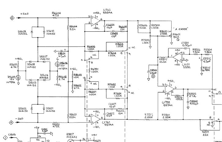

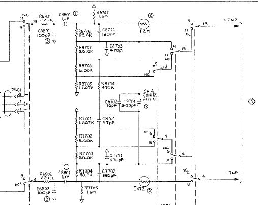

You need to add some clamp diodes to protect the input. Best practice seems to be light bulbs in series to limit the current (but have low resistance when off) and diodes clamping to the rails. The input protecting for the AP S1 is below. You can see the light bulbs (48V in this case) and the clamp diode array Bruce Hofer used. It seems to work quite well. It could be simplified some.This prompted me to think about some protecting attenuator I will attach to my sound card in the near future.

What I meant to ask is what signal is that FFT?Its the Picoscope. Its an 8 bit 100 MHz PC scope with parallel port from 1998 or so. Its really all you need. The software in this case is limited to a 4K FFT. Later Picoscopes working with USB have higher resolution options. However I hate discarding fully functional and useable stuff. The cheapest Picoscope on eBay would work fine. The Pico software is the best USB scope software I have used. 8 bits is more than enough after the analyzer has preprocessed the signals. I tried a 16 bit Picoscope which brought nothing to the measurements (except not enough bandwidth). Getting this all on a 24" monitor makes it much easier to see what is happening.
You also need to add some compensation capacitors to keep the FR flat at high attenuation.You need to add some clamp diodes to protect the input. Best practice seems to be light bulbs in series to limit the current (but have low resistance when off) and diodes clamping to the rails. The input protecting for the AP S1 is below. You can see the light bulbs (48V in this case) and the clamp diode array Bruce Hofer used. It seems to work quite well. It could be simplified some.

For highest resolution this is the way to go.You need to add some clamp diodes to protect the input. Best practice seems to be light bulbs in series to limit the current (but have low resistance when off) and diodes clamping to the rails. The input protecting for the AP S1 is below. You can see the light bulbs (48V in this case) and the clamp diode array Bruce Hofer used. It seems to work quite well. It could be simplified some.

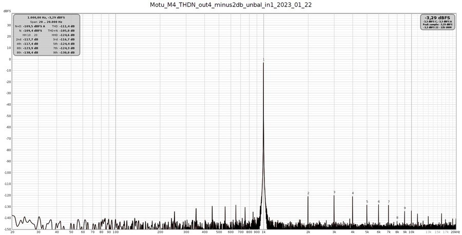

But in my case there are OPA1678 input buffers .
For protetection I added 10k series resistance.
With guaranteed max input rating of +-10mA I do not not need any clamp diodes upto 100Vpp on each branch of balanced input.
The 10kOhm series resistance adds 11nV/sqrt(Hz) to 4.5nV/sqrt(Ht) input noise of OPA1678.
That looks pretty much compared to top notch inputs in the ballpark of 1nV/(ssqrt(Hz).
But in reality input noise of the ADC is dominant, so resolution only degrades a tiny bit.
This is a loopback measurement at -2dB FS generator level.
Its the FFT of the residual after the notch filter. Its on the "reading" output.What I meant to ask is what signal is that FFT?
