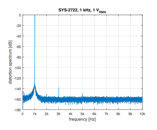

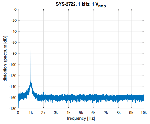

believe or not but you got H3 -110db as I said, isn't it? FYI, ere is the pdf with notch measurements of 2722, 555, s1 AGens. https://www.nanovolt.ch/resources/oscillators/pdf/low_distortion_oscillator_comparison.pdf

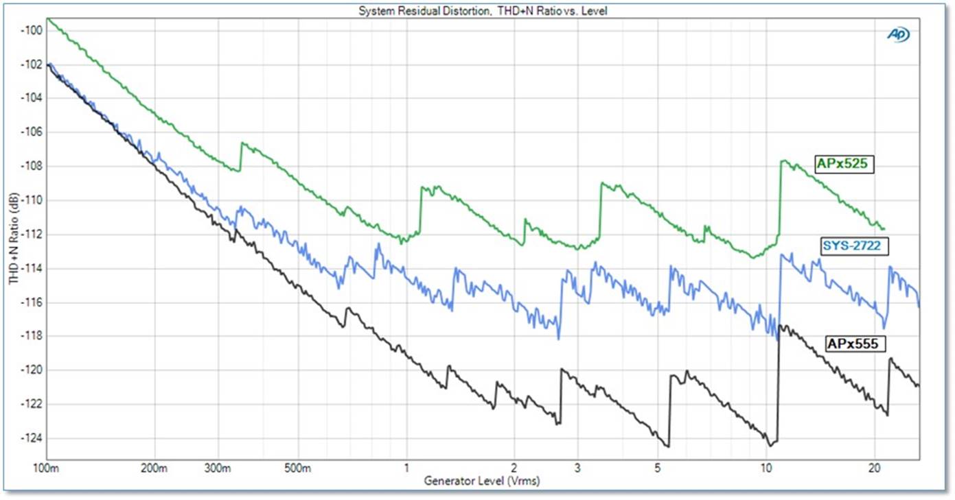

Tom,Because it is... The SYS-27xx was the state of the art at one point. I'm thinking the APx525 (~$12k) was less expensive than the SYS-27xx. Then the APx555 came along and made the SYS-27xx obsolete. AP just discontinued support for the SYS2700-series.
I received this from AP when I was talking to them about these things.
You can compare the performance of you 2522 with the plot above and find out. I suspect the 2722 is quite a bit better, but that's my guess.
I don't know if this generalizes to other AP models, but the performance of the APx525 is limited by the THD of the generator. So by filtering out the HD one can get down around -125 dBc THD (not THD+N!). I was able to measure near -140 dBc THD by then also notching out the fundamental from the DUT output. Unfortunately, I could not get it to work reliably across a wider range of voltages, so I ended up punting and getting the APx555 instead.

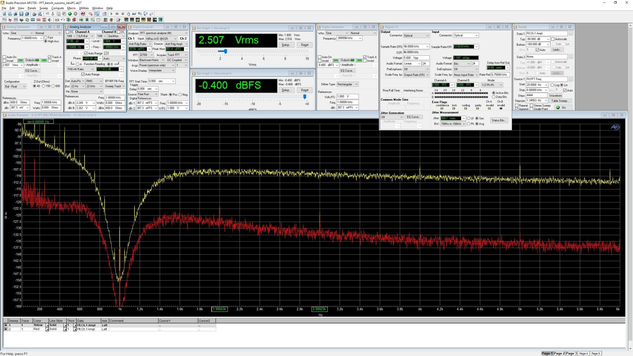

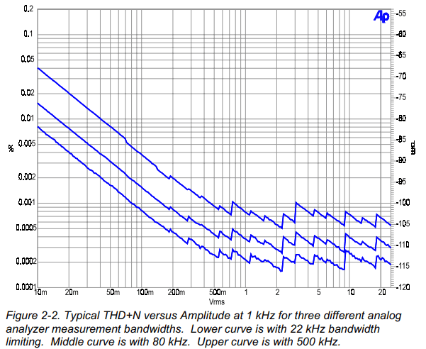

As I am getting more acquainted with the unit, I ran the same test shown on the brochure to compare models, on the 2522 to compare the performance,
As you can see it is pretty much a match with the 2722.
Maybe 2722 was improved vs 2522 with a sample rate(192k vs 96k) but the THD+N is nearly the same. At 2.5V (the sweet spot) mine reads -117.6db, AP 2722 commercial boasted -118db.

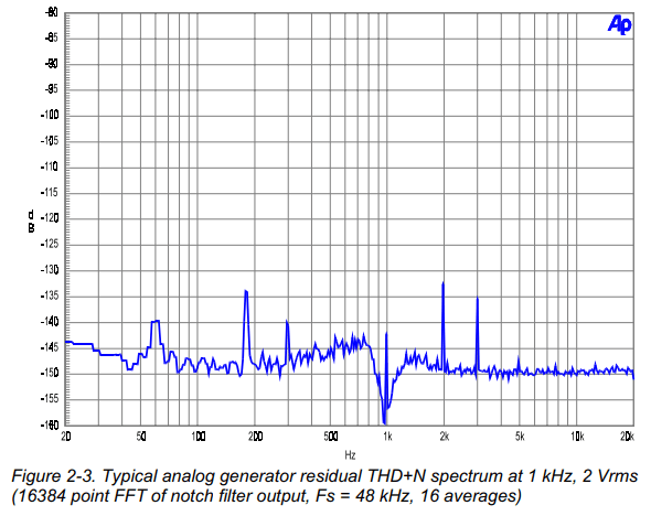

why don't I get this performance?believe or not but you got H3 -110db as I said, isn't it? FYI, ere is the pdf with notch measurements of 2722, 555, s1 AGens. https://www.nanovolt.ch/resources/oscillators/pdf/low_distortion_oscillator_comparison.pdf
My scan shows about -140dB noise floor. What am I setting wrong with the analyzer?

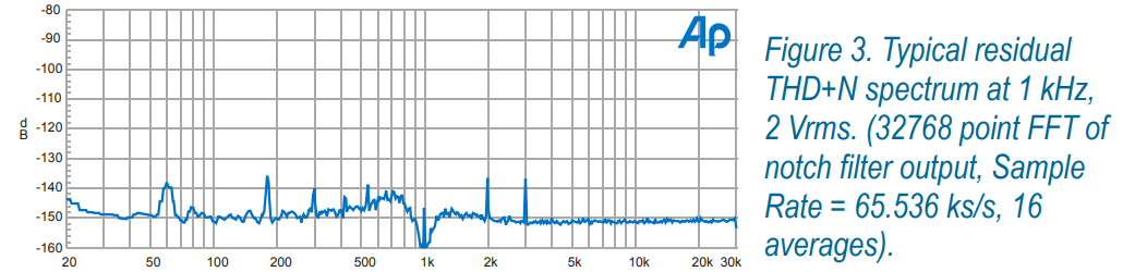

This is the pdf with EXTERNAL notch-filter measurements of 2722, 555, s1 AGens.

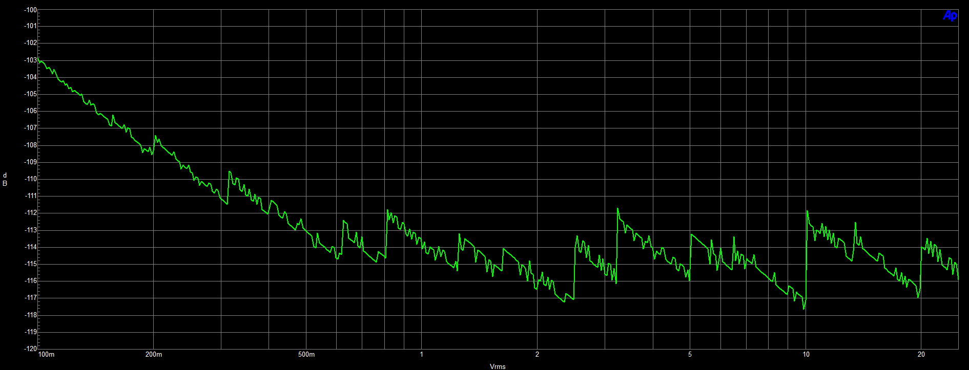

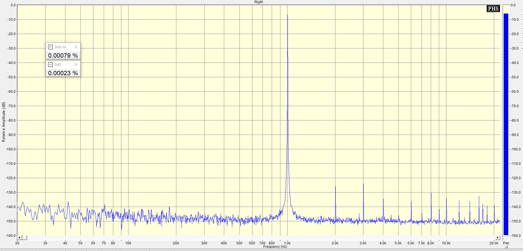

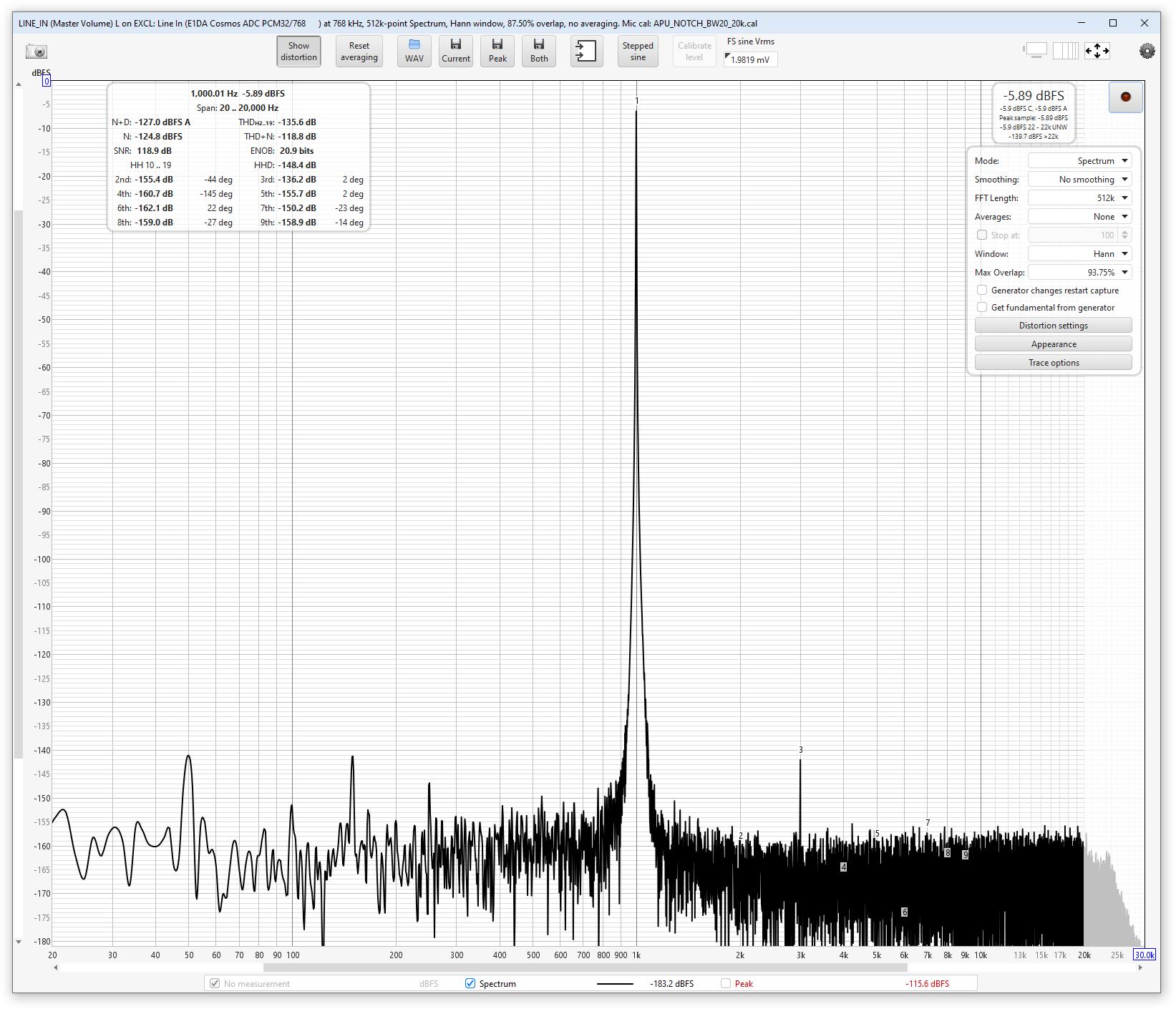

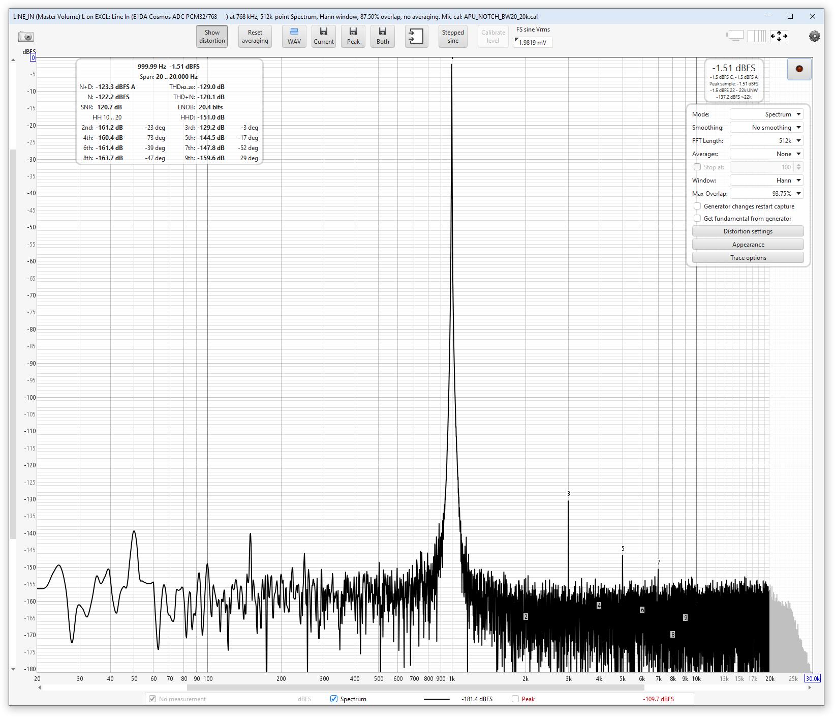

With a notch(Cosmos APU, see attached) my 2522 has H3 -136db, and H2 <-150db, however, almost any modern DACs has better THD performance.
THD+N reaches -120db at 10V.

It is 2522 AGen, 1st screenshot is 6V, second one at 10V. ADC was mine indeed but you can get the same result even with your laptop 3.5mm audio input.
The notch was EXTERNAL device, nanovolt.ch also used external notch filter.

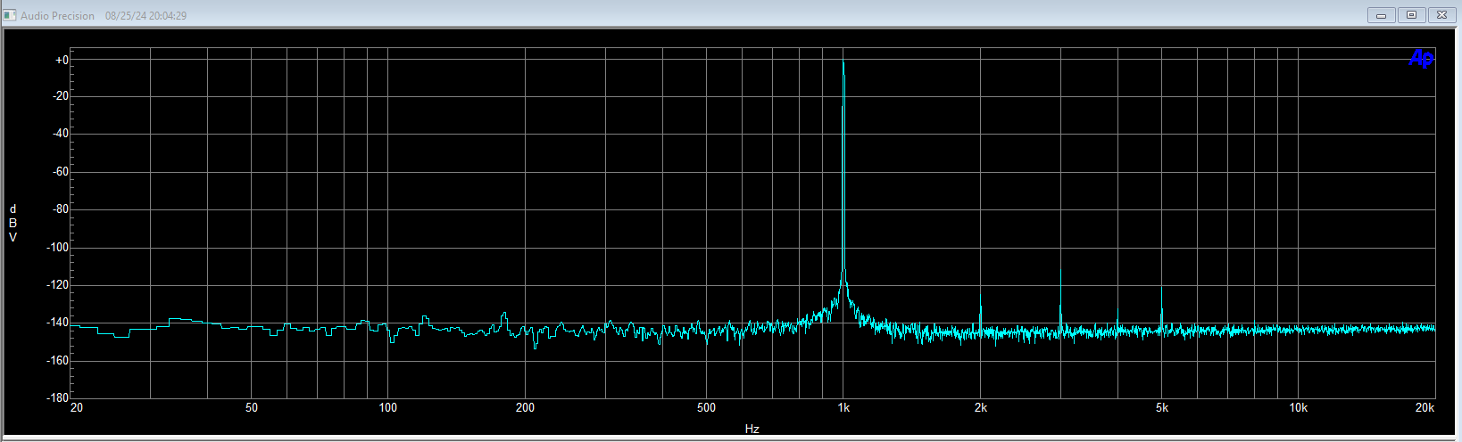

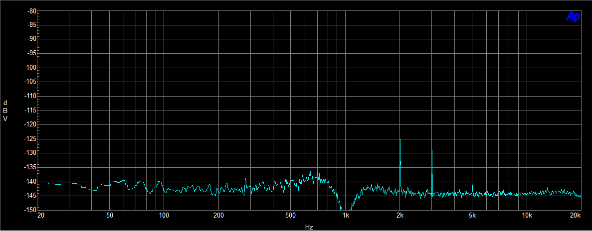

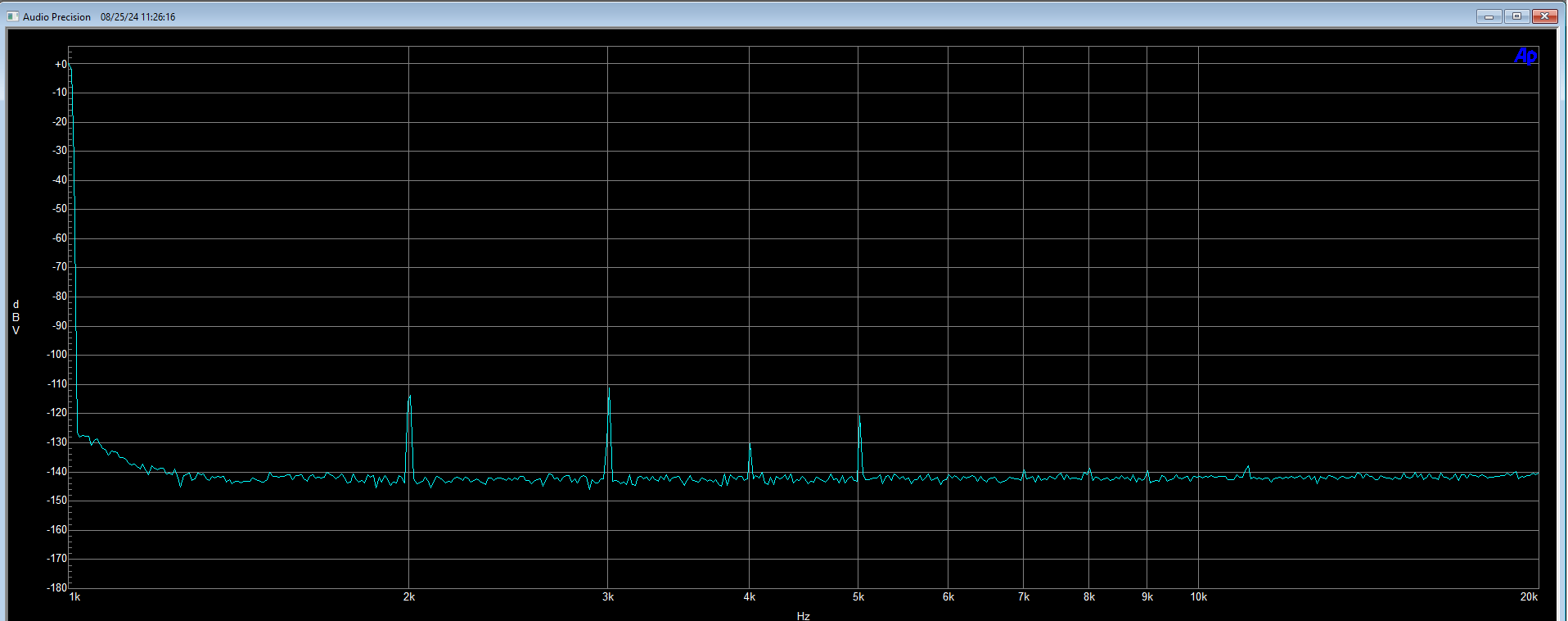

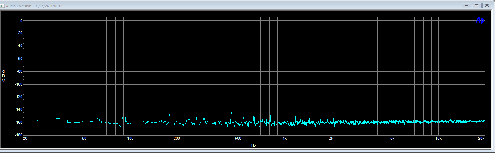

This is the loopback when generator is off
This is with the gen on 1KHz/1VRMS
while the generator should have this performance also confirmed by your plot with Cosmo
What am I missing?
This is the AP spectrum of the Signal Generator 1VRMS going into my EMU0204/SprecraPlus
This is roughly 10dB difference between AP and the EMU, but it's because the levels are not calibrated and shows on EMU 1VRMS sits at -10dB while on AP at 0dB?
Does it mean the software takes the whole graph 10dB lower? TDH+N is in agreement with the Soundcard measurement, AP marks 0.00083%.
Again why am I not getting matching results with the one shown on the article with all the generator measurements?

I have been trying for many hours to see if I get the expected spectrum, but I am unable to get noise floor down to -160dB and highest peak at -140dB no matter what I do.
Could you be so kind to plot a loopback test of the generator at 1KHz/1VRMS on your AP? Everything being equal, I am assuming you should be able replicate the same readings you get with the Cosmo ADC which also match the ones posted on the article you linked (which doesn't specify if these spectrums are taken on the AP or on the SYS system)

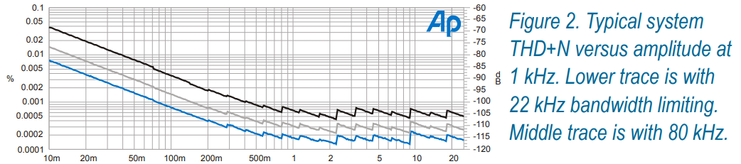

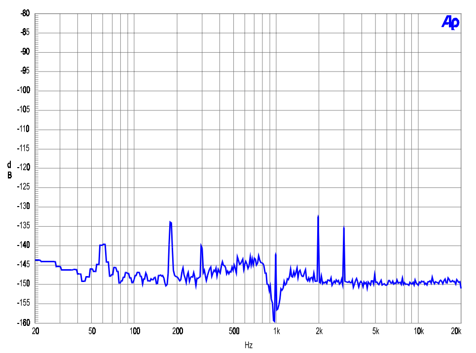

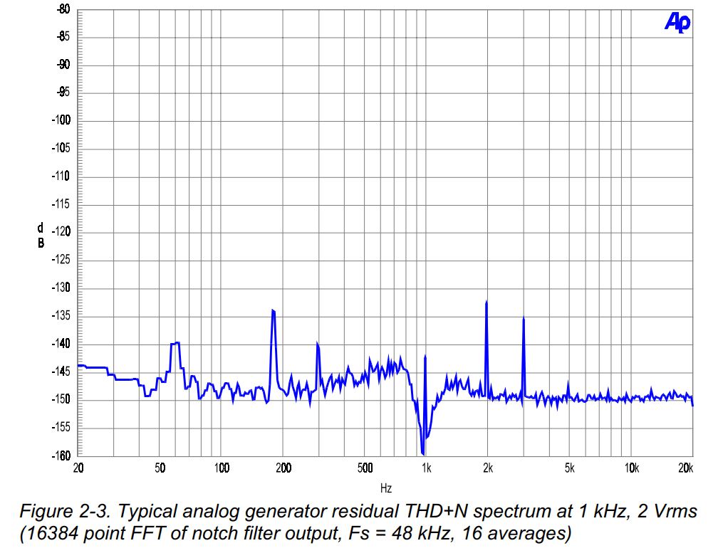

Unfortunately it didn't let me edit the post above but I compared more documents here from AP site
Just for completeness, this is an extract from AP documentation
System 2 Cascade
2700 series
Looking closer at the bottom graph with the 22KHz filter, we can observe that 2700 has 2dB or so less noise than system two
Spectrum for the generator with notch out
System 2 Cascade
2700 Series
Here we can see the same, an improvement of 2-3dB on residual harmonics from system 2 to the 2700series.
All in all however, the two units are basically almost identical.
Nevertheless, even though my plot for THD+N vs voltage @1KHz matches the datasheet, the FFT has third harmonic significantly higher than what expected, which means I have to review my settings and study what's wrong with it.
Once I have determined the problem hopefully, I will post so if anybody runs into the same problem, at least they know how to solve it effortlessly.

You were correct I had missed something on the Digital Analyzer. I had the input of the digital analyzer on Anlr, but for greater dynamic in the case of low distortion levels, I had to select Anl Rdg. So here it is with the option inserted:
The resulting spectrum is a match with the datasheet.
On a different note, the TDH+N on the 2522 at 1VRMS reads -113.4dB, while on the 2722 at the same level reads -116.4dB (I found a picture on internet that showed the measurement on an actual unit) thus showing an improvement over the 25XX by 3dB that is expected by looking at the two datasheets.
With this in mind, I have finished checking the analyzer and gladly, it is all within specs. Now I will go on and read as suggested, some application notes on AP's site for measurements and start putting it to use for the project I am currently working on.
