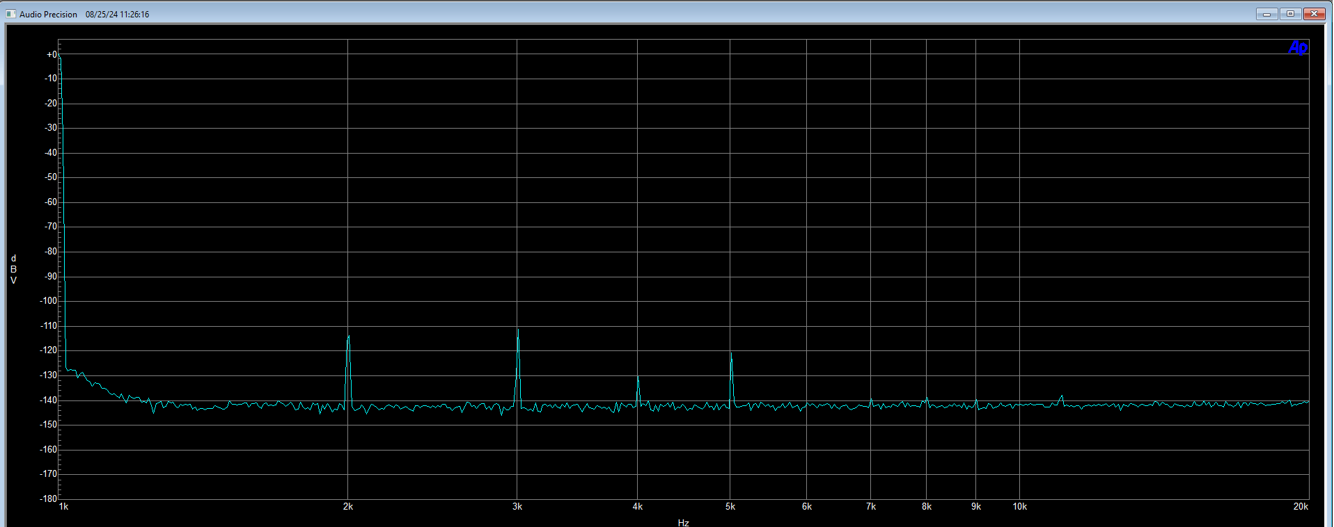

This is the FFT of 1KHz 1Vrms

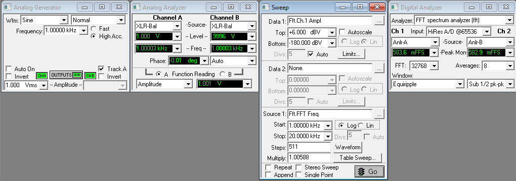

with the following setting (unfortunately I have to do a snip of the screen to capture the image, with APWIN I cannot see export to JPEG or anything like that.
Are these setting correct? Should I change something to obtain better performance?
Also, why on the pre-made tests I can see the generator has more options in terms of impedance and the analog analyzer selectable input impedance? How can I enable all those features?
Also, do I understand correctly that the max FFT frequency allowable is 32KHz? The machine is 96K so shouldn't it go up to 48KHz max BW?
One note, I have only loop cables between Analog in analyzer to Analog out gen, do I have to add monitor to the digital section ot some other conenction?

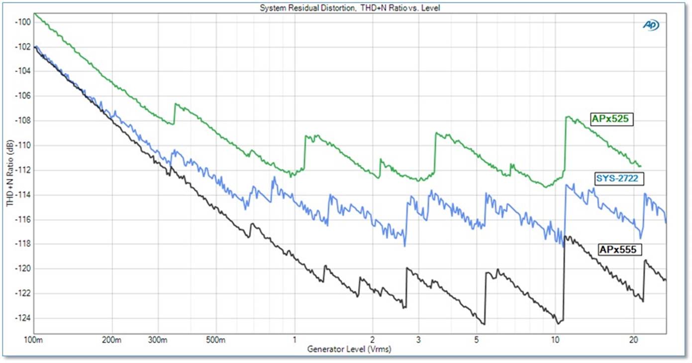

Because it is... The SYS-27xx was the state of the art at one point. I'm thinking the APx525 (~$12k) was less expensive than the SYS-27xx. Then the APx555 came along and made the SYS-27xx obsolete. AP just discontinued support for the SYS2700-series.I thought the APx was the latest and greatest how can the 2700 be better?
I received this from AP when I was talking to them about these things.
You can compare the performance of you 2522 with the plot above and find out. I suspect the 2722 is quite a bit better, but that's my guess.and I wonder if there is any significant difference in performance between the 2722 and the 2522.
I don't know if this generalizes to other AP models, but the performance of the APx525 is limited by the THD of the generator. So by filtering out the HD one can get down around -125 dBc THD (not THD+N!). I was able to measure near -140 dBc THD by then also notching out the fundamental from the DUT output. Unfortunately, I could not get it to work reliably across a wider range of voltages, so I ended up punting and getting the APx555 instead.
Tom
I thought they only had the APx555. I cannot find any documentation regarding the performance of a 2722 vs. 2522. I am wondering if they were different like in this case, they would have published it, but I am not sure. 2722 was too expensive and I don't know what benefits it would have offered.Because it is... The SYS-27xx was the state of the art at one point. I'm thinking the APx525 (~$12k) was less expensive than the SYS-27xx. Then the APx555 came along and made the SYS-27xx obsolete. AP just discontinued support for the SYS2700-series.
