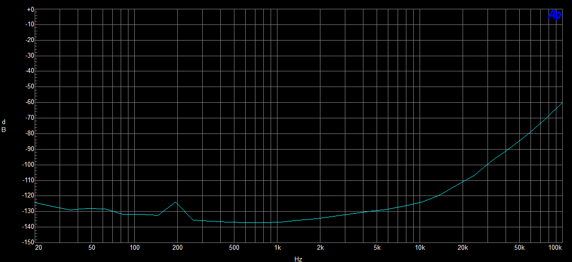

Thank you. I think I can stop right here switching op-amps the result is not bad. I thought of the hfe since I have read a comment on the dedicated thread on this made by you. I am using MJE15034G. Datasheet indicates ft>30MHz, but there is no specific graph of hfe over frequency.
I believe the recommended D44Hxxx are 100MHz and have less interelectrode capacitances. They should be good up to 1A or so.
But I agree; what you have now is very good and hard to - meaningfully - improve. Go on to your next project 😎

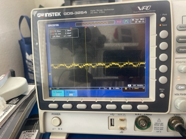

I have spent the last several hours on the Jung and made marginal improvement, by changing the pass device and switching to OPA182.
Below is the last result and I won't push it any further.
With the scope probe right at the output, I can see about 1.13mV pk-pk about 150KHz main oscillation frequency with higher harmonics
.jpg
Play with grounds reduce or increases slightly the content of the waveform above.

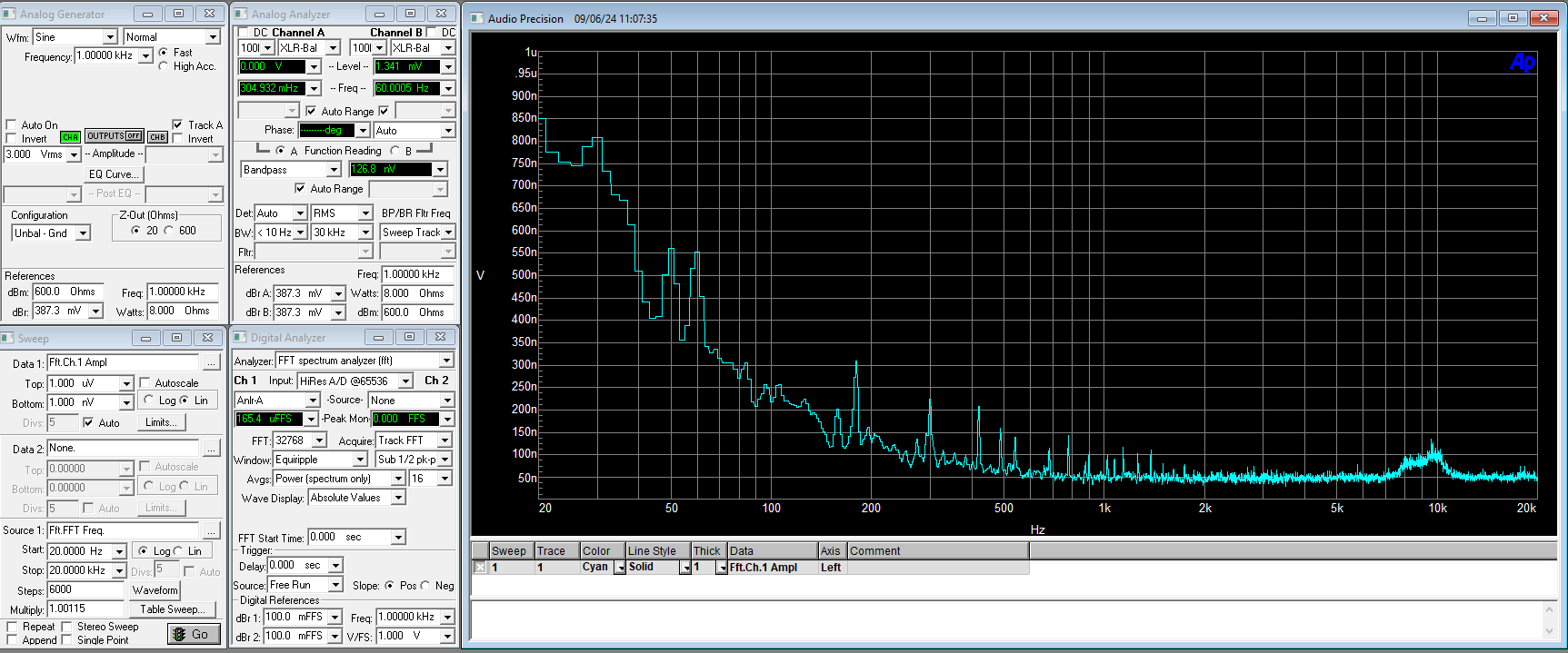

Below the FFT of the noise out (not scaled to sqrt(Hz) yet)

With the scope probe right at the output, I can see about 1.13mV pk-pk about 150KHz main oscillation frequency with higher harmonicsView attachment 1353188
Wat you have is very, very good. For the remainder, do the same test with the probe connected only to its ground lead but at the same location. Chances are that you measure basically the same grudge, meaning it's not the regulator.
Jan
Reactions: Stefanoo
Jan, yes you are correct. It’s a matter of grounding I got the plots to clear significantly. I have optimized to what I feel, as much as I could. I will post the final plots tomorrow as it is 1.30AM lol

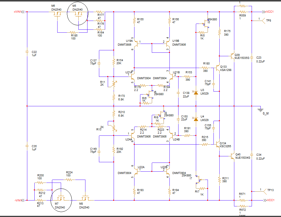

This is the shunt I am trying to optimize. interesting enough, I removed the cascoding M8 and performance instead of decreasing, improved. Maybe the cascoding needs more headroom to operate don't know yet.

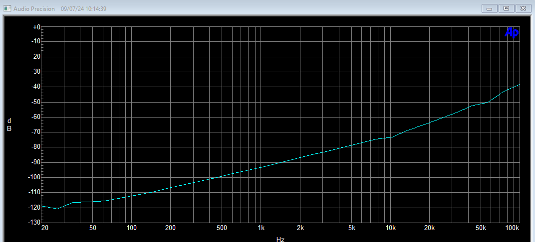

Belo is the plot without the current cascoding also set to 0 ohm R155 and R156 and max the current on the current source I5, I5 by shorting the gate/source resistor and now probably deliver 1-2mA
I think the shunt should also provide similar performance to the Jung Regulator given the natural isolation it provides by it's current source, at least it should be better than this I assume lol
There is a shunt regulator from Walt Jung employing the same principle as well known JD regulator. It should have excellent performance (judging by simulation results). Some members here use it for DACs but no one has made any significant measurement.
https://refsnregs.waltjung.org/UnivReg_122714.pdf
Walt Jung’s site is bandwidth limited so I’ve attached the document, just in case.
Reactions: Stefanoo
Thank you so much Tom. I had seen this topology just yesterday, this document toi attached is very useful in detailing everything.
Problem is that the board is designed with the shunt I have in the picture so I will have to fix what I have. Implementing this on the current board would be very challenging. Later on for my own purpose I will design a test board for this one and perform measurements maybe I will use it for future applications. Thank you again for the valuable info!
