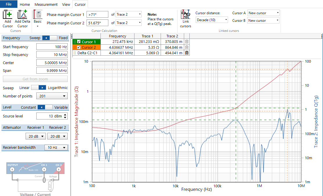

Well, for one thing, to measure phase accurately with an AP you need several milliVolts of signal. With a VNA you can do it with uVolts.
Here's an example of looking at power supply stability with a VNA. The red line is impedance, the blue line is "Q".

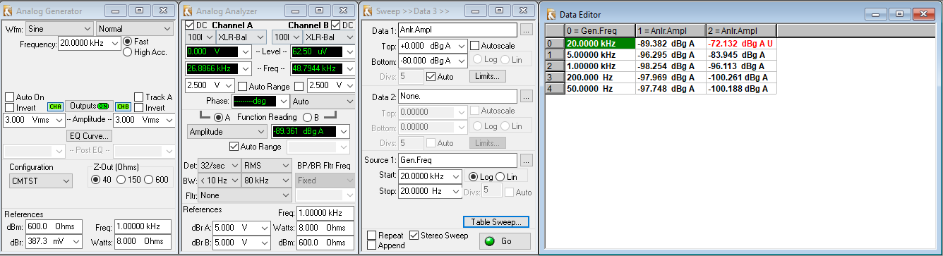

Just unrelated with the latest conversation, but I was running a self-test on my AP and it fails one channel on the CMTST setting on one of the channels.
Not sure why, it passes all the other tests in with this gen configuration. Here the results. Does it mean I have a problem with one isolation transformer on one of the two channels?

It passes the test at 5 and 10V but fails at 2V and only one channel. If I understand correctly, you are suggesting to swap channels to see if the problem follows. Thanks it’s a great idea. I will do that tonight as soon as I get back home, I just took a break from work to go to the LA Italian festival lol
I have swapped channels i.e. gen out A gois to IN B, while gen out B goes to IN A, the problem doesn't follow, which would suggest the issue is at the input of the analyzer. What can it be?I would verify the source output impedance before suspecting the transformer.

you have the Bode 100, nice Vector analyzer. Can I understand how much this measurement really impacts the design of an audio linear supply?Well, for one thing, to measure phase accurately with an AP you need several milliVolts of signal. With a VNA you can do it with uVolts.
I quite don't get it why going to this range and I Am not saying this is not good measurement, rather the opposite I am impressed, I am just trying to understand what this can bring to the table when it comes to an audio gear. Granted we can see stability issue without special insight through a scope.
BTW in the meantime I brought out the spare HP spectrum analyzer 9KHz-1.8GHz to plot the output of the circuit, so I can learn to incorporate more into the daily routine those tools I use for RF design into Audio as well.
For example, if you are using high speed opamps etc (>50MHz) you want to make sure supply impedance is flat (ohmic) and low at all frequencies.Can I understand how much this measurement really impacts the design of an audio linear supply?
And when you work on a DAC chip that pulls supply currents at MHz freqs and harmonics and you happen to have an impedance peak at just this frequency you know why distortion is worse than expected. Typical scenario would be the dreaded CLC resonance tank circuit, like paralleling a more remote ceramic bypass cap with a smaller ceramic one closer at the chip, maybe even connected with a long but narrrow trace. Without an impedance analyzer you are sitting completely in the dark here.

Very true.Typical scenario would be the dreaded CLC resonance tank circuit, like paralleling a more remote ceramic bypass cap with a smaller ceramic one closer at the chip, maybe even connected with a long but narrrow trace. Without an impedance analyzer you are sitting completely in the dark here.
Therefore, a network&spectrum analyser vs o'scope offers a similiar level of improvement in observable circuit behavior than a scope does vs. a multimeter.
Many (most?) power distribution schemes on pcb's these days have resonant peaks all over the place. I think this is because dogma from decades ago about paralleling bypass caps and so on still is commonly applied today.
Despite efforts from people like Howard Johnson to explain all of this, it's hard to move a lot of engineers off their current practices. Beginners don't learn about this until they are on the job, even though they certainly have studied the underlying fundamentals along the way. Many more senior engineers have gone into management roles and expect the people they supervise to follow what they did back when they were practicing engineers.
It's too bad, too. You can simulate a lot of these factors in Spice, and LTspice is free to use. You can also measure a lot of this with low cost VNAs, as you explained. You can design goodness into the pcb or at least allow for a few RC dampers in various places so that you can add them experimentally later. But, none of that seems like it's common practice. Thus, a lot of products don't meet their potential. That's true for DIY efforts as well as commercial offerings. I guess people would rather argue and rationalize...

Anyone has any idea what could be wrong with this test?Just unrelated with the latest conversation, but I was running a self-test on my AP and it fails one channel on the CMTST setting on one of the channels.
