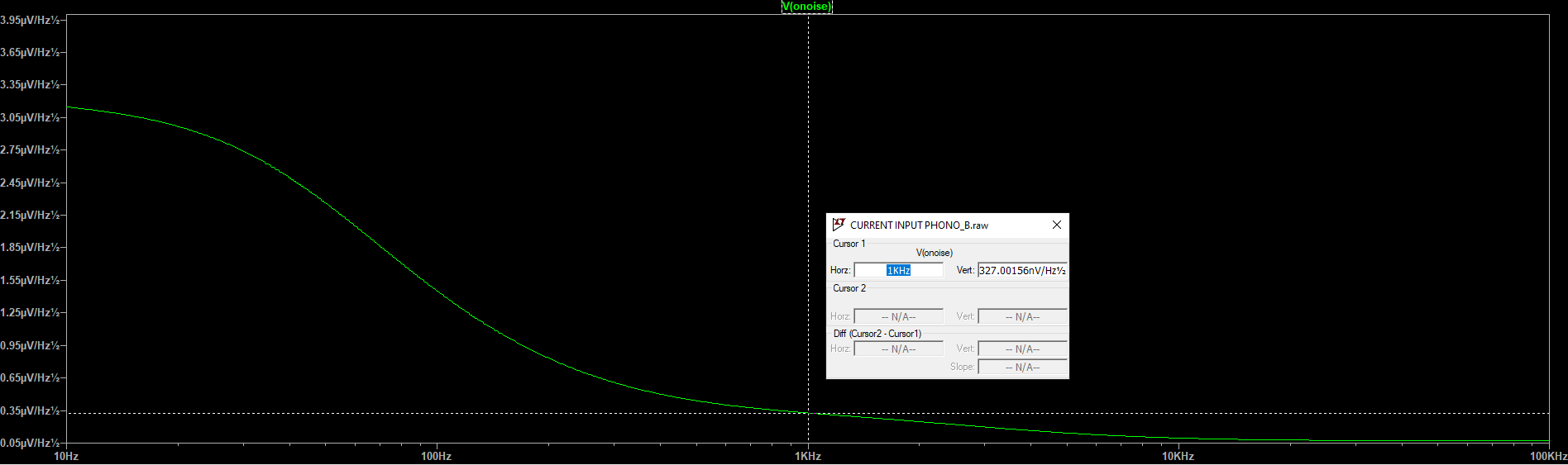

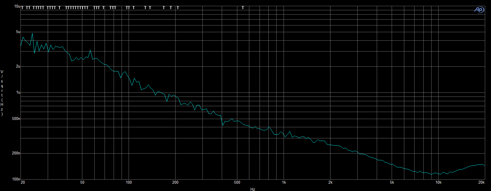

Just wanted to share some results on the 70dB balanced fully discrete transimpedance phono amplifier I am working on, in specific the noise density measurement using AP.
Below the plot of the SE output.
Not sure why I have that rise above 10KHz (balance noise flattens out). Noise measured at 1KHz 330-340nV/sqrtHz
SE noise density output of the simulated circuit:
Simulated noise 237nV/sqrtHz @1KHz
I do love AP and how reliable it is, the match is striking. Thanks for sharing the macro with everyone.
