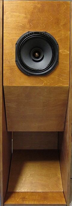

I am in the process of building and tuning back-loaded horns for AN10 cast frame drivers. I have used the EZ10 plans and I have reached a point to be able to test the sound with one of the side walls attached just with a clamp (to allow me to open the speaker and play with acoustic foam without even fixing it firmly just yet etc.).
I must say I did like what I heard so far but... after around 10 hours of playing, I am afraid I miss "transparent clarity" of sound.

I'd put 45 degree reflectors in that horn design at the 90 degree bends - those 90 degree surfaces are going to be bouncing the sound around like crazy. You might usefully add a short 9 inch to 18 inch or so horn at the front to balance lower midrange and focus the higher frequencies. But perhaps this driver might be best in open baffle. The 8 inch unit might give more transparency but otherwise you could add a cheap peizo tweeter - or two at 45 degrees to simply add sheen to the top end of the sound.

Adding reflectors will probably just cause more problems; the LF wavelengths are too long to be bothered, & you may end up with more unwanted midrange (which with their shorter wavelength are more affected by sharp turns) passing through. That's why many of my designs use the folding as a functional part of the design; in conjuction with the low-pass chamber they set the upper corner frequency of the horn.

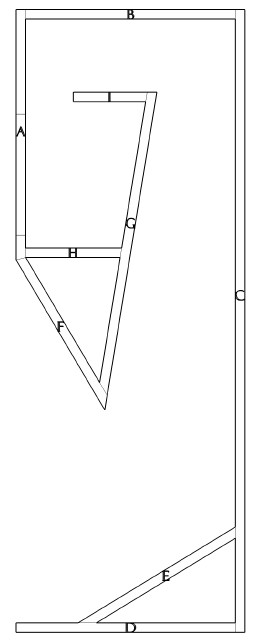

a) if the manufacturer-given frequency response specs (http://www.commonsenseaudio.com/an10cfspecs.jpg) show the driver is capable of delivering clean treble, what might cause that it doesn't (I guess apart from the possibility that the theoretical specs are off)?

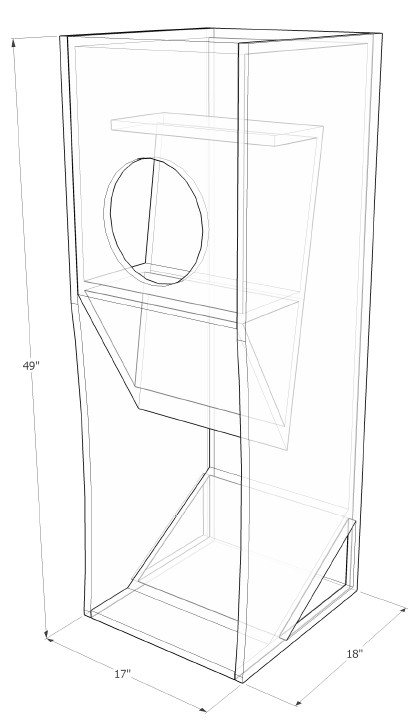

b) how important in back-loaded horns is the width of the path (sorry for my lack of terminology) such as distance from 'I' piece to 'A', 'I' to 'B', and 'I' to 'C'? I understand the author of the design Thomas Petzwinkler used software to calculate the dimensions. Would adding 45 degree reflectors in the 'H+A' corner or 'A+B' corner or 'B+C' corner mess up the simulated frequency response (http://spqracoustics.files.wordpress.com/2008/02/ez10-in-room.gif)?

a/ Chances are they're being economical with the actualite. Most driver manufacturers tend to present an idealised version of the truth.
b/ Length is generally taken along the centreline of the horn. Deflectors (assuming they're done properly) are good for maximising efficiency over the broadest possible BW, but generally, you don't actually want a particularly high acoustic XO from the horn to direct radiation or you'll run into severe group-delay / phasing problems up through the lower midrange.

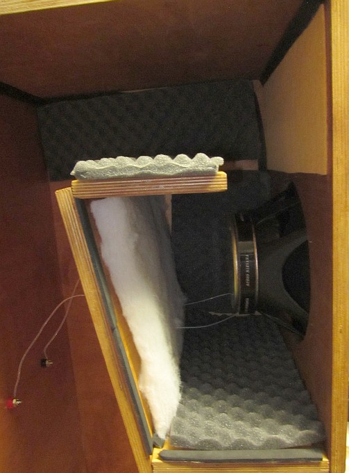

Are you sure you have the cabinet properly sealed? I can see slivers of light creeping through on the closed end.
I have no experience with back loaded horns, but they look like the best choice for a driver like AN. The response of the AN is tilted up in the high frequencies and you need a BLH to improve its efficiency in the bottom and balance it out.
What amplifier are you using? If you are using a big SS amp with a high damping factor, it is going to make the AN sound even more shrill. Use a tube amp (or even an good SS amp) with a low damping factor. Makes a big difference in the bass.

the cabinet has not been fully finalized yet (and there is indeed a very narrow glue-filled transparent gap that you noticed in the bottom half of the cabinet).
The cabinets are still in the garage where I worked on them with my father and I have not tested them with my main amplifier (SET EL84 tube amp). For testing, I first used an SS amp and then a push-pull EL84 tube amp and the latter was indeed better.
Depends on the design.
Ideally, as you can't run any back loaded design up particularly high, you want a driver with a reasonably low mass corner so your horn assists below that & you obtain a seamless transition to direct radiation. 250Hz - 300Hz is about the limit you can run a back horn up to without suffering from the aforementioned adverse group delay, phasing etc.

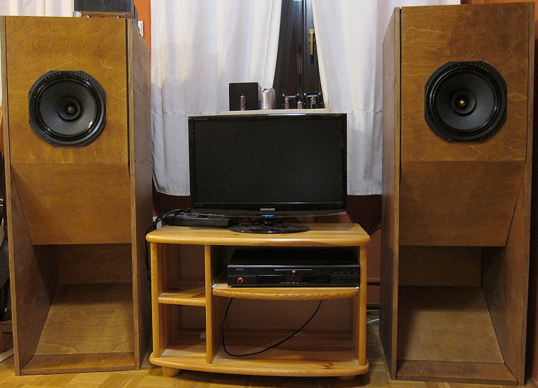

Listening impressions: AN10 in EZ10 back-loaded horns
In case this is of interest and relevant to this topic, I summarize below my listening impressions of the AN10 in back-loaded horns EZ10.
All the observations below are my subjective opinions, with no scientific measurements involved.
Because of my limited experience with speaker building, I am often unable to differentiate between effects of a speaker cabinet, damping, speaker placement/room acoustics, and driver itself.
The speakers have been playing for some 100 hours, so the drivers should be - for the most part - burned-in already.
I kept the source, amplifier, and speaker cables the same when replacing my previous speakers (Metronomes with "EnABL-ed" fullrange drivers Fostex FE127eN) to be able to better spot any differences. Naturally, the Metronomes were my reference point for this comparison so any evaluation remarks on EZ10 with AN10 are to be understood in that light.

EZ10/AN10 are without doubt the winner here. The bass is full and much more present than with the Mets. I have never heard better bass in my system before. The planned EnABL treatment of drivers might make the bass notes more cleanly defined as they are now, perhaps.
