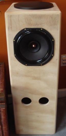

Here is a picture of my Cast Super 10" in the 2.8 MKII enclosure.
I haven't stained them yet. I was to anxious to listen to them.
Here is something I did when I built mine, that you might want to consider. I used 2 pair of speaker terminal and wired the top driver to one and the bottom to the other. I wanted some options with this setup. Here's what it can do.
1. Jumper the 2 terminals and use 1 amp = parallel setup 4 ohms.
2. No jumper, 1 amp using only the 10"
3. No jumper, bi-amp, no active crossover required.

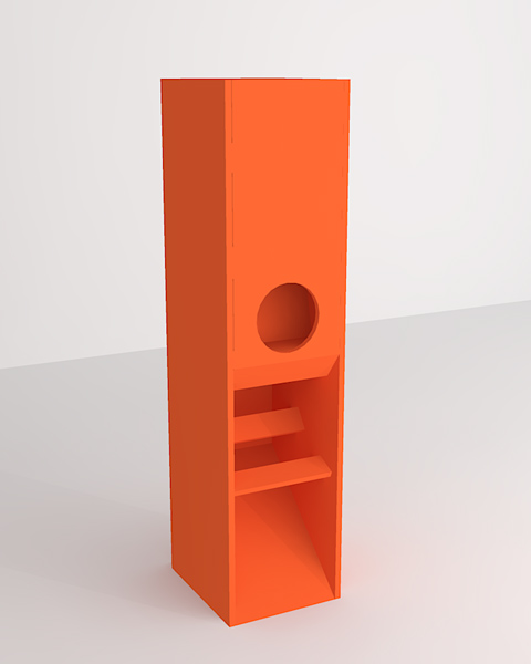

I have decided that these will be my next project (tax returns don't ya know) 😀 . I will begin design on an enclosure based around the Model III (for the 8" style drivers shown) probably this weekend. I will keep everyone posted.
Tom
Thanks for the tip about editing my posts. I didn't know I could do that.
Allen ...
Tom
Thanks, I look forward to seeing what you come up with. I am also curious about the 12's but fear that their high frequency response may suffer too much...

Yes I did use David's design. Except for the wiring part, it's exactly as David designed it.
David is a real down to earth guy. I e-mailed him and talk to him on the phone several times so he could answer all my questions. This being my 2nd set of Audio Nirvana speakers I have learned a lot about building and tuning these speakers. I would be happy to answer any questions you have with them.
Both sets that I have built sound awesome. The best I've ever heard. Certainly better than anything Best Buy sells.
The first set is the Super 10 in a 2.8 Series I birch enclosure using the 6" port hole.
The second set is the Super Cast 10 & the regular 8 in a 2.8 MKII Abmience birch enclosure with twin 3" port holes.
Their wasn't enough low end bass with the first set with the 6" port hole. So after talking to David, he told me that a 5" long port tube would improve the low end bass making the enclosure equivalent to one with the twin 3" ports. So I bought two tubes from Parts Express for about $5 and it greatly improved the sound of the low end on these. The second set has the twin 3" ports and it's perfect.
I recommend the 2.8 enclosure with the twin 3" ports. The Ambience if you can afford it.
I listen to a lot of different things. Right now, I'm re-enjoying Supertramp because I'm hearing things I've never heard before I had these speakers. The song, "School" is really good. When the singer starts to sing, you can practically see him standing in the room it's so real. I listen to 70s, 80s, 90s, alternative, jazz, and dance music. The speakers play them all well, but the recording makes all the difference as to where or not they sound fabulous.
By jumpering the speaker wires, the load presented to your amp will be 4 ohms. If your amp can handle 4 ohm loads, you will have no problem. It should be listed in the documentation.
