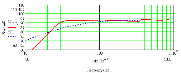

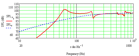

Looking at the rough dimensions for that CSA box, & roughly setting driver & vent heights, then you can expect something like the attached with the vent you have at the moment.

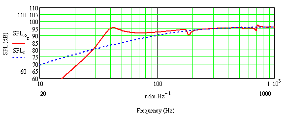

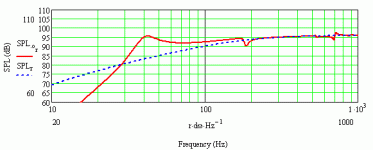

The 10in will work better in a box type cabinet than their smaller units. For e.g., this MLTL: internal dimensions 56in x 13.5in x 10.5in (HxWxD). Zdriver 21in, vent 3in diameter x 1in long. Line the top, back & one side wall from the top 45in down. Brace to suit, and it's a max-flat alignment, so adjust & damp to taste / your own room / system in practice.

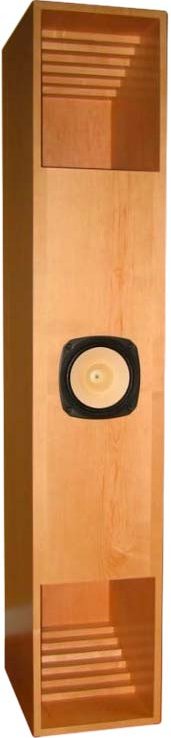

The 206 works nicely in a BLH (as do the 8in ANs actually). Something like Ron's Dallas II / III, the Factory 208ESigma enclosure (works well with the regular 206) or the attached (if you don't mind a big cabinet).
You can make this (and the 8in ANs) work in an MLTL, but they need correction, via a BSC circuit to get the upper-end into line, and a bit of additional series resistance to artificially raise Qe & improve the LF characteristics.
That looks like a lovely plot Scottmoose.
Cheers Jeff. It's not a small box, but bigger is better... 😀 The Super10 is supposed to be the sleeper of the AN range; hopefully I'll get chance to hear a pair some day. The 6.5in & 8in models are pretty good, though not quite as good as their Fostex rivals, and in the UK, aren't really much cheaper, so over here, the latter tends to be the canny choice in those sizes. The new cast frame range might change that though. Be interesting to find out. I think Spectrumaudio are getting some shortly, which will make prices more attractive in Europe.
