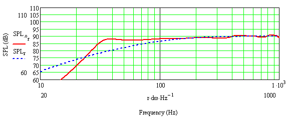

The 10in will work better in a box type cabinet than their smaller units. For e.g., this MLTL: internal dimensions 56in x 13.5in x 10.5in (HxWxD). Zdriver 21in, vent 3in diameter x 1in long. Line the top, back & one side wall from the top 45in down. Brace to suit, and it's a max-flat alignment, so adjust & damp to taste / your own room / system in practice.
I am using MK's worksheet and want to build a MLTL cabinet for the usher 8945, I cannot seem to a get the FR flat like what you did for the AN driver. I have the MK worksheet. Would be able to suggest a starting point for for the correct cabinet size? The detail TS spec is below:
Specifications: *Power handling: 80 watts RMS/90 watts max *SD=150cmcm" *Le: .46 mH *Impedance: 8 ohms *Re: 5.8 ohms *Frequency range: 35-8,000 Hz *Fs: 35 Hz *SPL: 87 dB 2.83V/1m *Vas:34l *Qms: 1.96 *Qes: .366 *Qts: .308 *Xmax: 6.0mm , bl=8.37 n/a,
Surely. Q is a bit low to be ideal for MLTL loading. Doesn't mean you can't use them, just that it takes a bit more work. Therein lies the limitation of MathCAD of course: it's one of the best modelling programmes on the planet, but it can't design a box for you.
Anyway, see what you think of this: 48in x 9in x 7in (HxWxD -you can reverse the second two if you want), Zdriver 17in, vent 2in up from the internal base, 3in diameter x 5in long. Stuff 0.485lbs ft^3 from the top 29in down. Alternatively, line the top, back & one side-wall with 1in acoustic fiberglass down to the bottom. This is the QW equavalent of an EBS alignment which will match well to room-gain in practice.
In practice, I'd suggest at least a couple of window braces. 3/4in baltic birch ply would be my choice for the build material & doubling the front & top panel would reap rewards. If you want to use MDF, you'll need to get the thickness up to at least 1 1/4in to match the stiffness of the ply -easiest is to laminate 1/2in to 3/4in. A BSC circuit will be needed unless you're planning to use them up against a rear-wall or in corners.
Hope that helps?
Scott
