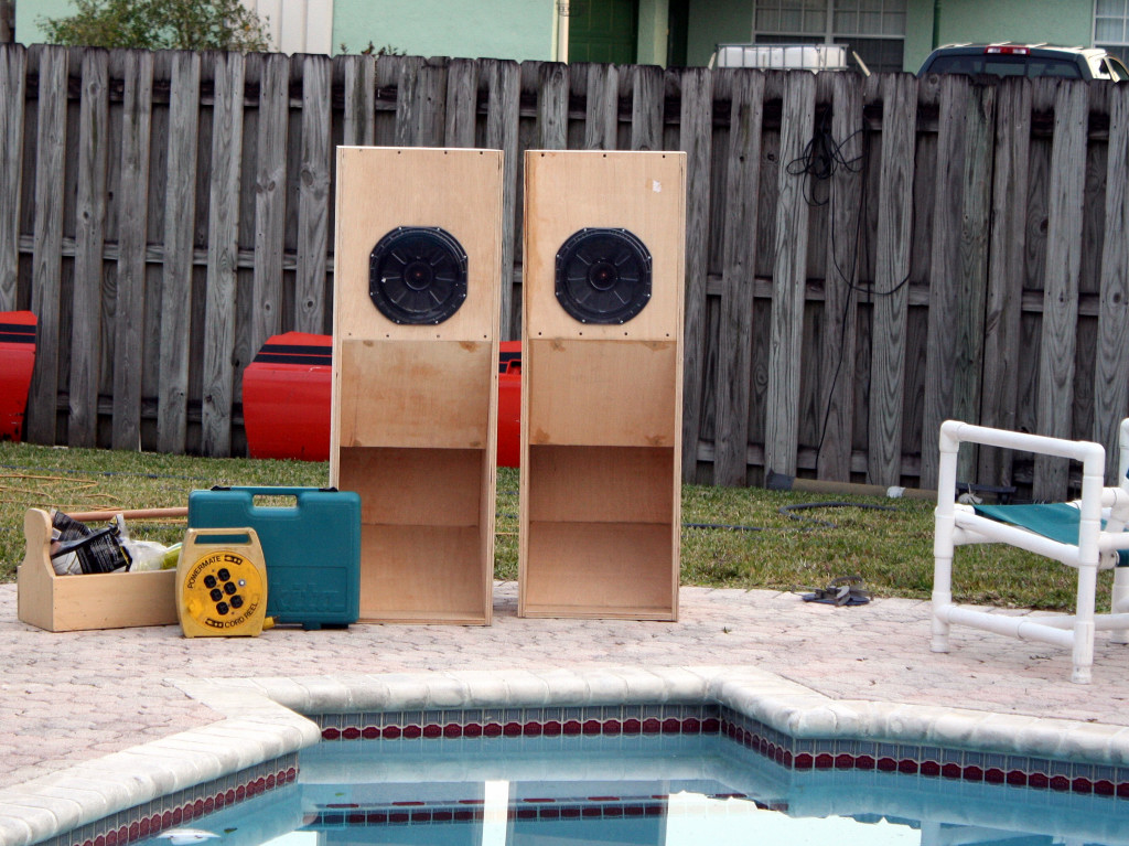

I finished up my EZ10's last night. As of now there is no damping material inside them, and the drivers have about 3 hours on them. These are my first speaker build in 35 years other than stuffing some Hawthorne Silver Iris into a pair of old Zenith console radios. I connected them to a P-P tube amp that makes 125 WPC, which is obviously way more power than needed.
The Silver Iris (claimed 96 db) can do rock concert levels with this amp with wall shaking bass. I was surprised to find that the EZ10's can also get quite loud with about 10 watts of power. The bass is powerful but not well controlled, but that is expected without damping. The realism factor is far better than the Silver Iris but not Lowther quality yet.
These speakers will get fed daily doses of local radio stations for 10 hours a day while I am at work at 3 WPC or so to assist with the break in. Today I left the boombox on a rap station.......

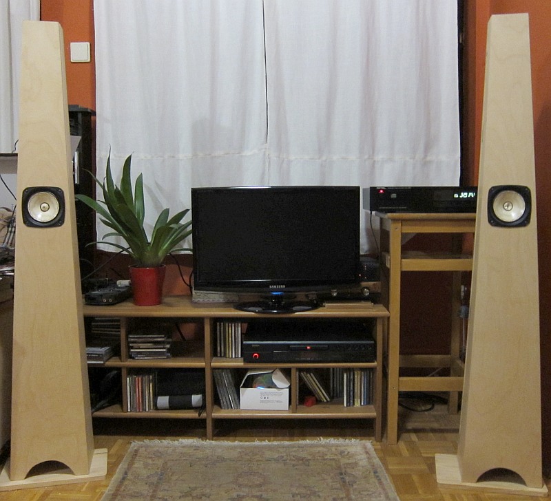

I am still experimenting with damping and fine-tuning on mine. I have solved a number of issues already (such as noise floor) but do not seem to get the damping right. The sound still tends to "stick" to the drivers and does not form a nicely laid-out soundstage (except perhaps for voice). Because of my room size limitations, my speakers cannot be more than 1,5 meters apart, which may be too little. How about your finetuning process?

Good to see you built them! You are the third person I know of to do so. They seem to be well received. Suggestions for damping is all walls in the CC with 1 inch batting or wool, Felt on the mouth of the horn, Felt on the face around the driver to smooth out diffraction and possibly enabling the driver. Let me know what you think of them. Since they seem to be taking off I may do a second iteration of the design once I build a set. Thanks!

The sound seems to have mellowed a bit after 2 weeks of being fed the radio for 10 hours a day. Unfortunately I have had no time to tune them since my mother passed away 2 weeks ago (expected, she was 90) and I have been out of town for the last 2 weekends. The boxes have no stuffing at all, just bare wood, so the bass is rather boomy.
My wife was out of town when these were built. When she saw them she was not impressed, so I haven't decided which room they will live in, but all of my choices are also rather small. I plan to add stuffing until the bass sounds right, then play with room placement for a while before doing anything drastic. I glued the cabinets together with PL premium except for one side. I planned to glue that side once the tuning was done, but there are no rattles even at stupid volume levels so I may not glue them at all. There are about 40 screws in each side.
Speaking of drastic, I got this itch to stuff some Electro Voice 10 inch guitar speakers into these cabinets and plug then into a 200 watt head. I bet it would go past eleven!
I have been building amplifiers for 40+ years, tube and solid state. Any of my speaker projects have been rather crude and oriented toward guitar cabinets or disco boxes. I have been itching to make some good speakers for a while, and due to two favorable trades I recently got some drivers. The AN10's went into these cabinets and so far I like what I hear. I also got some Enabled FE126En's from Planet 10 and the Frugel Horn Mk3's are being built now. It will be interesting to see how the two sets of horns compare. My initial thoughts were to use the FH3's for detailed music at reasonable levels with a small SE amp and the EZ10's for loud rock with bigger bass fed by a big tube amp. So far the EZ10's do that well but sound good at reasonable levels too.
My conclusion:
EZ10/AN10 show great potential. They do very well in dynamics and bass and I hope they can be improved in other areas. Further tuning will involve:
- speaker placement/room acoustics changes,
- damping changes (at this point, no two parallel inside walls are left undamped in the top part of the cabinets - but changes can definitely improve things, I believe),
- EnABL treatment to lower the noise floor and clear micro-level detail,
- bracing - I wonder if putting some bracing between the back of the driver and the back panel of the compression chamber might help.
