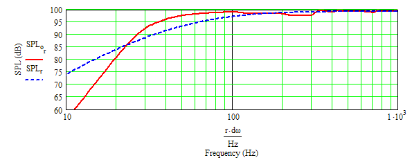

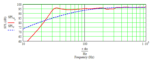

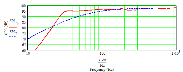

OK, after browsing the CSA site a bit more, the 13.6 with its ~32 Hz tuning still seems a reasonable choice, so unless you're planning on driving them with a really high output impedance amp it's probably not worth it overall going any larger unless the specs are even further off than Freddy's implies.
Anyway, if I'm to believe CSA's description of the Super 10 Vs the cast version, the responses should be ~the same in the 13.6, so using Freddy's Super 10 specs, I get this for a MLTL for a ~:
L = 63.25"
WxD (CSA) = ~371.4"^2
zdriver = 26"
zport = 59"
dport = 8" or rectangular equivalent (~50.266"^2)
Lport = 0.75"
All dims approximate and sims are with minimal wall damping. I recommend the widest practical baffle, so figure a ~1.5x installed driver depth to find cab internal depth to find the internal baffle width. With such a wide baffle, offsetting the driver in a golden ratio of external width is a good plan.
If these aren't big enough, you could always use the worst case specs which results in a pair of 80+ ft^3 net BIBs just to tune them to Fs...........
Note that when I blow up the Cast driver's specs by the same amount as Freddy's, the T/S max flat alignment is right at 13.6 ft^3. A coincidence?
GM
