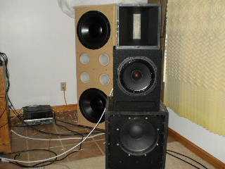

Promising, so far
Fearing for the worse, and hoping for the best... the latter seems to be the trend. They sound clear, detailed and open. Very cursory test, so please take with a grain of salt. A picture is worth a thousand, so let me give it my first try.

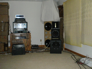

hi Scott L. - cool on your Nirvana - they have a lot of treble extension on axis - one of your amps looks almost like a Citation 12 -- Scottmoose re: "made in China" - does this example count?
Yes Fred, the one on the floor is a Citation12. Actually, it's a mod of the Nelson Pass Mod. One-of-a-kind. I bought 3 such units (stock) from stereo Cost Cutters of Dublin Ohio, more years ago than I can remember. Cr 1980 something. $55 each plus the cost of the complete Nelson Pass modification kit. I used them in my system for years. I was doing verticle bi-amping with 2 of them. The 3rd was a spare, and my buddy Randy decided to play around with the power supply, and who knows what else. I sold the 2 Pass mods and kept this 3rd one. It had been working non stop for years, except just recently had it repaired, albiet just some sort of internal fuse. Very, very good sounding amp, even by today's standards.
As far as the SuperCast 10 goes, when time permits, I am going to try another box I'll build myself. The one it's in now is just a temporary deal, bought at a close out price strictly for the convenience.
