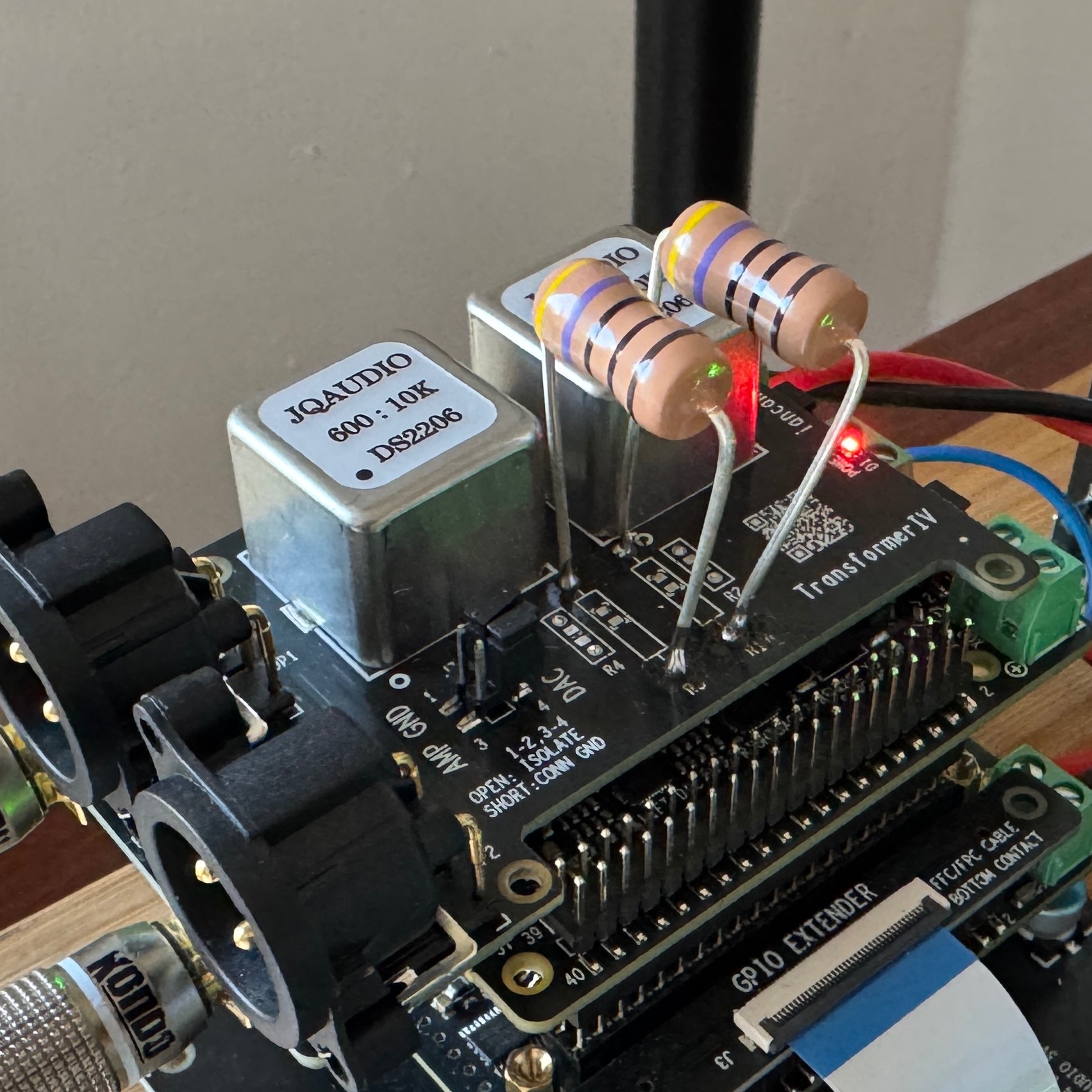

Originals values are 511 Ohms. Lower value means less output volume but, I believe, easier impedance to drive for the dac current output.
So I have tested : Vishay Metal film Charcroft Z-Foil resistors 510 Ohms and Audionote silver robium 470 ohms 2W (my preferred). Both are available at Hifi Collective. The Vishay seems to be more precise and the AN seems to me more musical. It's a kind of compromise.

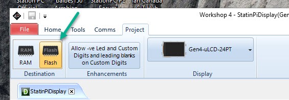

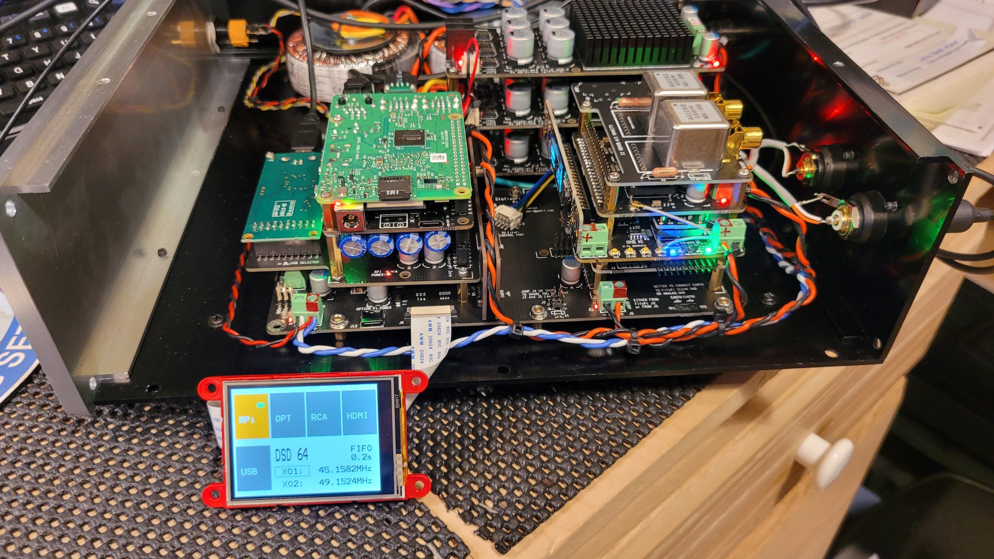

I guess I'm having a conversation with myself! 🙂 Anyway, it's funny how one small detail makes all the difference in something working or not. On the Project tab of the 4D IDE the destination must be set to Flash not RAM. I knew there must be someplace to perform the flash. Once I found it and changed it from the default of RAM, everything made sense and it worked. Touch screen works and I've got it displaying controller information too. Here's an image of my rebuilt-stack. I still need to bring a USB jack out to the back panel. Then I'll have all the inputs I use available. Of course, I have to mount the screen on the front panel as well and put the finishing touches on everything.
View attachment 1076487 View attachment 1076489
How did you get the clock speed to show, mine just has the button select, no lower right information.

I assume you mean these?
https://www.hificollective.co.uk/catalog/470r-2w-audio-note-silver-niobium-resistor.html
That's quite the price for a couple of resistors! I'll have to see if I can find that in the states, I 'm guessing you'd say it's worth it?
That’s it. Well, I found it expensive too (and you need to add shipping and customs fees) but compared to the whole project it is still acceptable. And it worth it.
You need to know that you have to solder it in on the surface as the original hole is too small. So take care of having the solder connecting the top and the bottom of each hole.
(Yes this is a bit ridiculous to have such big resistors, but I compared 0.5W version and 2W version… and 2W are better. Believe me or not…)
