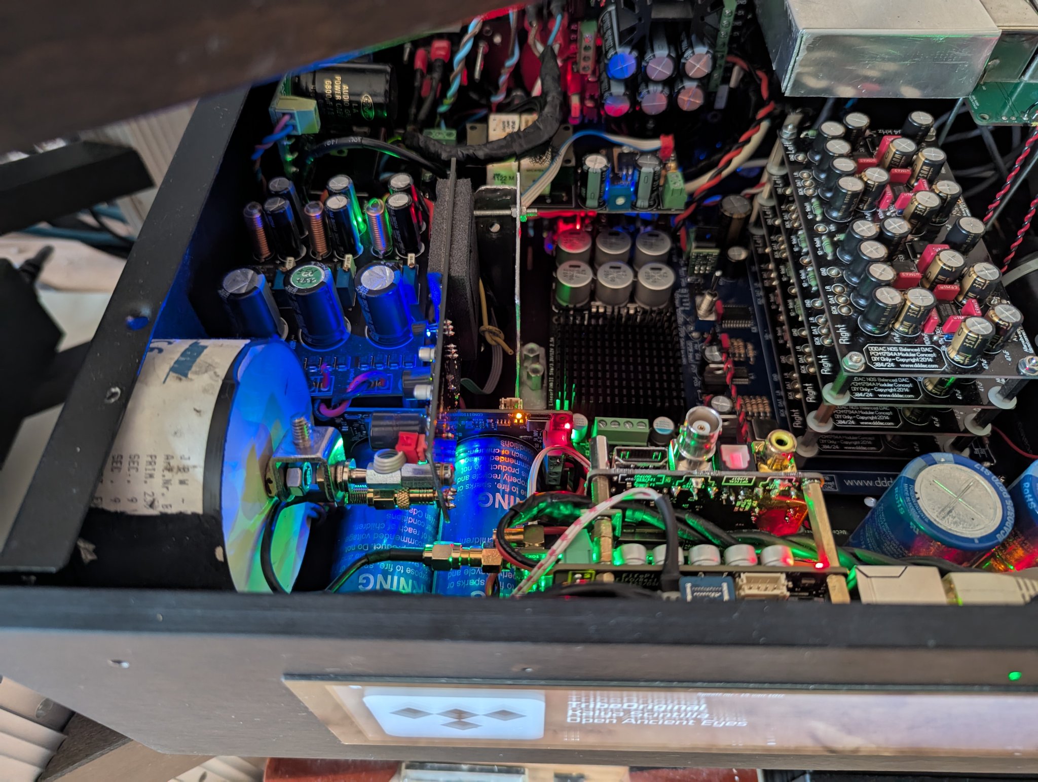

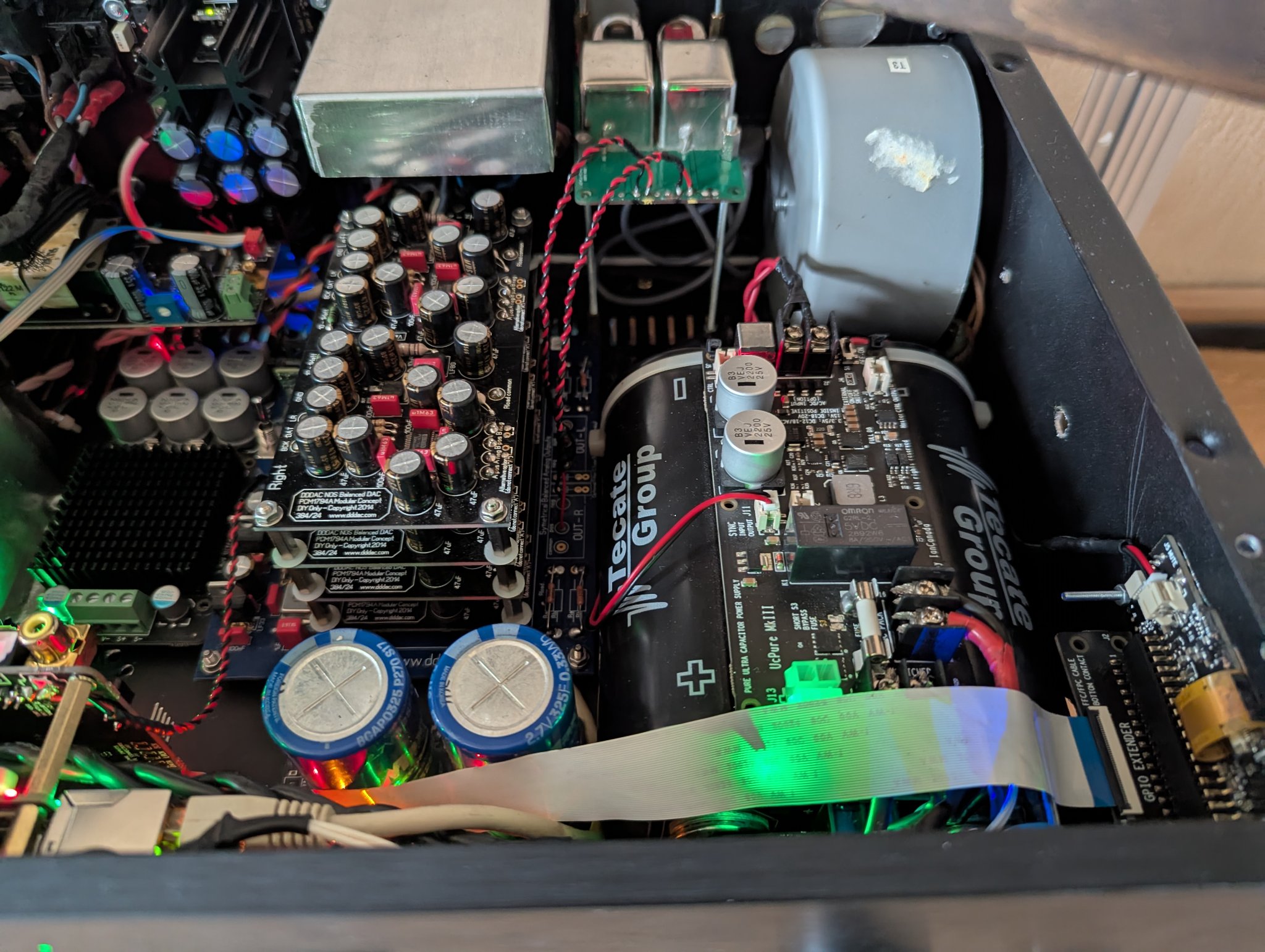

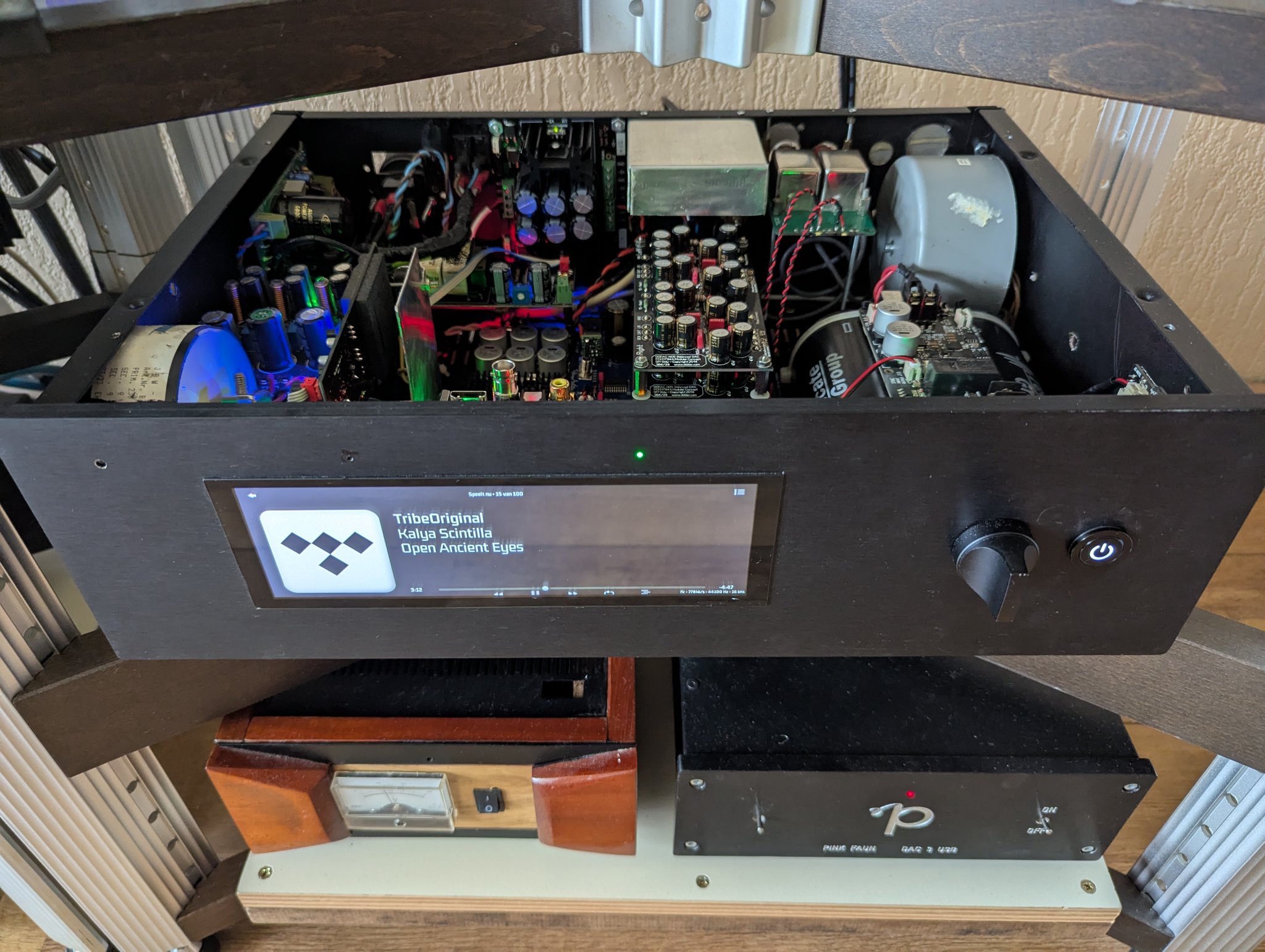

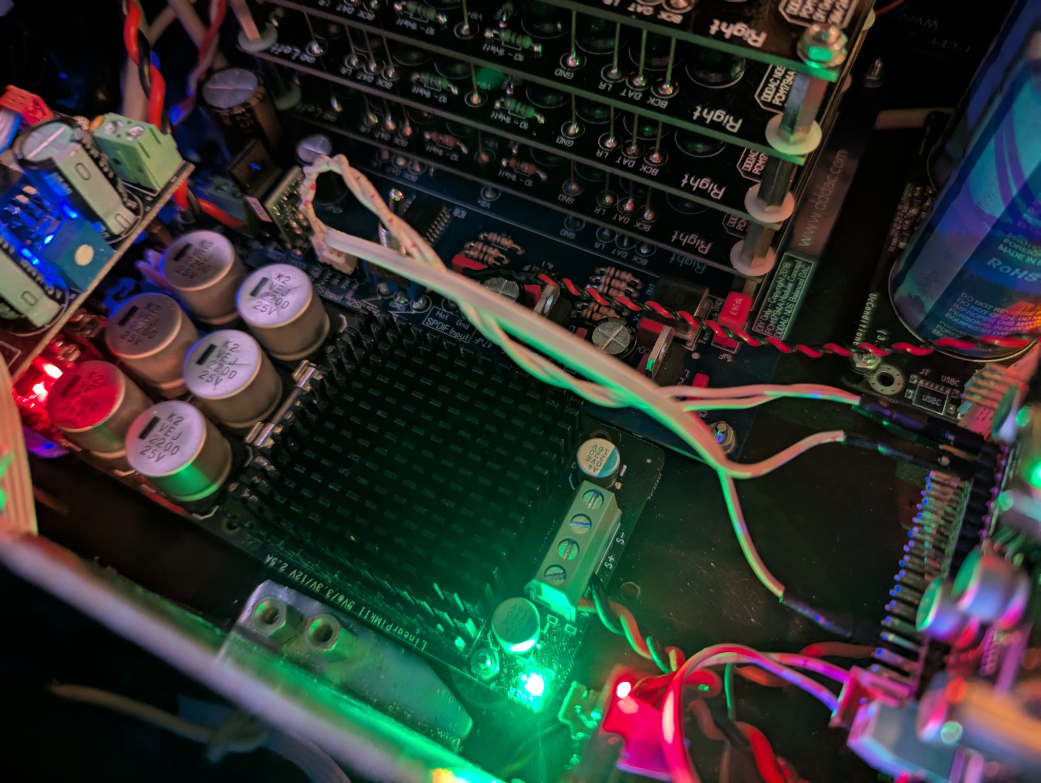

Dddac mk2 4 deck combined with ian Canada products plus an external clock. used a FifoPiQ7ll and transport pi mk2.
only a 3.3v shunt regulator needs to be added to the input Transport pi mk2.
also ordered better cables which I hope to receive tomorrow. sounds very nice.
There is also a simple toslink to spdif coax converter in it, maybe I will replace it with a receiver pi DDC ll.

Why not feeding the DDDAC with I2S? I think in your setup, by using the SPDIF input at DDDAC, the Tentclock on the DDDAC board is involved and will be the last instance which "reclocks" the digital signal!? I could imagine, that your nice clock / FifoPi combo in front of the DDDAC does not have a big impact then!??

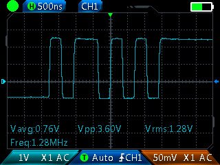

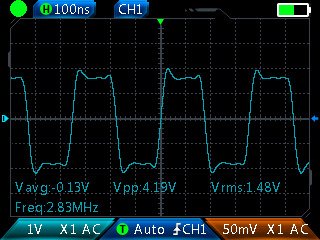

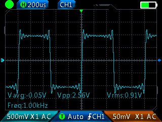

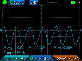

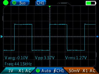

I have FifoPiMa connected directly to PRI4 (dtoverlay=hifiberry-dacplus)
When played and measured square 1khz at the DAC output, I noticed a ringing like this:
After that, I measured other i2s signals and noticed similar for BCLK(SCK)
Also tried without DAC connected measuring at GPIO18 (pulled down with 10k), but looks the same.
Am I doing something wrong or this is normal BCLK signal but dac out ringing coming from somewhere else?
Other i2s signals looks fine I think:
MCLK:
LRCK:
Data:

in the meantime a direct i2s connection has been made. it sounds very different now. first listen like this for a while to get an idea of what sounds better now.
MCLK:
LRCK:
Data:
have you check your oscilloscope probes and terminated the dac output by connecting it to something, like a preamp, and i think your MCLK signal should be a square wave maybe the probes again, not an engineer so those are just my thoughts, and you oscilloscope should have at least a 30mhz bandwidth
MCLK:
LRCK:
Data:
Good day,
Square (pre and post ringing) at your DAC output is typical for OS DAC with digital filtering.
For better BCLK square try increasing the series resistance at BCLK at the output of the reclocker.
Nice day
Tnx for the info I will try that, just not sure where to put that resistor as FifoPiMa is connected to RPI by GPIO header directly. Should it go btw Fifo and RPI or from Fifo to DAC?
Good to know, after you mentioned it, I was able to find some references ... https://www.diyaudio.com/community/threads/cd-square-wave-pre-ringing-a-filter-problem.6901/
