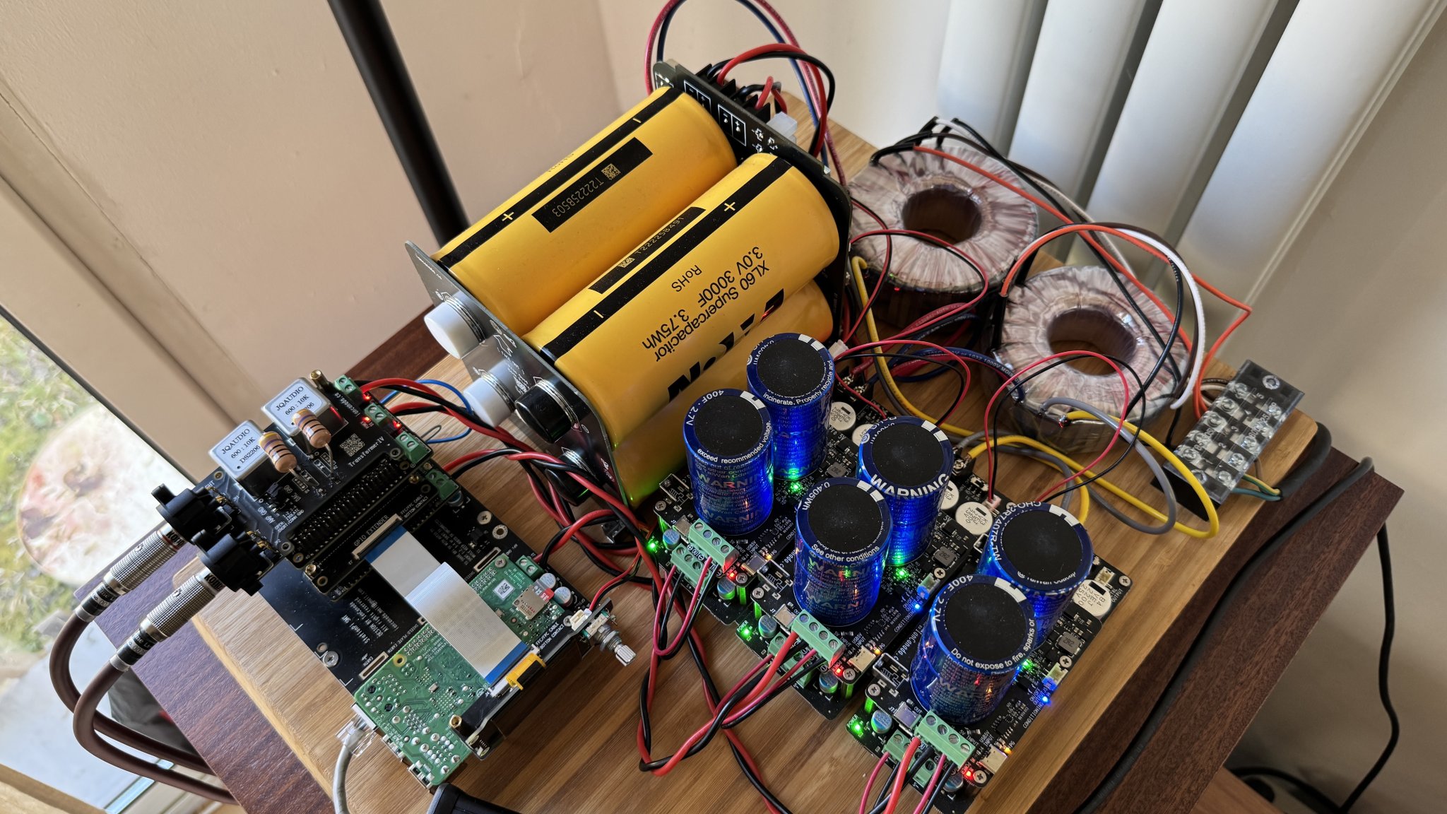

I have built a Iancanada full streamer/dac.
So far I have built it using :
  • Station pi with separated +5V for pi and audio section
  • Raspberry pi 4B
  • FifoPiPro Q7 II with SC Pure clocks and PiMonitorPro
  • Dac ES9038Q2M with MCLK connected to FifoPi
  • I/V transformers board with upgraded resistors.
Power supply is :
  • UcPure Quad for 3.3V
  • LinearPi + UcConditionner for 5V
I am now wondering what would be the next steps to improve further.
As I want to keep RCA outputs, I’ll invest in nice i/v transformers.
Could you guide me on how to move forward with this DAC and help pinpoint what really makes an impact? I don’t want to waste time in useless improvements, but I am willing to do very well what could be good ones.
Here’s a list of ideas—which ones do you think are the most worthwhile? Can you help me to prioritize ?
Any help would be really appreciate ! Thanks a lot!
A - Supply the Dac ES9038Q2M board with separated powers. I power it from UcPure today. If so, which inputs are important to separate from J2 ? AVCC ? VCCA ? None ? Both ?
B - Supply the Rpi and the audio section of the PiStation with different +5V (Done and I like it)
C - On UcPure, following some Ian ideas from his blog : remove fuse, direct wiring and other hacks to power FifoPi and the Dac board
D - Shield the toroidals transformers
E - Shield the raspberry pi or put it away thanks to a gpio extension cable, or both
F - Add a copper plate between each module (fifopi, dac...) and ground it
G - Wire analog ground from fifopi to the dedicated pinpad on the stationpi
H - Wire analog ground to the earth of the wall socket
I - Other improvements ?

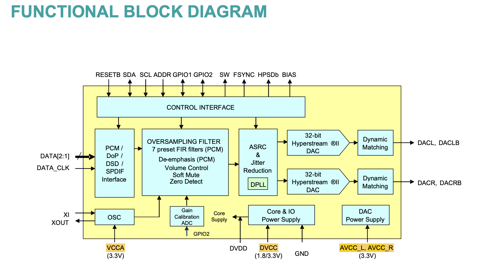

I have both inputs equipped with 3.3v shunt regulators and as close to the input as possible.
I have used Tentlabs shunt regulators for this, of course you can also use another brand.

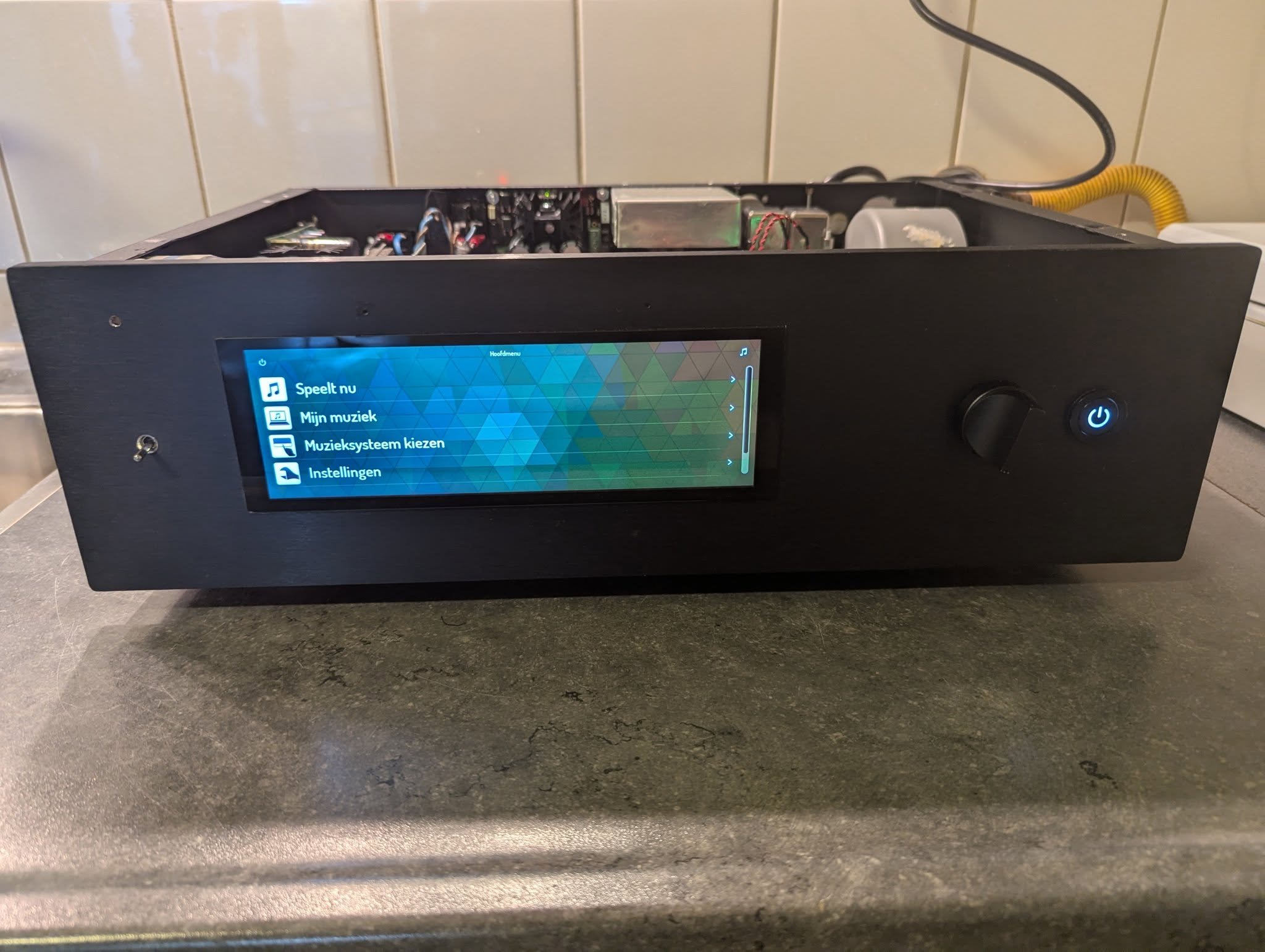

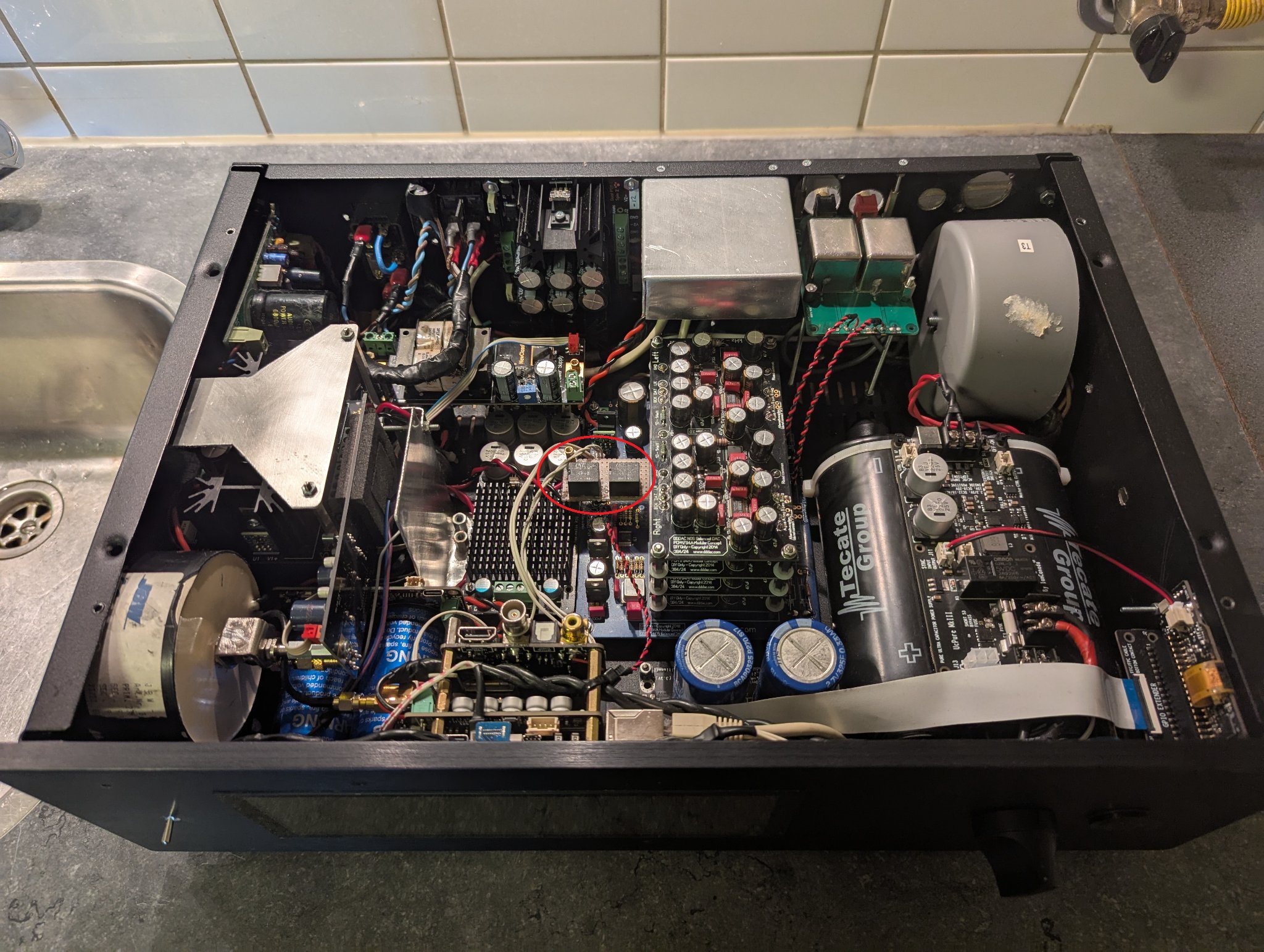

made a switch with relay for switching between i2s and spdif.
i hope to get a ian canada Adapter U.FL I2S for DAC DDDAC Module, ufl cables and a reclockPi next week.
So you have prefered to remove the jumpers on the board to disable the 3.3v distribution from J2 and feed through shunt regulators each input, right ?
What is your input on the shunt regulators ? Is it the same power supply shared across the shunt regulators ?
