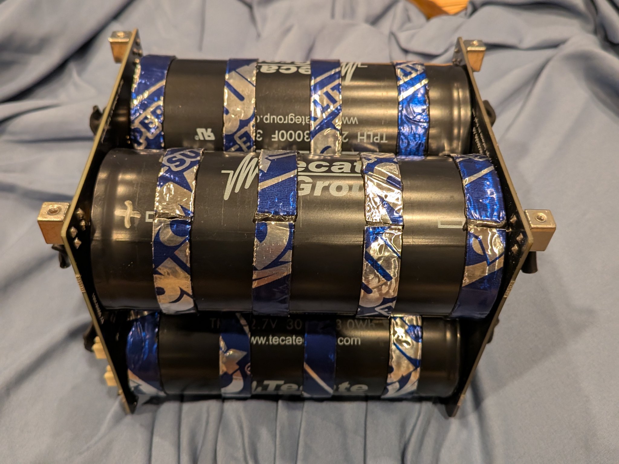

@Greg Stewart - Sounds very interesting about damping the UC's to sound their best. Any possibility to get some pictures showing your setup and how the damping looks like ?

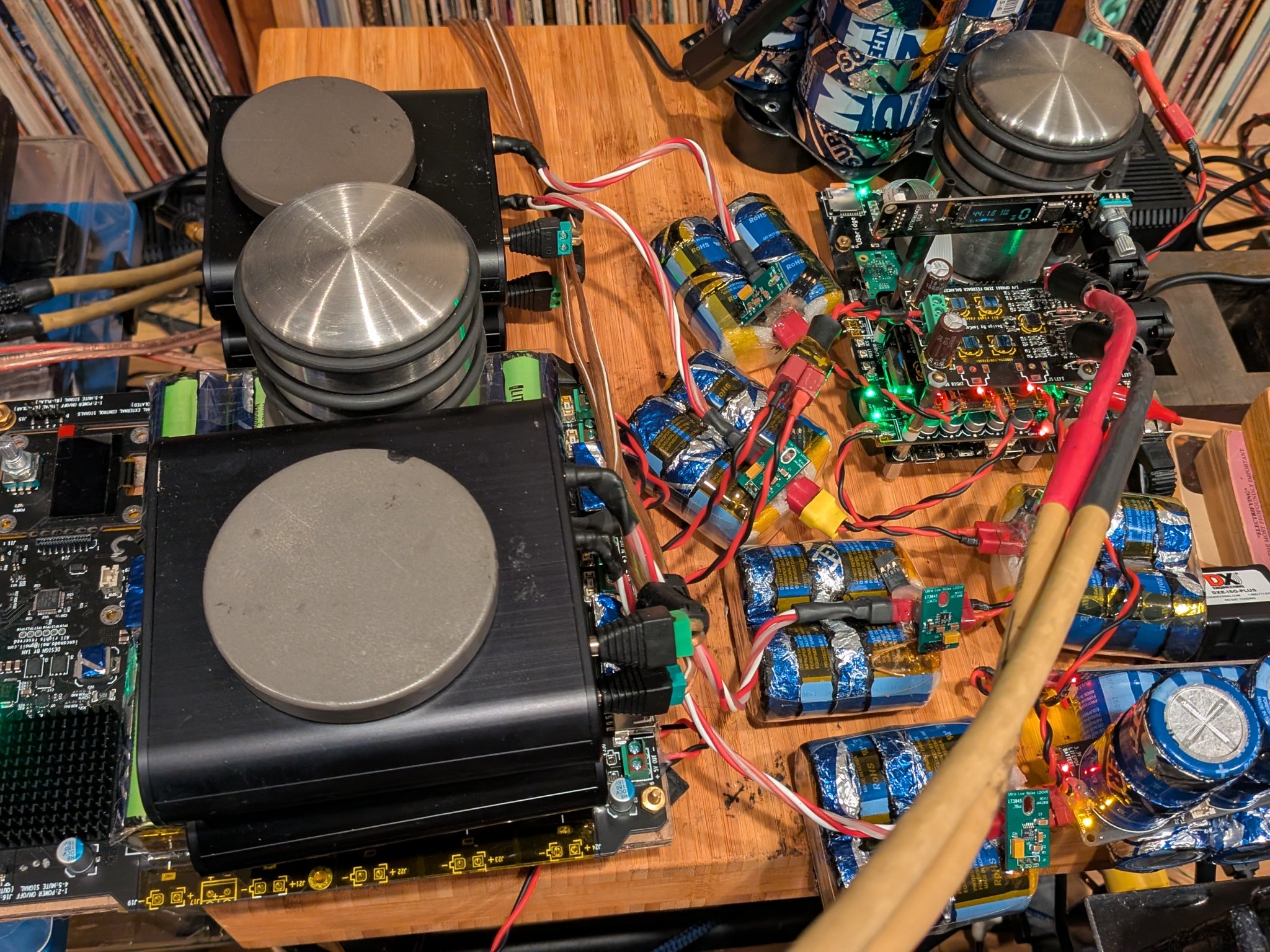

@HankRevo, attached are.pictures of:
- Damped Tecate UCs in a UCQuad
- My main Ian Stack with a FifoPi & DM DAC on an Allo.com USBridge Signature & Ian's OPA861 IV stage. The USBridge Sig is powered by a UCQuad with original Maxwell UCs. The FiFoPi & 3 rails of the DM DAC are powered by Uptone Audio LPS-1.2s with each feeding 325F Maxwell UC buffers, 4 in parallel for the FiFoPi. The OPA861 iV is powered by the 3.3v rails of Ian's LiFePO4 battery board configured as +-3.3V.

& my oops, I said 3 wraps, really 4 wraps.
I was an early adopter of UCs & tried them with Ian's early, very rudimentary UC board. I have tried UCs from four different manufacturers & a number of various p/n's. Not all sound good, BTW.
I went on to assemble my own UC pairs that I energized with various raw power supplies. Based on my DIY experiences over the years, I damped the UCs as a matter of course & never compared them damped vs raw. The smaller UC pairs in that setup pix are those.
When I 1st tried Ian's UCPure & UCQuad boards I orginally didn't damp.the UCs. My initial comparisons between the Eaton & Tecate UCs in this state had the Tecates on top.
After damping the Eatons were.clear winners, that is how much the sonics changed.
Try it, I bet you'll like it!

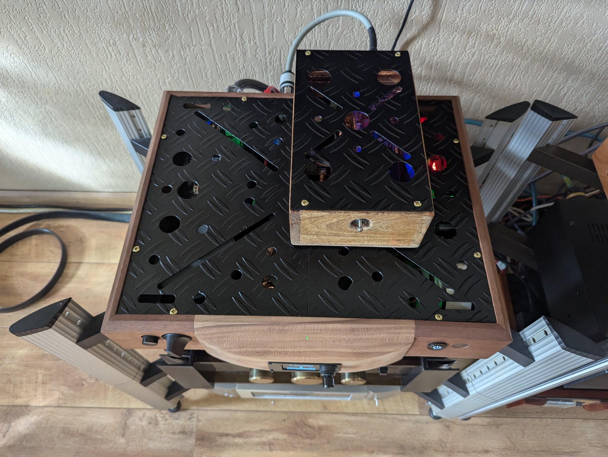

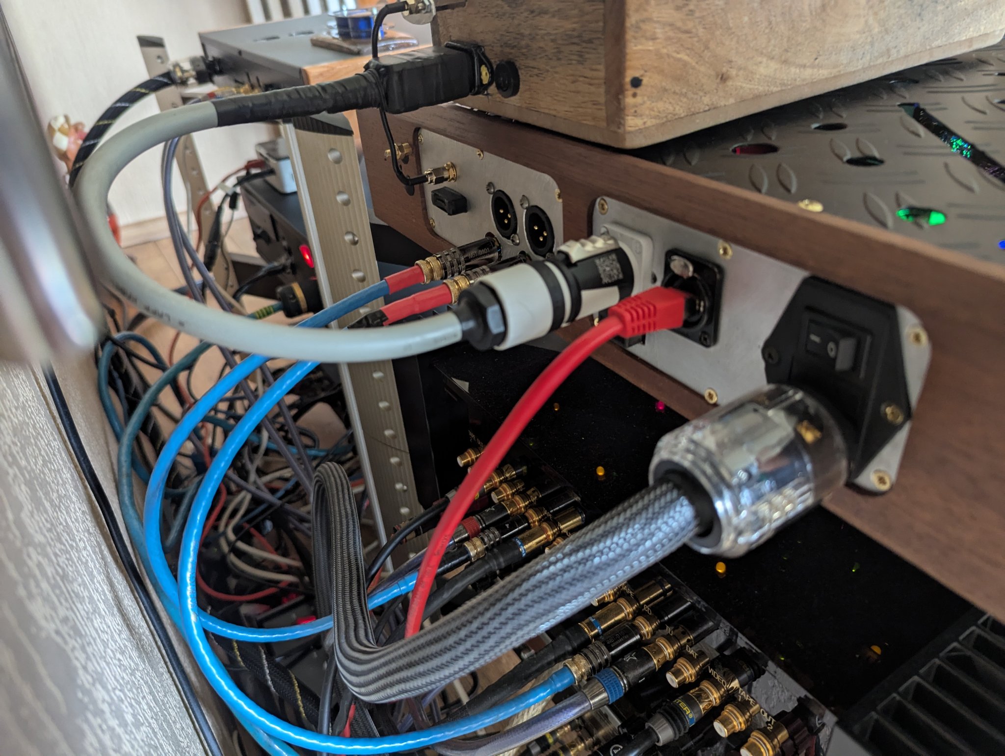

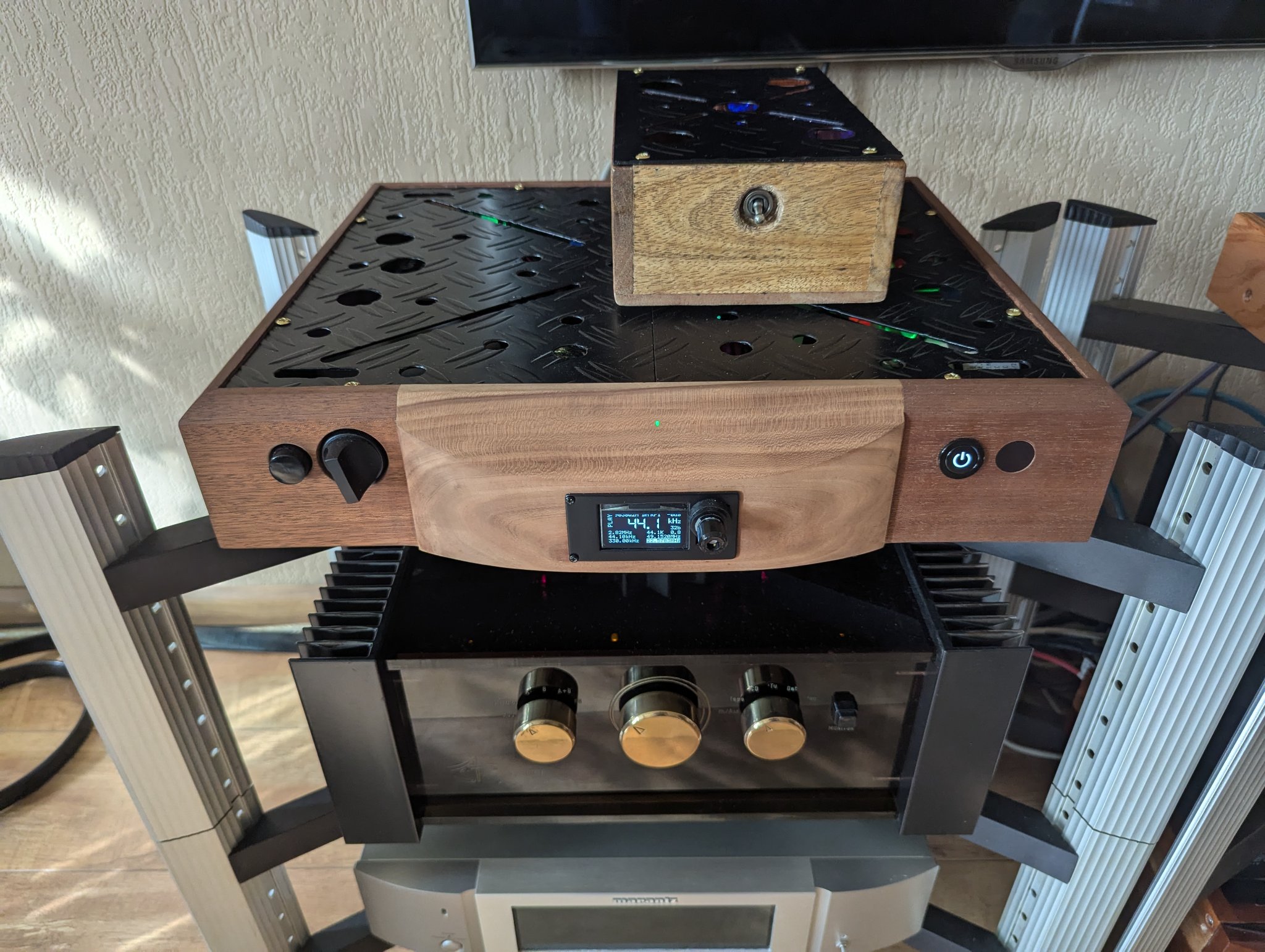

I made a suitable cap and neutrik powecon connector with shielded cable for the 230v input external neutron star clock.
Now I just have to install a pair of Elna Silmic Eelcos with the correct value for the shunt 3.3v regulator input Dual Mono ll DAC.
