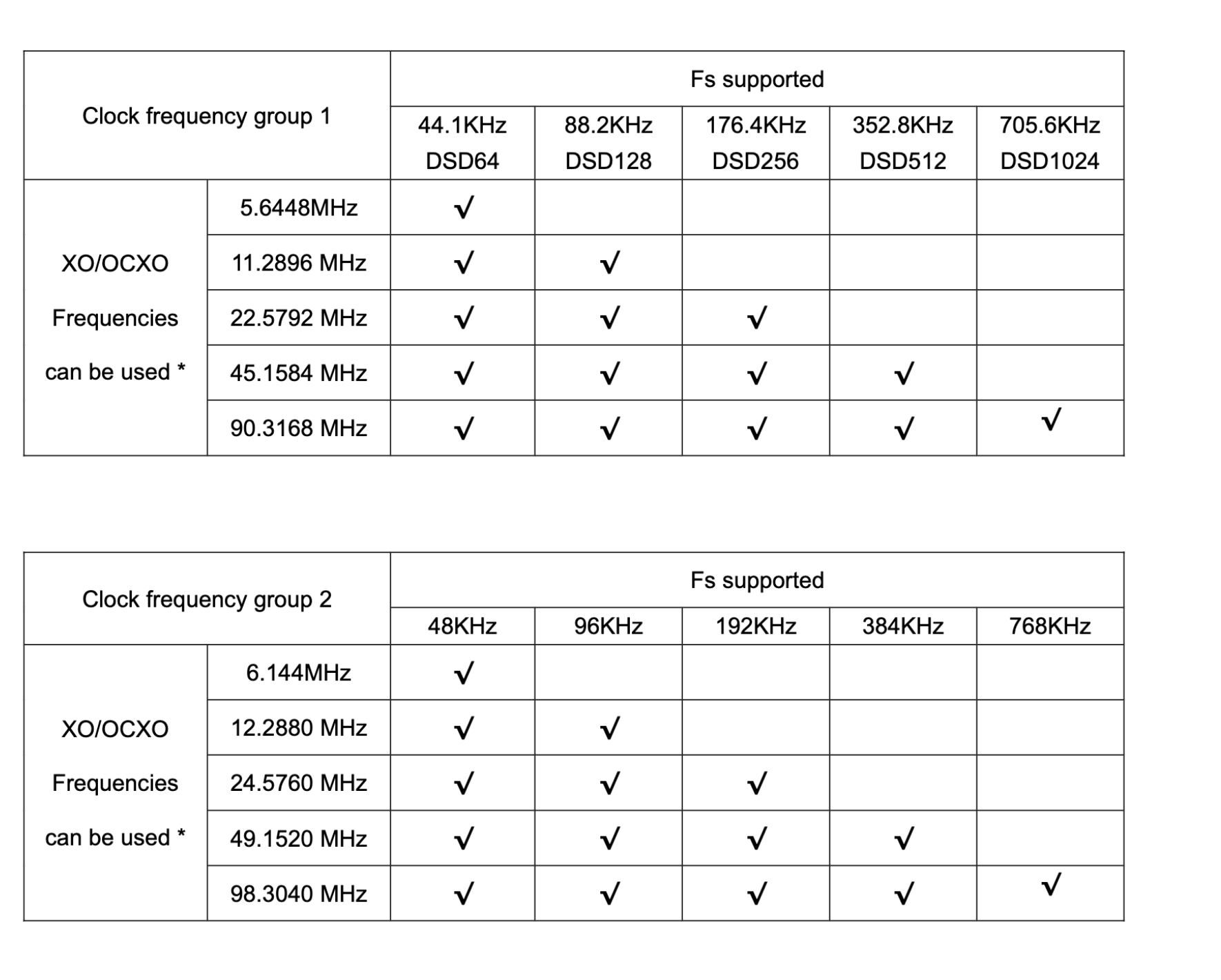

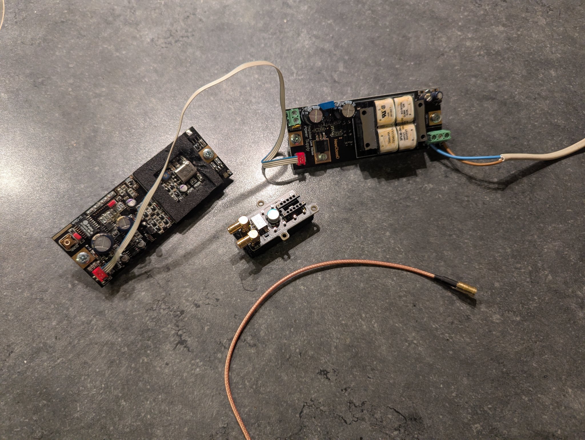

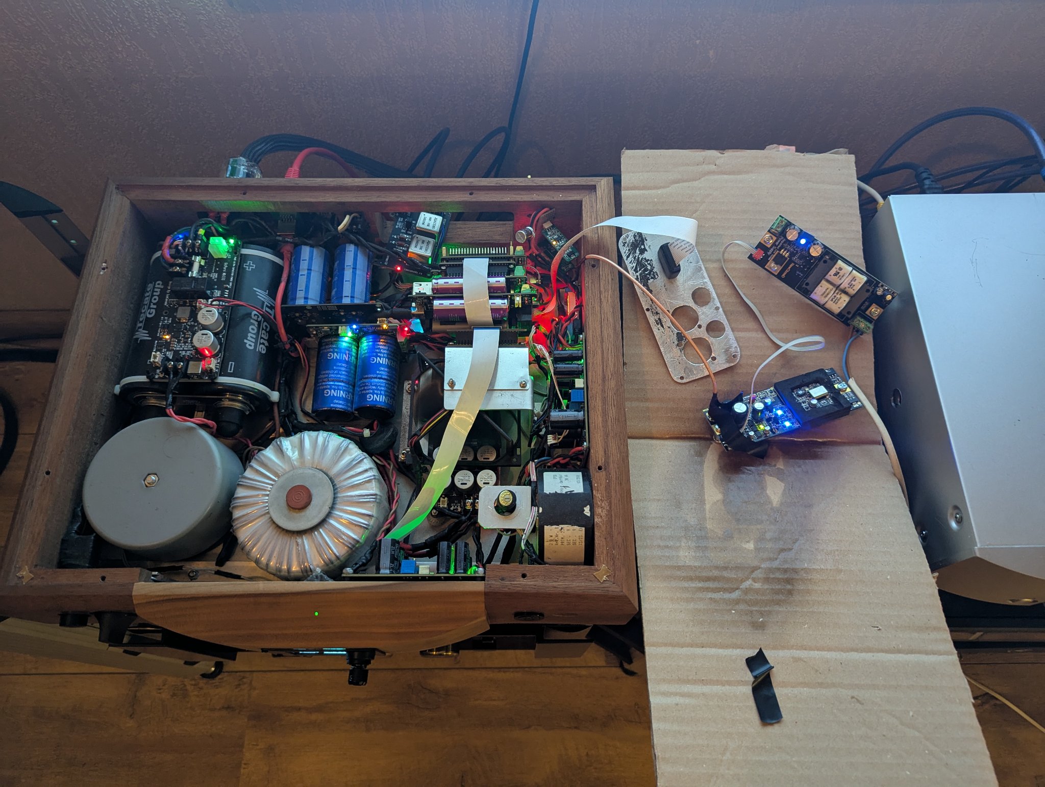

I bought a second-hand Neutron Star 2 reclocker and Ian Canada SinePi.
I want to make this work via the Q7ll with the ES9038Q2M Dual Mono II dac on top.
Now this DAC can work between 22.5792MHz to 98.3040MHz.
Now I want to take one of 45 MHz, where and which one is best to take or do I have to take other specifications into account?
now it has one of 8.467200 MHz.
thanks.
