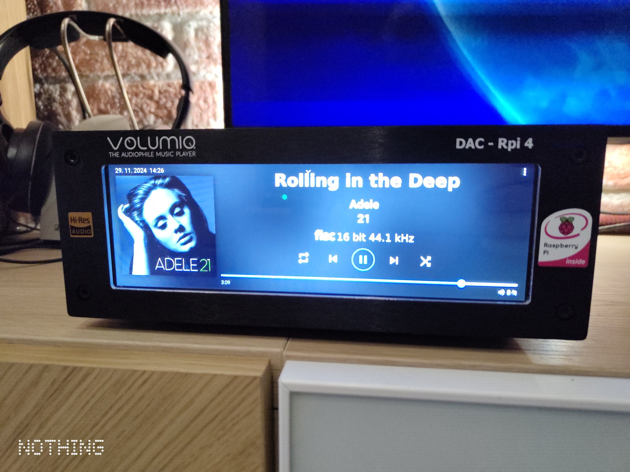

I recently finished my first raspberry audio player with sw Volumio.

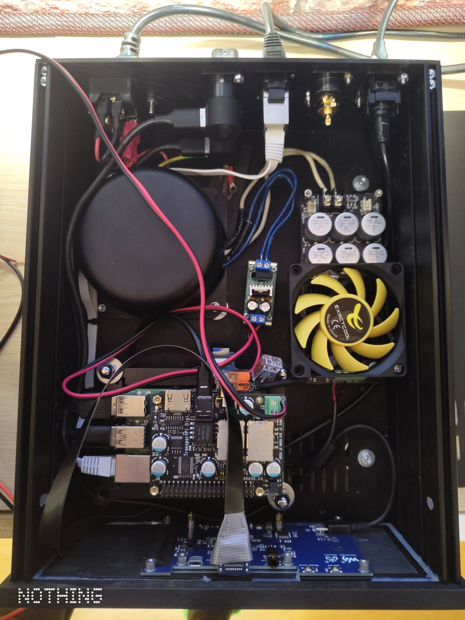

- Rpi4 4GB RAM
- IAN CANADA UCPI Universal Ultra-Capacitive Power Supply Board for Raspberry Pi
- Power: Toroidal Transformer 2x 9V 5.5A
- Power supply so far with one branch from IAN Canada 5V
- LCD Display: 7.9-inch capacitive touch LCD display, 400×1280 LCD Waveshare
- Custom-made aluminum box CNC milling and screen printing. ModuSchop

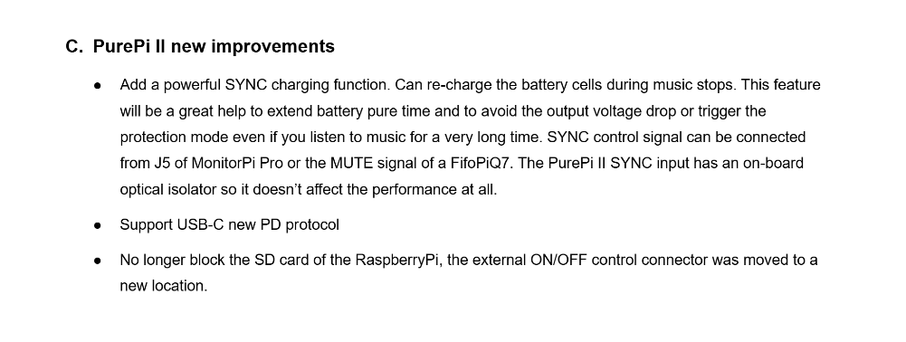

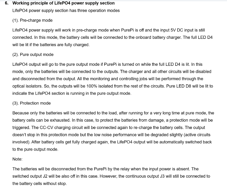

.... and now I hear it clicking again. Please if anyone has an understanding how this function works share it with me, I would love to understand what is going on.
that clicking is a relay.
As soon as no music is played, the Pure output LED turns off and starts charging. As soon as the music starts again, the Pure LED turns on and stops charging. he will also charge it for a moment with the next number. it's all in the manual too.
When playing for a long time when it is almost empty, the pure output LED turns off and as soon as it is charged again (orange LED) the Pure output LED turns on again.
Thanks a lot for the answer! Usually I power everything off for the night but this time I will leave the streamer on so it can charge everything fully and I will see how it behaves tomorrow. Right now charged and pure are both off.
you can read everything in the manual.
https://github.com/iancanada/Docume...aCapacitorPowerSupply/PurePi/PurePiManual.pdf
Thank you again for taking the time to collect these. My assumption is at the moment that clicking might happen when switching from pure output mode to protection mode. When the battery power is lower, it will run on protection mode continuously, and no clicking. Hopefully will be able to reproduce it tomorrow. As I listen to music continuously almost when working from home I wonder how long it will take to drain the batteries enough to go into protection mode. I will try to measure that also.
I think I was right in my assumption: whenever the pure led goes on or off the click comes. Although when there is not enough charge in the batteries for pure I suppose the system is working in protection mode continuously, so no clicking when going to mute or coming out of it. There is an interesting trend in the current consumed: right now playback is going on in pure mode, the system takes 0.52 A at 5V. If I stop playback, click comes, pure led goes off and the current consumption goes up to around 1.2 A. (These are not calibrated numbers, I use my hand built linear PSU to feed the PurePi II, and that has a simple current and voltage meter in the output line, so no calibrated numbers but the magnitudes are still interesting). When it was doing playback without the pure led on, it was consuming roughly 0.6 A regardless of playing music or not. That was kind of surprising that even when not having enough juice for pure mode when mute was initiated the high current charging did not kick in. After a while consumption drops down to 0.67 A and the charged battery led comes on.
So the only question remaining in my head: when playback is happening without the pure led on, why power consumption does not jump up for charging when the music is topped? Would be very interesting to know.

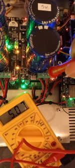

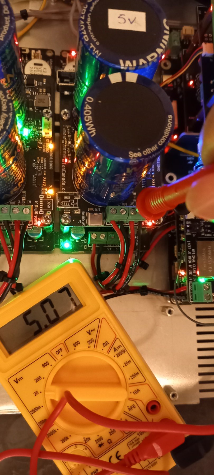

I'm using UcConditioner Pro 5V for 2 months approx with great result feeding topping E30 Dac. Today, after 2 weeks absence for some holidays I switched on again and after a while the 4 usual leds lit on, plus a fifth led : D6, wich is overvoltage above 2.7V on one cap !!! UcConditionner is fed by Ian's LinearPi MkII
I measured incomming voltage from linearPi, and output voltage from UcConditioner : same 5.07V. Then I removed the UcConditionner from my setup and mesures voltages cap1 : 2.85V, cap2 :2.04V. There is indeed a problem.
Is there something I can do, or is the UcConditioner definitively defective ?
Update : with adequate resistor I discharge one cap to bring it to same level than second cap. This brought the system to normal condition again. But certainly this will happen again after long switch off.

Just to share my own experience. I initially purchased one 5V UcConditioner. I fed it with 5.07V from LinearPi MkII, D6 led was on for a long time. Please see below a photo, I sent to audiophonics while I was experiencing the issue with the 5V UcConditioner.
Audiophonics assured me that so long as the input is not more than 5.3V there is no problem. I decided to allow some grace period. After about a week of use, which was adequate for the UcConditioner to break in, D6 led went off.
Afterwards, I purchased another two 5V UcConditioners. There was the same problem. When I let them break in their leds also went off.
From my experience, I would advise you to leave it for some it and see, so long as you do not feed it with more than 5.3V.

Thank you for sharing your experience ! I indeed noticed again this morning same problem, and a breaf and weak D6 led blinking on another UcConditioner (I have 3 in total) that led me thinking it's may be not a defective unit but something there by design. The annoying thing is I measured 2.85V wich is exacte overvoltage limit for this ultracapacitor. Was certainly a bit higher because it took me some time to remove it and measure.

I had this on one of my UCConditioners and emailed to Ian about it.
I am using LinearPi II's, and he said it should be no problem and that after a few runs D6 will go back to normal.
Mine did do that.
Also asked him to further describe D3 and D6 in the manual, instead of that they are to indicate overvolting without any further information.
But I didn't receive an answer to that.
