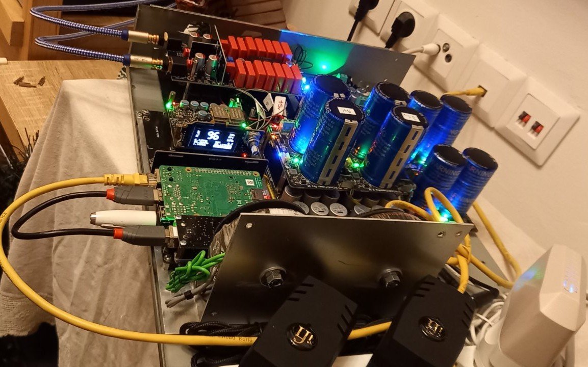

hi @pkonstantinidis,
The DAC is ready. Yesterday, music signal flowed through its RCA outputs. For the moment, I am not in position to comment on sound since I ‘ve just heard it through some low cost headphones only for testing purposes. I also tested it with an non A chip in order to avoid the risk of flying my precious. Now that I know that there is no short circuit, I will use my precious TDA1541A taken from a Proton CD player.
Some comments to help friends that currently building the TDA1541A DAC.
  1. The guidance provided by @Gabster 2000 is indeed helpful and sufficient. If you just follow instructions from @Gabster 2000 YouTube channel you will not have any further queries.
  2. Soldering particularly U.FLs and LEDs (provided in 3.3 version) is really challenging. I am not experienced in that, and I received valuable help from a friend (professional of the field) while most of soldering work was undertaken on his bench.
  3. Speaking about LEDs, please be careful to solder them on with the right orientation, since they operate as diodes.
  4. On the I2S to PCM board do not forget to put ONLY one jumper on JOB on it. At the same time, be careful with the setup jumpers at the back of the TDA board.
  5. Further from soldering U.FLs, carefully connect the U.FL cables on the boards. The first time, I connected the TDA, it produced a white noise output. I was afraid that I fried the TDA. I initially removed the I2S to PCM board to see if the TDA would play if connected directly with FIFO PI. But, when I connected FIFO PI with TDA, I forgot to change the setup on the back of the board (fortunately, this did not cause any malfunction). So I did it, I proceeded with the DC offset and music came out. The TDA was working properly. On a second step, I used again the I2S to PCM board. I made sure the all U.FLs were properly connected, I changed the setup on the back of the TDA board. At last, all equipment was working properly!
Final point, I have in my collection many high res files (96kHz and 192kHz, 16bit and 24bit). All were reproduced from the TDA1541 (non-A chip) without any problem. To that end, I see no need to down sample the files.
I will hear on my speaker system the TDA with the non A chip and then with the TDA1541A chip and revert with comments.

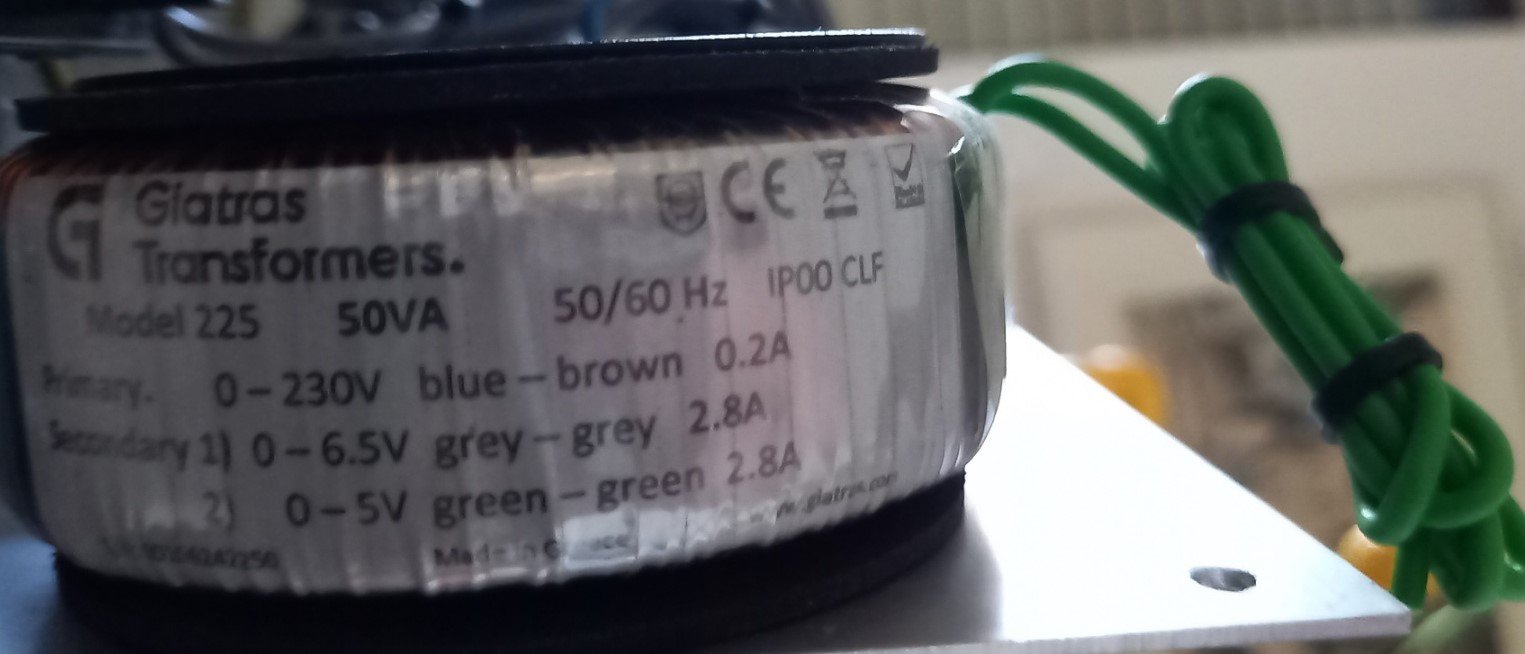

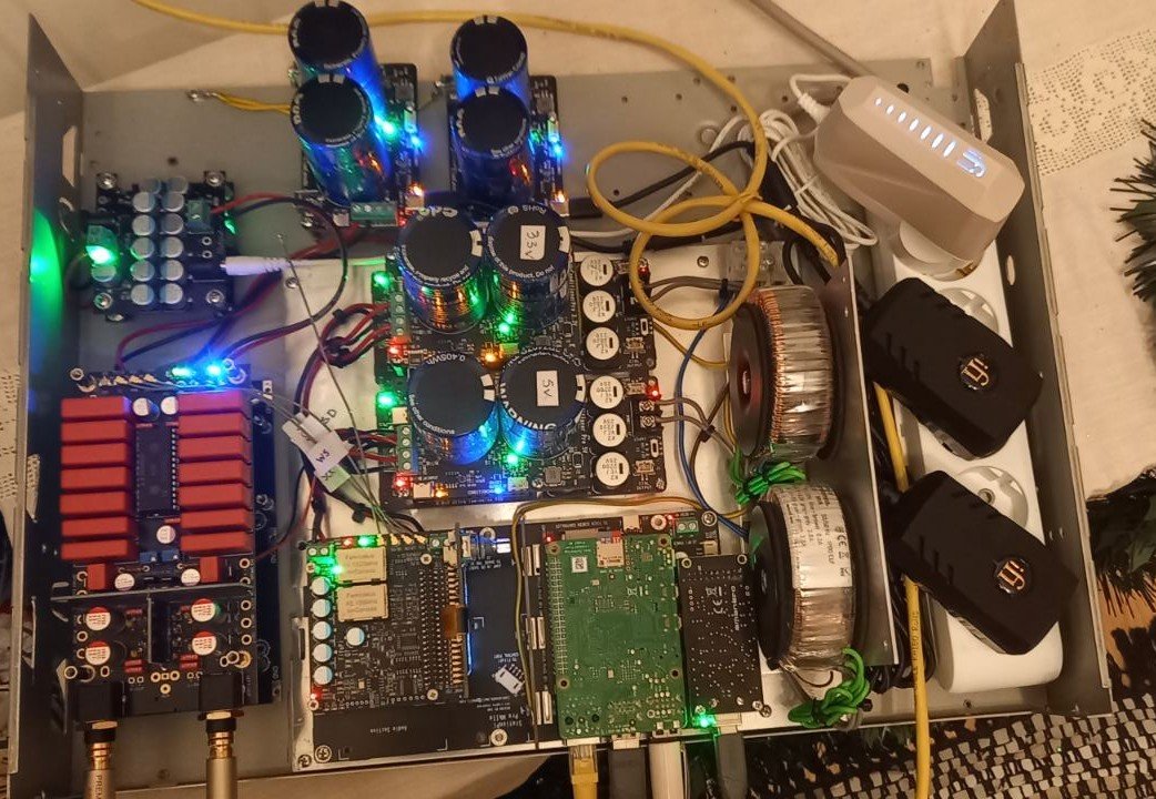

@TheodorM
could you please share those used toroidal transformers detailed specs and links please.
White ifi adapter - which config you picked? 9V/2.5A 12V/2A 15V/1.5A ? Black ifi must be 2.5A models.
Also when you get time a rough connectivity diagram will help a lot. Please. Thanks in advance.
Reactions: TommySA
Hi @VMRKarnati ,
The streamer part has two power supplies:
-5V power supply: is the toroid seen in the picture (same as @pkonstantinidis – see pic) using its 6.5V winding -> 5V IAN CANADA LINEARPI MKII ->5V IAN CANADA UCCONDITIONER PRO feeding (1) the 5V side of IAN CANADA STATIONPI PRO plus (2) the Ian Canada I2S to PCM board.
-3.3 V power supply: is the toroid seen in the picture (same as @pkonstantinidis – see pic) using its 6.5V winding -> 3.3V IAN CANADA LINEARPI MKII ->3.3V IAN CANADA UCCONDITIONER PRO feeding the IAN CANADA FIFOPI Q7 II
The TDA part (excl the Ian Canada I2S to PCM board see above):
-2X [ IFI iPower2 5V/2.5A -> 5V IAN CANADA UCCONDITIONER PRO] feeding the TDA -5V/0/+5V output stage
-IFI iPowerX 15V/1.5A -> 2X in raw CRC Filters (proposed by Gabster) feeding the TDA DAC part.
Hope this helps.

Hi @VMRKarnati ,
Hope this helps.
Thanks a lot TheodorM for this detailed info. this helps a lot. much appreciated for your help and support!!!
