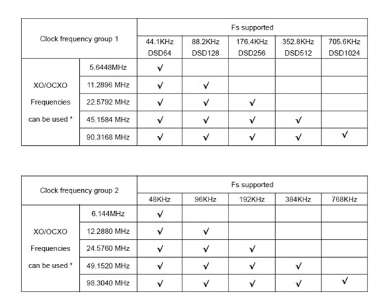

Hi @eMiL6789,
That is correct. please see the attached table from Ian's manual which presents the limitations of each clock.

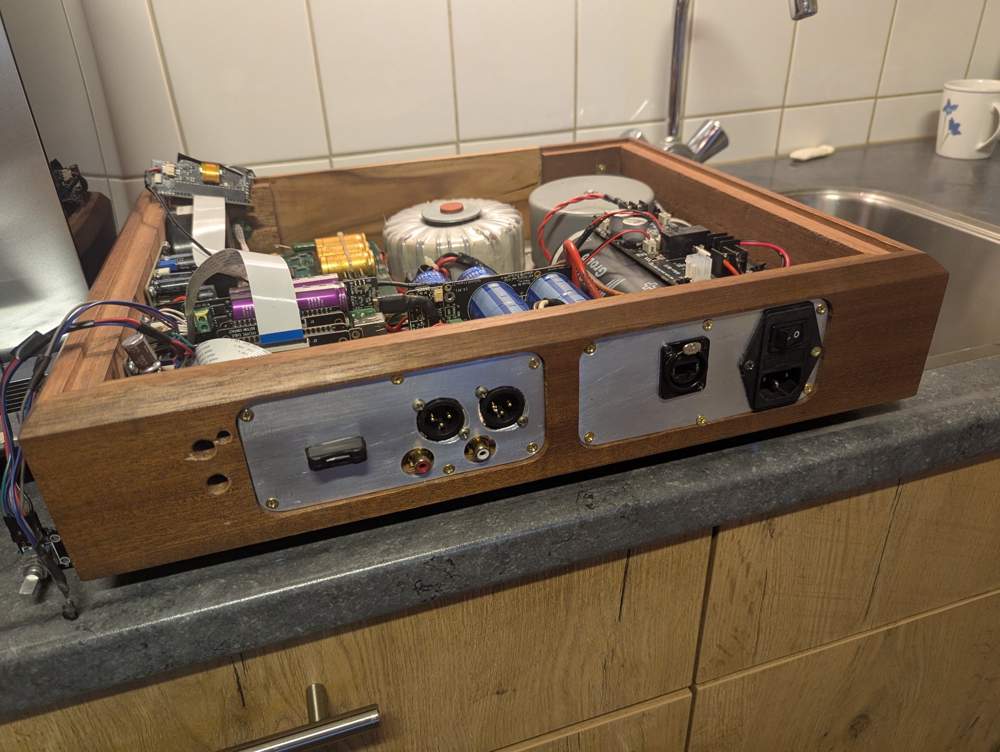

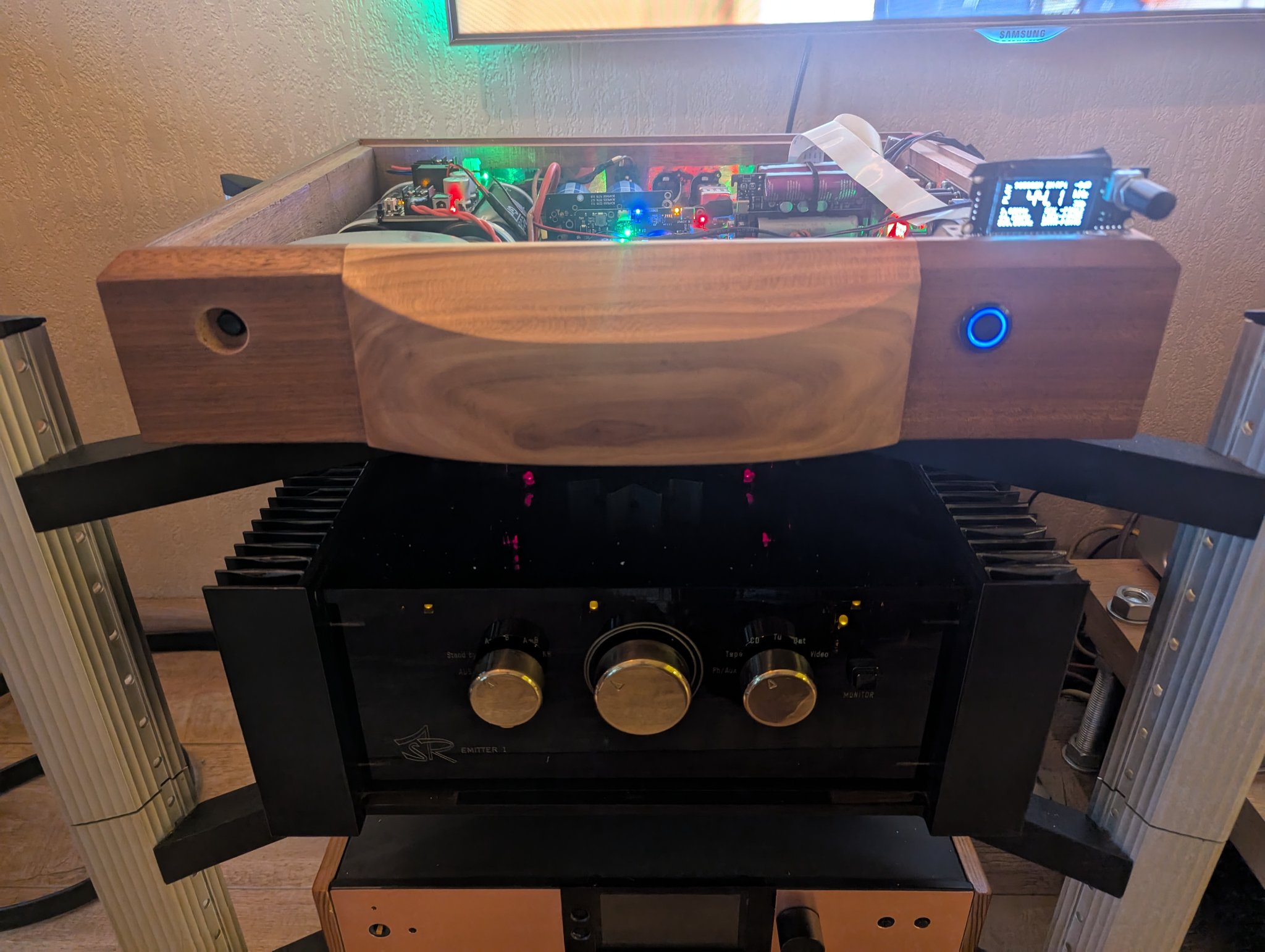

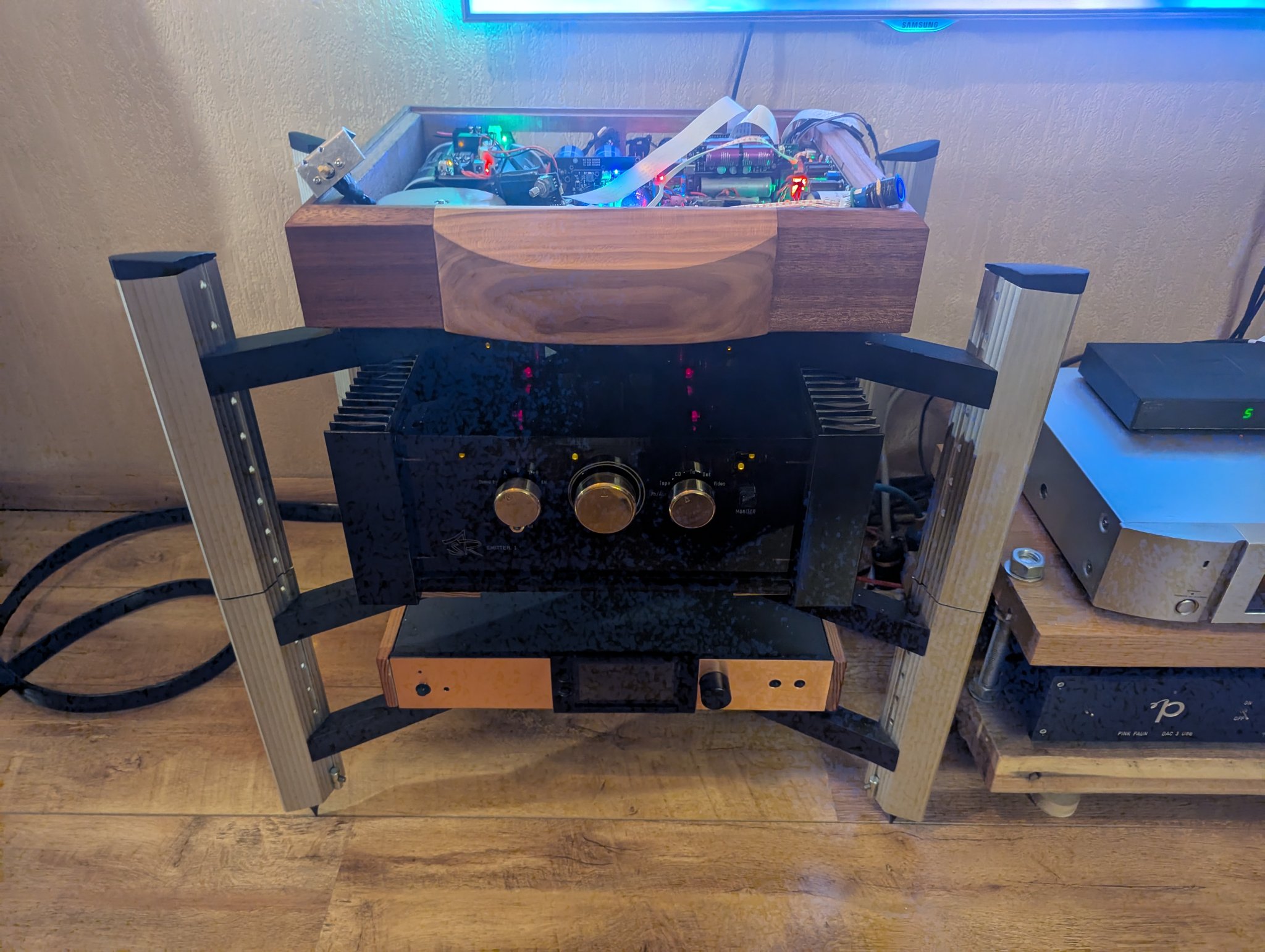

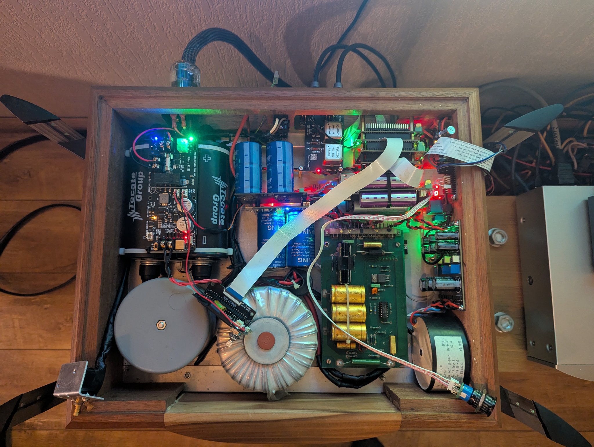

just an update.
Front on/off button plus LED power on/off indication ready plus rear inputs also ready.
Now only the front rotary encoder button, infrared, pure output LED indication plus the monitor Pi pro can be built in.
so we are still busy for a while.
