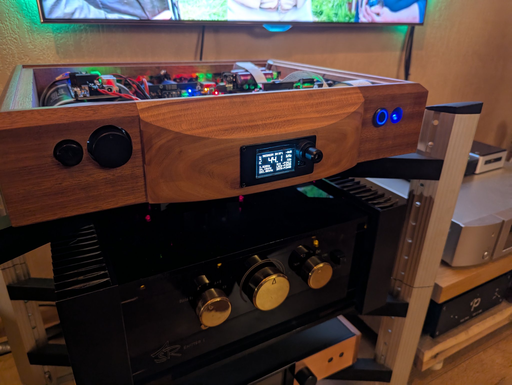

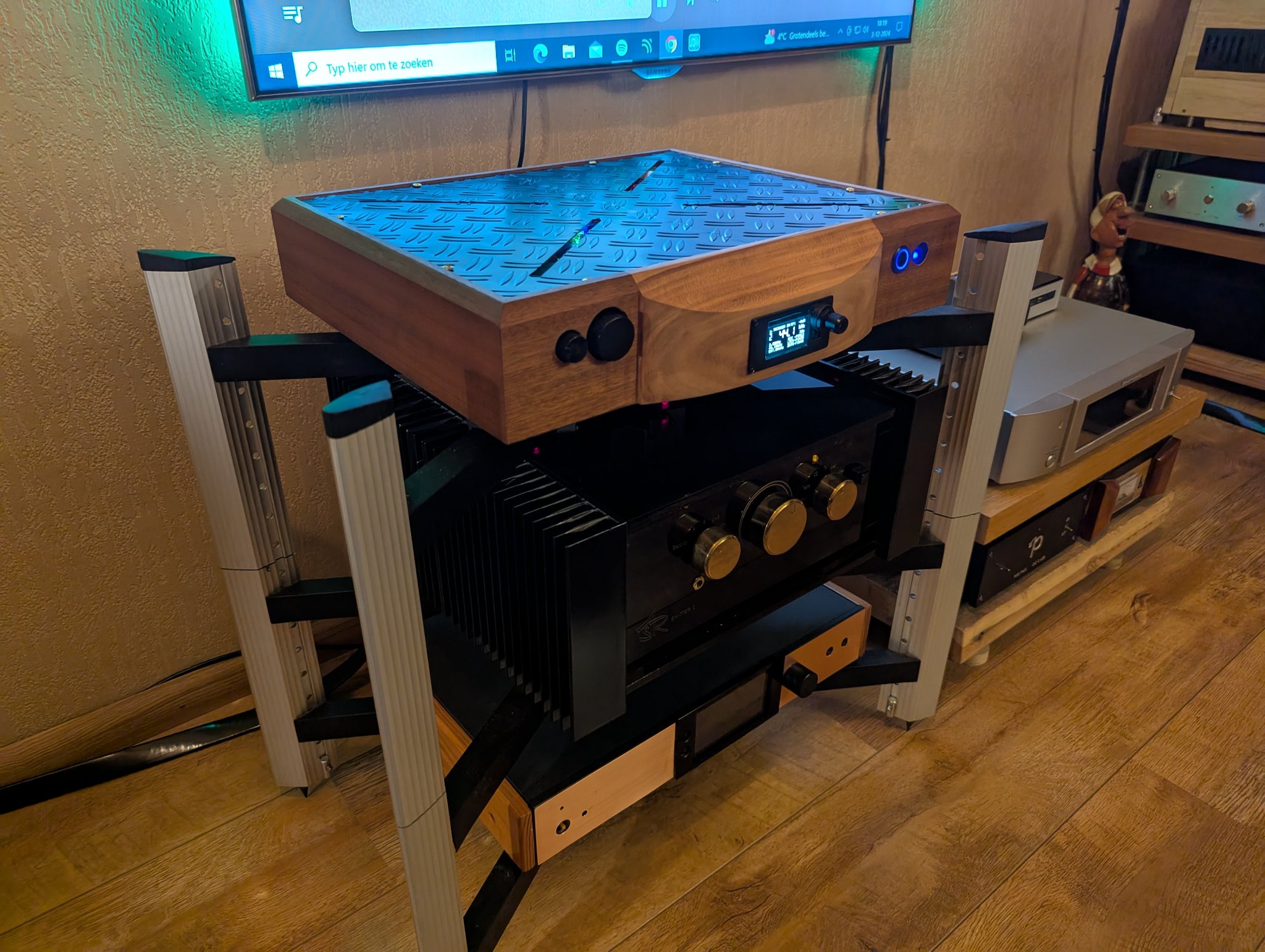

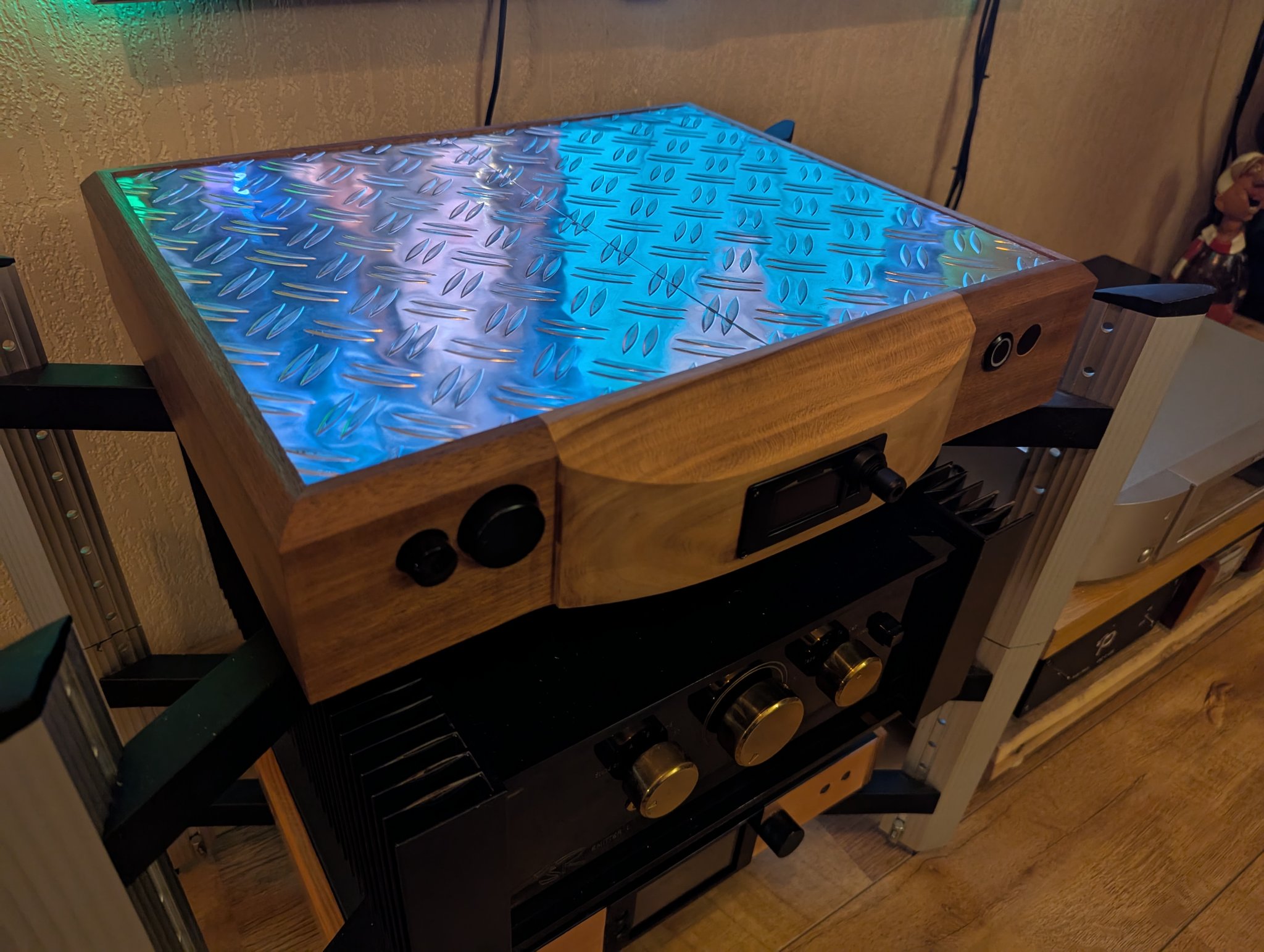

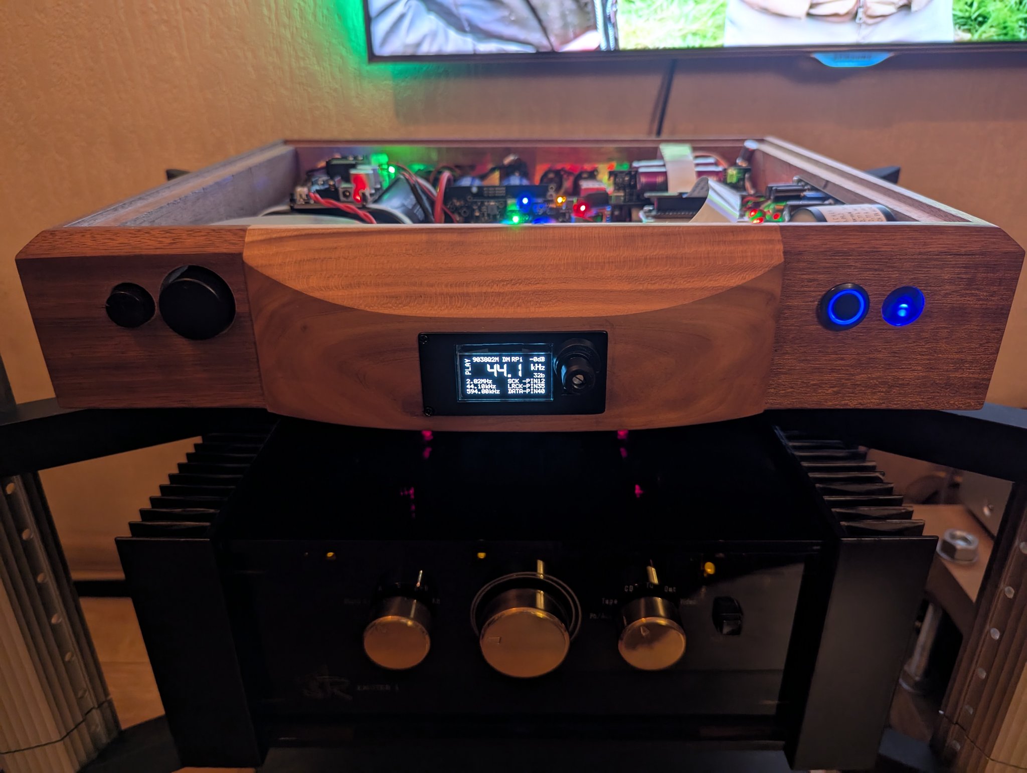

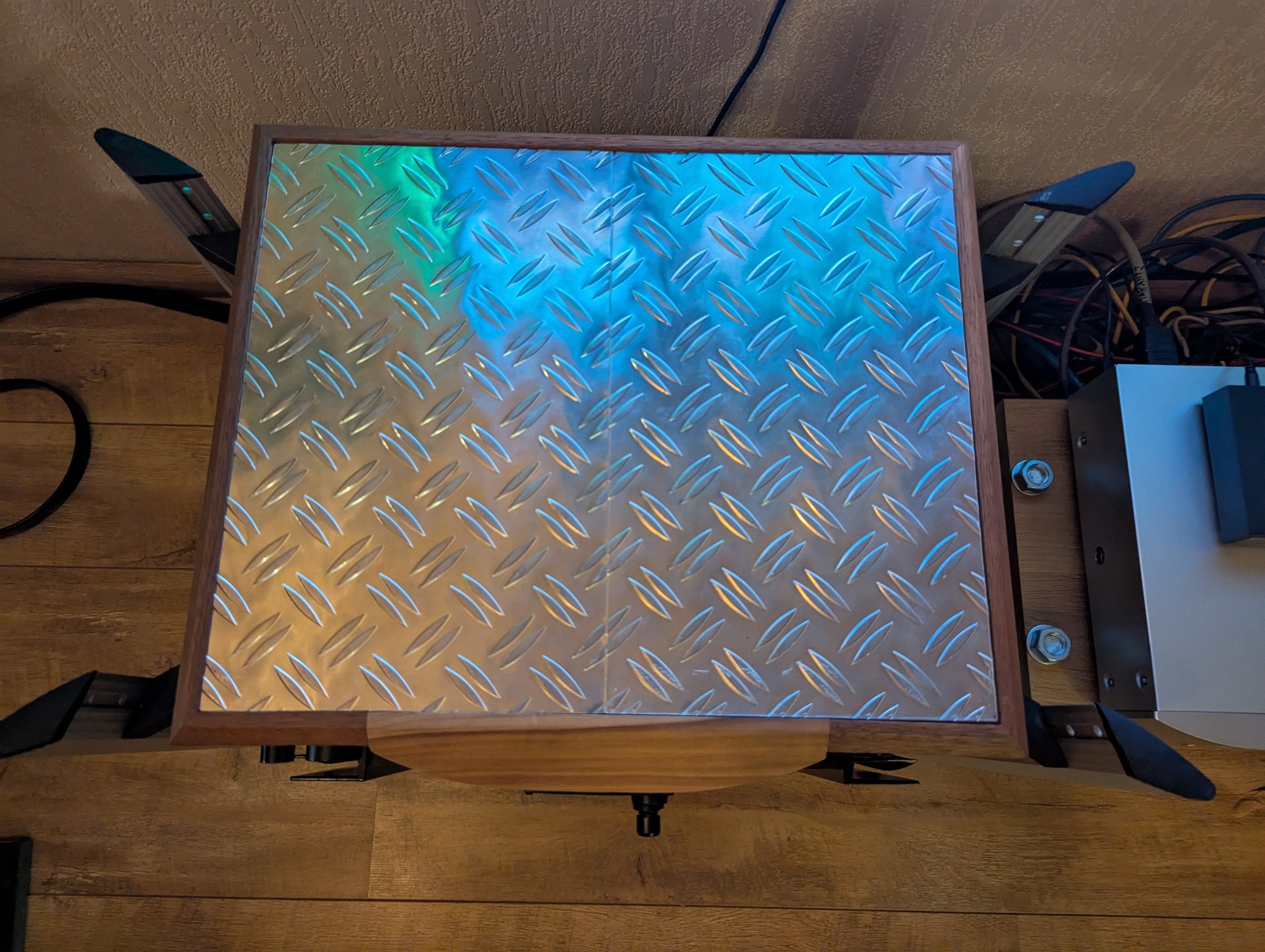

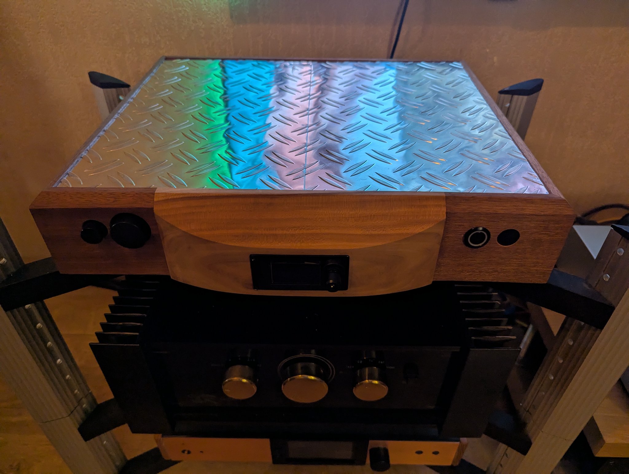

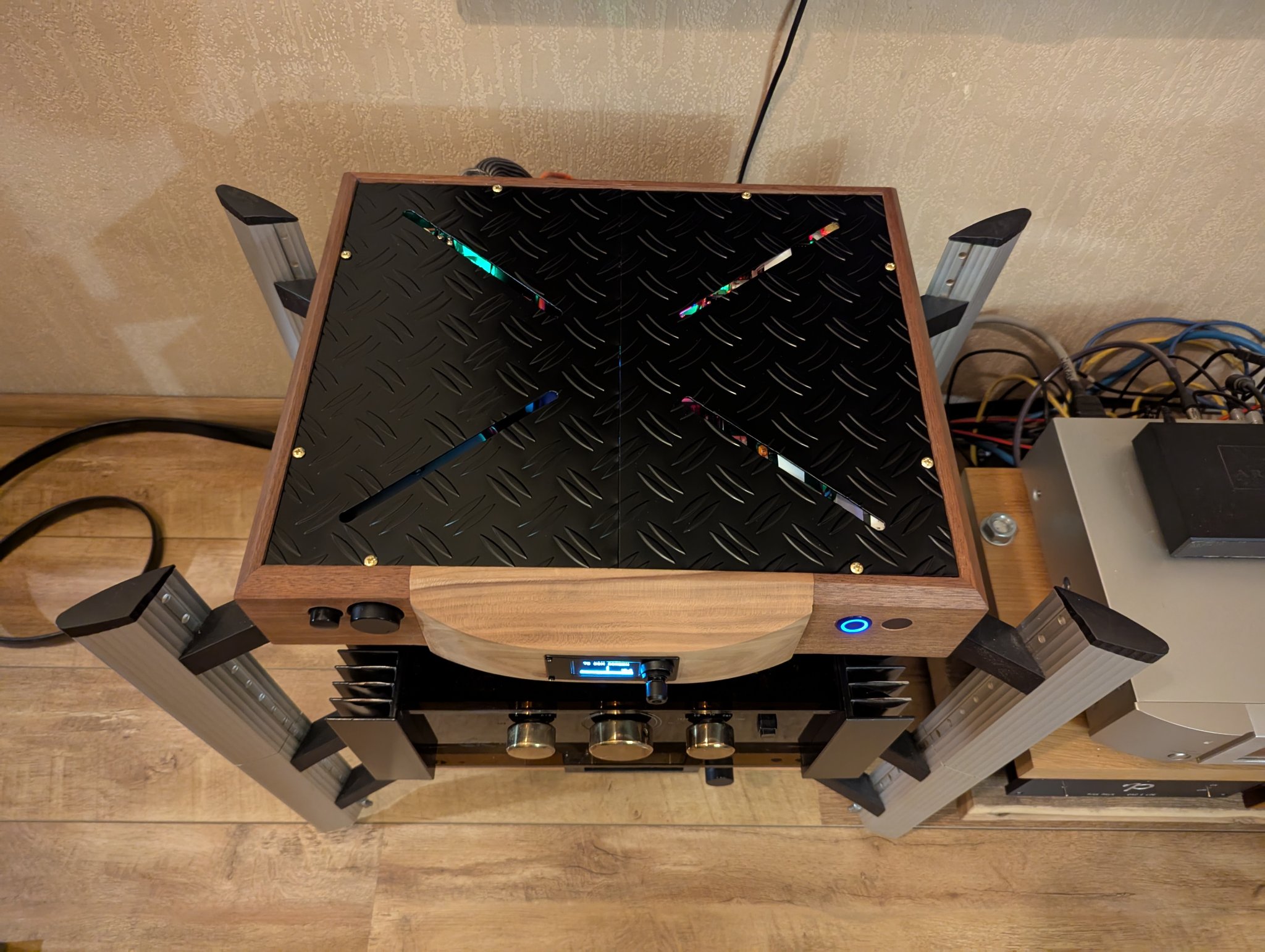

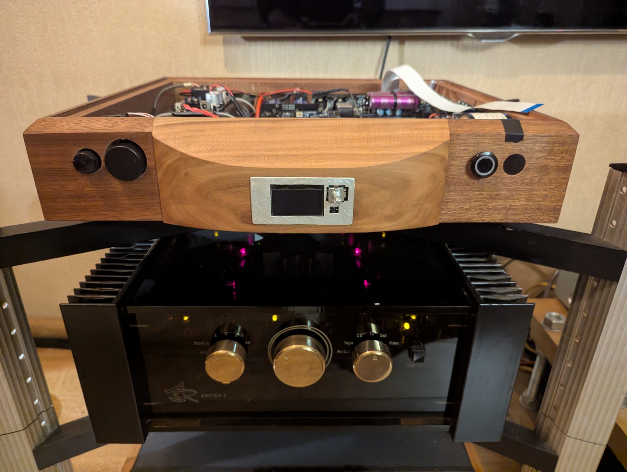

I am using JRiver and Diretta ASIO on a Windows 11 PC, playing to Gentooplayer and Diretta Target on a RPi4-based Ian Canada stack which is capped with Gabi's TD1 DAC. My MonitorPi also shows 32b in the top right..but I don't know what this means 😉
monitor Pi pro sits in front of it.

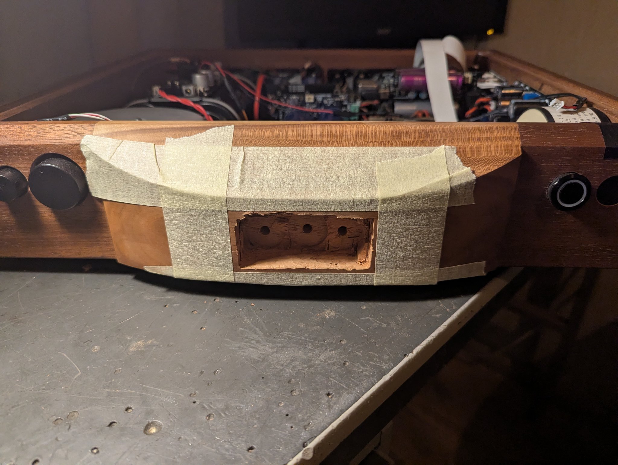

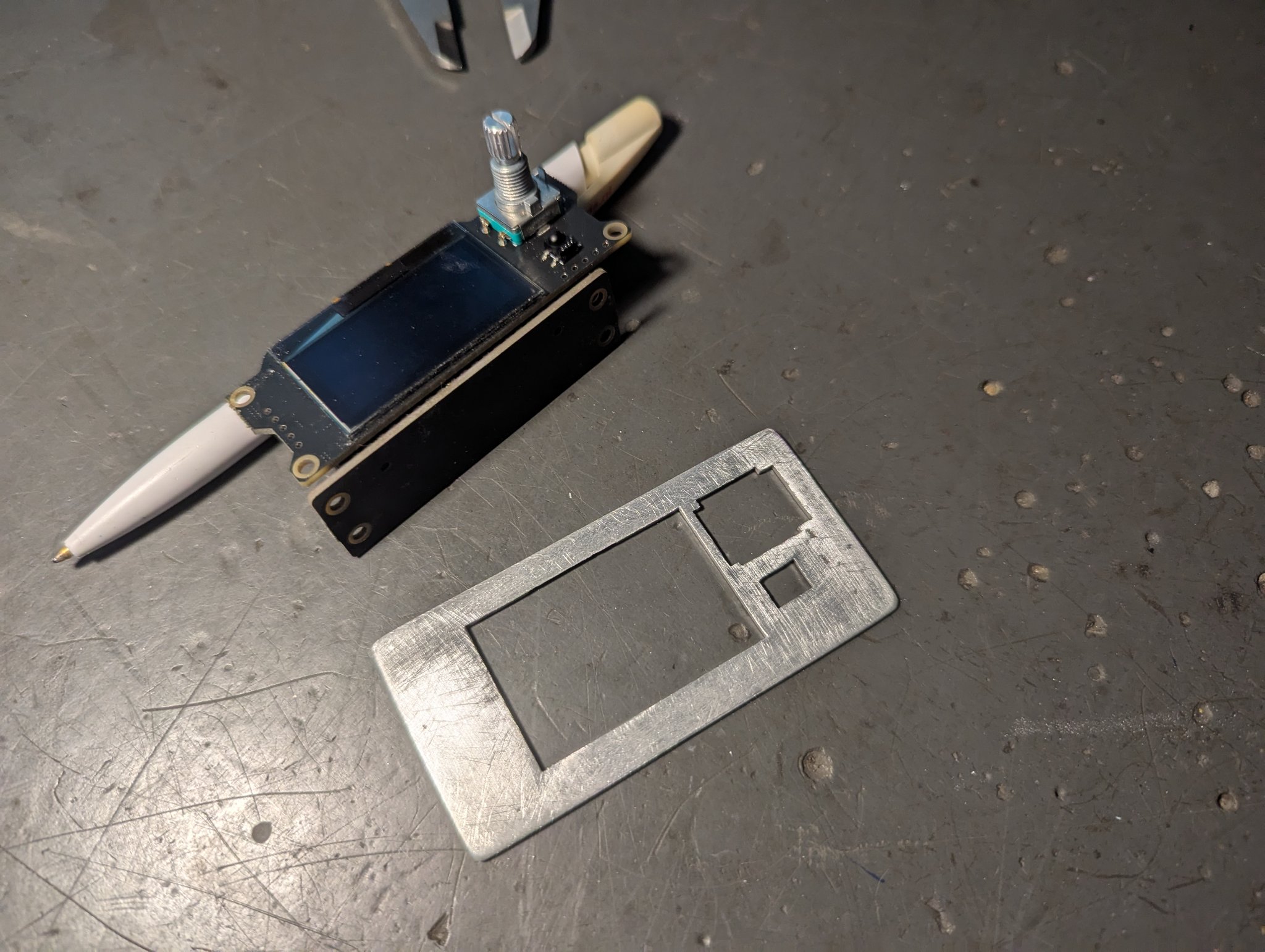

is not an easy thing to build in.
also the Rotary encoder, infrared and Pure output LED behind the smoke glass.
