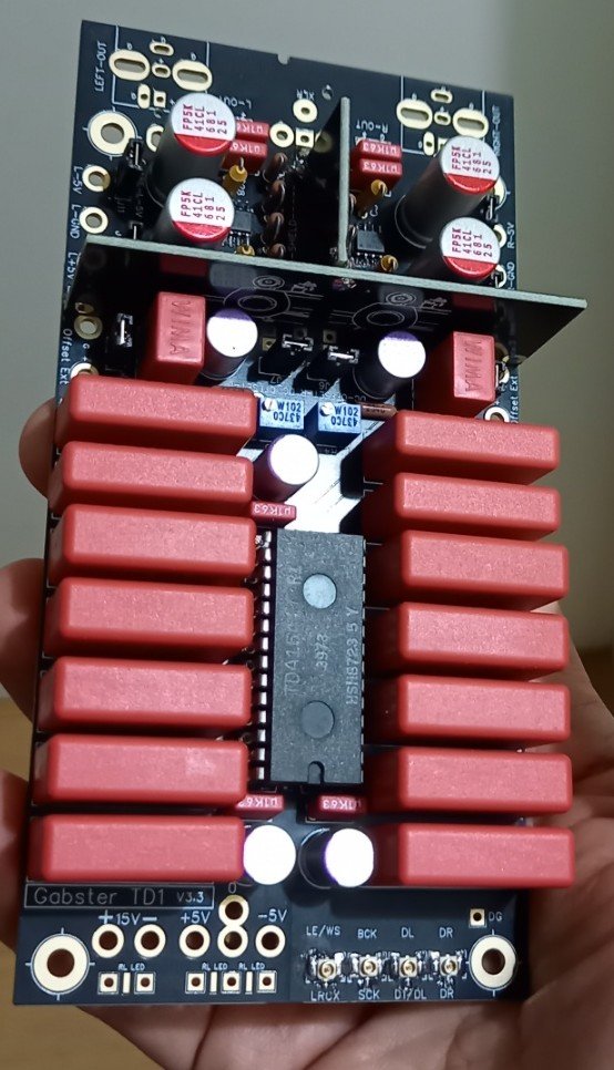

Hi @pkonstantinidis, I am also in process to adding TDA1541 DAC in my streamer. I have in my hands the ian canada i2s to PCM converter and I am waiting for IFI power supplies (2X 5V supply plus 2X UCconditioners and a 15V supply plus Gabster CRC Power filter).
For the moment I have a TDA1541 (non A) chip. I am wondering if any colleague has to recommend or share a positive feedback of a reliable TDA1541A supplier (for example from ebay) .
Once DAC is ready I will revert with feedback.
