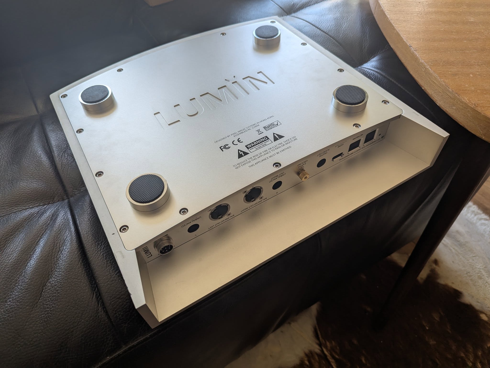

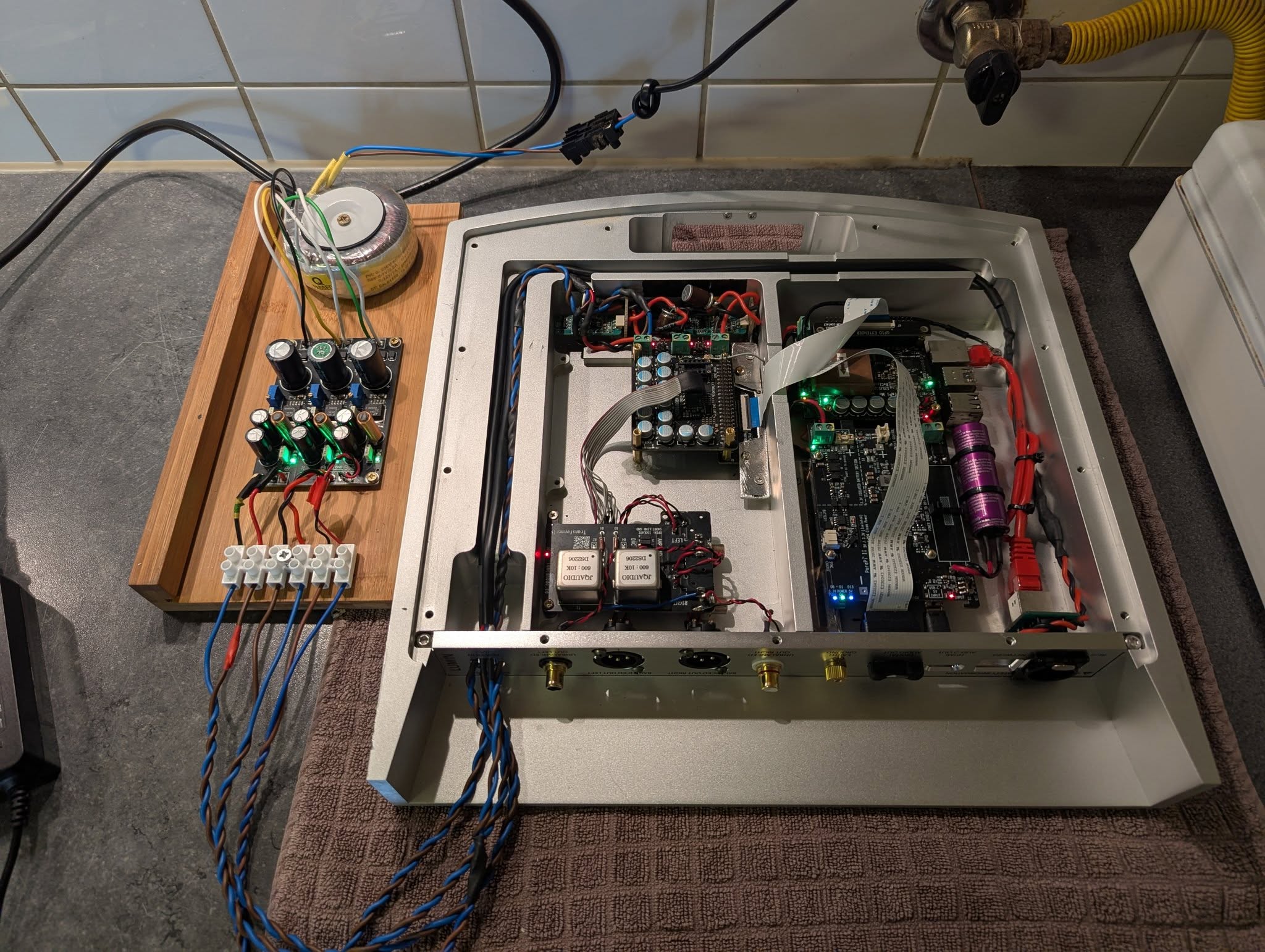

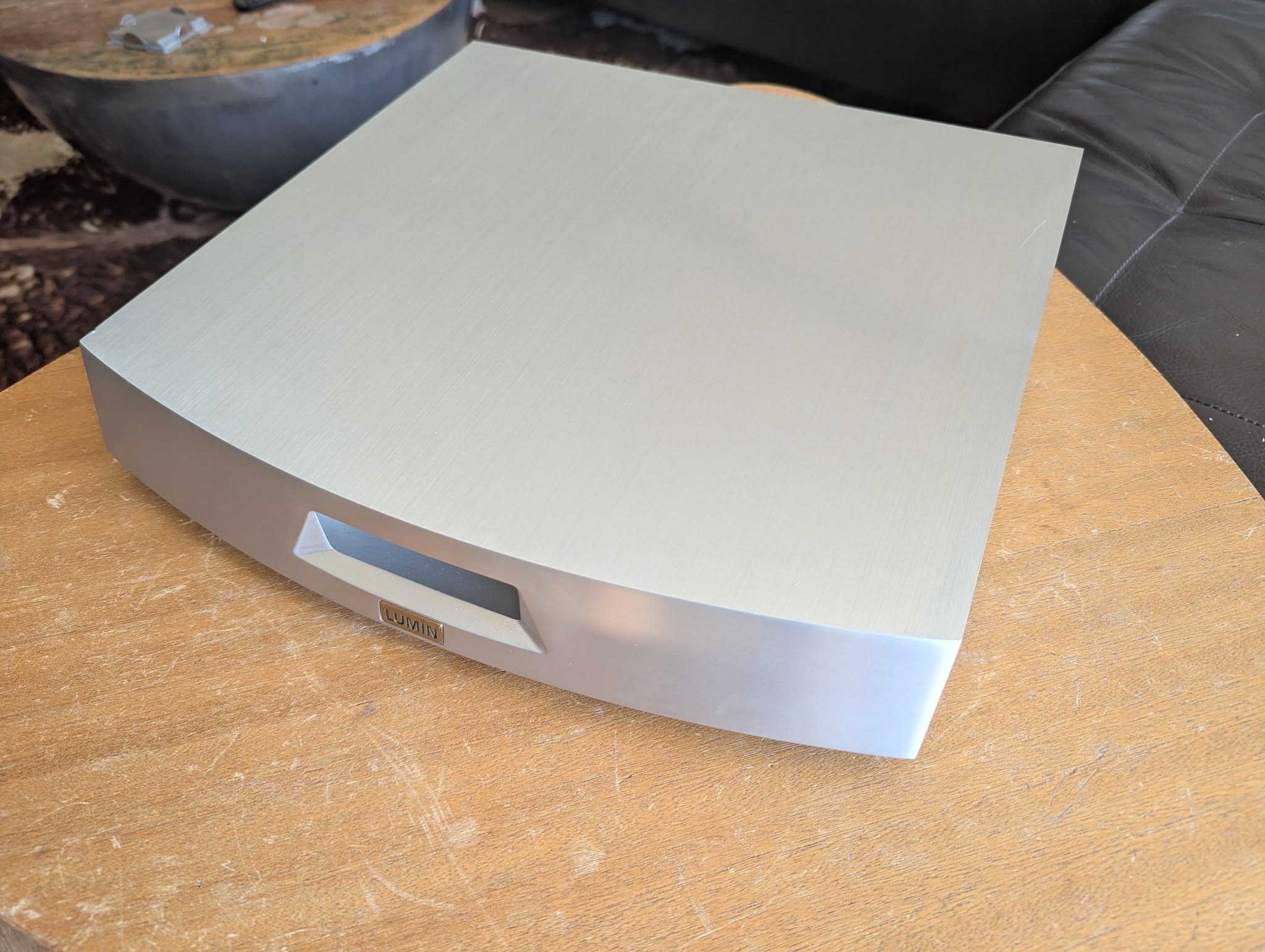

am working on a streamer/dac in an empty Lumin S1 case, almost 8 kilograms of pure aluminum.
I don't have much space and it is only 4 cm high.
ES9038Q2M Dual Mono II, FifoPiMa, PurePi-ll 3.3v-5v, Transformer I/V.
just need a monitorPi pro screen in between....next week see if there is any sound coming out of it.
Finally, the power supply comes in an external cabinet with a nice cable with screw coupling.

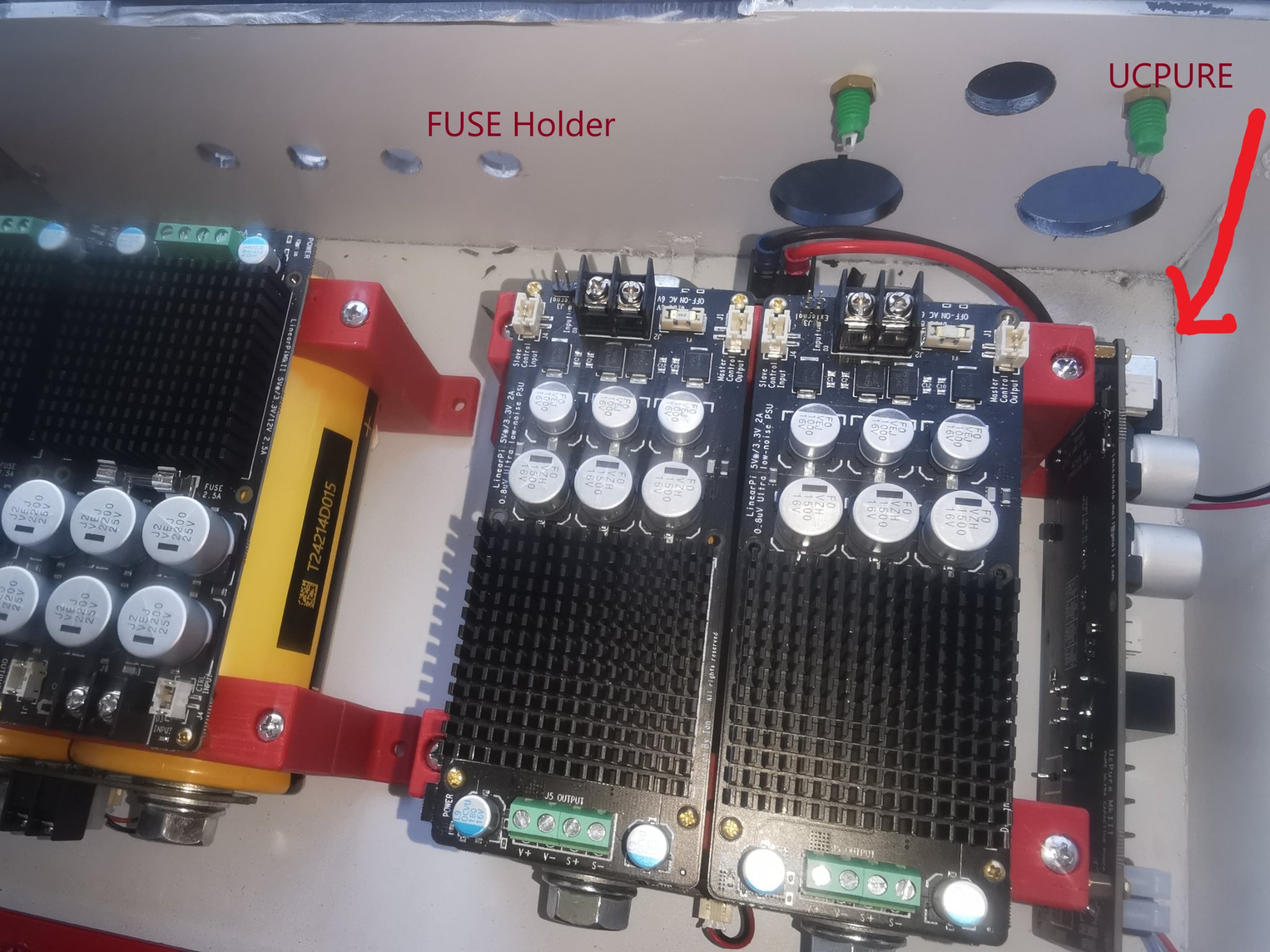

Hi All, On the UCPure MkIII . there is a Fuse , I want to move the actual fuse to the rear panel , as replacing the fuse will be difficult as the board will be in an awkward position (did not think about this when designing the case (so many , so many mistakes🙁 )). Is this possible without causing any issues , The fuse with be about 4 inches away.
