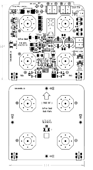

I’m having trouble configuring my Ucpure QUAD to output 3.3 V instead of 5 V. Here’s what I’ve done so far:
  1. Initial setup
    • The jumpers were all open, so the board was set to 5 V by default.
  2. Switching to 3.3 V
    • Powered down the unit (switched off S1 and unplugged).
    • Installed four jumpers as per the manual: two on J14 and two on J15.
    • Ensured each jumper bridged pins 1–2 and 3–4 correctly.
  3. Powering back up
    • Reconnected and powered on the QUAD and power on S1.
Checked the output voltage—still reading 5 V, not 3.3 V.
Is there another step I’m missing or a common pitfall when switching voltage on the QUAD? Any suggestions would be greatly appreciated. Thanks!

@Gabster 2000 ,
Can I leave the 6–12 V lamp mounted on the Ucpure Quad board, or should I remove the caps from the board for do this?
If I do connect the lamp while it’s still on the board, where would you recommend I attach the positive and negative leads, based on this image:
Thankss!!!
You can use either J10 or J13 ( either one they are connected together) these are connected directly to the caps or The easiest remove 2 plastic caps ( 1 + 1- ) on the top main board and put the bulb on any positive and negative.
The 2 banks of Caps are connected in parallel (The 2+are connected together same with the2 -) so you will be draining all 4 caps this way (avoid any shorts your wire will burn instantly and you can burn your fingers if not worse) as there is no fuse on J10 and 13 same for the cap screws you are connected directly to the caps so be careful shorting anything.
Do not leave the bulb permanently this is just temporary to drain them till you get around 3v.
I think most of us same for me the first time i saw it think because there are 2 output terminals that these are 2 independent supplies they are Not they are the same Connected in Parallel The Advantage of the Quad is you have more Storage capacity so they last longer and less voltage drift, also half the ESR. They are Ideal for the FifoQ7 3.3v Clocks or other applications where you want the lowest ESR and bigger storage Capacity

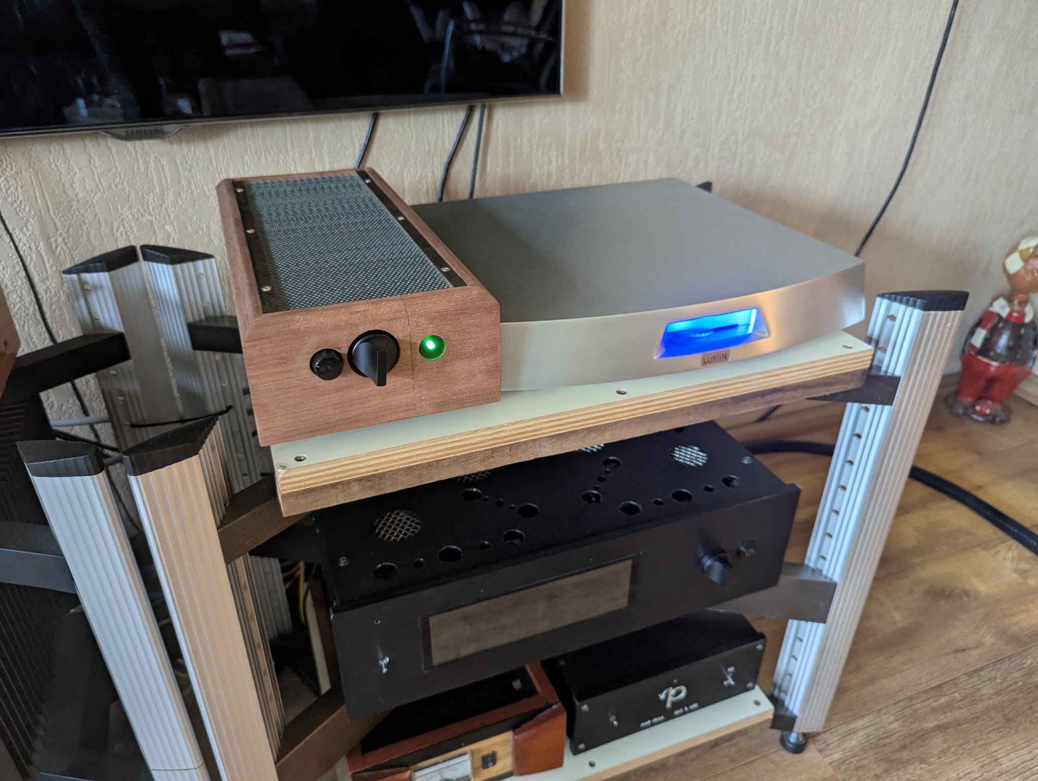

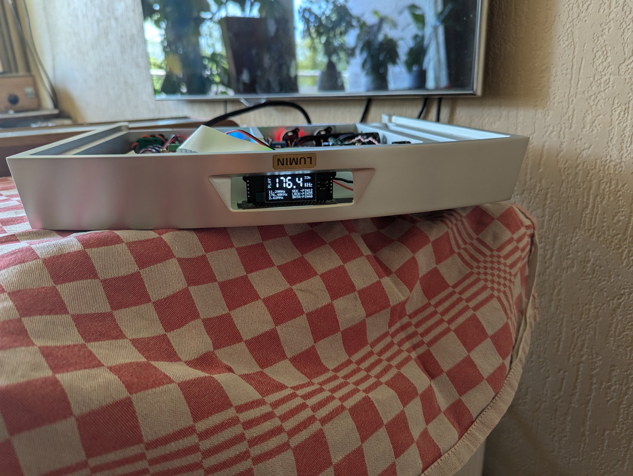

On a smoke color window in front is the pcm 1794A in lumin S1 case ready. Also made a dark blue slaves for the power and gpio (rotary encoder) cable.
it has an ian purepi ll, ucconditioner and a FifoPiMa in it.
I consider it done.
