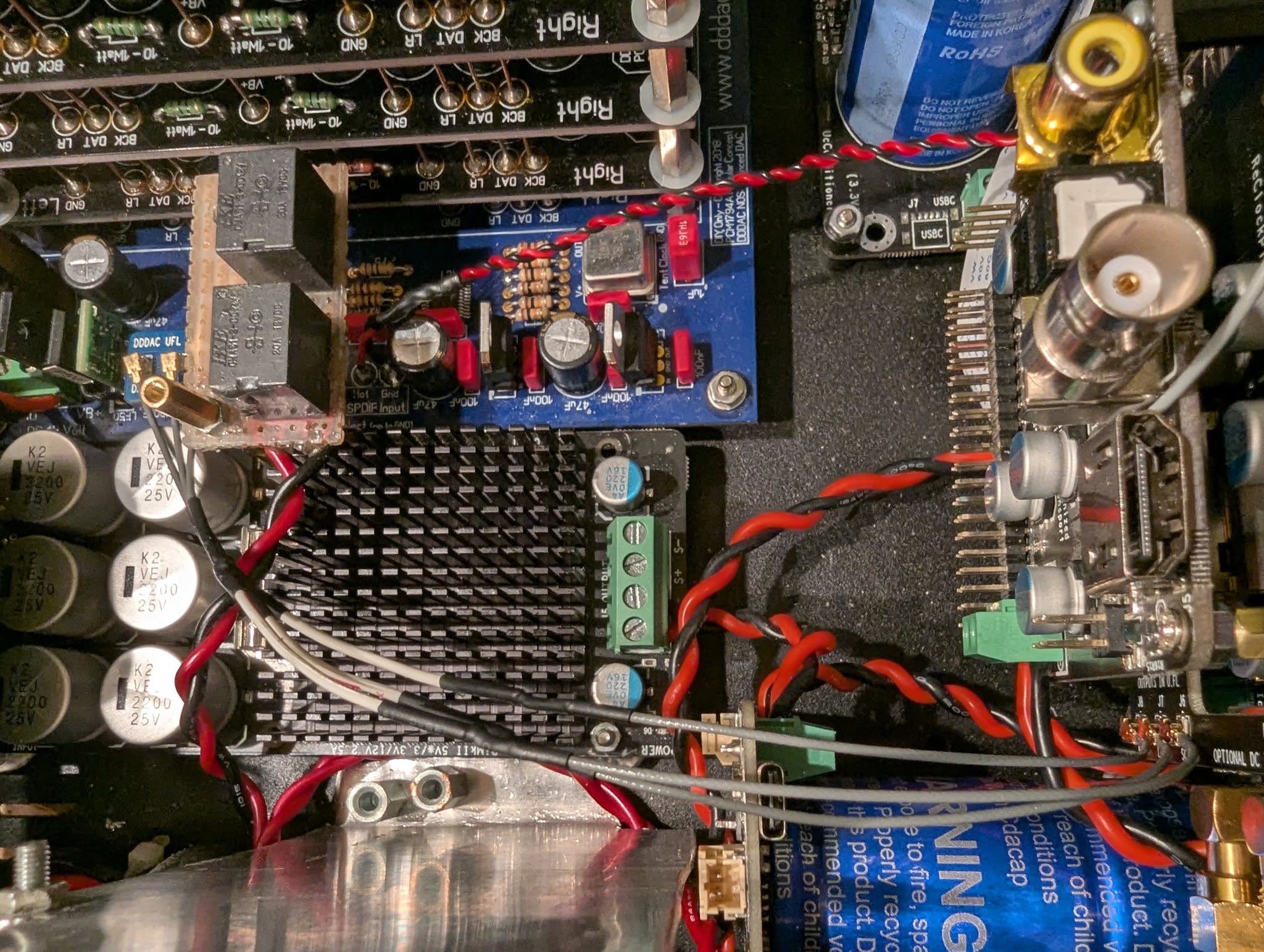

in the meantime the reclockPi, U.FL adapter for DDDAC and U.FL cables arrived (just too short😏) also connected but still have to feed the reclockPi separately with 3.3v.
Next week I'll add the 3.3v and then I'll have a good listen to what it has brought.

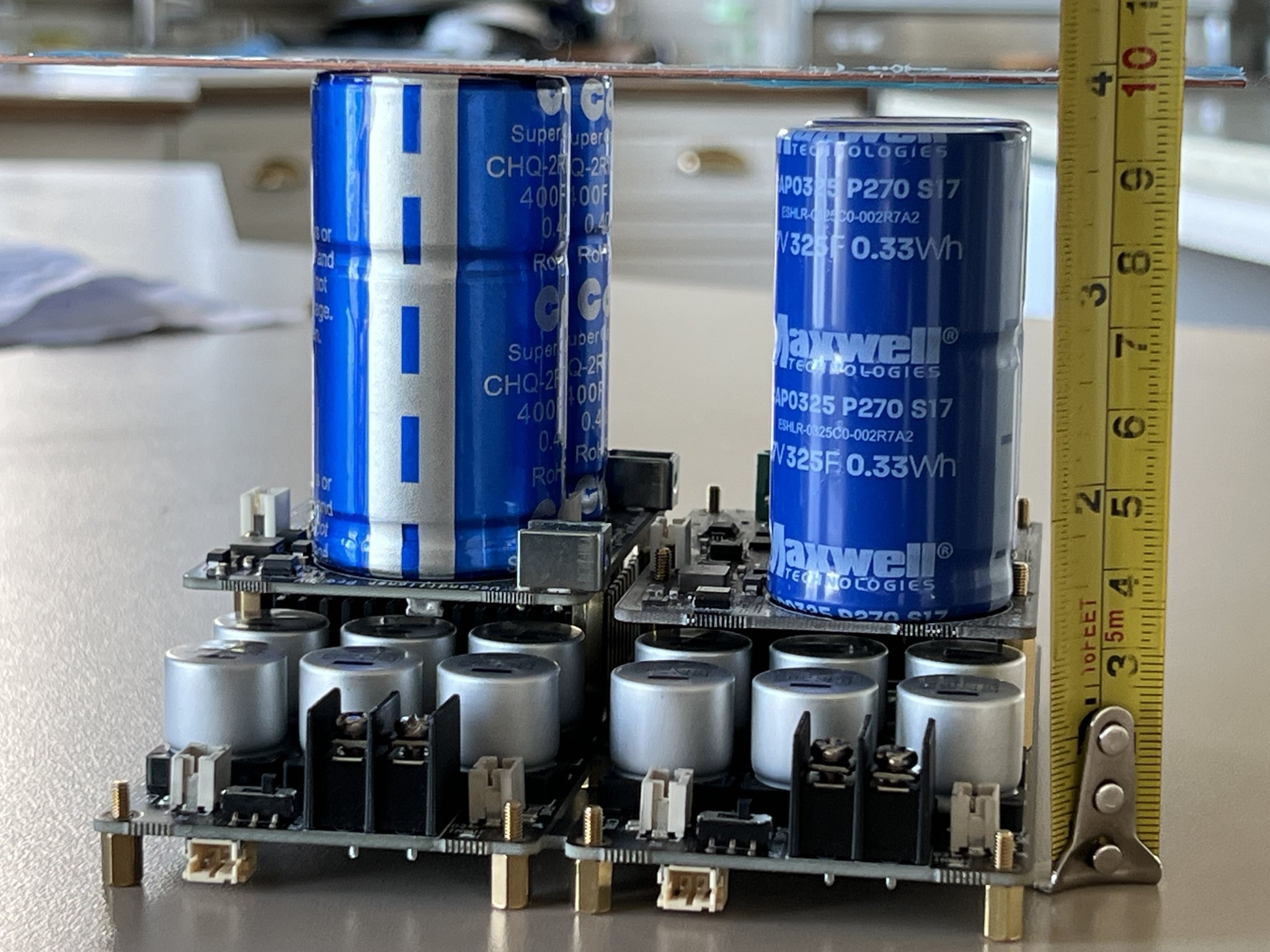

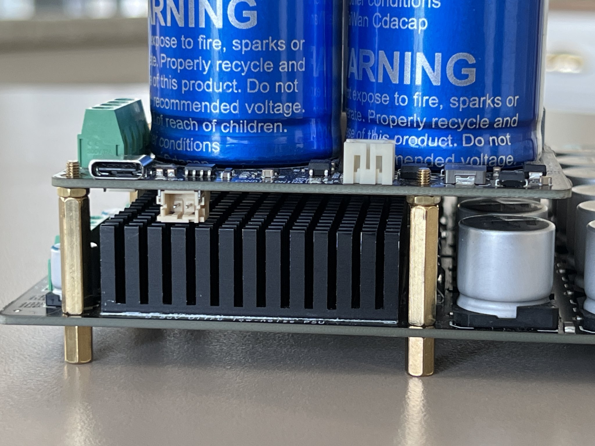

@dddac Ref Quick question...... what height in mm has the assembly of linearPI with UC conditioner on top? including standoffs at the bottom ?
I recently took some photos for an upcoming video showing how to fit both the Linear Pi and the UCConditioner on top of each other inside a case with an internal height of just 100mm (10cm). I wanted to share my findings with you, as this is a challenge many of us face—especially when using the pre-soldered capacitor version.
With a 7mm standoff on the bottom, a 20mm standoff on top, and a 2mm nut (since 22mm standoffs are hard to find), you reach 100mm (99mm) in total height. However, keep in mind that many enclosures have around 6mm of internal space lost due to the bottom and lid thickness.
To make things fit more comfortably, and gain 6 to 7 mm I recommend using your own capacitors. I use 60mm-high capacitors rated at 3V instead of the standard 67mm ones. This gives you a better safety margin while still delivering great performance.
Here’s an example of the 60mm capacitors from Mouser:
https://mou.sr/4cIHGWa
if you have the Older UcConditioner you also gain 7 mm
