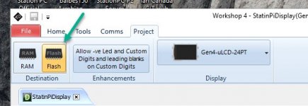

I'm following your notes on setting up the 4D System screen using your code. I can get it to work fine on the development controller by by using the compile and download commands. However, whenever I disconnect the display and hook it to the StationPi Pro connector it reverts back to the 4D splash screen and not your large display buttons. Is your code 'flashed' to the screen or is in volatile memory? Is there a step I'm missing?

The Comp'nDownload appears to work ok, and I get no error messages (see below). I've tried a couple times now and the display never changes when hooked to the SPP. Is there a jumper I'm overlooking, or 'saving' of the your 4D code once it's downloaded to the display?
Just to be clear, either the 24PT, or the larger 28PT display can be used interchangeably? I've tried both, neither worked.
Anyone else running into this issue, or is it just me? Ideas?
I guess I'm having a conversation with myself! 🙂 Anyway, it's funny how one small detail makes all the difference in something working or not. On the Project tab of the 4D IDE the destination must be set to Flash not RAM. I knew there must be someplace to perform the flash. Once I found it and changed it from the default of RAM, everything made sense and it worked. Touch screen works and I've got it displaying controller information too. Here's an image of my rebuilt-stack. I still need to bring a USB jack out to the back panel. Then I'll have all the inputs I use available. Of course, I have to mount the screen on the front panel as well and put the finishing touches on everything.
