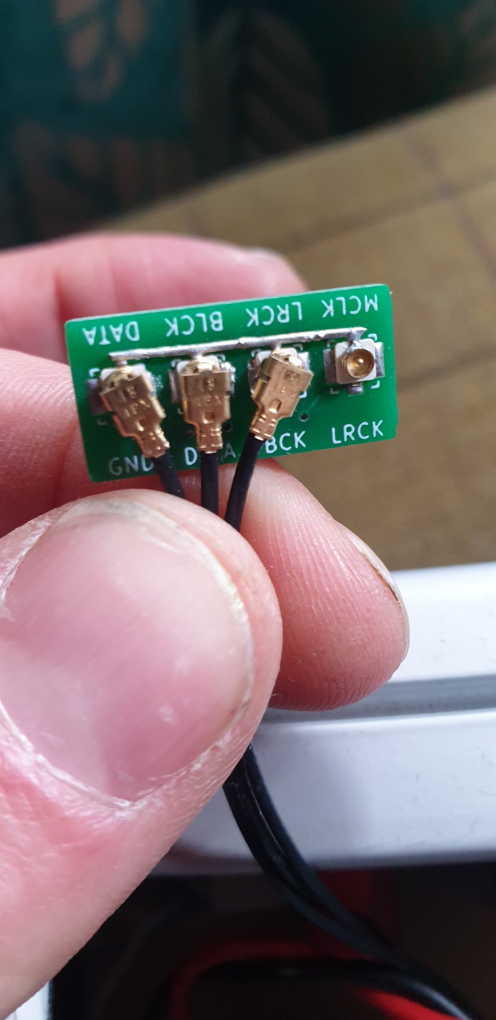

I have a load of these little boards that came from gerbers on Miro's 1862 thread. Bare PCBs so need u.fl and 8 way headers.
This one is hacked to link the grounds. PM if you need any
Reactions: wlowes
I used the small Miro1360 board to feed the DAC from Ian's Fifo. Fifo has 3 u.fl as uses the outer of the coax as ground. There is a 4x2 header on the underside nof the small green board and the ground needs to use 4th 'port' of the header for ground to DAC. So I tried the u.fl grounds together with the wire to connect to this 4th connector

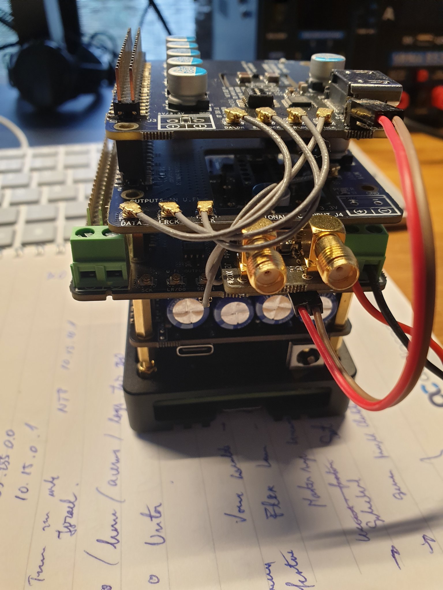

Hello everyone,
I need some help as I am not able to make the Sinepi work with an external FOS-3 device.
My setup:
RPI4-->ConditionerPI-->FifoPi Q3 Ultimate-->ReclockerPI-->HDMI LVDS Transmitter MK2
I am powering the 5V on Conditioner PI and 3.3V on the FifoPI from an HDPLEX 300.
I have used successfully Accsilicons with the above config. I am trying now to replace the Accusilicons with 44.1 and 49MHz provided from the FOS3 to Sinepi.
SinePI is installed replacing the two Accusilicons, using exact same configuration for u.fl cables. I have no sound out. What I have noticed is if I turn off
the FOS-3 the relay switches continuously - this would mean that there was a lock and without there is no lock (so the clock is provided and locked with FOS-3)?
Attached the u.fl cable cable configuration used (successfully with Accusilicons and unsuccessfully with FOS-3)
FOS-3 characteristics according to the manufacturer:
  • OUT1 output frequency: 44.1k-88.2k-176.4k-352.8k-48k-96k-192k-384k-8.4672M-11.2896M-16.9344M-33.8688M
  • OUT2 output frequency: 44.1k-88.2k-176.4k-352.8k-48k-96k-192k-384k-8.4672M-11.2896M-16.9344M-33.8688M
  • 10MHz port output frequency: 10MHz
  • Output waveform: 3-channels 3.3Vpp square wave
  • Output impedance: compatible with 50 ohms and 75 ohms at the same time
I am using two of these coaxial cables from Digikey (15cm):
PART: ACX2042-ND
MFG : Amphenol RF / 245101-04-06.00
Ian mentioned at some point that "a SinePi can take both sine input and square input". Is this really the case?
Am I missing anything? Any ideas?

I’m no expert on this but you’re using the same frequency families on both clock inputs. Maybe that’s the reason it keeps switching.
