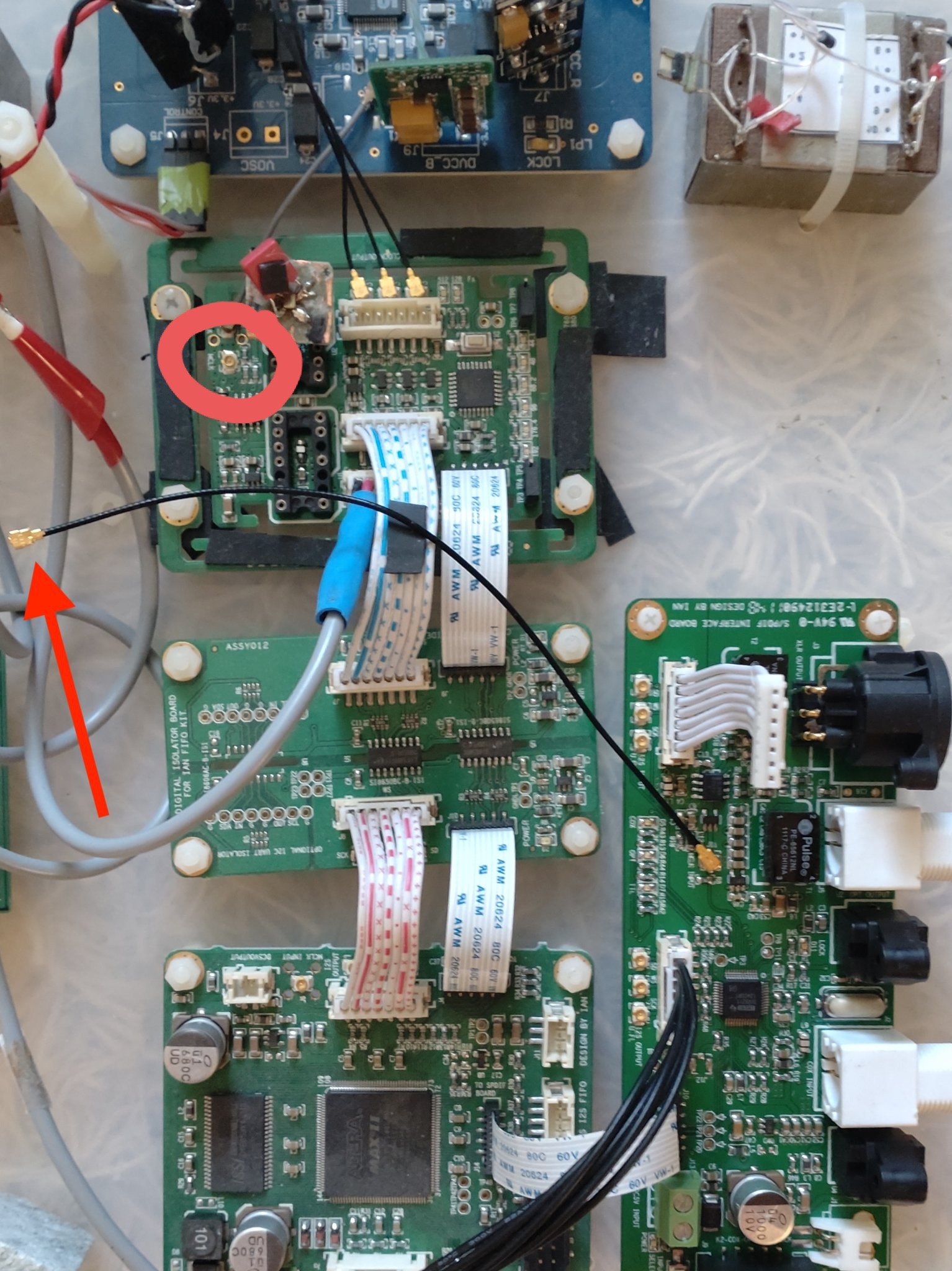

Hello,
IF you have a circuit board with a cable plugged in it would be very strange if the other end would not be connected somewhere else. Usually there will be some " information" close to the terminal to tell you about the purpose.
Maybe the data transferred by the cable already is transferred by the flat cable and you can choose either one of them?

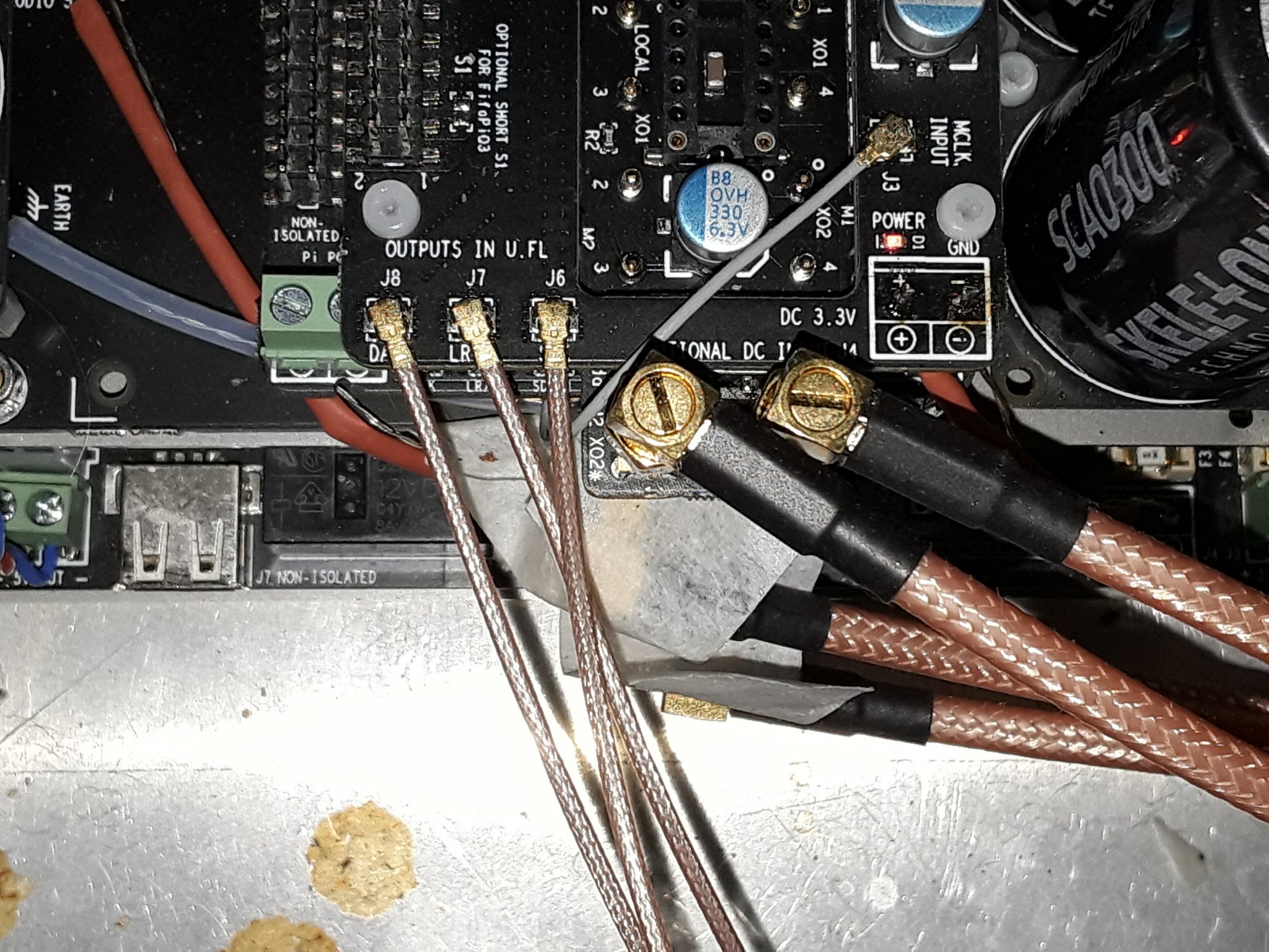

Yesterday i received the tiny " adapter circuit board" Ian designed to be used for the dddac motherboard. I soldered the 3 u.fl cables directly to the board but it is a real pain in the ... to do this properly when the board is not fully accessible!
Maybe better to remove the Dupont terminal and solder the wires after they have passed through the holes to mount the Dupont.
These tiny u.fl cables are not made for the average diy guy. IF Ian would not have designed this little jewel i would have used a few solid core wires and connect them to the big connector on the FIFOPI . Nice to have the best cable but if you cannot use it properly it doesnt make sense to me.

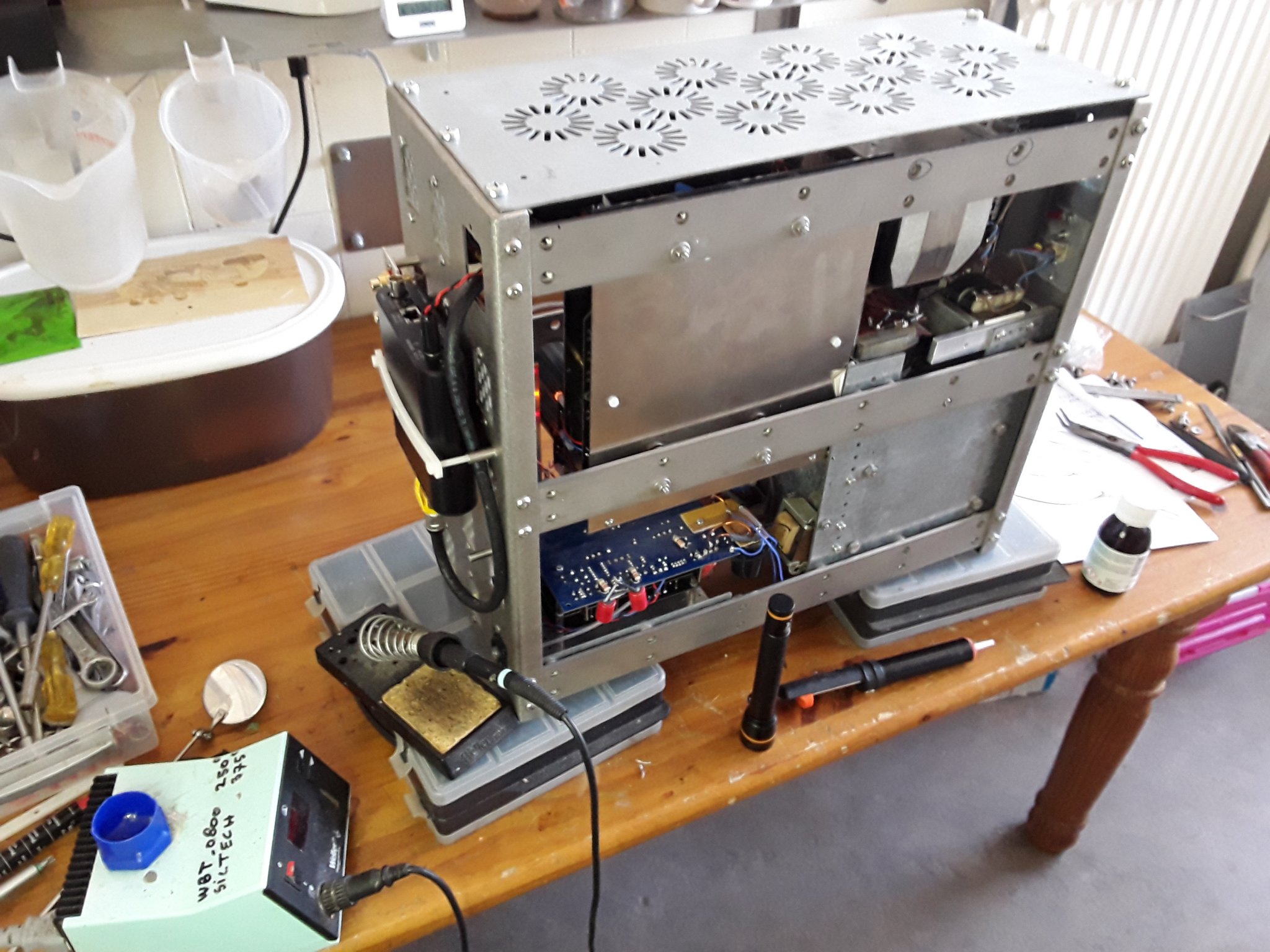

So now the dddac is on the kitchen table again. Hoping the reason for no sound was indeed the bad connection going into the dddac mainboard.
As you can see i replaced the connectors on the Sinepi.because the cables going to the Andrea 's clock circuit were way to rigid. I ordered the cables with 90 degrees terminals and i could not use these without putting to much stress on the connector part soldered to the board.
The 90 degrees connectors have a screw, is it used to keep the connector in a certain position/angle compared to the circuit board?
I told my friend to go for another " clock circuit topology " just to avoid all the hassle with cables or find another cable. Especially if you have several boxes interconnected the cable should be not as sturdy.
