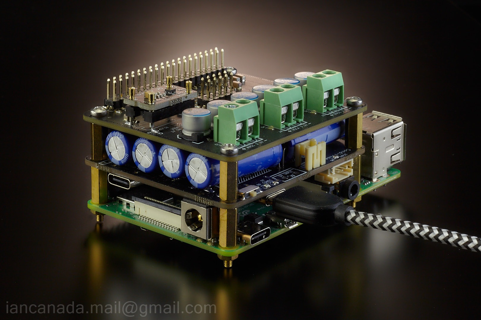

@rikibow
I understand your requirements for the RPi transports with HDMI output . I will have two solutions for you
1. Performance series, best and simplest
TransportPi Digi (with secondary re-reclock and HDMI output)
RPi
UcPi (5V ultracapacitor power supply seat)
2. Advanced series, best of best but still very simple
HdmiPi Pro (with discrete ultra low jitter secondary re-clock and ultra low noise discrete LVDS drivers)
FifoPi Ma
Rpi
PurePi(5V ultracapacitor + 3.3V isolated battery power supplies seat)
I'm working hard trying to make them available soon.
Ian
