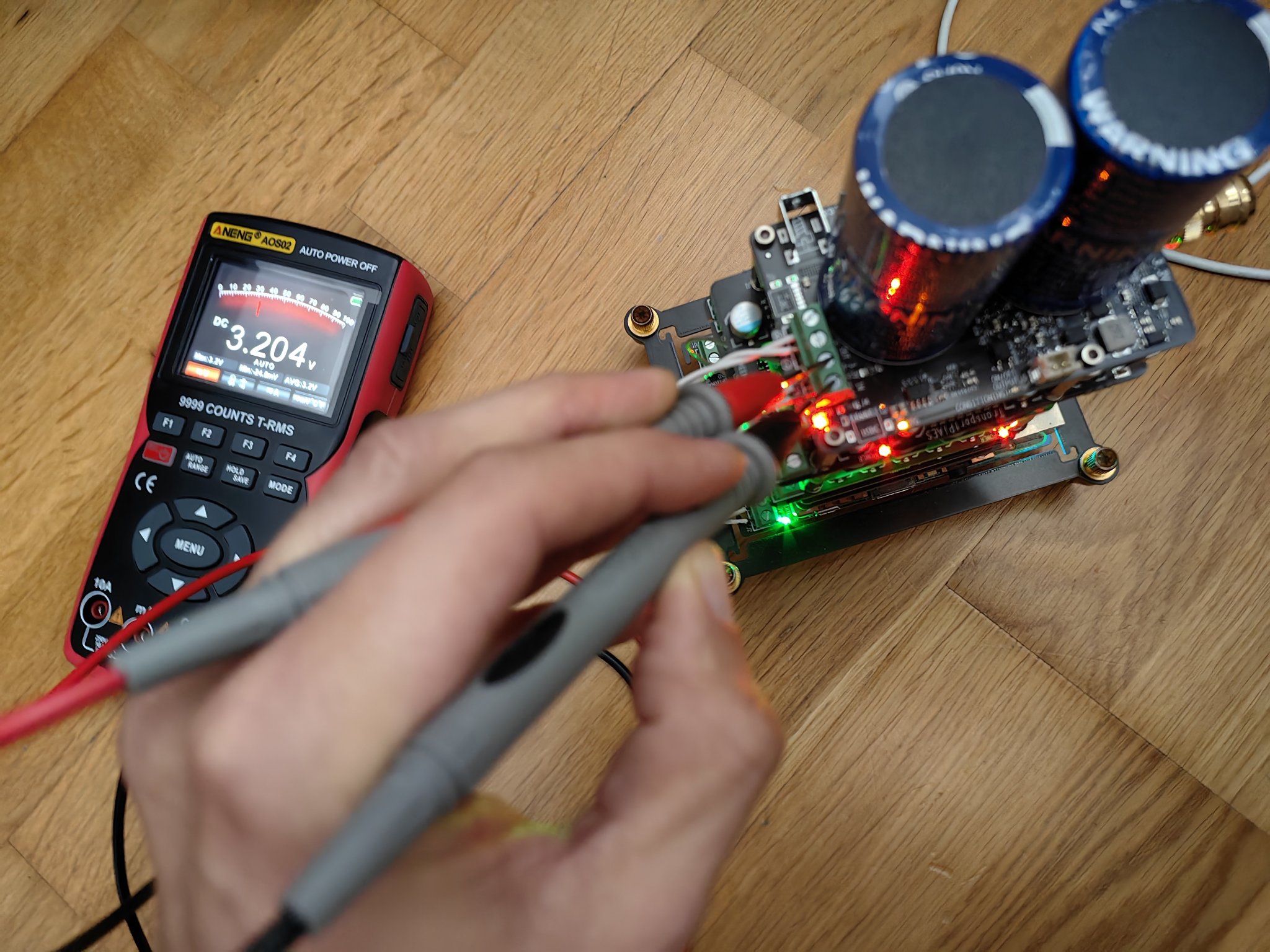

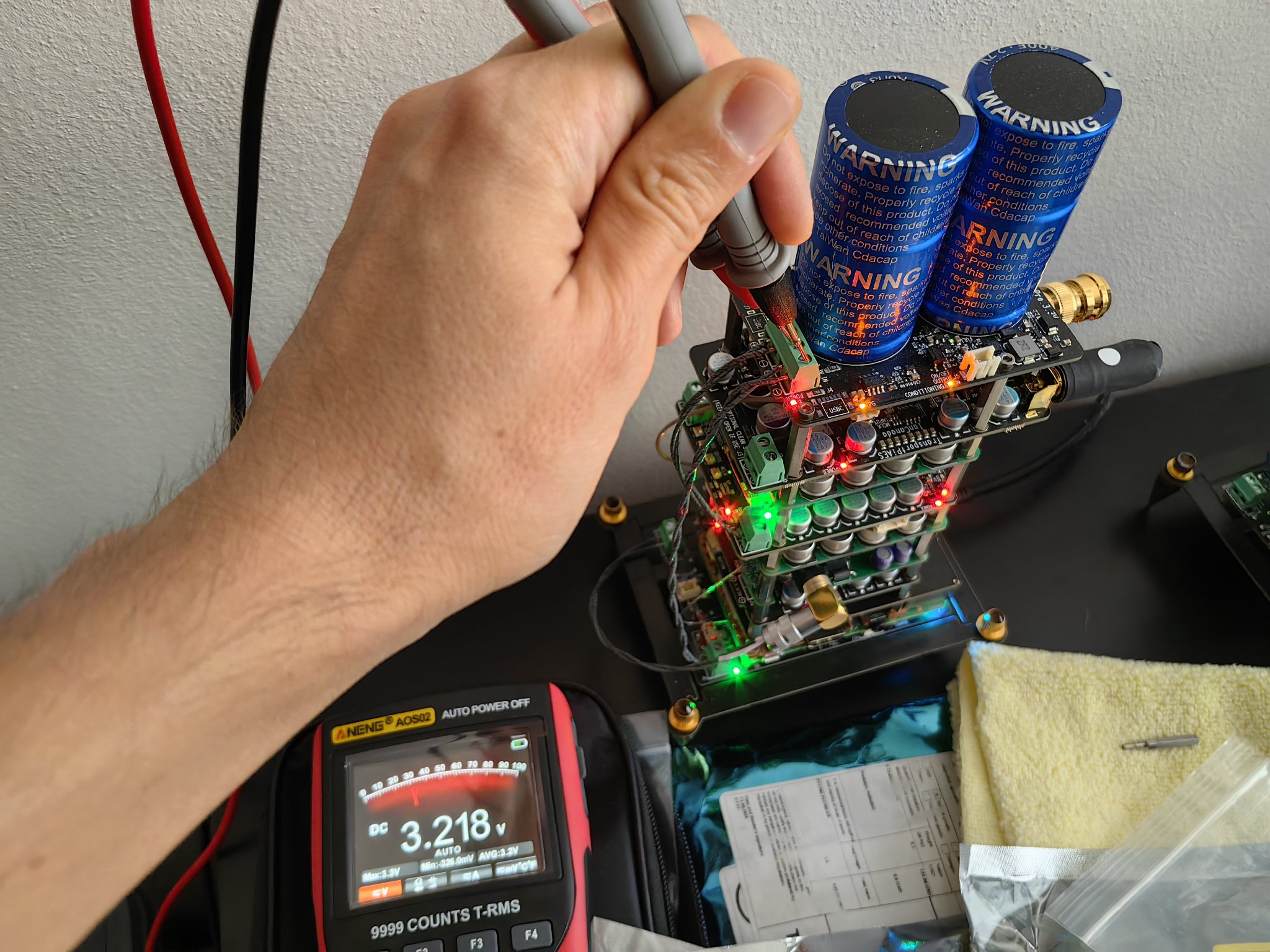

Guys, have anyone encountered this behaviour from the UCC (Pro) modules? With two of them in my latest PurePi stacks, the first green LED starts to fade away at 3.22V (input), at 3.2V all LEDs are dead and the pure mode is being carried all the way down until around 3.1V, which takes another 6-7 hours, so pretty much half of the pure time is UCC being driven without control LEDs.
I tried 5 different battery brands, 4 DC cables and 3 PurePis. But this doesn't happen with my older UCC mkII, which holds all LEDs lit even close to the end of the pure battery cycle.
Green LED dead around 3.22V
Last man standing (power good) slightly above 3.2V, then they're dead.
Any ideas?

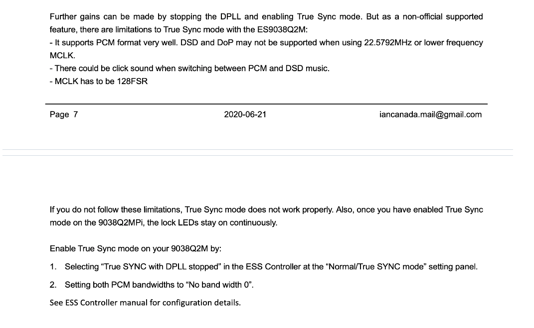

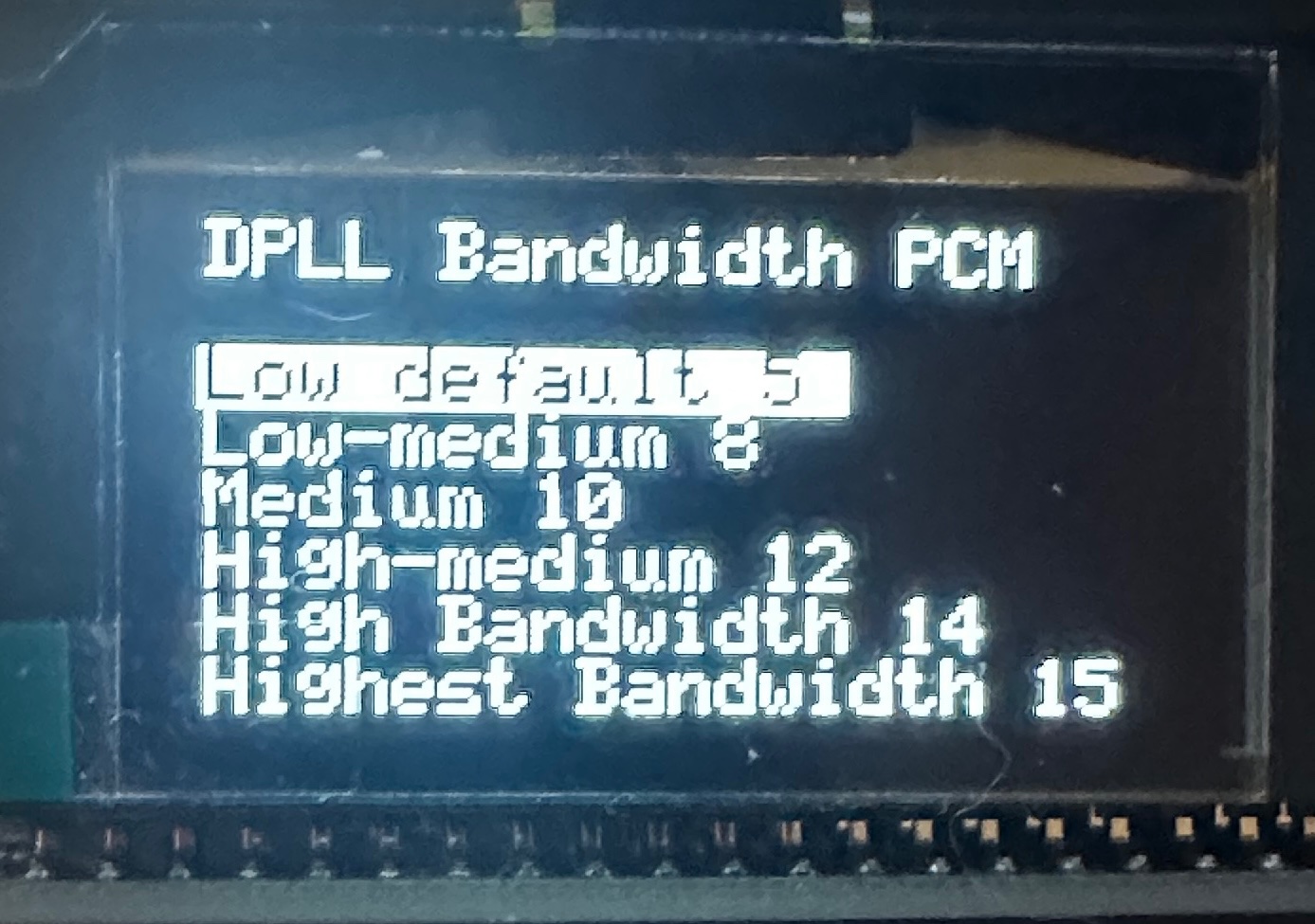

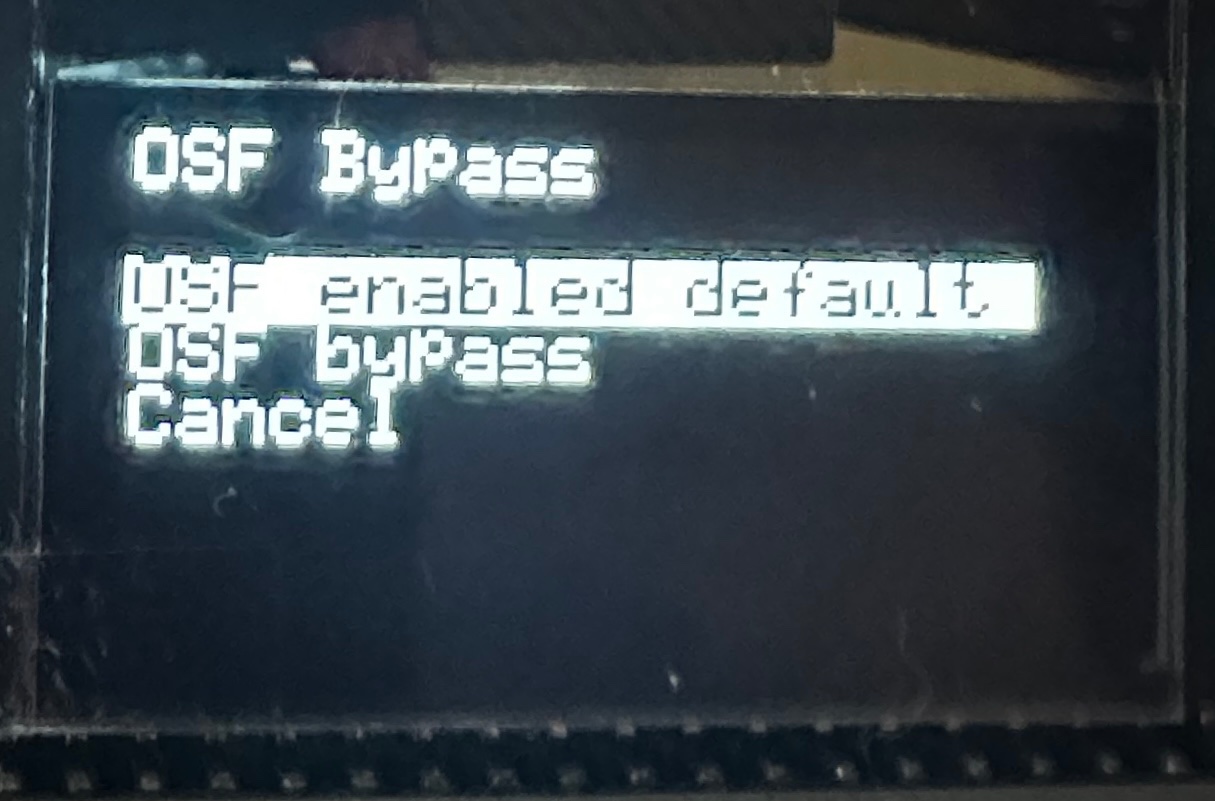

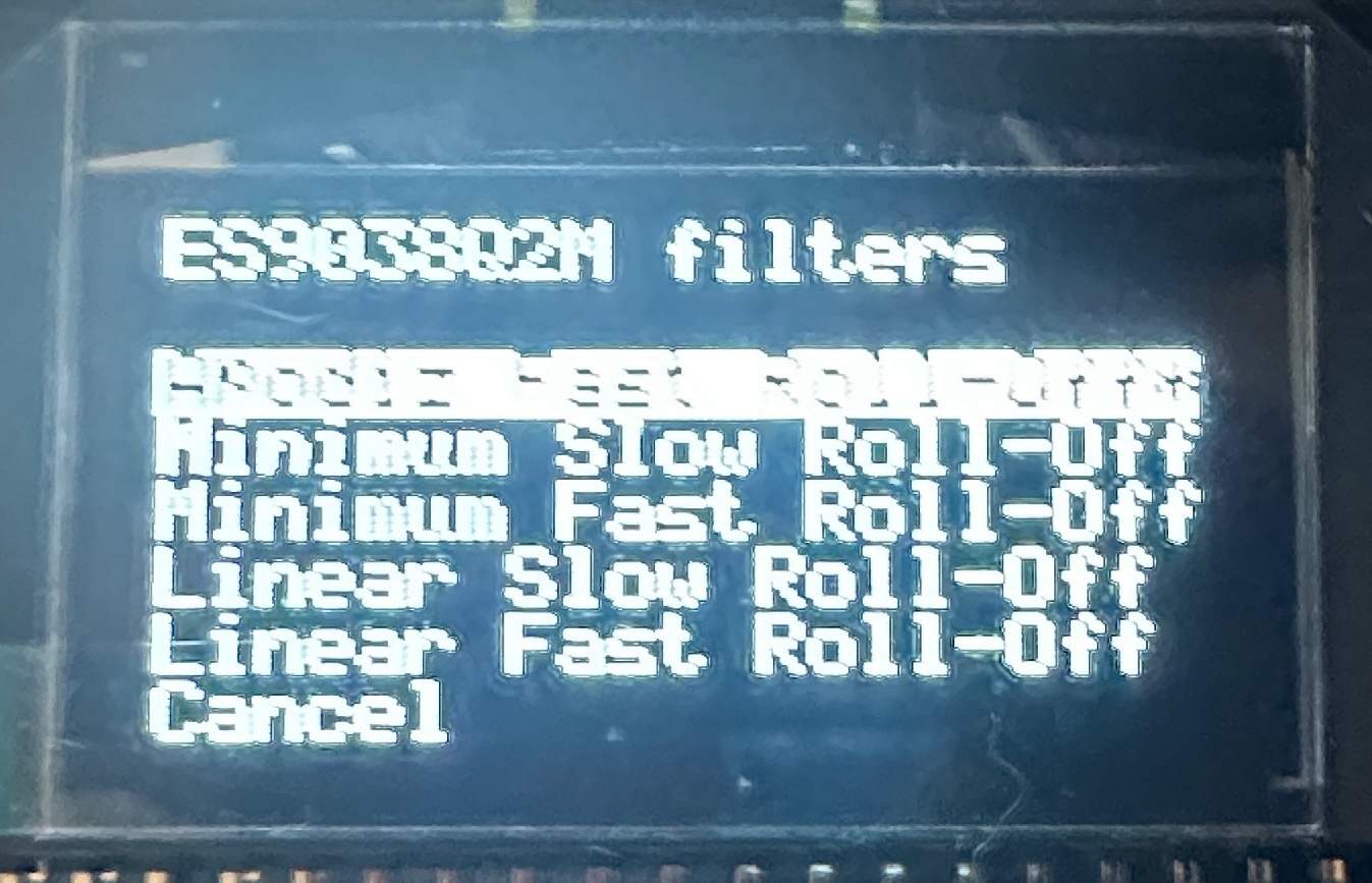

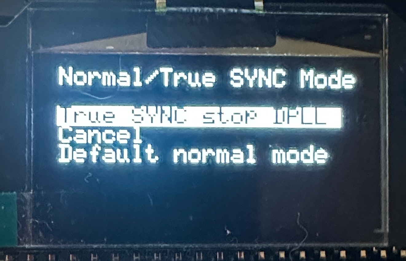

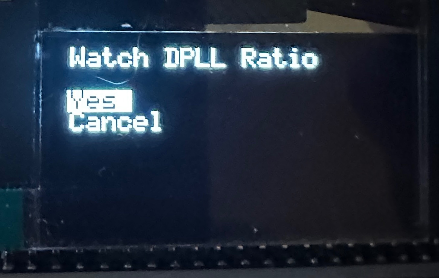

I've just installed a ES9038Q2M dual mono II DAC with the OPA861 zero feedback bal I/V board on top an Rpi with FiFOPI Q3
I've also the Monitor PI PRO where there are many setting for the DAC that I can't find any documentation.
I've also removed the DAC clock and I've connected the M/Clock signal from FifoPIQ3 to ESS DAC
Are there suggested setting to use with IAN ES9038Q2M DAC ?
I'm posting the screenshot of the setting I'm trying to figure out how to configure
Any help will be appreciated

The filters are the out of the box ESS ones and should be on the datasheet. The lower the DPLL, the better possible SQ but source dependent and True-Sync is the ultimate of that. If you can bypass OSF thats the best sonic performance, but you loose volume control and if I remember correctly you need to be upsampling to 358/384 prior.

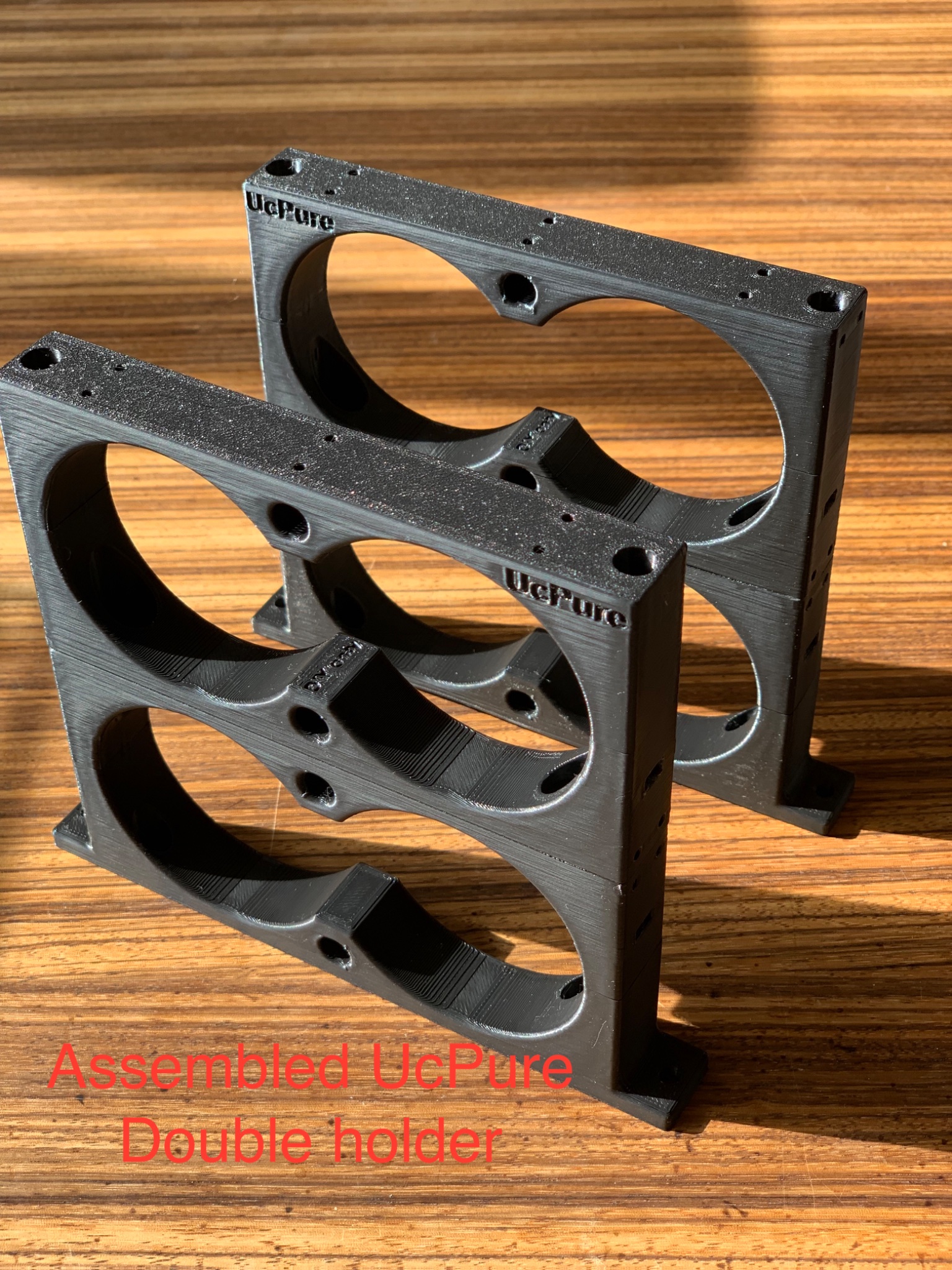

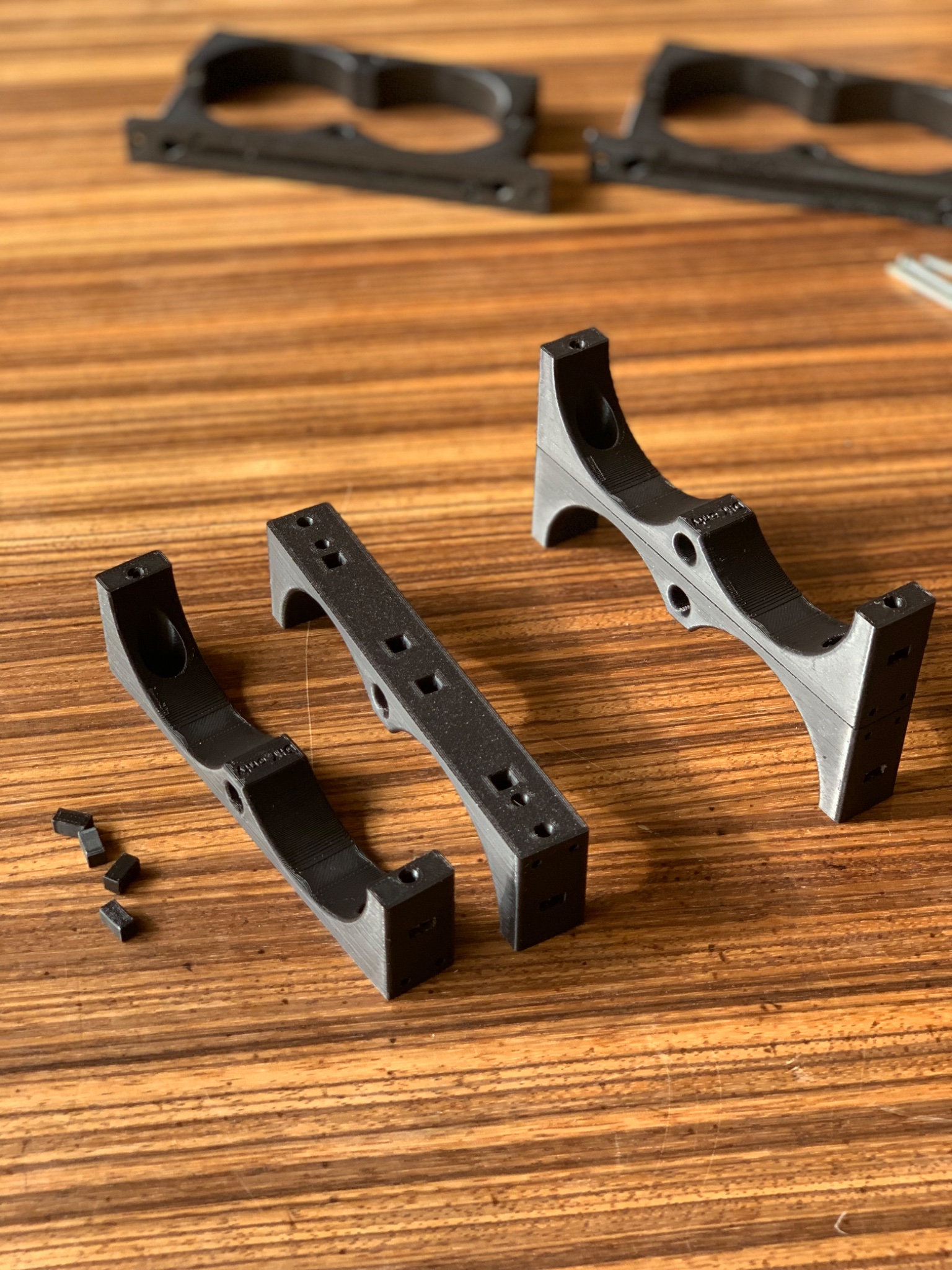

UcPure holder now with added center piece to build a UcPure Double
A fellow DIY'er asked if it was possible to stack two UcPure holders on top of each other to build a double/quad UcPure. It is of course possible but I created a center piece to make it easier.
Ian has of course his Quad solution but this I more meant for a plus/minus 5V supply for an analog stage.
The center Piece can be downloaded for free at: UcPure Holder - Thingiverse
Here is a picture of the finished UcPure Double and some printed parts (thanks for the picture Jay):

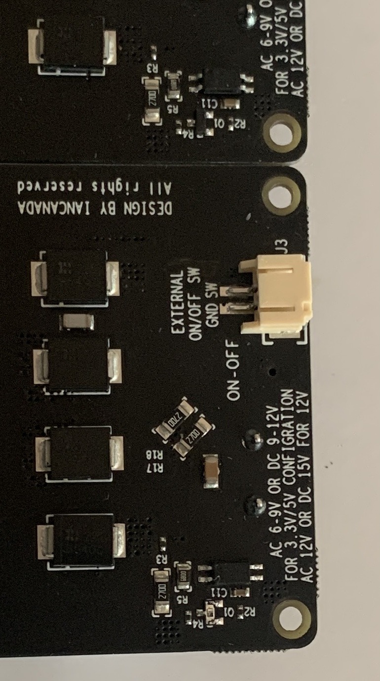

Is there anybody who know what Q1 is on a linearpi, it has blow the top away, ser photo. View attachment 1362592
Not sure if you got a response yet, maybe I overlooked it, but Q means transistor.
I wouldn't trust it if it's blown off, but I guess you could measure it so see if it's still functional.
Otherwise, maybe the manual specifies what the specs are, and you can replace it.
And maybe contact Ian on it.
