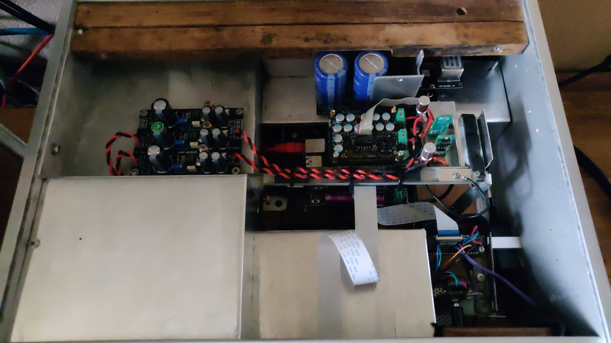

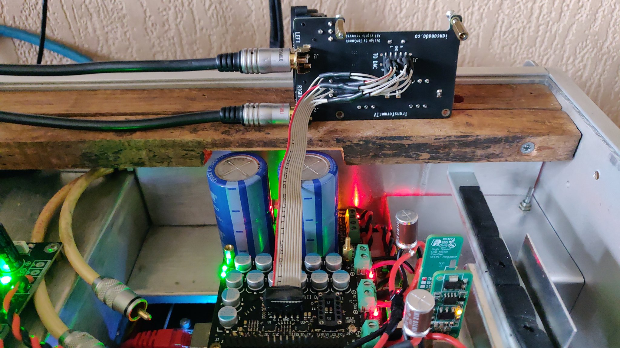

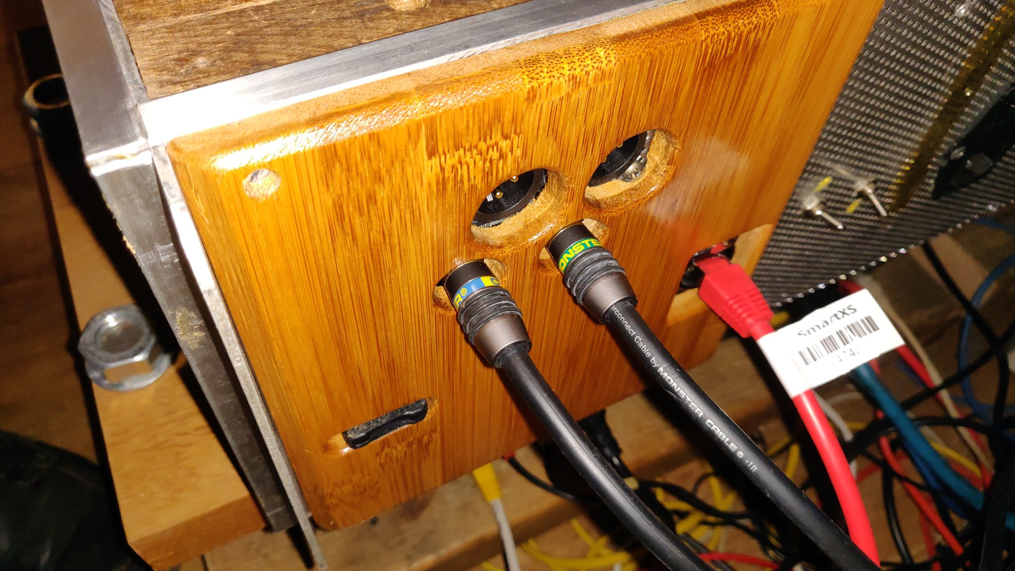

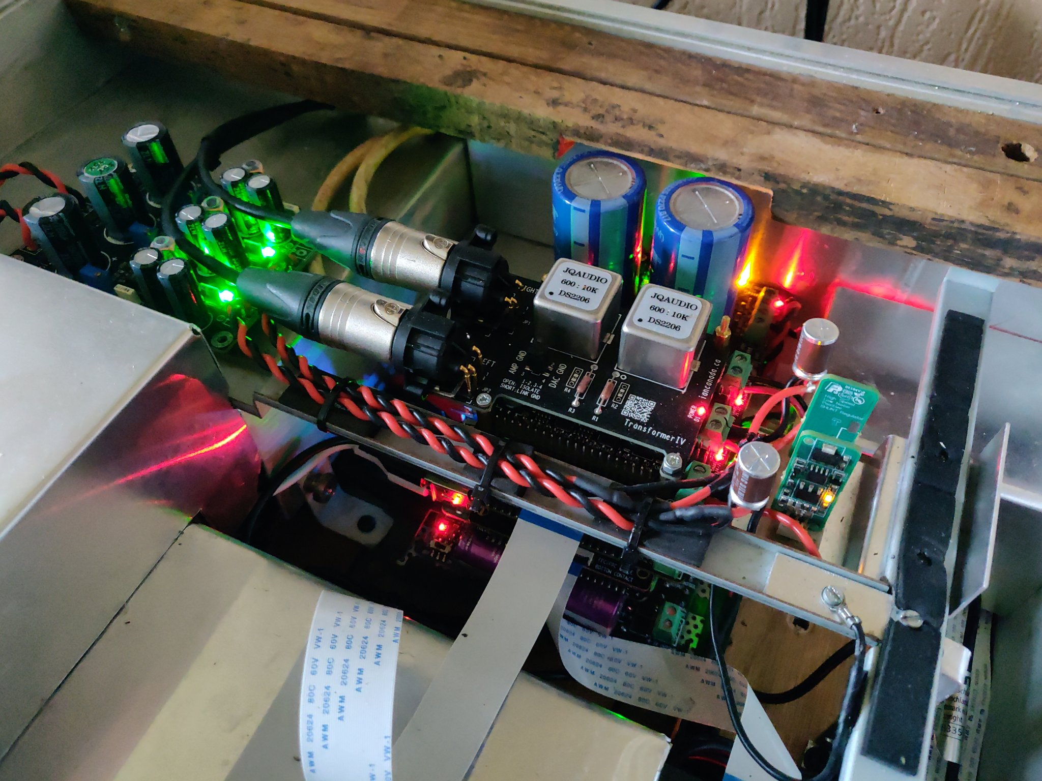

the IV outputs moved with a cable to the top right, no longer on top of the ess mk2 dac and therefore no interlinks... last photo.
piece of wood was used because the back no longer looked good due to a lot of moving.
a bit strange layout of the outputs, but it's a wake-up call. Next week I will tackle the right side with wood.
I also has this problem thinking for a long time how to make an enclosure for my Purepi II streamer and Stationpi pro Dac with this board and connector layout.
So I decided maybe I will just desolder all the XLR/RCA connectors and use a normal enclosure. For the Pi access just have to cut a bigger rectangle hole and push it as close to the enclosure wall as possible. Only problem is the i2s HDMI Connector which maybe hard to access.
