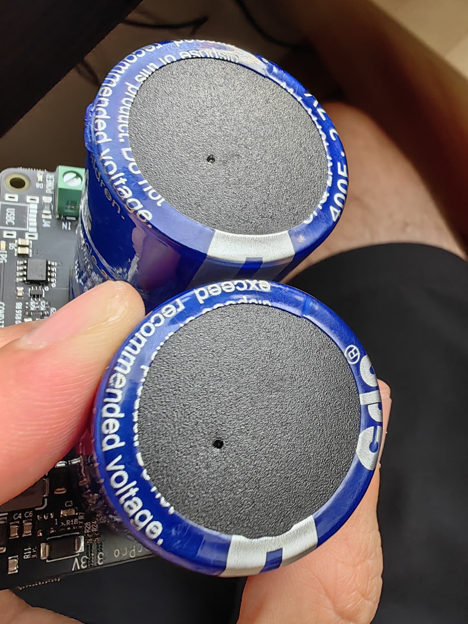

looks like damage to me , I would contact the company and ask for an explanation of why those holes exist, If they cannot give you a valid explanation, return it as damaged . who knows why those holes are there, and they are Ultra capacitors , so don't take any risks
perhaps a safety valve to release any pressure if they are in danger of breaking

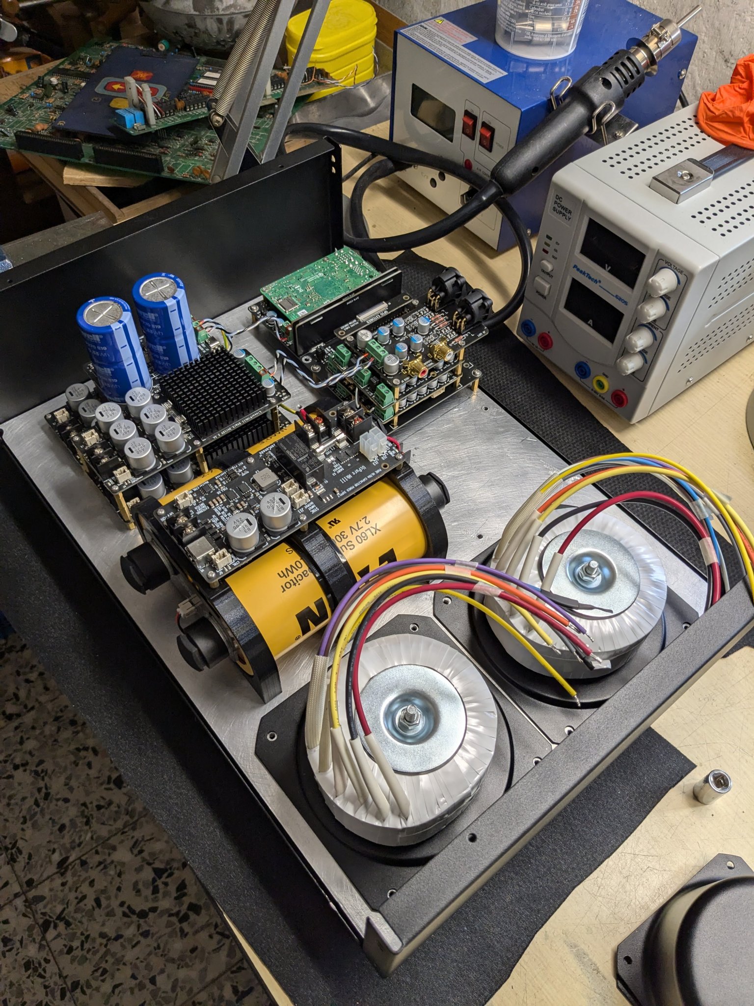

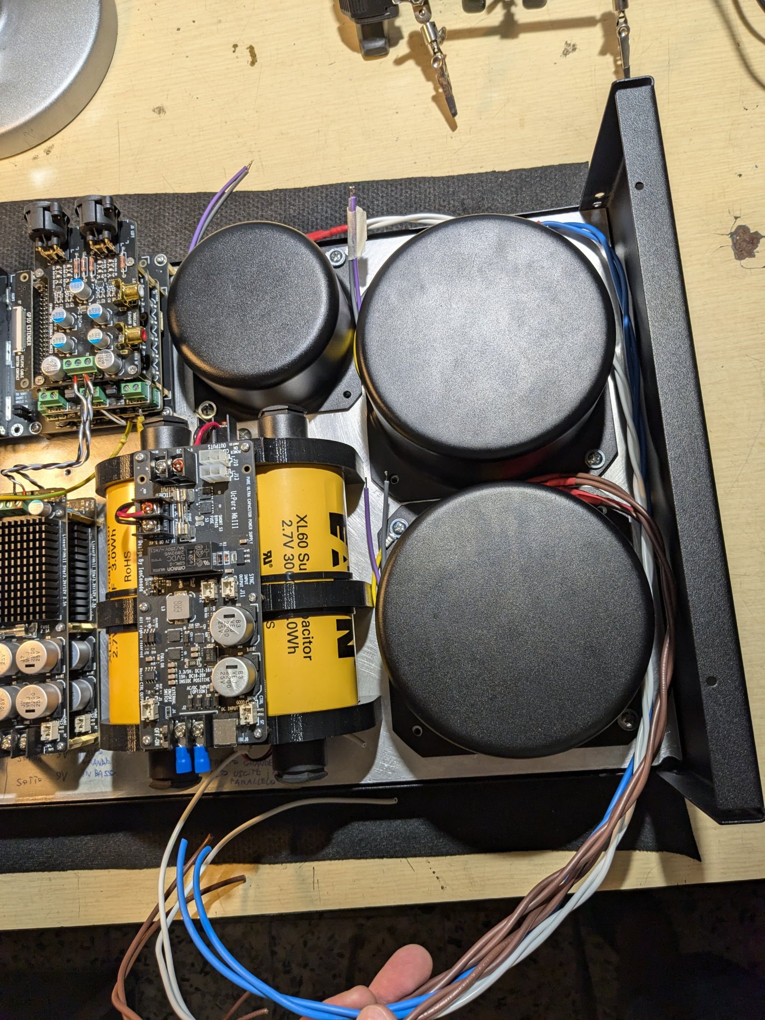

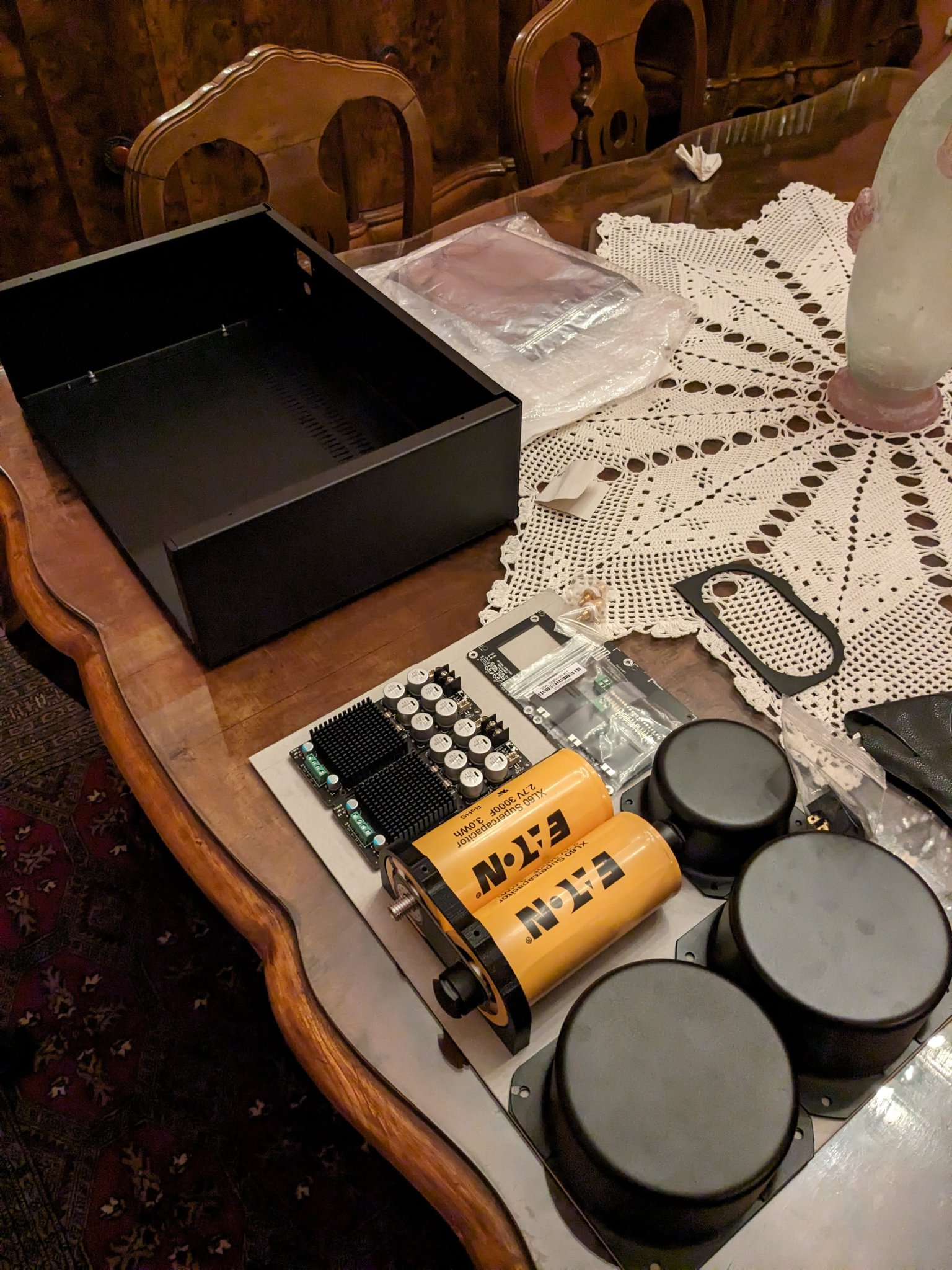

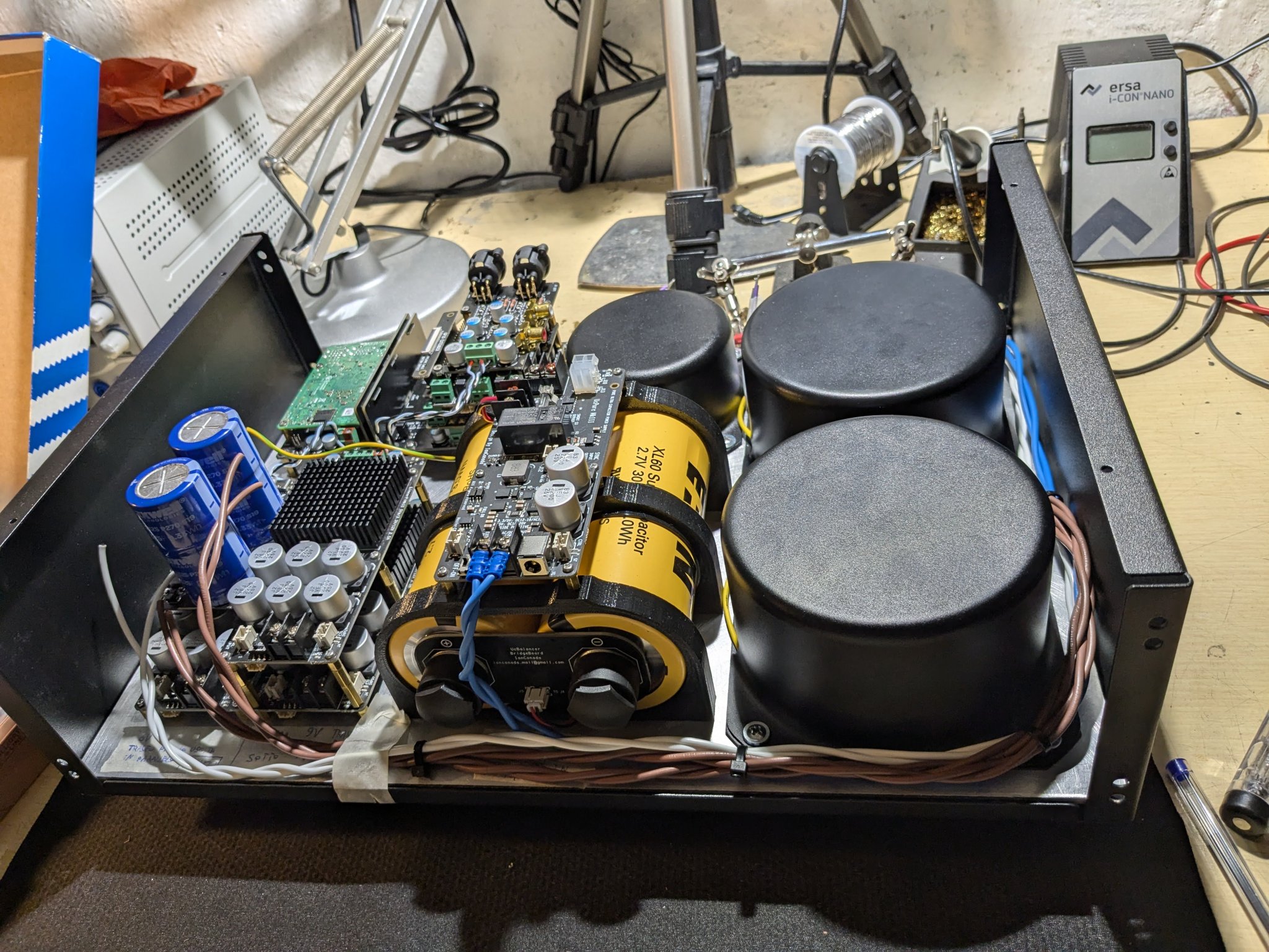

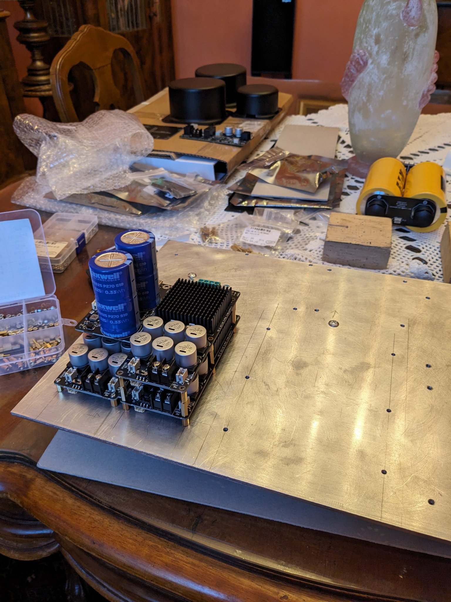

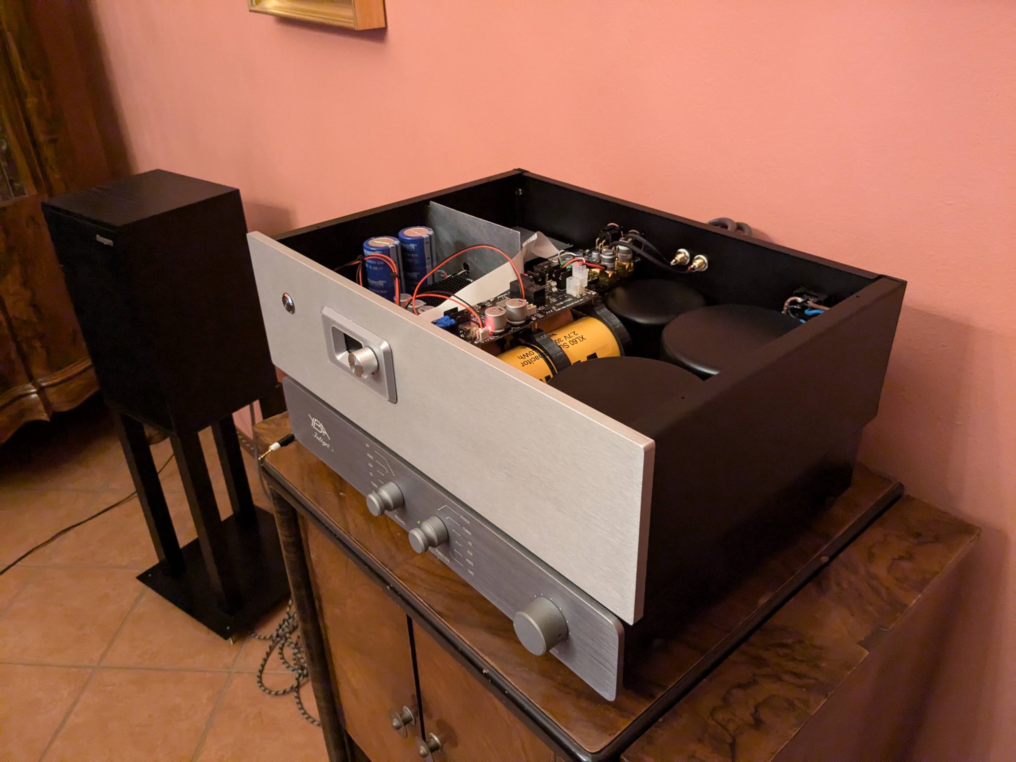

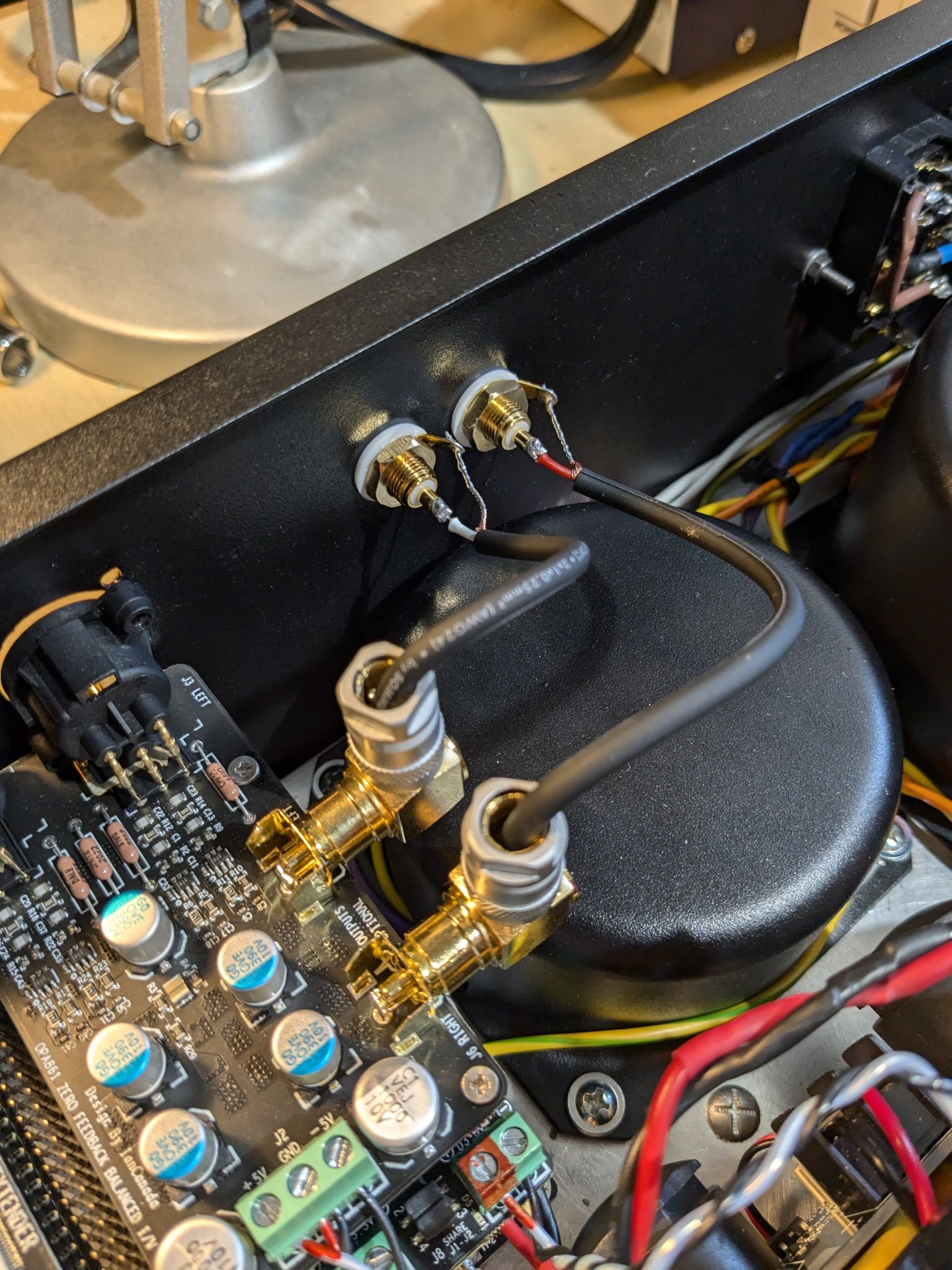

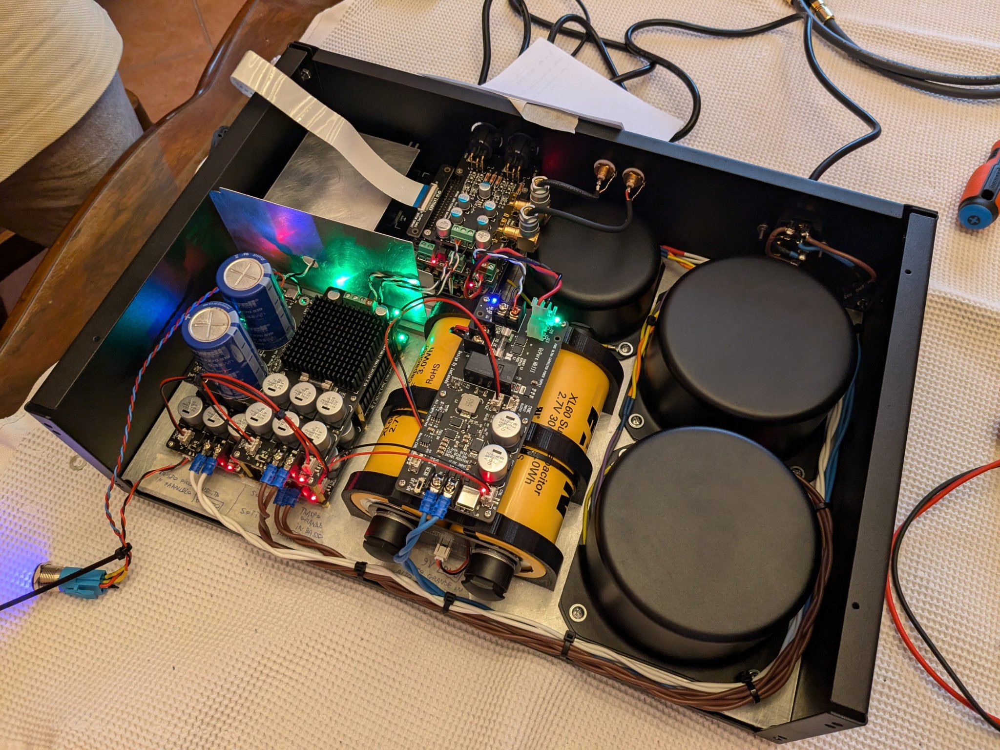

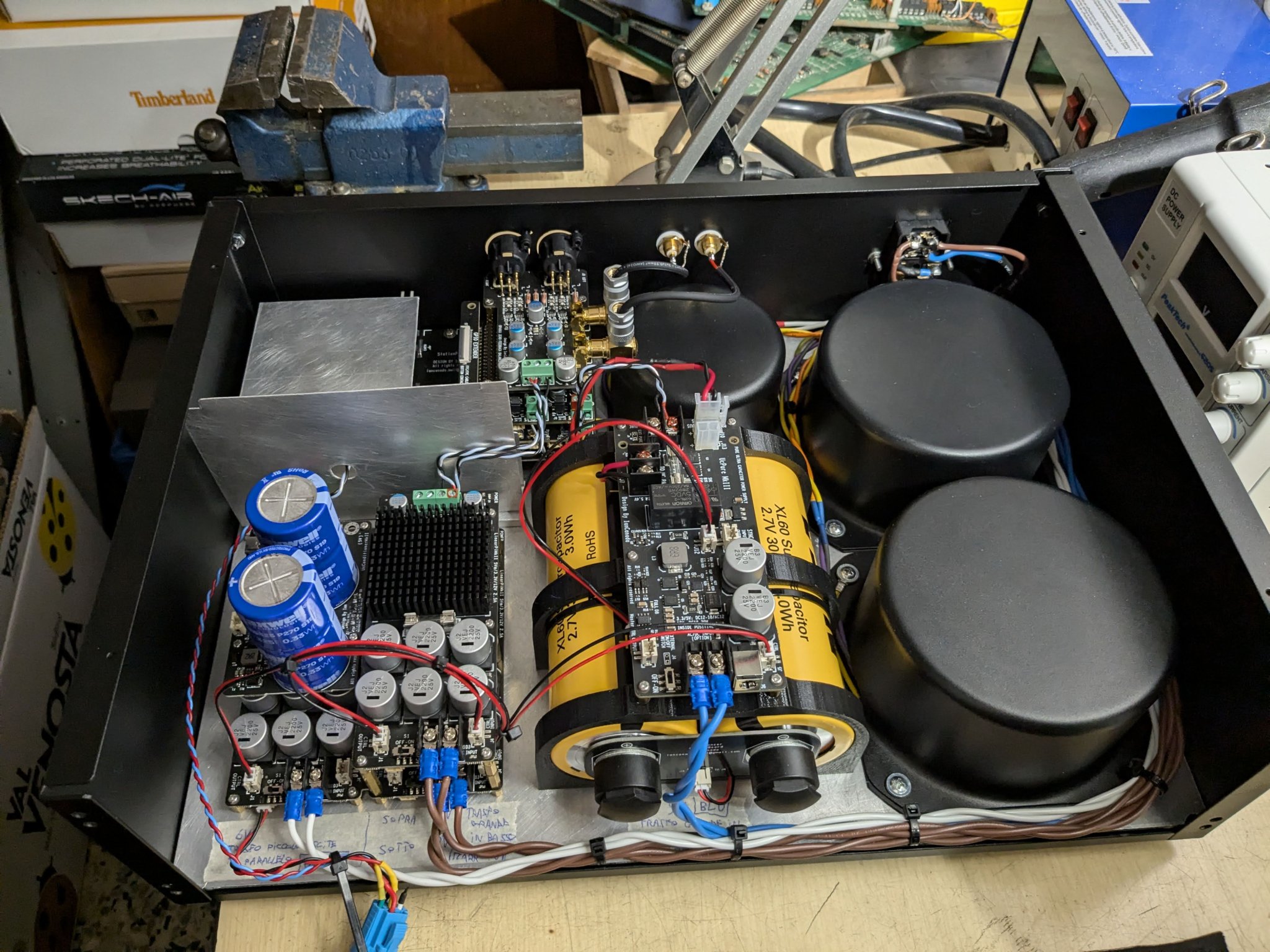

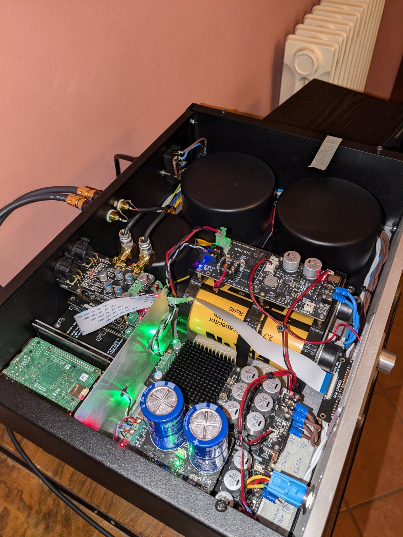

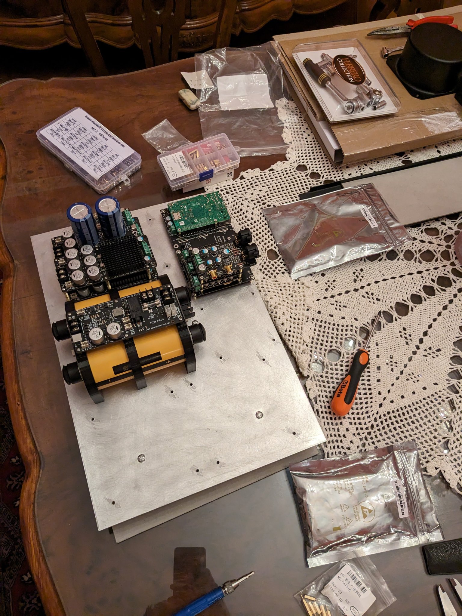

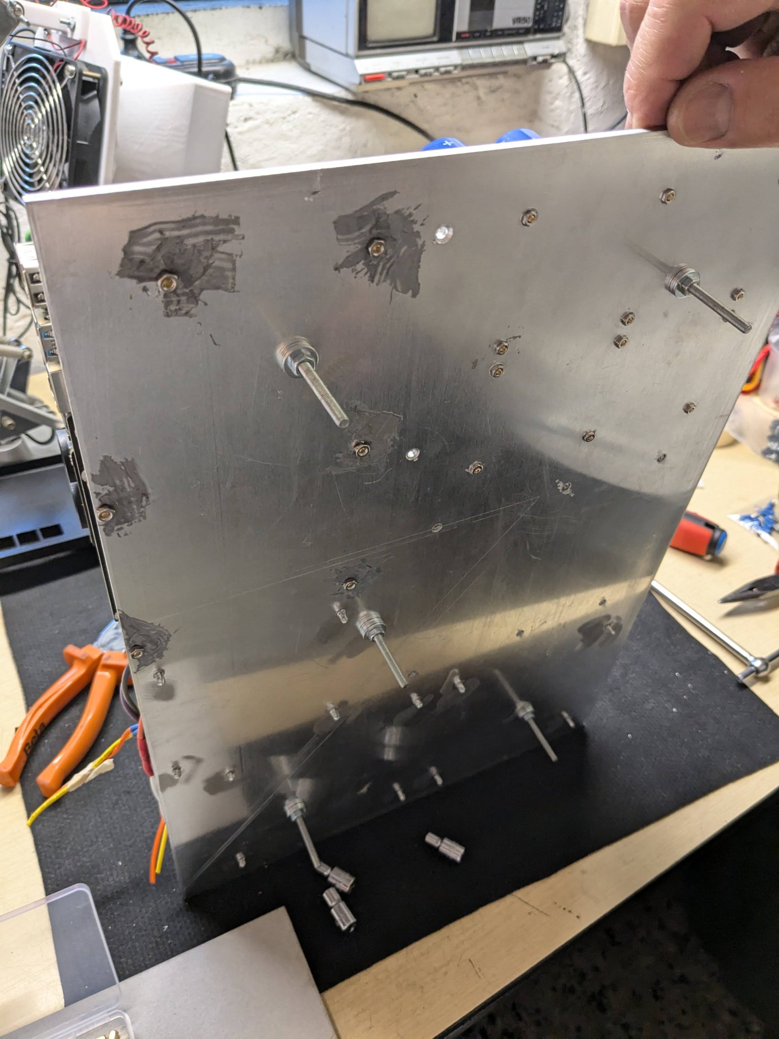

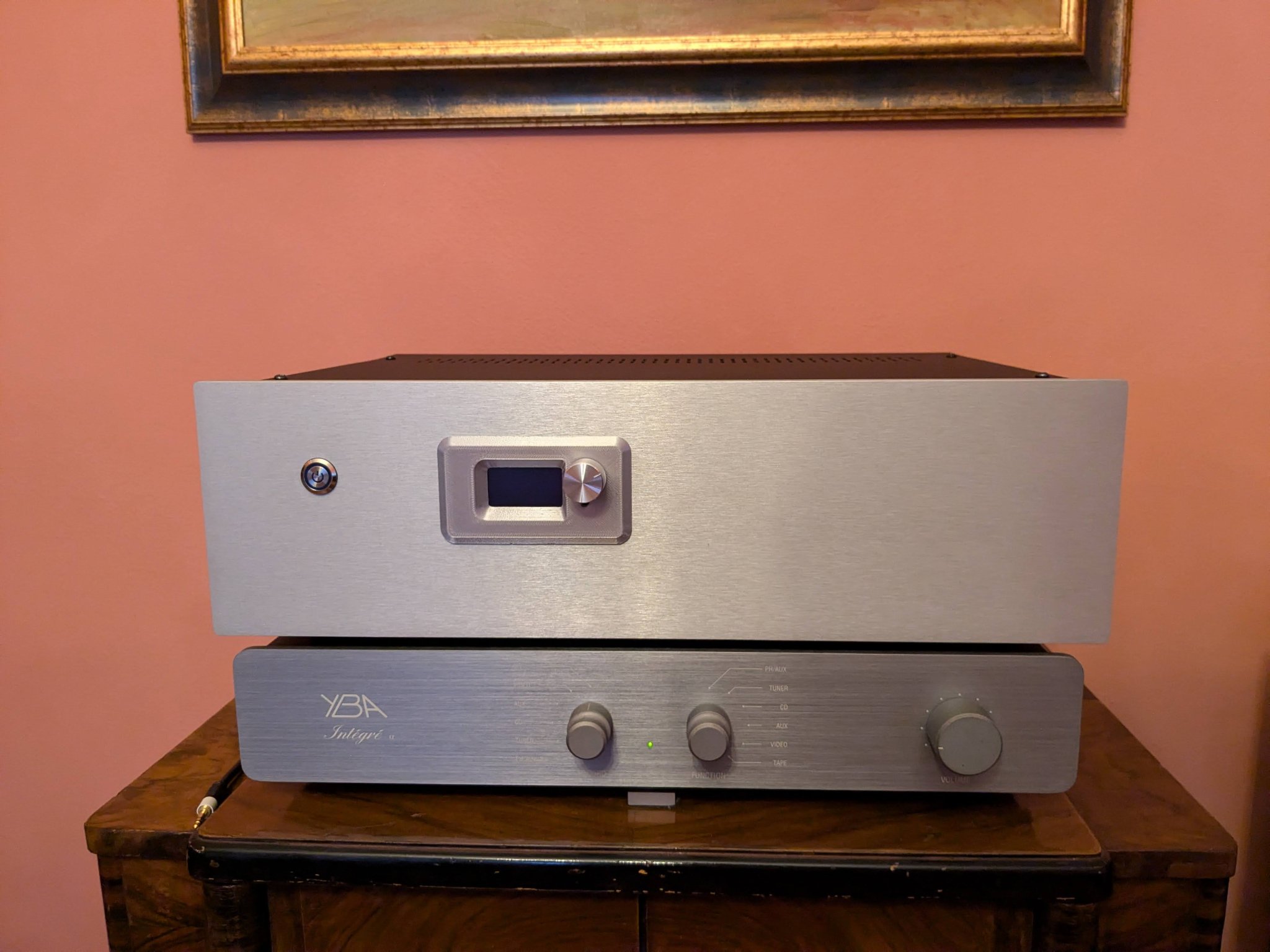

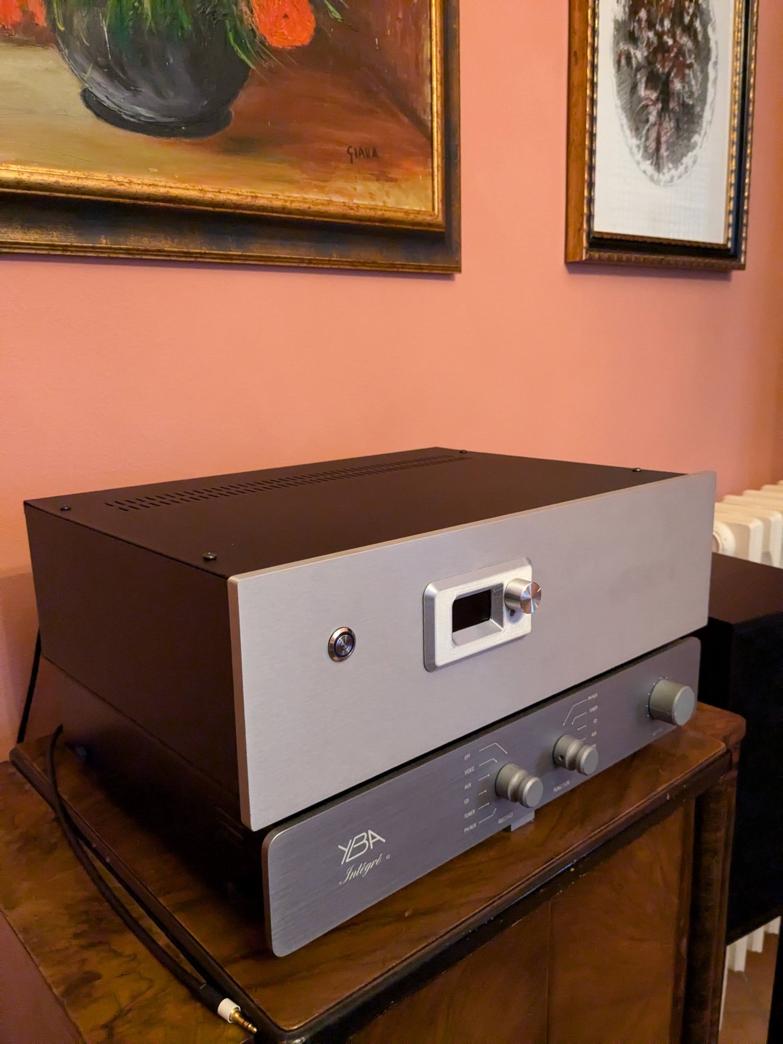

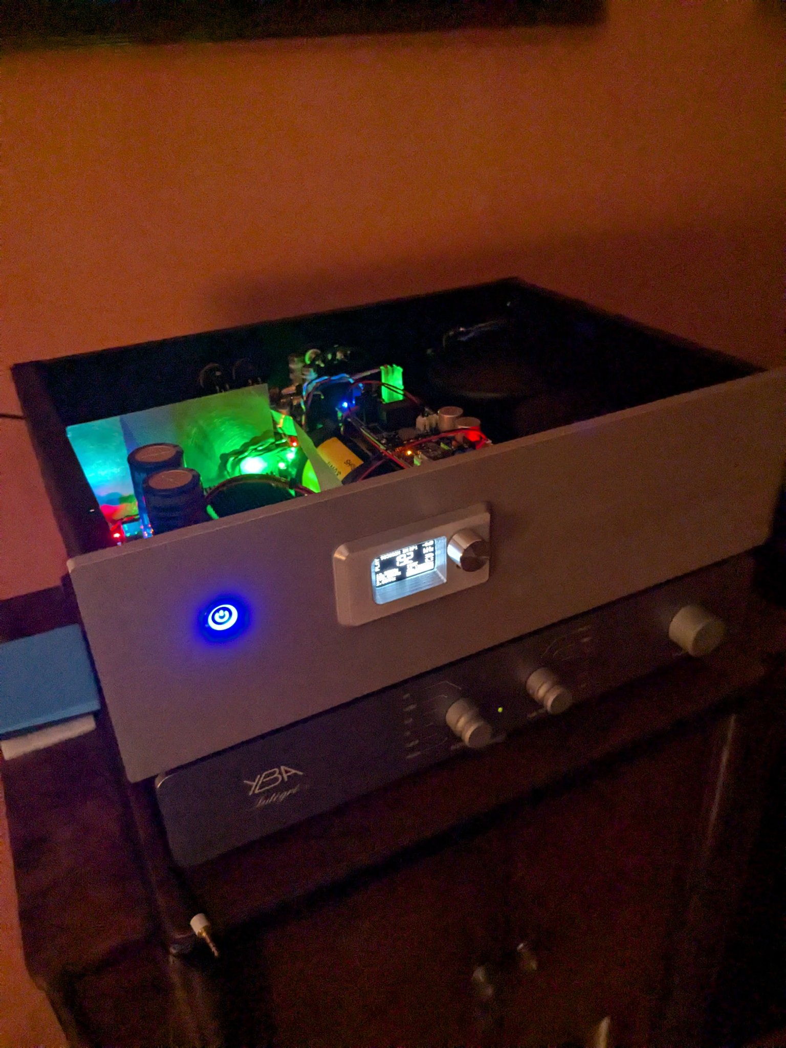

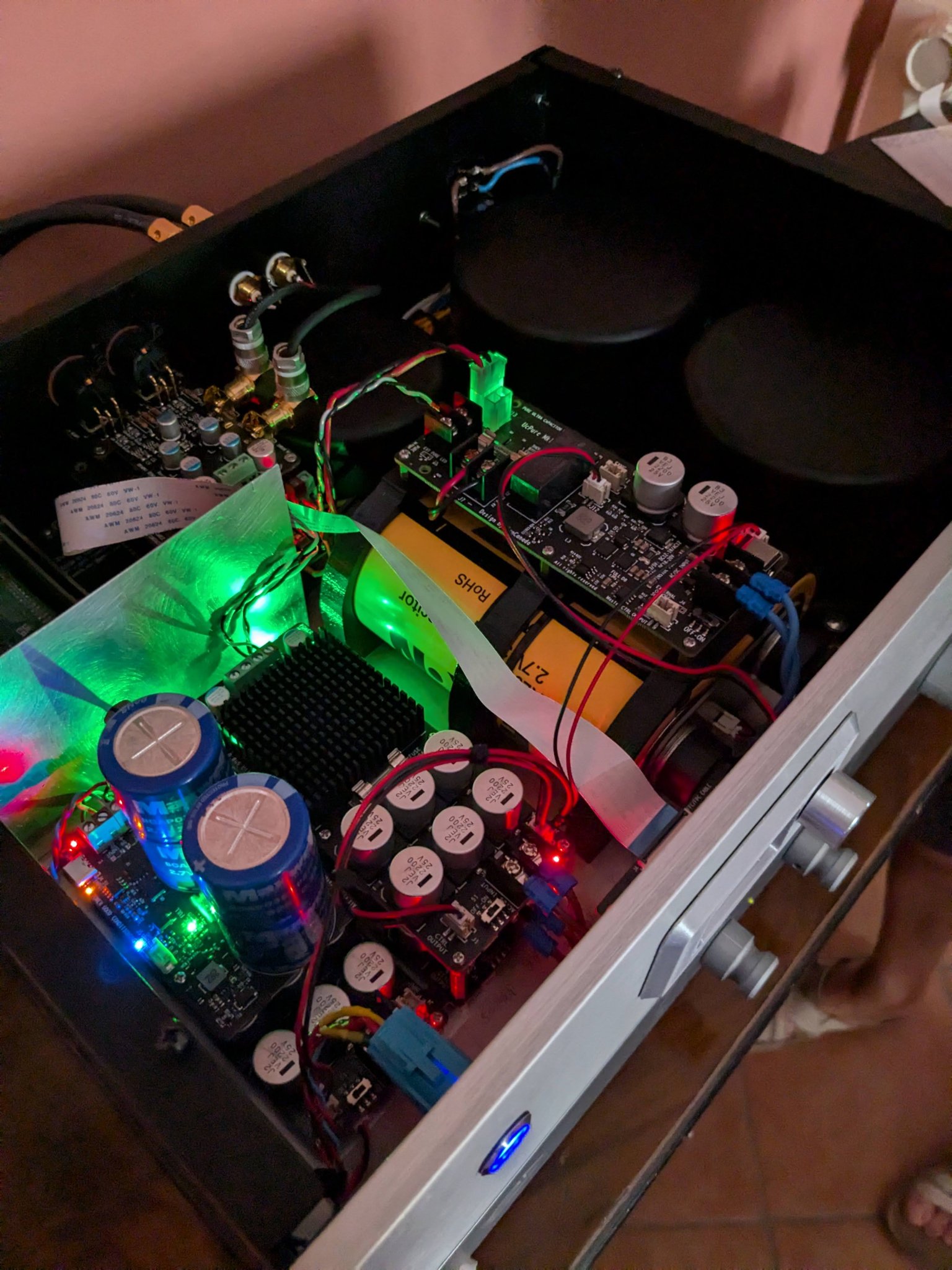

Hello everyone, I want to present you my finished project!
Took a long time, but I think it came out extremely well and I can't be more proud of it 🙂.
It's a IanCanada parts based Streamer/DAC combo.
Main system:
Star grounding of all shields.
Needless to say, it sounds fantastic.
Filmed the whole time, from design to final assembly; I'll someday post a video on youtube about my journey through this project, just need to find time to edit an overall and explicated video. Meanwhile, here are some pics collected during these months.
I'm planning to make a transparent upper cover. Spent a lot of time to be mm precise with every detail and I think the internal came out really clean and neat, it's almost a pity to hide it all!
If you want, let me know what you think!
Thank you all.
Mark
Main system:
- StationPi SMT
- Raspberry Pi 4b 2GB
- FifoPi Q7 II (old stock clocks, upgrading soon to accusilicon's as318b)
- ES9038Q2M Dual Mono II DAC
- OPA861 I/V board
- MonitorPi Pro (used as fifopi controller)
- LinearPi + UcConditioner 5v [to stationPi]
- 2 LinearPi [to I/V board]
- UcPure 3.3V configuration + UcBalancer [shared between FifoPi and Dac board]
- Triad Magnetics transformers, Eaton Supercapacitors, Maxwell Supercapacitors.
Thank you all.
Mark

@Markmaister Nice work!
Question on the power button in the front, how do you wire things?
I see two wires go to the output of the LinearPi for the Raspberry Pi, but also wires to the input side?
@weust Thank you.
The front button is a latched position on/off switch. It is connected to the "external on/off switch" connector of a linearpi, which is the master of the power chain (all power supplies connected in a master/slave cascade chain), so it turns on and off the output of every supply. The other 2 cables are just the power for the LED, it needs 5V and is connected to the ucconditioner output. When the switch is off the output of the linearpi (then ucconditioner) is off, led is off; when switch is on the output turns on and so do the led.
There is also a main switch in the back that connects to transformer's mains, so it open and close the input line of every power supply. It is meant to be able to disconnect the UC charging circuit of the UcPure, so they don't stay charged when no used for long time, no real use for linearpis indeed.
