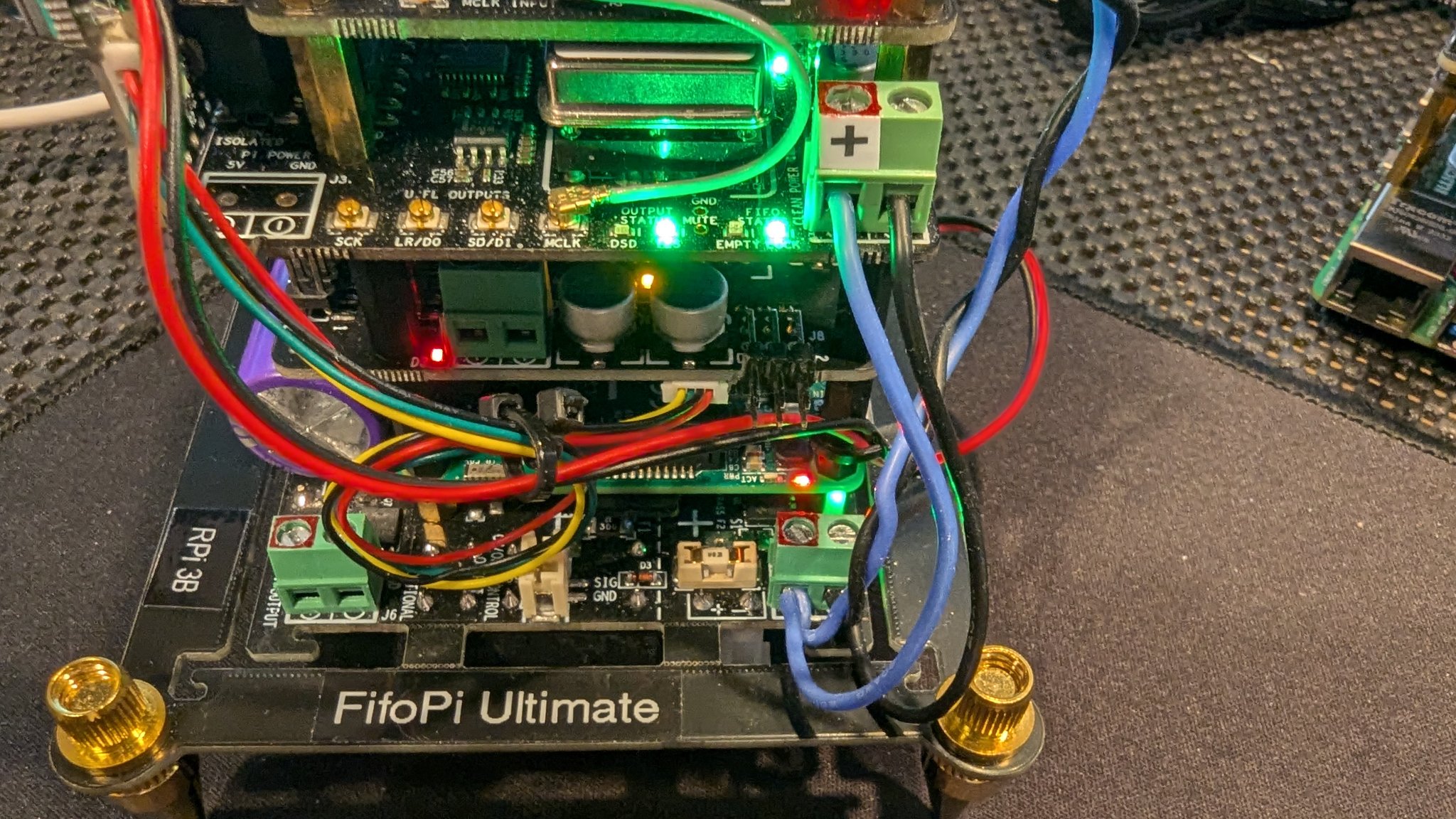

Well I'm really regretting this now. This time it is not my fault. I just got the Station Pi SMT along with a brand new Q7, I also have the UcPi and I was waiting on some parts for the Station Pi which I got today. I decided to take the UCPi stack apart and start putting together the Station SMT. I check to make sure everything was connected correctly, I wired the UCPi from the terminal post to the Station Pi, and then wired the 3.3v on the Q7. The terminal post on the Q7 and on the Station Pi are opposite. So I wired the Q7 exactly the same orientation as the SMT. You can clearly see the post marked on the SMT, but the post covers it up on the Q7...and just check for continuity on the 3.3 on the Q7 and I got nothing, it was working for a day...I guess I'll email Ian and see if he's willing to do anything, if not I think i am done with this, which really really sucks because I just sold my Bluesound Node, and I am really regretting this now! I had to look at the bottom of the Q7 before I realized what I had done.
Well OK. After a pretty crappy sleepless night I thought "maybe I should at least try to hook up the UCPure correctly and see what happens. I blew two fuses, but they did blow, so just for the heck of it I put another new fuse in it and hooked it up correctly, and low and behold...it's not fried. For some reason that terminal does not read continuity, but I just powered it up and played a song...and it's working. I am so relieved. But I think I'm gonna get a red paint marker and mark with a red dot all the positive terminals.

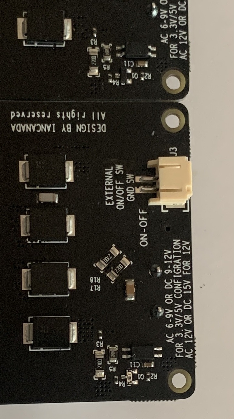

Is there anybody who know what Q1 is on a linearpi, it has blow the top away, ser photo.
As a matter of course, I mark all power terminal blocks (Phoenix Connectors) with a red sharpie. It helps keep me from getting confused. I also mark all LinearPis with their set voltage on the top and edge so there's no mistaking the voltage I'm using it for.
Very good idea. I'm gonna pick up a red paint pen if I can find one. Sharpies are OK, but I like the paint pens. But if I can't find a red one, I'll get a sharpie like you mentioned. Thank you. I just have to say once again how relieved I am. I was really getting into this, and I was getting pretty excited, only to have all my expectations destroyed, or so I thought. Fortunately as it turns out my dejection lasted less than 12 hours...

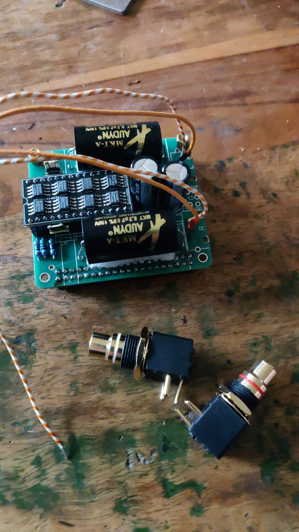

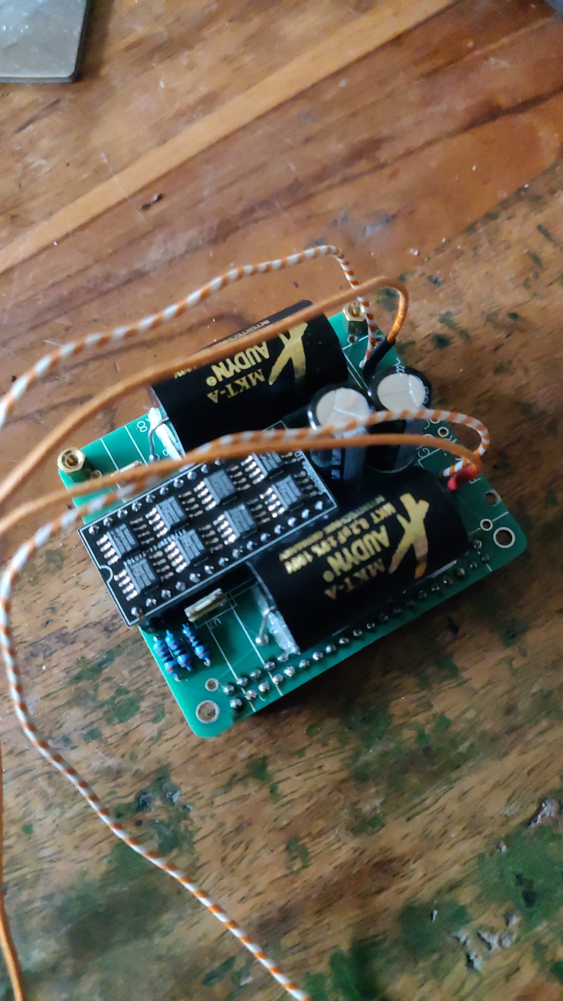

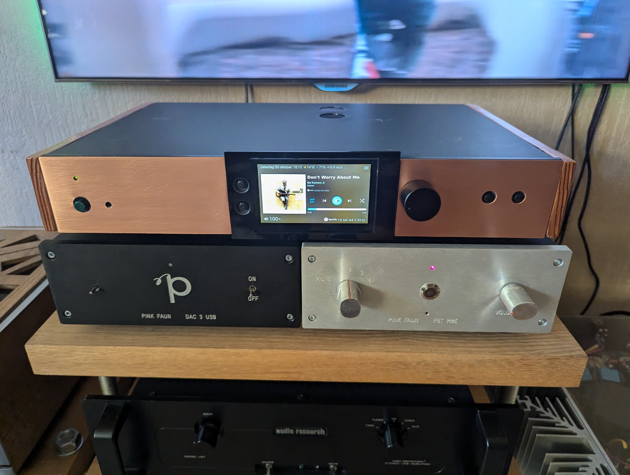

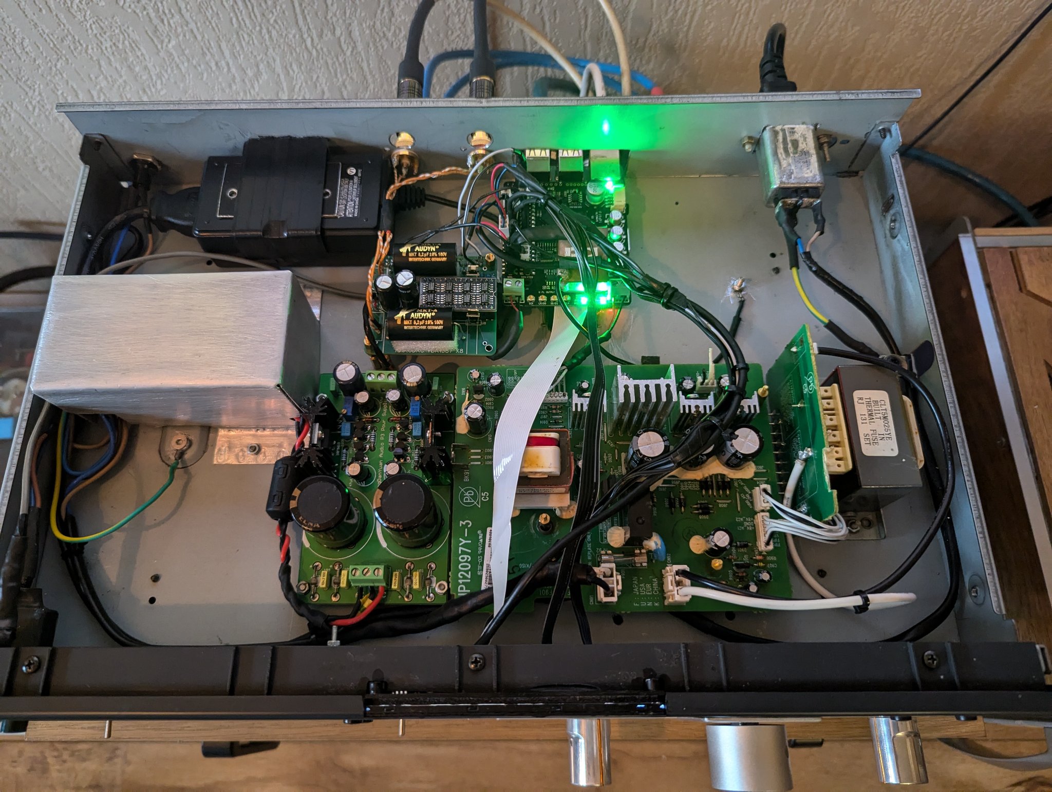

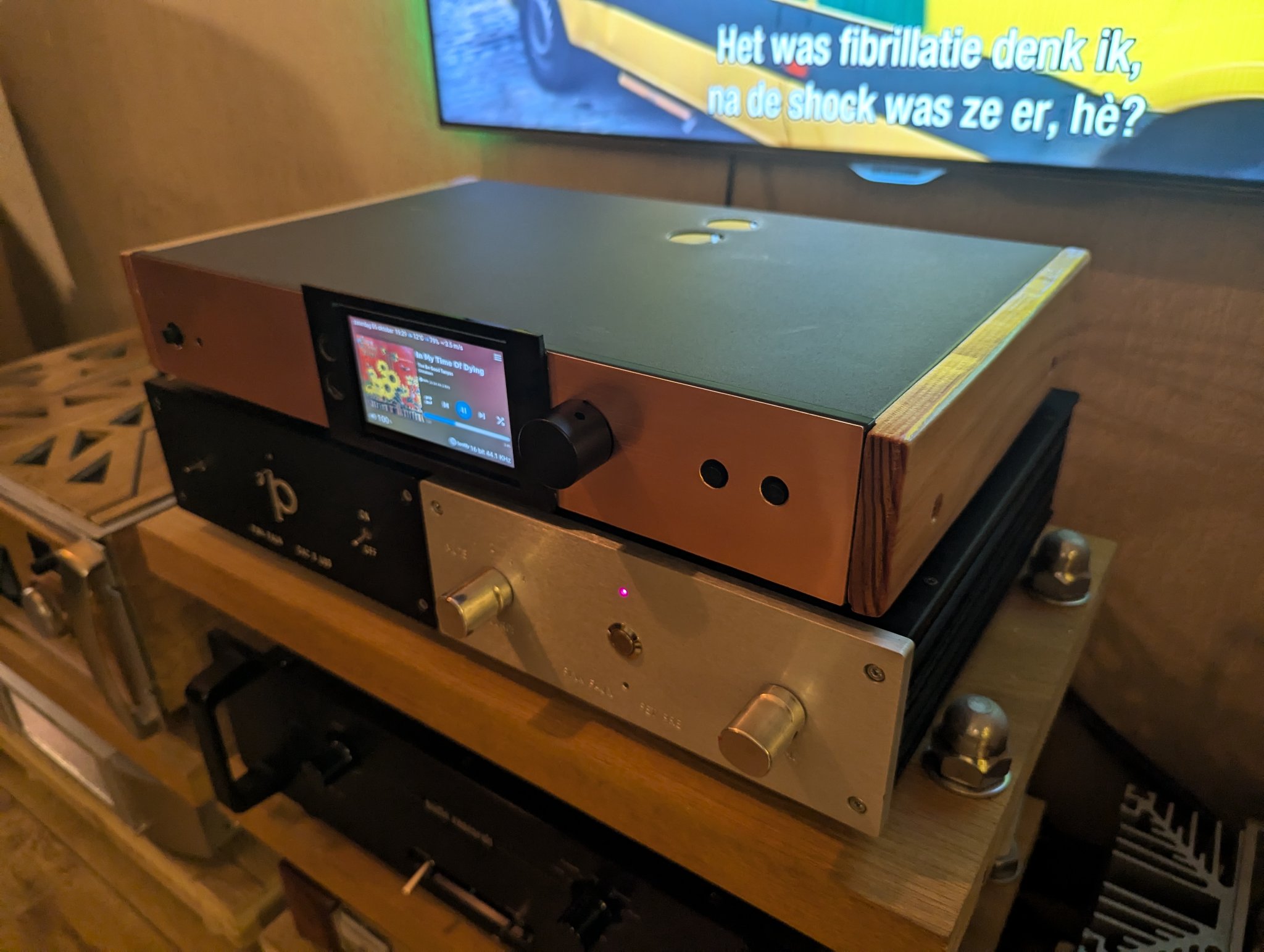

I added an old Q2 ultimate reclocker to a ProtoDac with accusilicon clocks.
sounds very nice.
I installed everything in an old Nad tuner, including the copper front with frame for a 4.3 inch screen that I made myself.
I have given the existing buttons a function, including a rotary encoder and infrared.
I was able to reuse certain electronic parts of the NAD.
