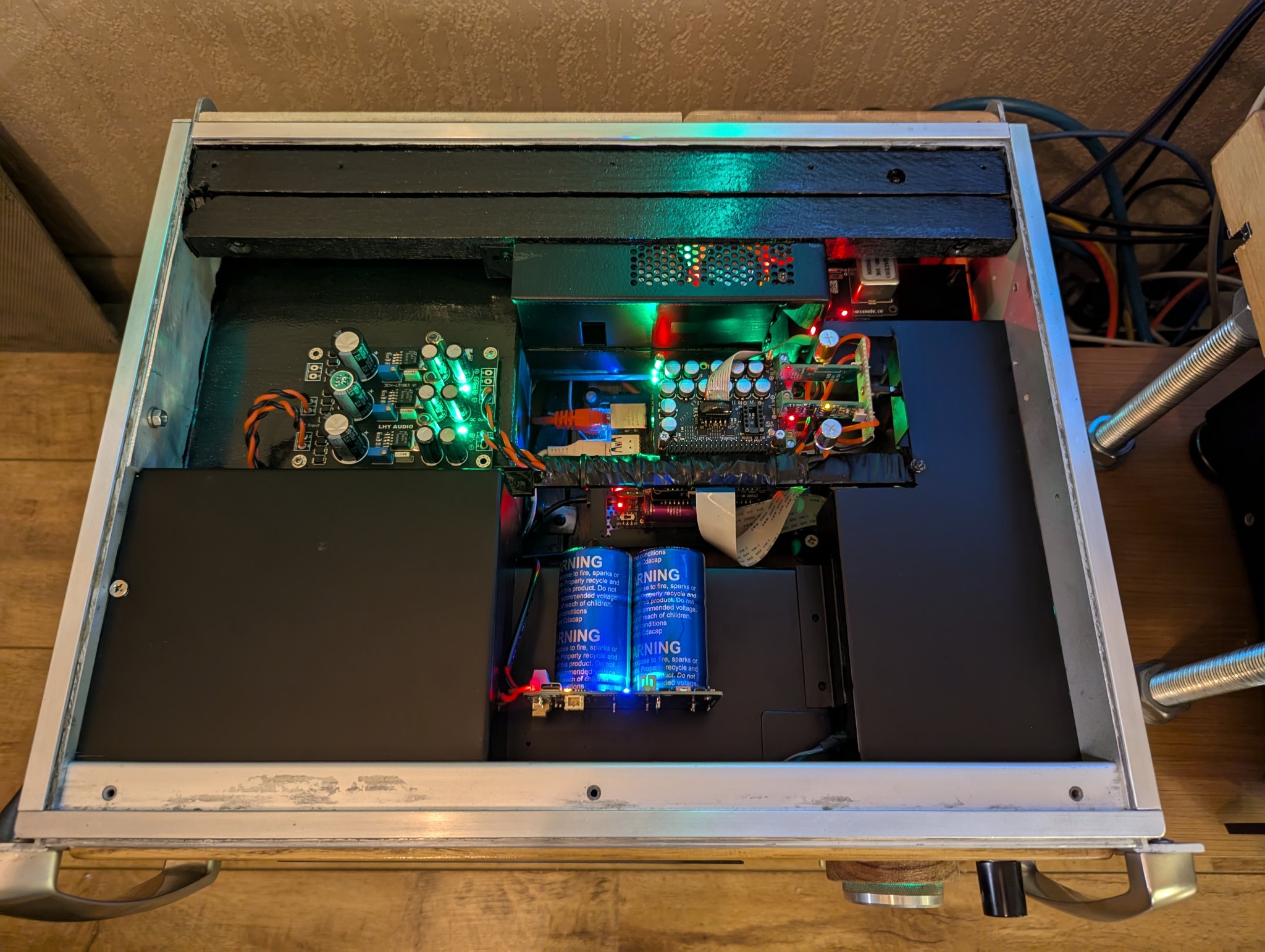

Placing Ultra Capacitors in front of Ultra Capacitors? I highly doubt that would make any sense.
It's not much, but it does provide some improvement/change, the small details are more audible and everything comes out a little easier and smoother. this is clearly audible in the quiet passages.
or I'm fooling myself and it's all in my head.
