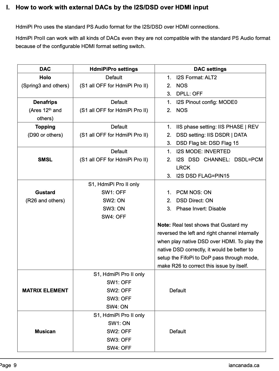

Thanks for the response! So this effectively says that the default setting of the HdmiPiPro matches the default setting of the Denafrips (Mode 0), which is great as no additional configuration would be needed. I had read somewhere earlier in this thread that someone had co that this was not the case and the settings would need to be changed. This document confirms otherwise n
Just curious about the NOS setting on the DAC: I’m assuming this means that the Denafrips will not (or cannot) do oversampling when connected to the HdmiPiPro. Why would this be? sorry if the answer is obvious, I’m still learning my way.
Interesting, I’ll need to read up on this. So what does the NOS/OS toggle button do, and does it matter what setting it’s on when connected to HdmiPi or do I need to make sure it’s in NOS?
