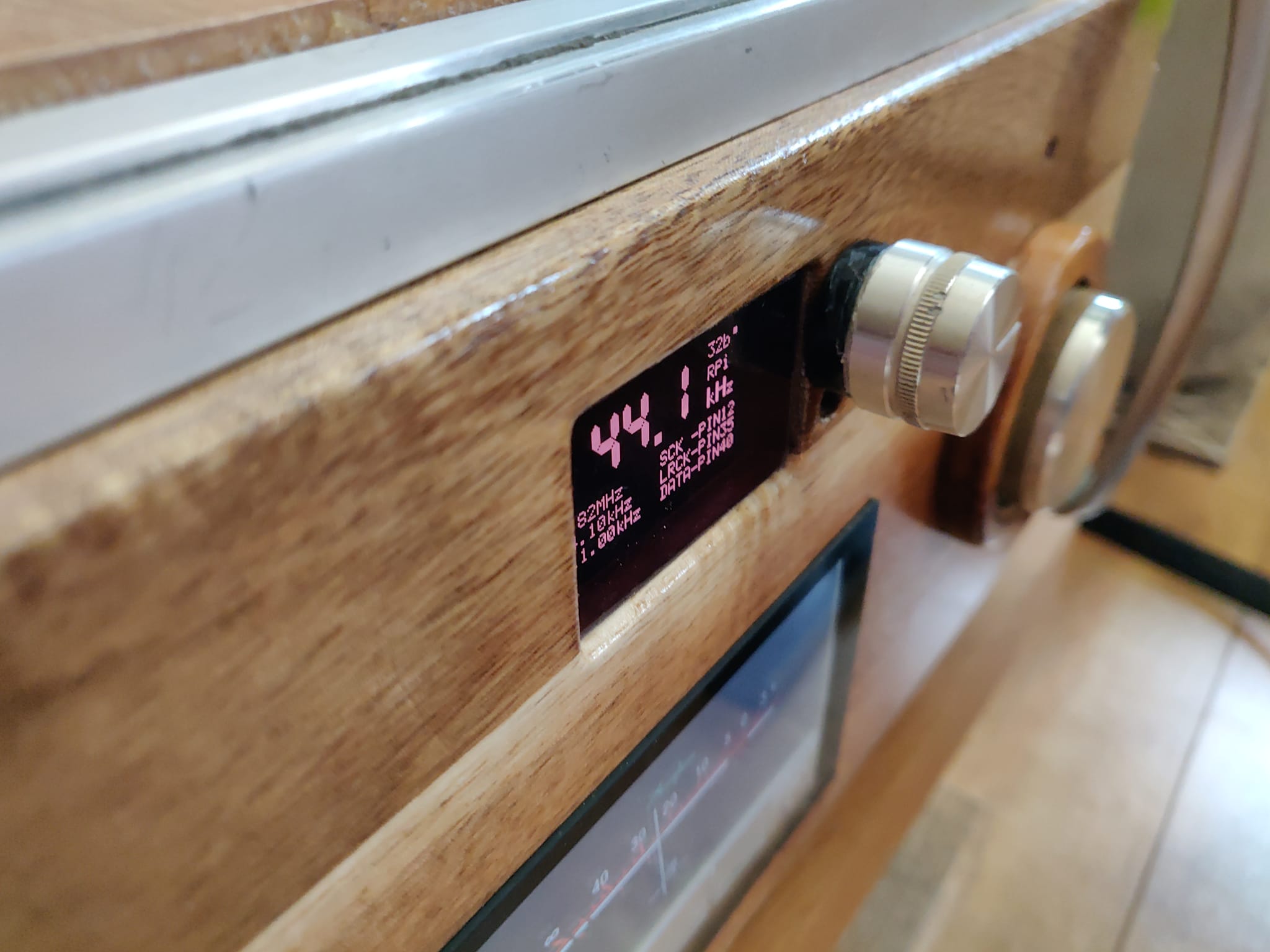

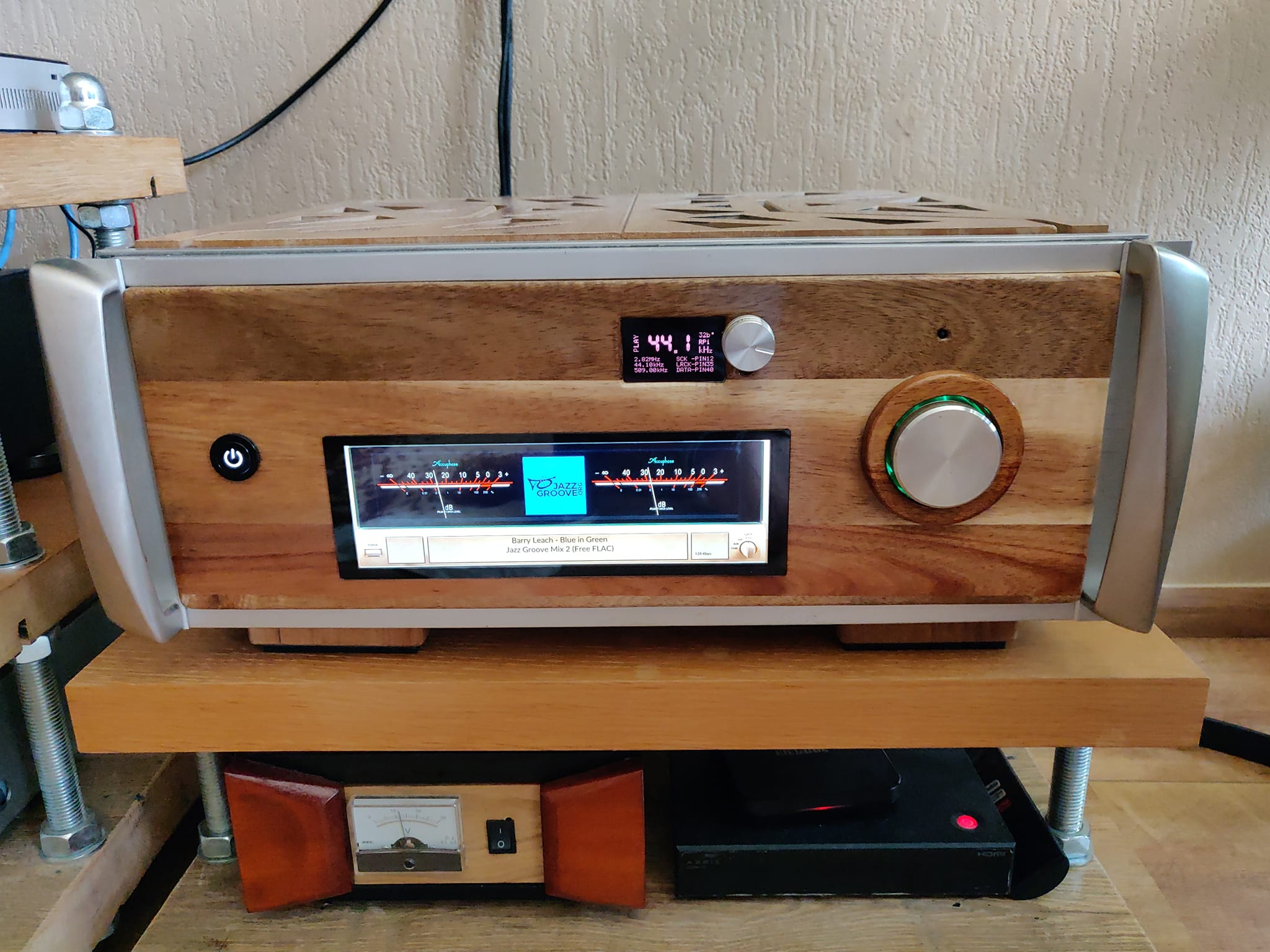

and ready, smoke glass is in front of the monitor pi pro screen 🙂
Finally, a UcPure MK3 must be purchased, which will eventually happen.
But enough for now and I'm going to enjoy the music.

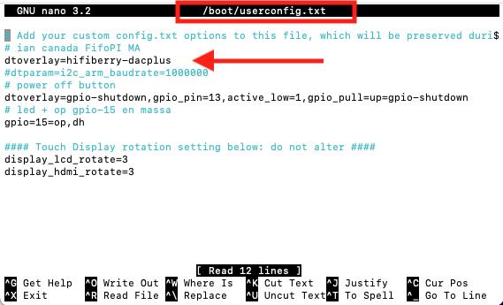

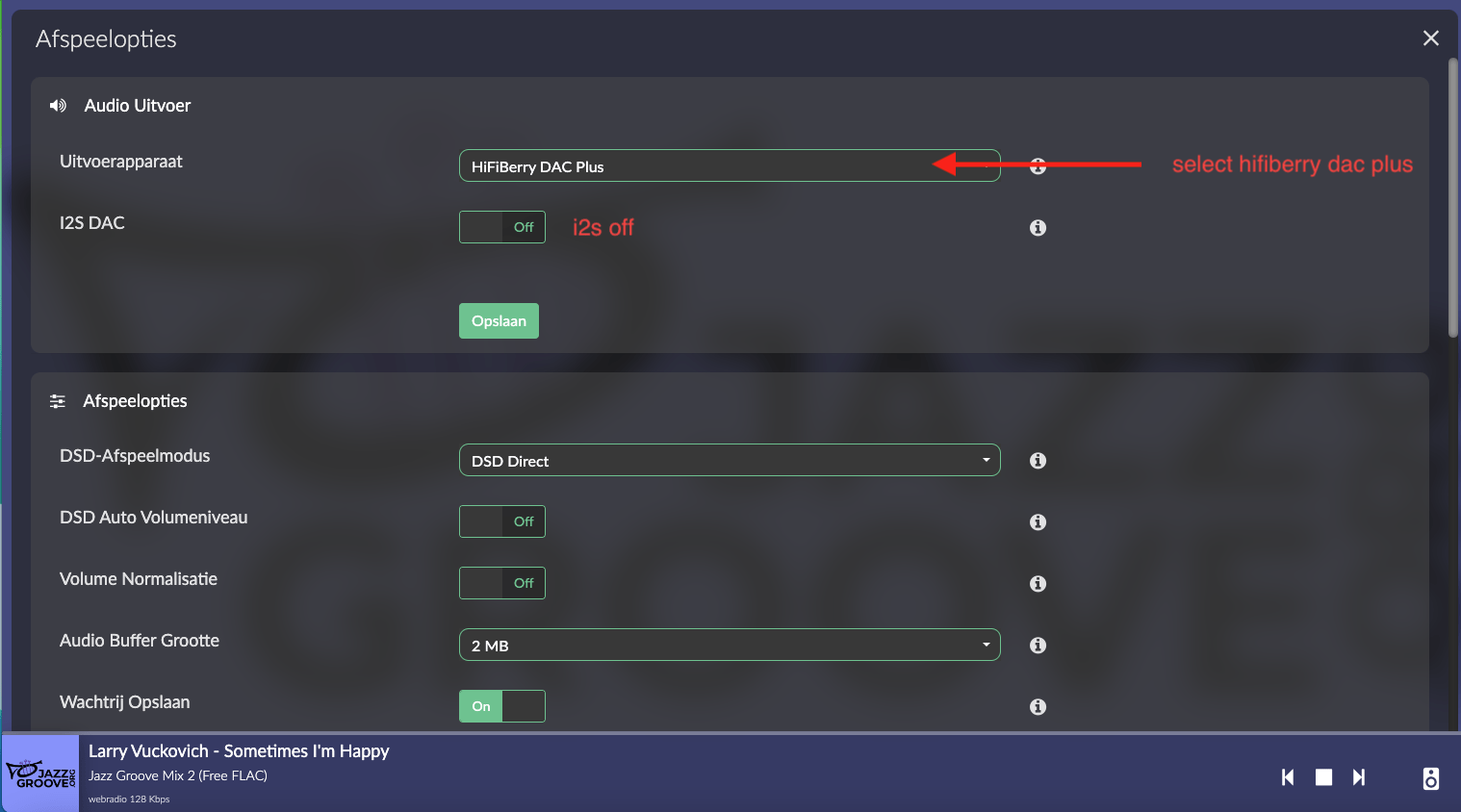

Raspberry Pi 4 with Iancanada Fifo Pi Master question:
Greetings and apologies for the basic question. If I'm in the wrong thread, please let me know...
I have a RPi 4 that I'm trying to connect to a Fifo Pi Master. PSU is PurePi II. I have Monitor Pi installed. I have Volumio installed on the RPi.
When I use the AudioPhonics ESS driver in Volumio, without Fifo Pi Master installed, the signal shows up fine on the Monitor Pi.
When I install Fifo Pi Master, and use the recommended HifiBerry DAC+ Pro driver in Volumio, the Monitor Pi shows "nosig" but the following LEDs on the Fifo Pi are lighted:

No other LEDs are lighted (neither MCLK selection). I don't seem to be getting a signal from the Fifo Pi. I've tried 2 I2s DACs - Buffalo IIISE and Miro's AD1862 DAC with I2S input.
I'd appreciate thoughts on what to try next. Thanks.

for clarification, add dtoverlay=hifiberry-dacplus to boot/userconfig.txt, safe the file and select hifiberry dac plus in the first dropdown menu, safe and reboot.
If HiFiBerry DAC Plus is not visible, choose another one, for example HDMI 0 out, click safe and now the HiFiBerry DAC Plus can be selected.
Please note that sometimes you have to turn off the Raspebrry Pi after selecting HiFiBerry DAC Plus instead of rebooting.
I don't know why, but sometimes it is necessary to get sound out of it.
https://community.volumio.com/t/3-6...ailable-with-rpi3b-4b-hifiberry-dac-pro/65551

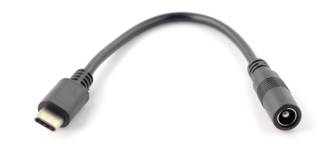

@sernikus on the board J@ is marked DC 5-12V... and ....I've tried to do as suggested with DC to USBC adapter.....No joy.
I am thinking that my batteries are the culprit. they are marked "LFP26650E 3.2V 3300mAh PSL" and I am noticing that Ian is recommending "ANR26650M1-B which output 3.3V 2.6AH, I've also seen them showing 3.7V. These batteries seem very difficult to locate domestically in Canada, the ones I obtained were from Battery Experts who seem to be only Canadian retailer that sells them. All others, particularly with the ANR prefix ship from China.
Do you think the issues I am having are related to under voltage? Also I should note that the Conditioner only seems to lite up in charging mode, when in pure it's LEDs do not light up. That would follow as the manual says tha twill only happen if there is 3.3V.....which my batteries never read.....
If there is a reliable place in Canada to get proper batteries, can someone weigh in please ?
dc to usb-c adapter like this : (you can cut-off "dc" socket and connect wires to linearpi 5v - for some reason 5V to J2 lifepomini is too low but 5v to usb-c works flawless ...
