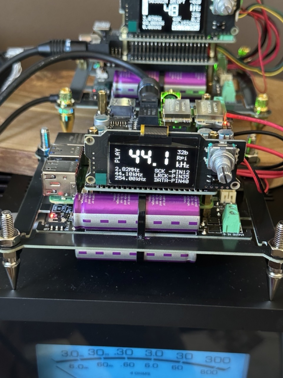

Did. you set the Audio HAT properly for the streamer? Does the monitor pro show the the audio stream being sent? Since your picture does not show the streamer powered up I cannot see what is on the monitorpi Pro Display.
From the Manual:
4. In the player software settings, select the standard WM8805 I2S device, such as Hifiberry Digi+ Pro, as
the Linux driver. Make other configurations as needed to enable your Raspberry Pi player to operate.
Does seem like overkill to run a Pi5 on the streamer. What are your thoughts for doing that?
@Bobfa: on player software setting, Selected HiFiberry Digi+ Pro and try on Hifiberry DiGi2
on Monitor pro show audio stream okie ( because if I select USB instead of Hifiberry Digi+ and connect USB to DAC audio stream okie)
Included 2 pics, IMG_1859 is Monitor of streamer, IMG_1862 is monitor of DAC KITs, DAC KITs alway say MUTE

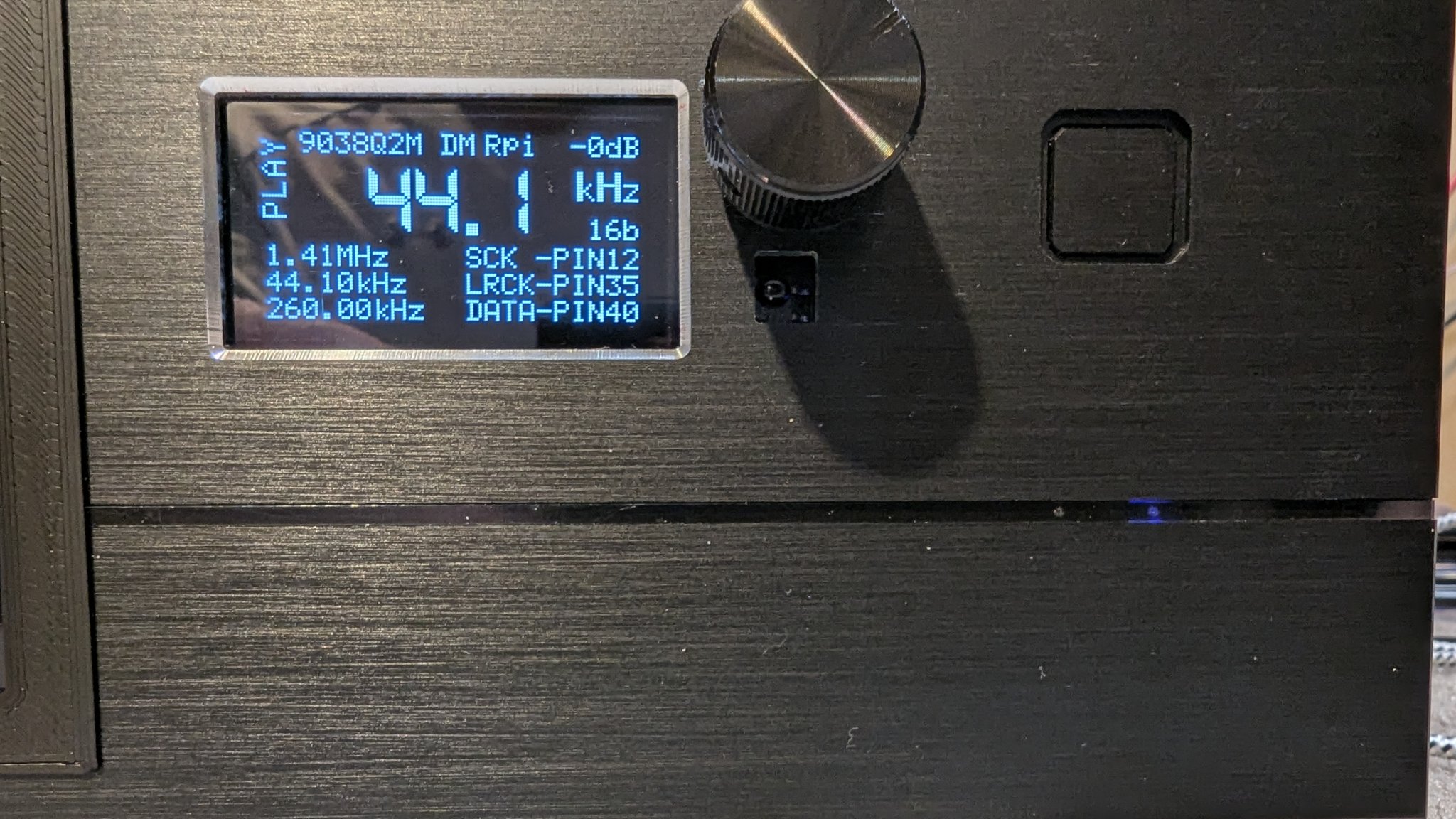

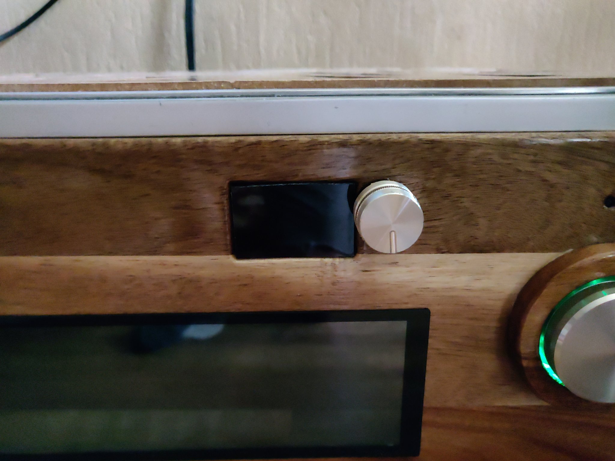

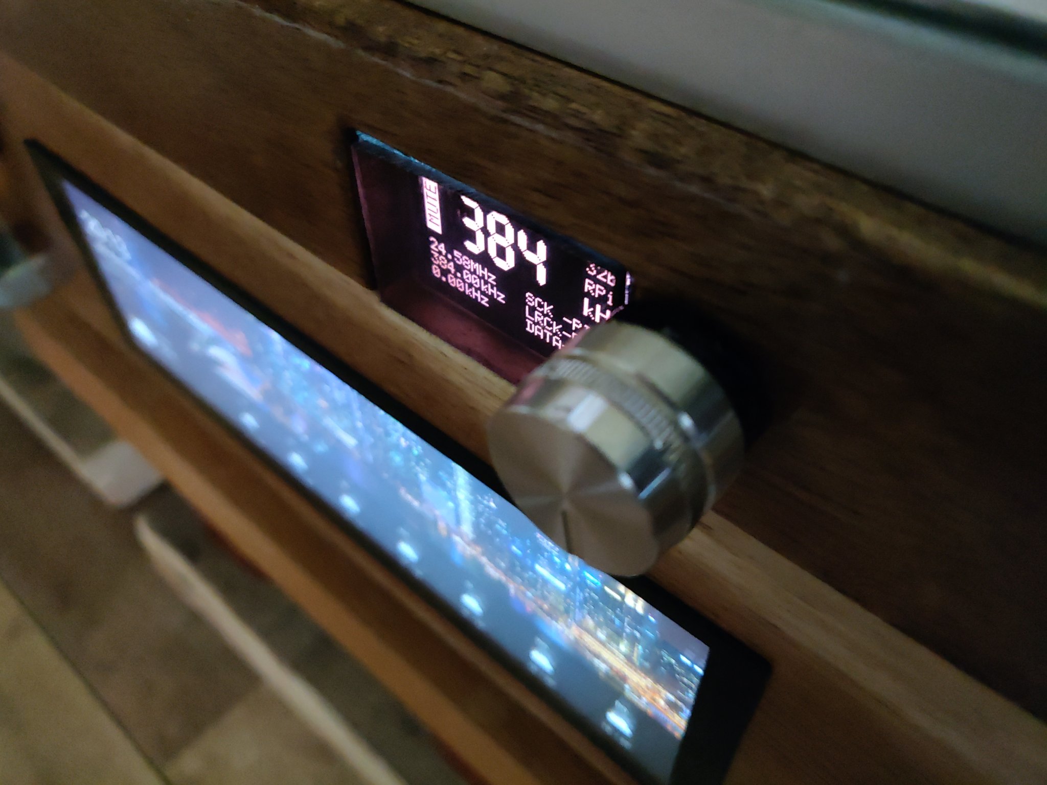

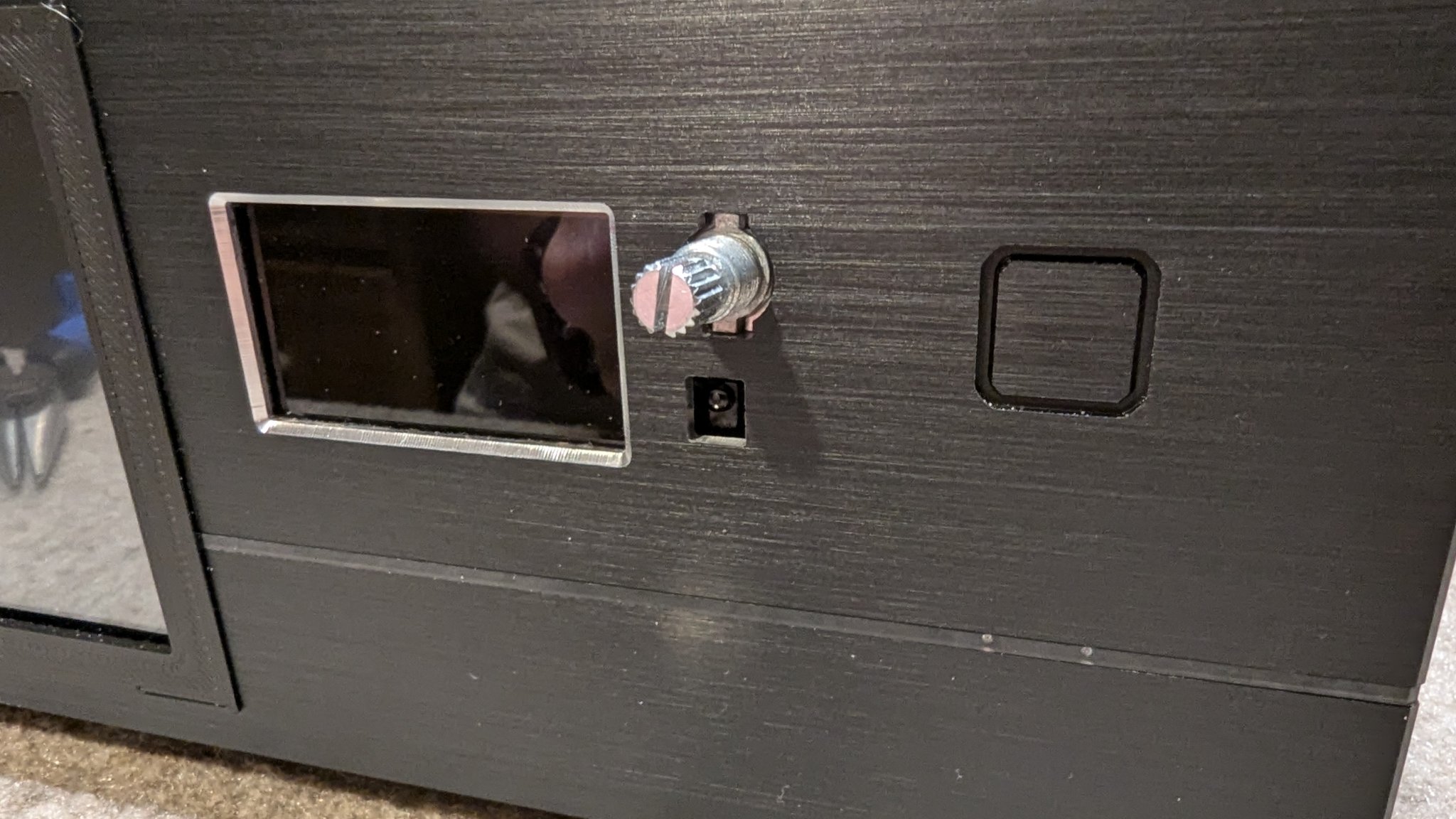

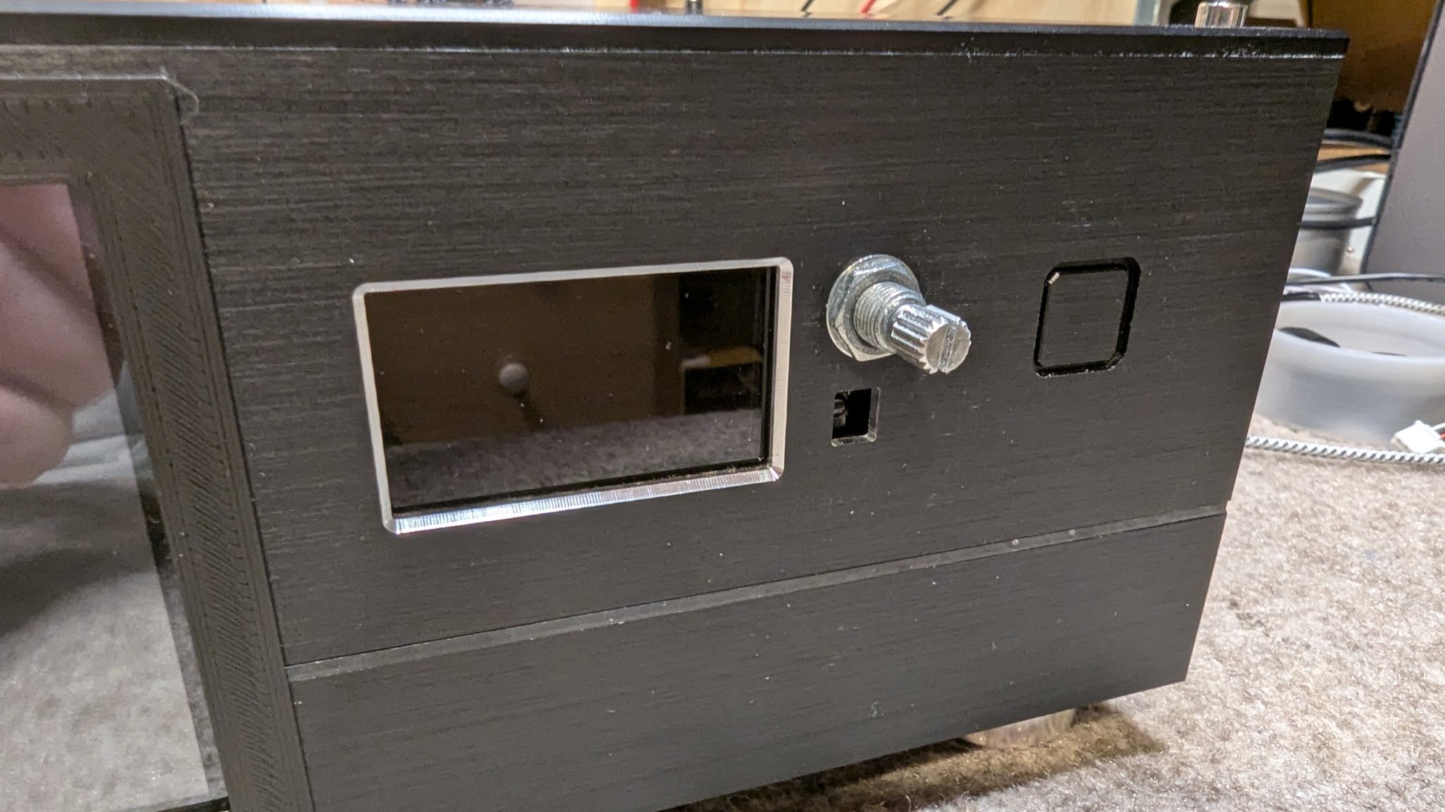

@gizmo3 Personally, I like the right photo more because of the more even colour.
The left one goes from a nice darker wood colour to a light in the middle.
Also, and this is not you but how the MonitorPi Pro is build, I would desolder the rotary thing so the screen can come further to the front.
And place the rotary thing separately from the screen.
I considered doing the same thing, but ended up getting my screen very close to the screen. It looks great behind a light smoked piece of plexiglass.
But than you have a pretty large hole behind the knob?
I also don't like, and need, the IR sensor.
My case will have a 10mm front, so was thinking of just having a non-through hole on the inside so I can hide it.
Or, I need to find out if I can just desolder the sensor. need to look into that.

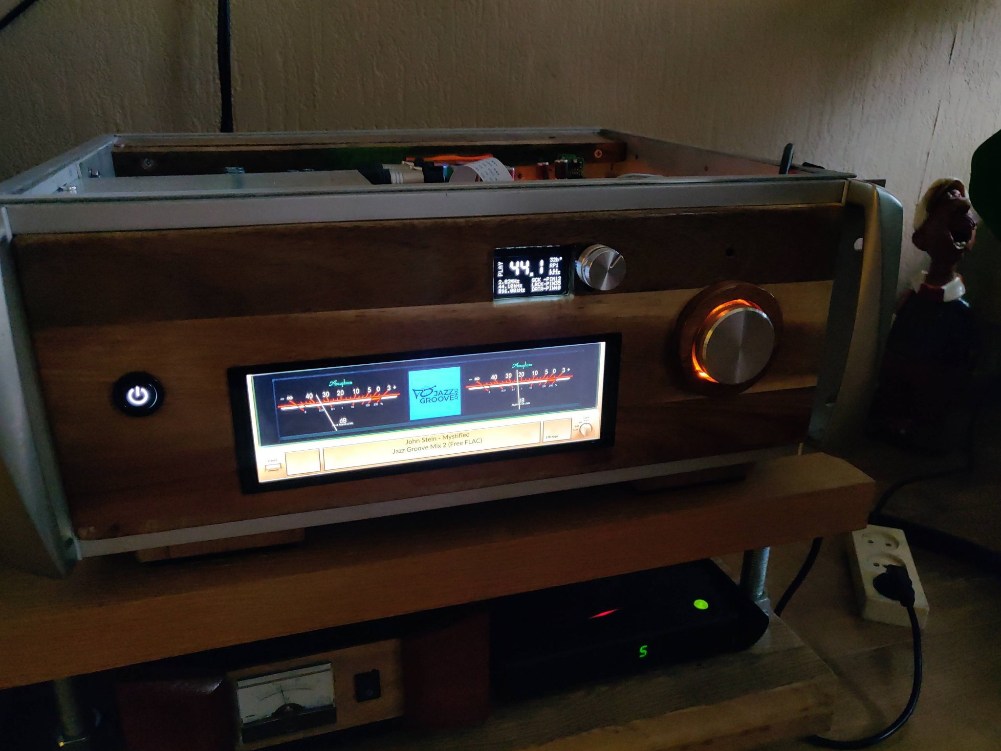

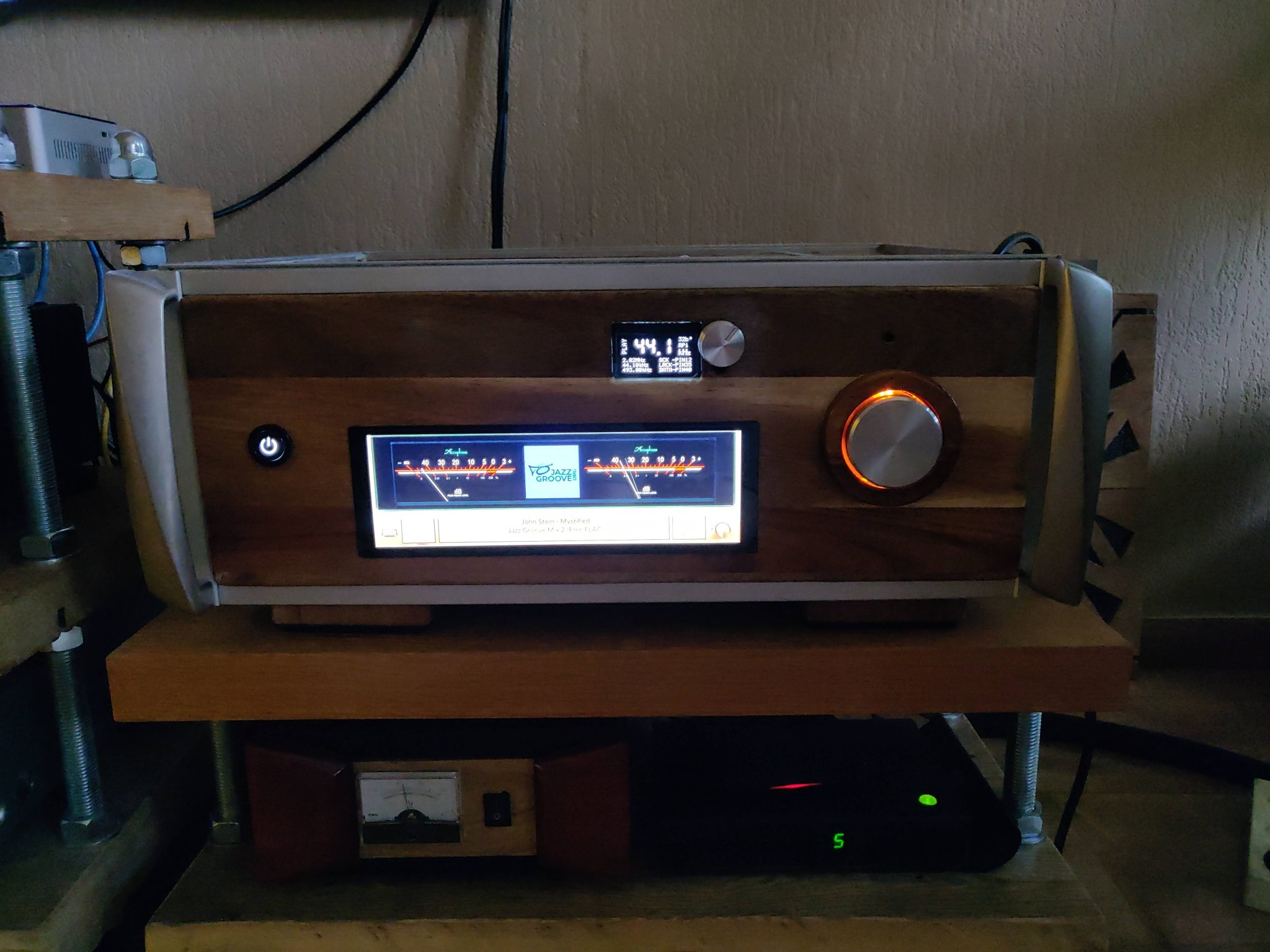

I worked on this build for months, with many hours spent prototyping and deciding on where and how to mount the MonitorPi Pro (MPP). I was working with a 4mm removeable front panel, and a 2mm steel super-structure, so it was challenging. I had FP Express mill the front panel for me. The hole is not that large, and basically covered up with a washer, and the knob. I'd like to find a very skinny knob, but used the smallest I had.

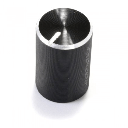

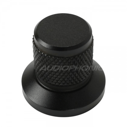

Oh, I would have expected the square base to go through much further.
Skinny knob wise, perhaps this is something you like?
It's from Audiophonics in France, but no doubt you can find it in the USA somewhere:
or
I am thinking about this one myself, personal taste wise:
It doesn't have an indicator, which is not needed with the MonitorPi Pro.
Part of the milling included blind cutouts on the back, of various depths to accommodate the encoder and screen depths. I use my 3D printer to help prototype the fitting, so I have a pretty good idea what the finished product will look like. This panel came out just as I expected. I did find a skinnier knob, but it has an indicator, but otherwise looks ok.
