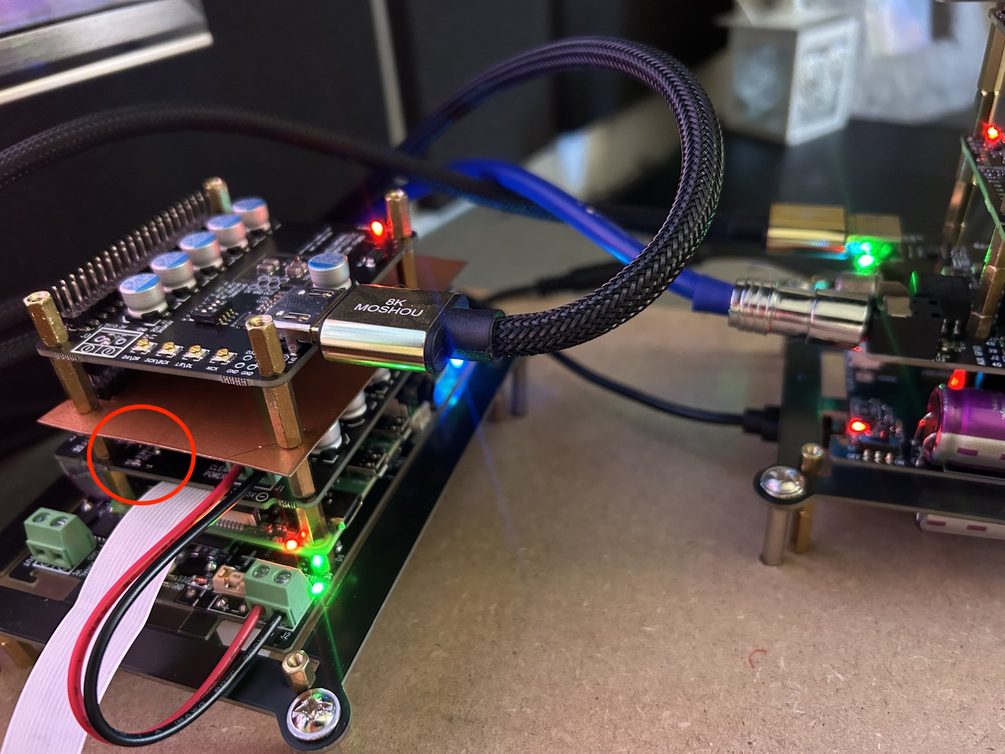

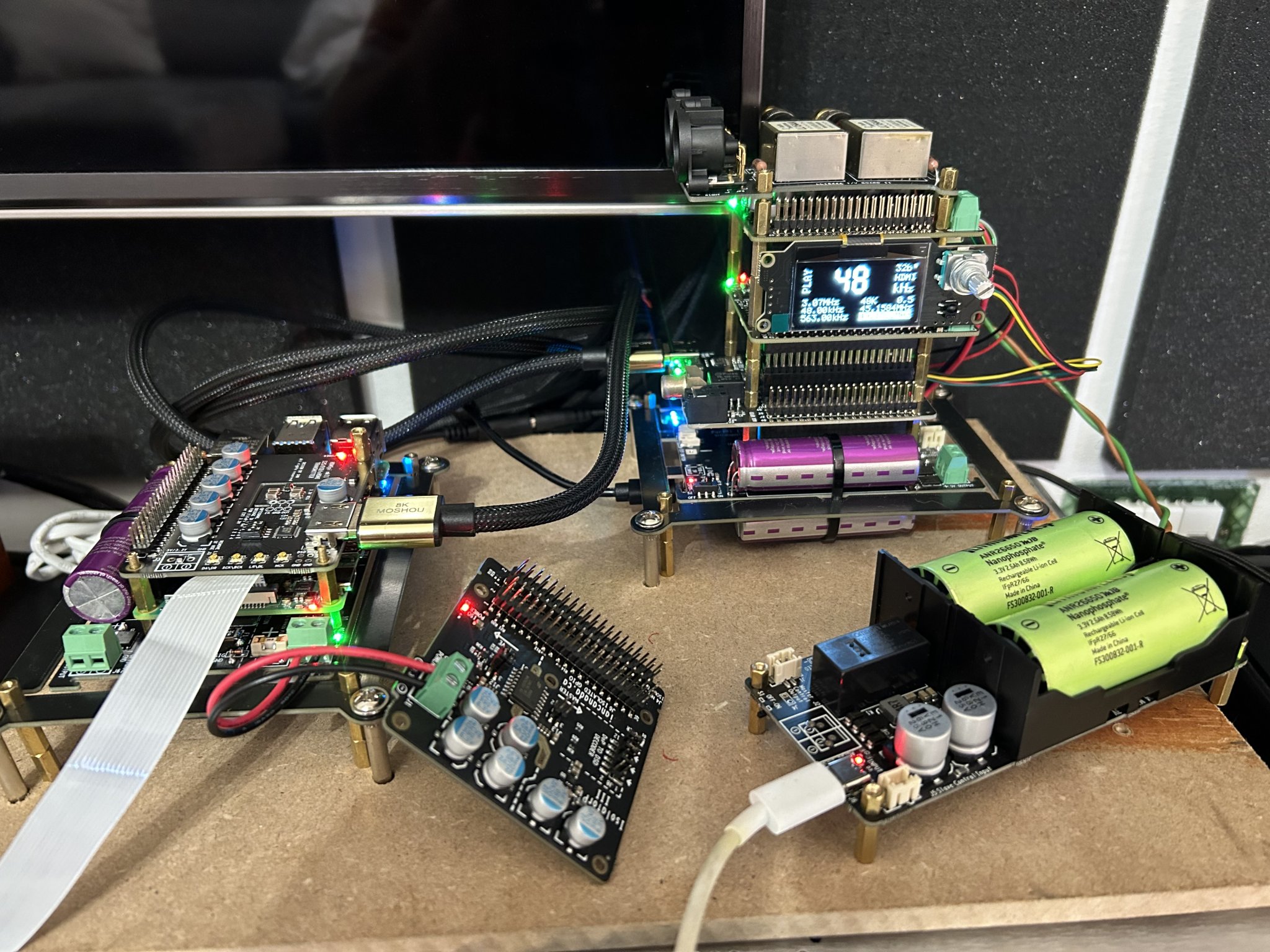

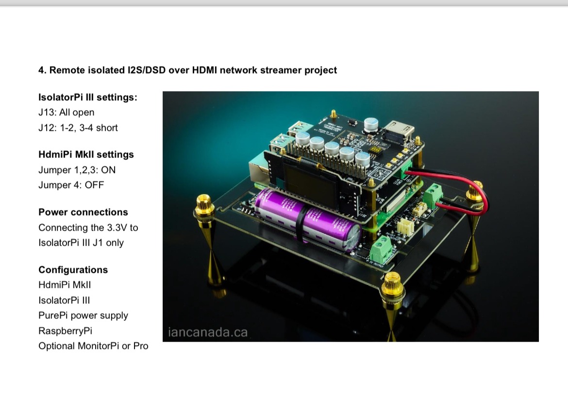

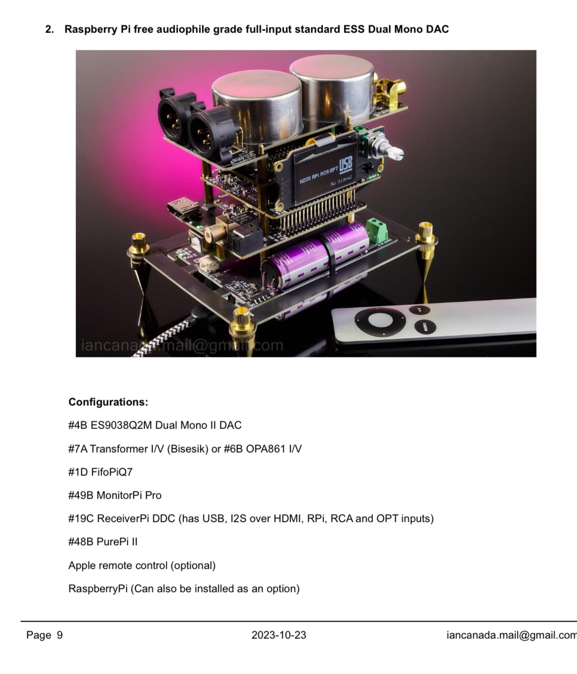

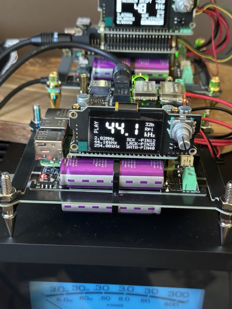

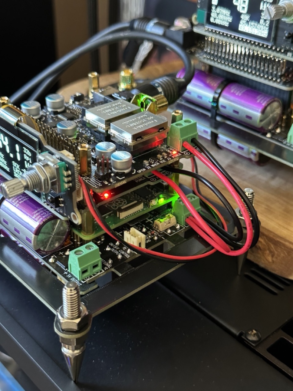

hdmi pk2 can work in slave or master. if it is mounted with fifopi it must be master otherwise in slave. at least that's how I understood the instructions. in my streamer stak there is Rpi4 with isolator3 and hdmi pk2. therefore without fifopi q7 and I read that it must be put in slave. the connection with the Dac stak is done with an hdmi i2s cable. the Dac is composed of ddc- Q7- dac9038- IV/trafo. in optics from the tv it works regularly. but from the streamer no signal comes out.! I'm posting a photo of Ian's project of the streamer and the Dac where the jumper settings for each stak are also written

without isolator 3 everything works correctly!! The only thing is reproduced at 48k and not 192 I have to understand how to adjust something else too. but anyway without isolator it works. so the problem is isolator 3. will the card really be wrong.!?

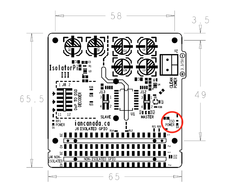

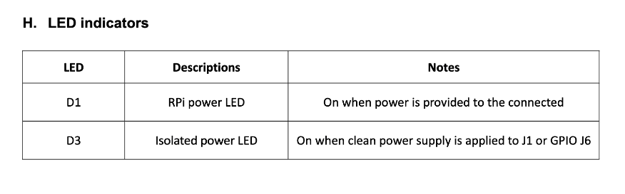

you use J1 isolator III as clean power but I see LED D3 is not on...Maybe I can't see clearly, but it looks like it.

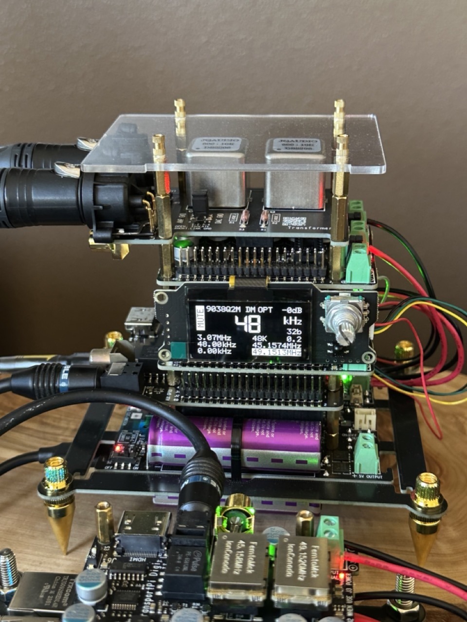

here we go!!!! finally!!! everything works.! I don't know why honestly.! hahahah i took all the streamer cards apart and just put them back together! and now everything works! the dac stack picks up a lot of noise and hum. i will check if i need to put some solder points to ground the dac.! do you have the same problem.!? or could it be the transformers that are noisy.!?
I don't have the same setup here, but I do have an isolator II in between, but no hum at all.
Maybe you have something not quite right or a bad isolator III.
By the way, is LED D3 now on?
and That copper shielding doesn't happen to be sitting against something that could disrupt things.

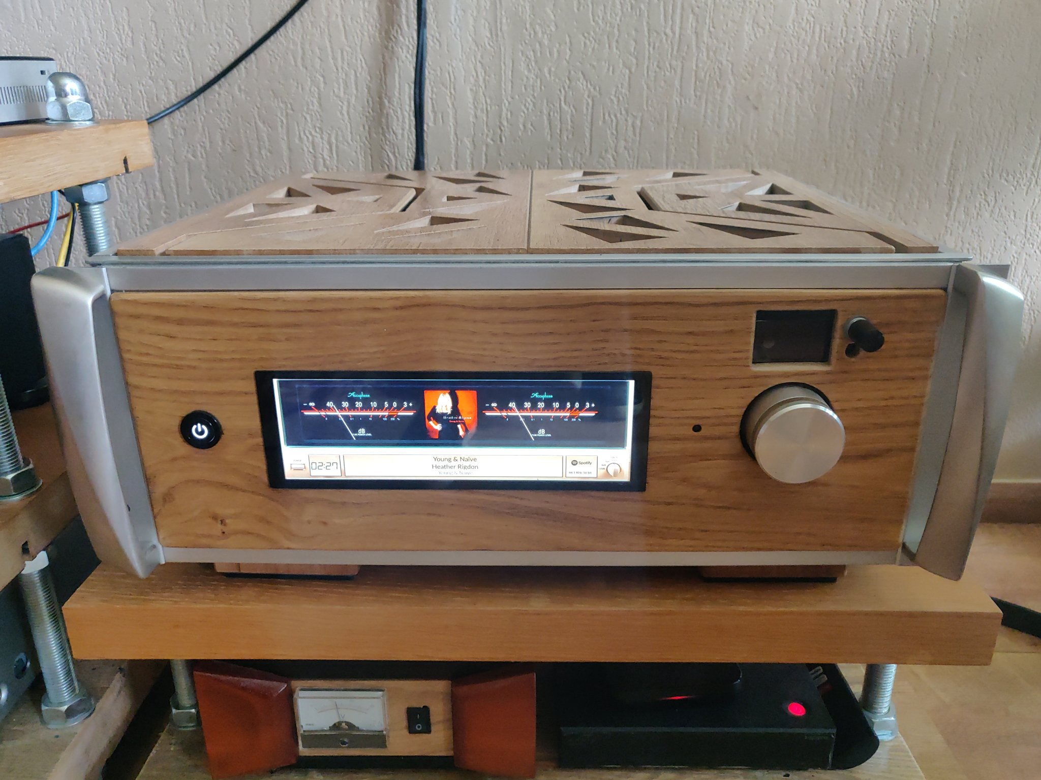

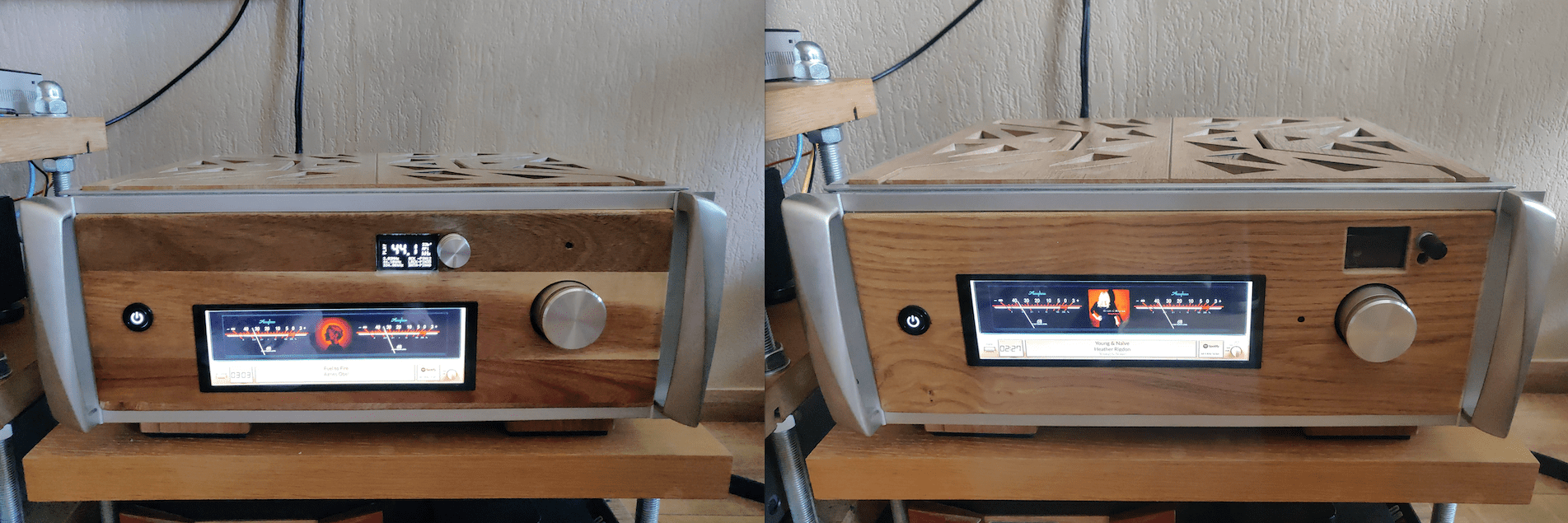

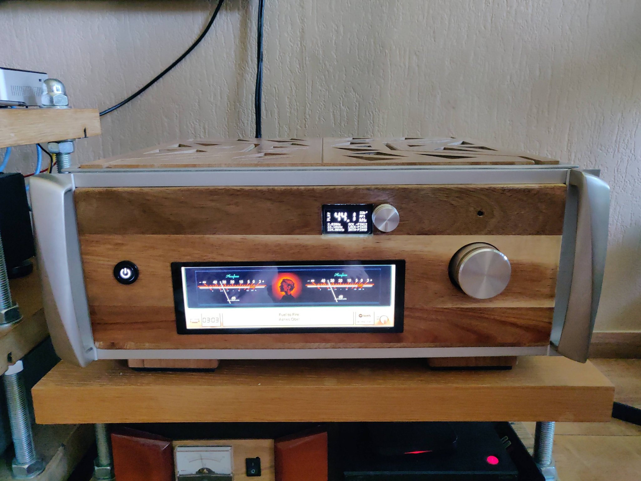

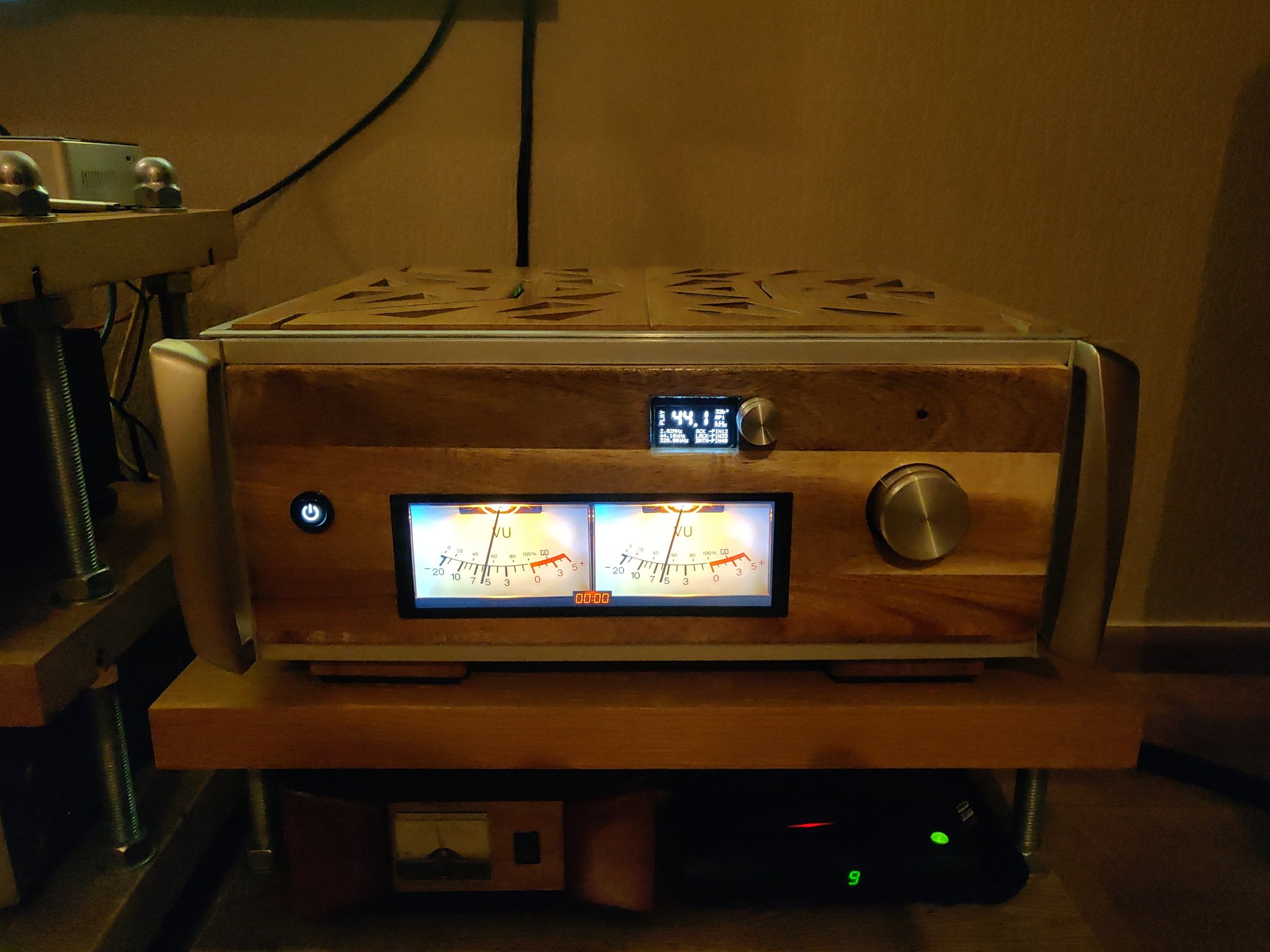

different layout of the touchscreen and Monitor Pi pro.
I made it so that I can easily change the front.
also used slightly different and darker wood and high-gloss clear lacquer.

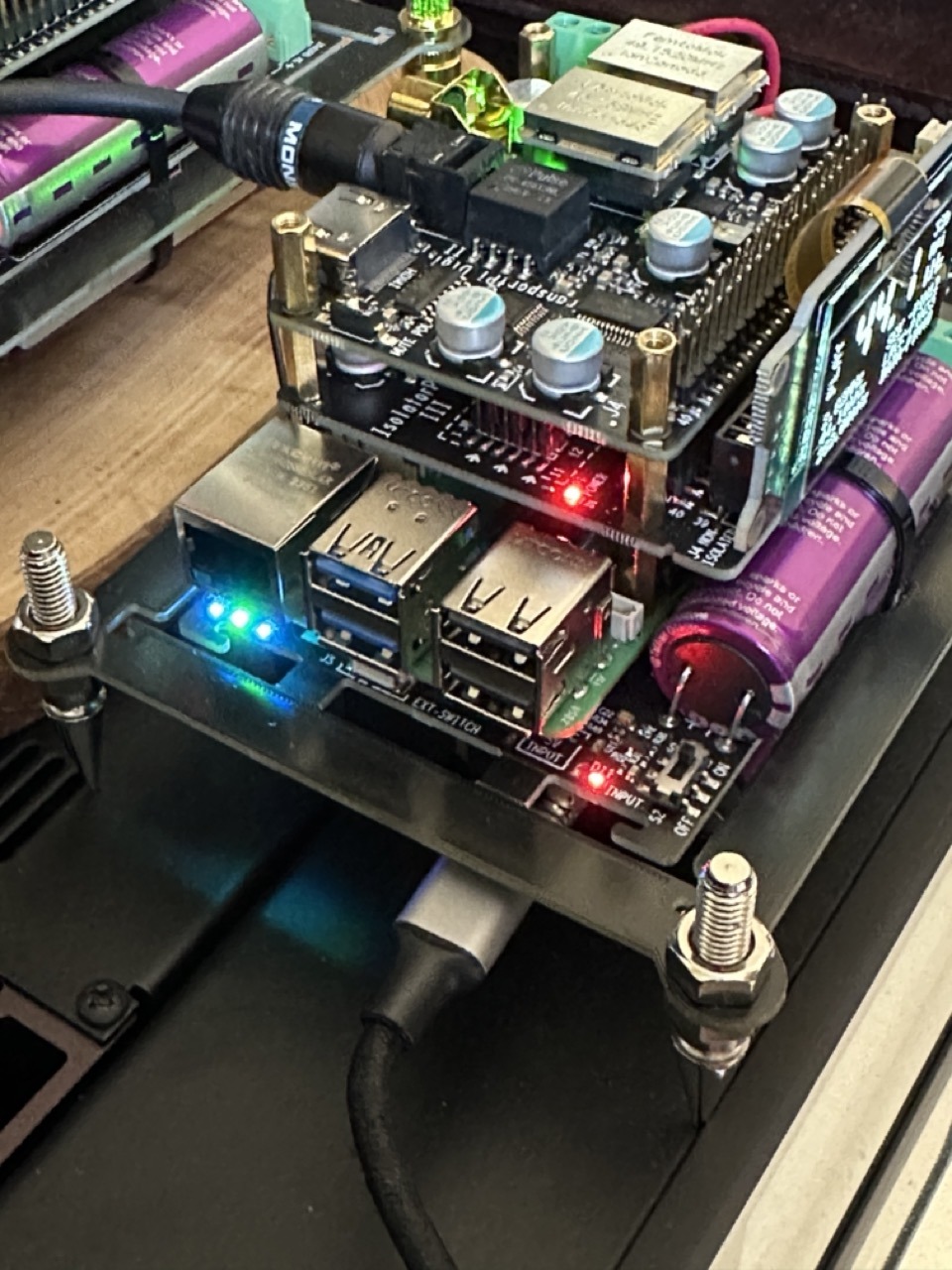

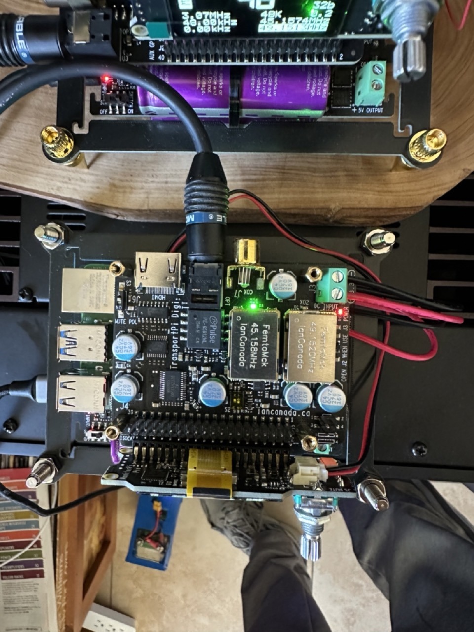

Hello to all Members
I am new here,
after read here to fix my problem with Ian Digi streamer but can not
now I try to post my problem need your help
I have:
#90C TransportPi Digi II Network Streamer with Isolator and Lifepo4/Ultracapacitor Power supply
  1. #20D TransportPi Digi II
  2. #48B PurePi II ultra capacitor/battery power supply
  3. #49B MonitorPi Pro display/analyzer/controller
  4. #3 IsolatorPi III
  5. #12A 13/2.5mm standoff set ......
  6. Raspberry 5
  7. Ropieee OS, play music via Airplay Apple Music
the streamer connect to Mac via Airplay okie, but signal go to :#94D. Flagship RPi free Multi-input ES9038Q2M Dual Mono DAC KIT in SYNC mode with fully finished transformer I/V
  1. #4B ES9038Q2M Dual Mono II DAC
  2. #1D FifoPiQ7II FIFO clocker
  3. #48B PurePi II 5V +3.3V Ultracapacitor/battery PSU
  4. #49B MonitorPi Pro Controller/Display
  5. #7B Transformer I/V KIT
  6. #19D ReceiverPi DDC
  7. #50B GPIO spacer
  8. 4 of #12A 13mm/M2.5 standoff sets
the signal don't go to it, monitor always say MUTE, I try RCA, OPT and HDMI non of them have signal
I try with Volumio OS no work
but when I play only Raspberry 5 transfer music to DAC kits is working fine
I need help to fix it, included some pic
Thank you so much
Dienson

A note on the PurePi II, watch out for the battery contact mount point, where LifePO4 sit. My PurePi malfunctioned, more like became epileptic, on the 3.3v power supply point. The 3.3v side is powered by the batteries, the 5v side is filtered by the ultracapicitors, the 5v power remained stable. So I pushed the batteries back up and everything works correctly again. This may happen to some who move their setup a lot or maybe as the seasons change and metal (maybe plastic) expands and contracts with moisture and temperature changes. It could also be the brand of LifePO4 batteries I bought.
@gizmo3 Personally, I like the right photo more because of the more even colour.
The left one goes from a nice darker wood colour to a light in the middle.
Also, and this is not you but how the MonitorPi Pro is build, I would desolder the rotary thing so the screen can come further to the front.
And place the rotary thing separately from the screen.
Reactions: redjr
