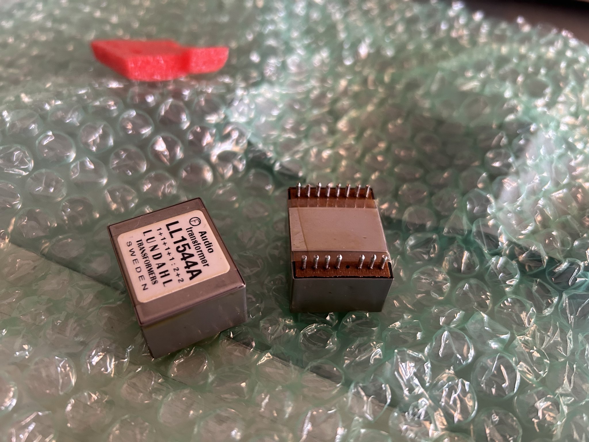

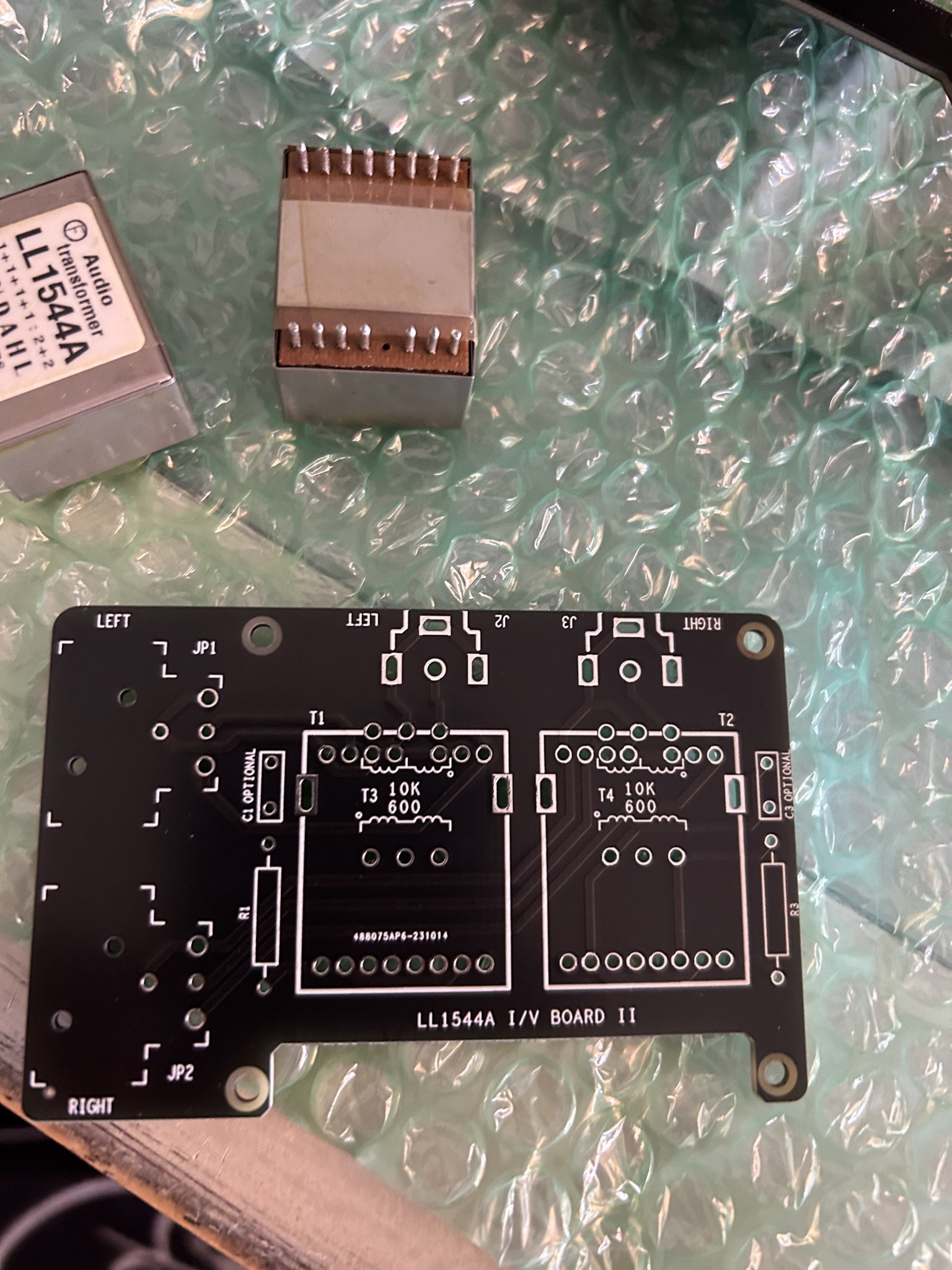

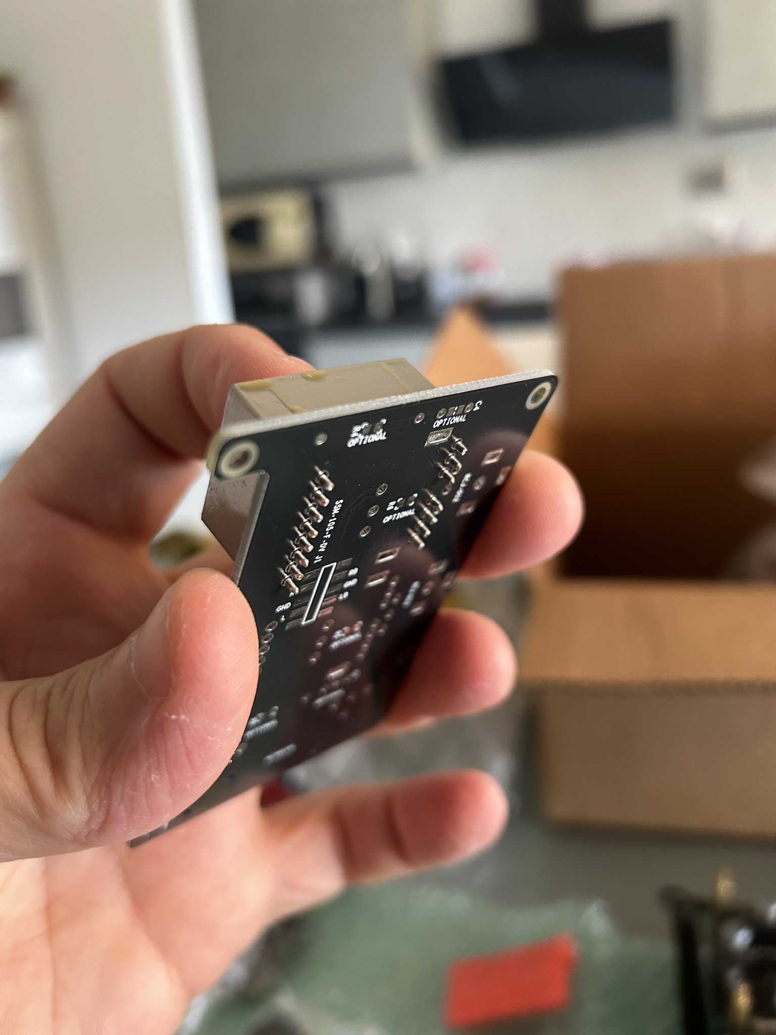

@Matteoleon there is only one way to solder it on the PCB. If you check the pin out you will see that one pin (No. 12) is missed, you can't go wrong.
If you still have some doubt please post some picture of your stuff.
Here is the photo. All the feet must be welded.?

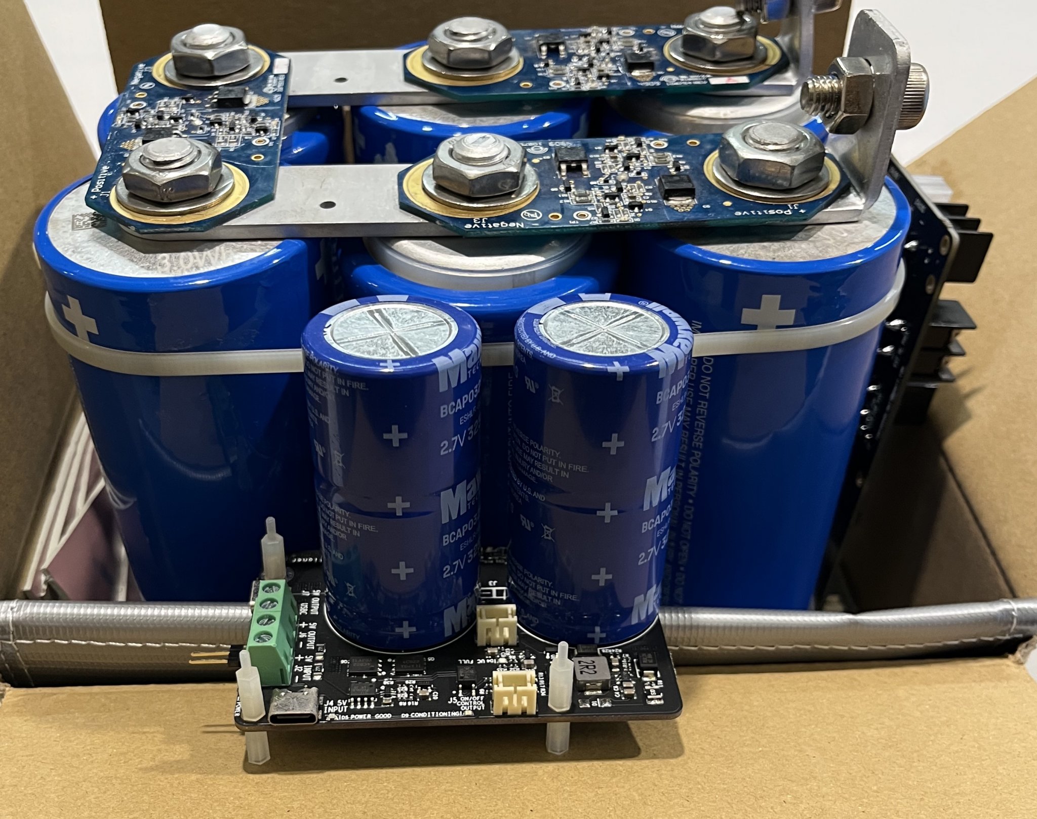

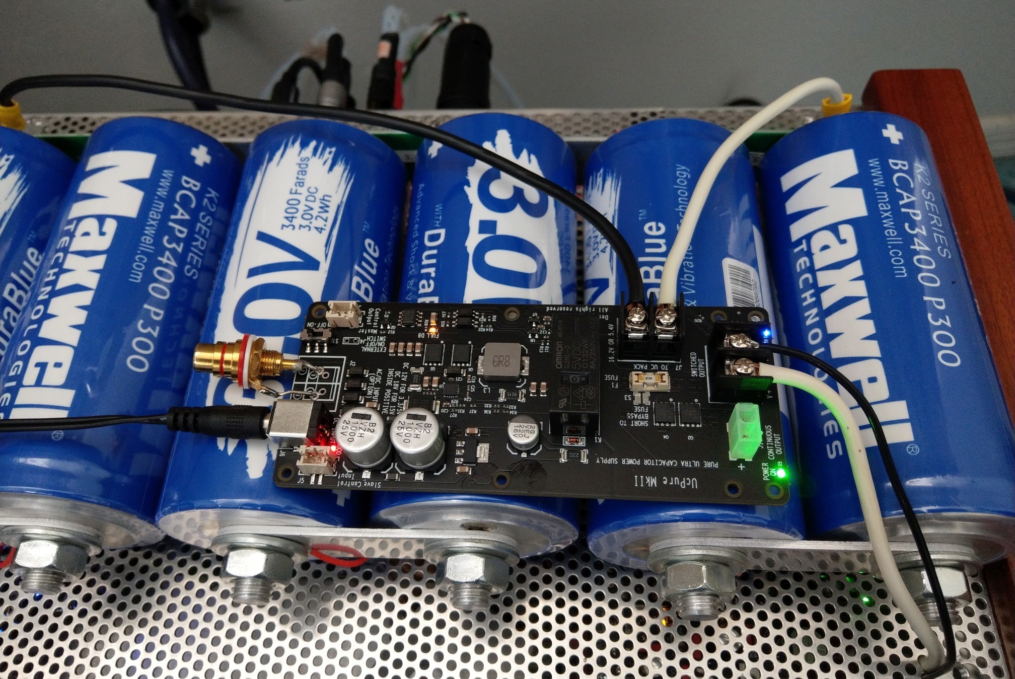

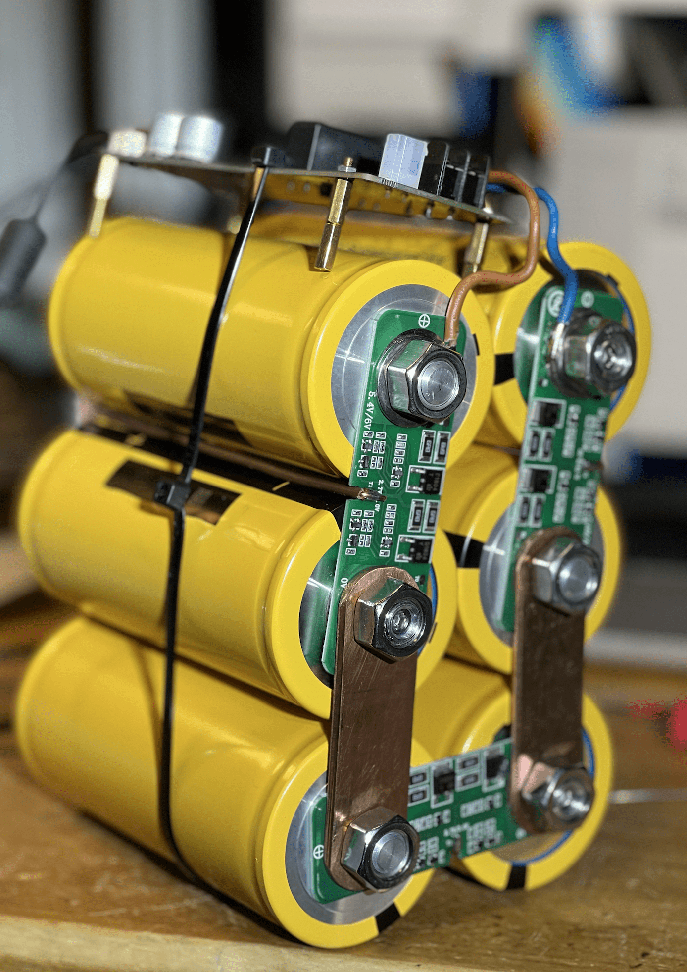

Where does the UcBalancer come into play for a 12V UcPure Build? I see a Rivet on UC3 +, but not the UcBalancer Rivet. This photo is from a user that no longer posts.
UcPure -UcPure +
Uc1 -BussBarUc2 +BussBarUc3 -BussBarUc4 +BussBarUc5 -BussBarUc6 +
Uc2 +BussBarUc2 -NULLUc3 +BussBarUc4 -NULLUc5 +BussBarUc6 -
According to these pre-UcBalancer photos, you need three UcBalancers?
UcPure -UcPure +
Uc1 -UcBalancer?Uc2 +BussBarUc3 -UcBalancer?Uc4 +BussBarUc5 -UcBalancer?Uc6 +
Uc2 +UcBalancerBack?Uc2 -NULLUc3 +UcBalancerBack?Uc4 -NULLUc5 +UcBalancerBack?Uc6 -
