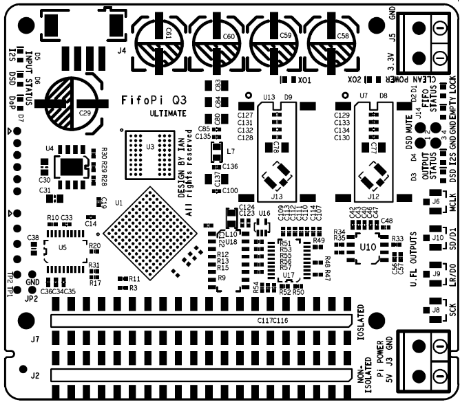

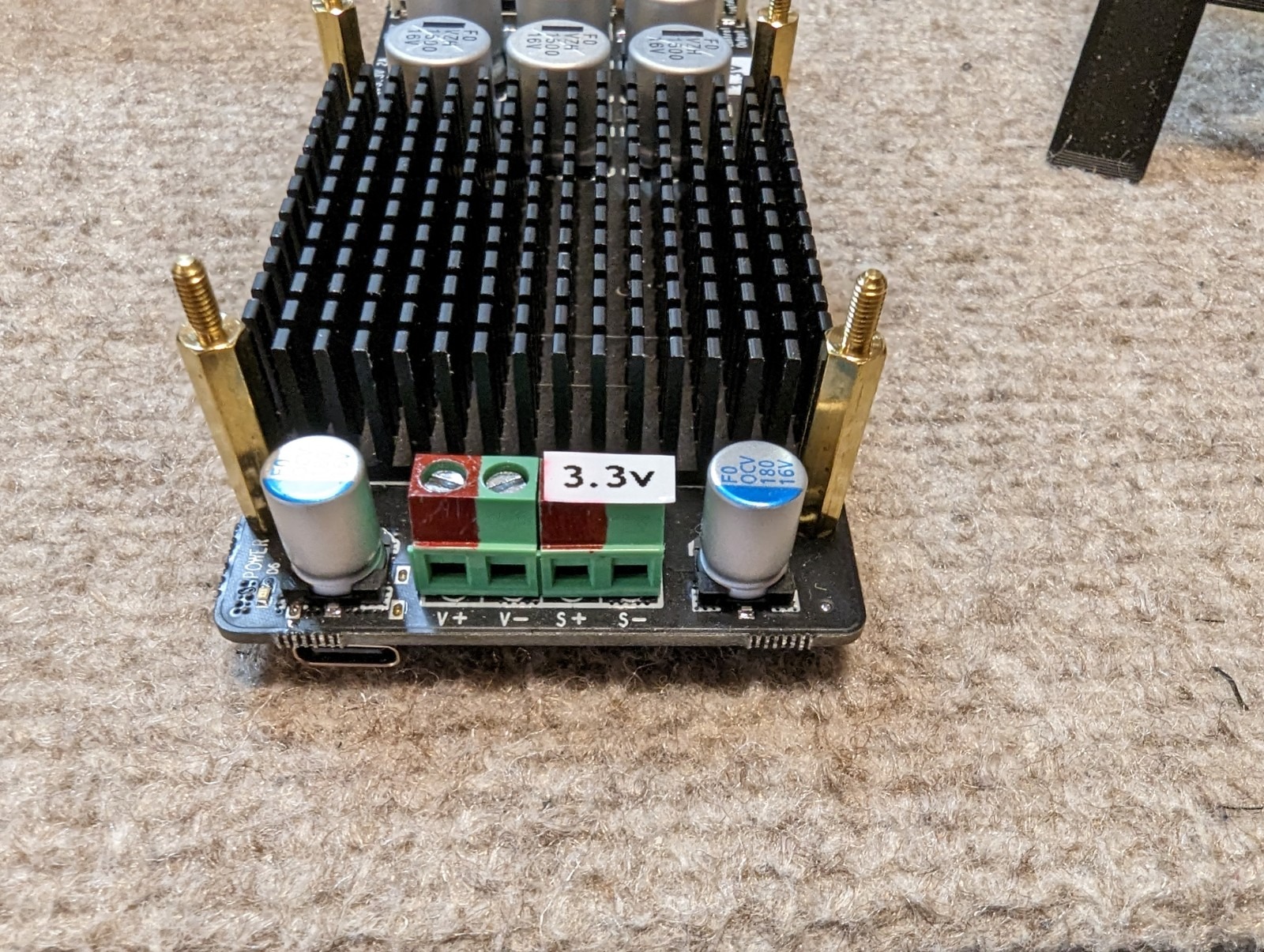

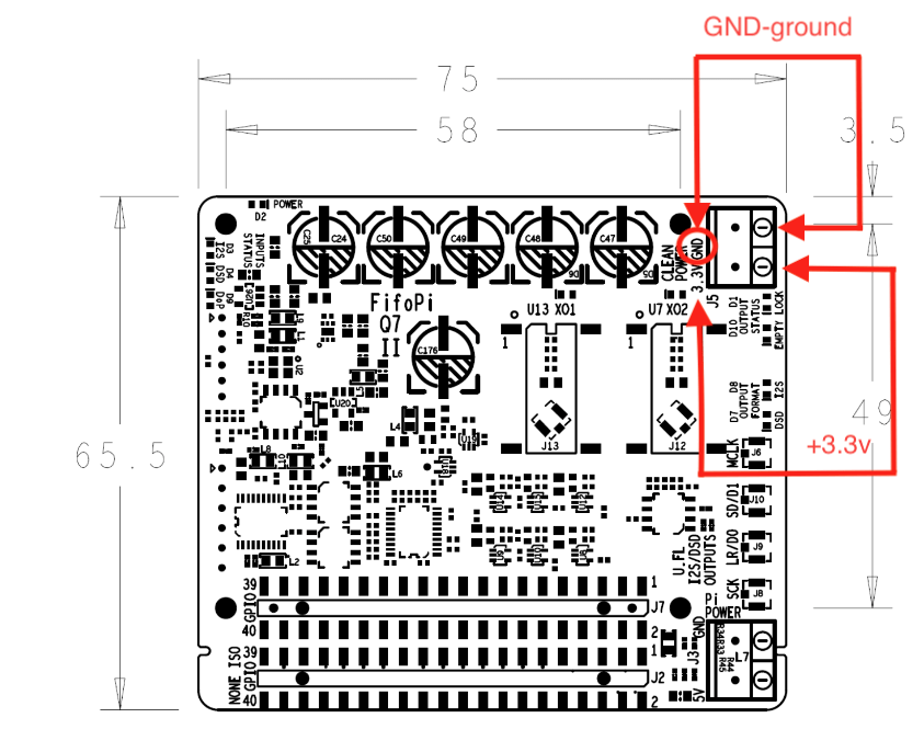

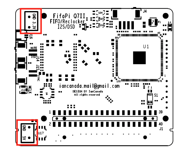

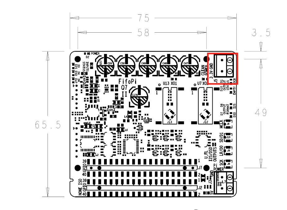

Have you already consulted the manual?Basic question but I can't figure it out...what's the polarity on j5 (3.3v) on fifopi? I'm trying to power from purepi and don't want to reverse polarity but it's not marked and I think the position is reversed from purepi.
Also...I'm supposed to connect fifopi ground to the earth on station pi....I guess I don't actually know where to connect it on fifopi...the (-) on j5?
https://github.com/iancanada/DocumentDownload/blob/master/FifoPi/FifoPiQ7/FifoPiQ7Manual.pdf
Seems to pretty clearly indicated 3.3 at the bottom and ground above that, same the 5 volt input below…
As much as I look at that I can't see what indicates polarity.Have you already consulted the manual?
Is the polarity marked?Seems to pretty clearly indicated 3.3 at the bottom and ground above that, same the 5 volt input below…
It says the word ground but I don't understand where to solder the ground wire...
is of course a top view.As much as I look at that I can't see what indicates polarity.
Ok thank you, I didn't know to read that as indicating positioning. I tried to see it that way but with ground right in the middle I thought it wasn't that and comparing with the 5v side didn't clear it up for me. So I DO share the ground for station pi with the incoming 3.3v.
I think this happened to me too at one time. But since I went from a Q3 to a Q7, I was able to backtrack to the Q3 photos.
There's a PurePi (Not Familiar) photo too in the Q7 Manual. The Red and Black cabling looks correct, but it's good you are doing your due diligence. Better safe than sorry, then you have a little comfort in that the last buffer there is a fuse.
To add to everyone else chiming in... I've found labeling and coloring power connectors may save you some grief down the road, should you accidently reverse something. I do this because I'm more anal than most. 🙂Ok thank you, I didn't know to read that as indicating positioning. I tried to see it that way but with ground right in the middle I thought it wasn't that and comparing with the 5v side didn't clear it up for me. So I DO share the ground for station pi with the incoming 3.3v.
