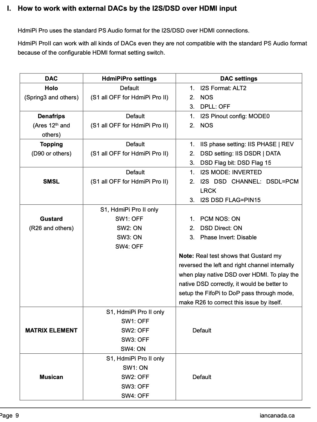

Hi folks,
I just finished building Gabster’s DIY flagship streamer and have a question on the I2S pinout of iancanada’s HdmiPiPro II compared to that of the Denafrips Pontus II DAC (12th-1 version - but assuming all Denafrips are the same).
The HdmiPro manual shows its pinout configuration, and I‘ve also looked at the Pontus manual but can’t make sense of the differences and can’t figure out which switches to change on the HdmiPro to match the configuration of the Pontus II. I am sure this question has been asked before, but I could t find a clear answer through searching.
I’m hoping someone has done this before and can either give me the answer or point me in the right direction. Thanks!

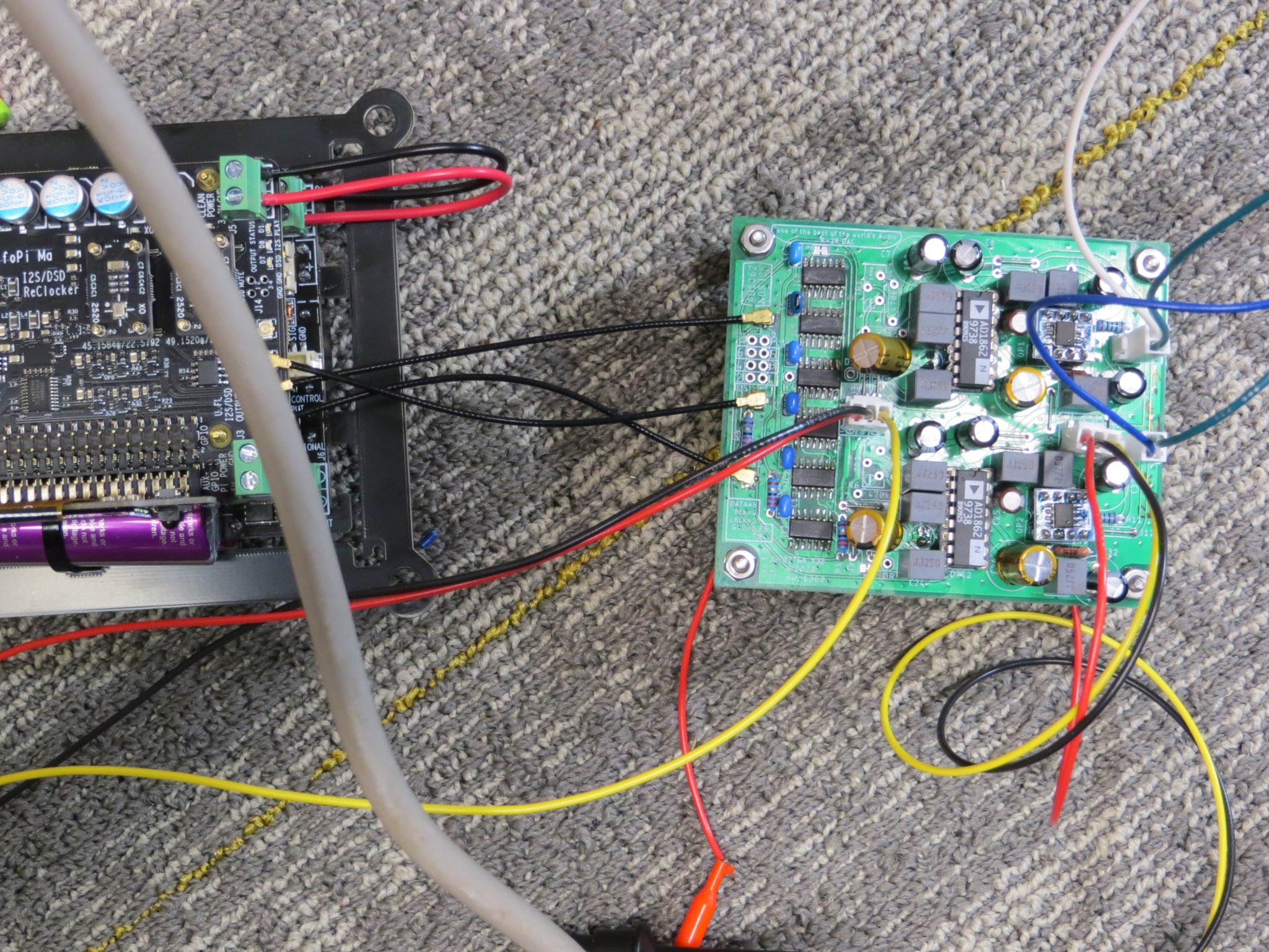

As mentioned in the post, the FifoPi Ma is working fine with Twisted Pear Buffalo III/SE DAC (based on ESS9018 DAC chip).
When I connect it to the AD1862 DAC designed by member MIRO1360, I have a problem. The Monitor Pi does indicate that output signal is being produced and I do get music from the DAC. But the music is almost obscured by noise and static. The DAC does convert the I2s output from the FifoPi Ma to DR and DL needed by the AD1862 chip. I'm using Volumio on the RPi and have tried different settings for the playback.
Here's a photo of the setup
Any suggestions will be appreciated.
Cheers.
@hirscwi
what you can try is install the FusionDSP plugin and set it to "convolution filters" in the first settings and click safe/apply.
in the next tab/setting "click to disable effects".
scroll down and enable resampling and set it to 176400 or 192000 - ++
make sure resampling is turned off in the playback options.

I tried this and it WORKS! Thank you.
I would be curious to know why it works, if you have time to esplain it.

I don't know why, but I had the same problem with a PCM 1794A dac.
I think in my case the DAC cannot handle certain frequencies, mainly 44.1 to 96 khz.
you could try other clocks "FifoPiMa" but to be sure you would have to ask ian canada himself or maybe someone here who knows.
btw a friend of mine has the Q7 and pcm 1794A with exactly the same problem.

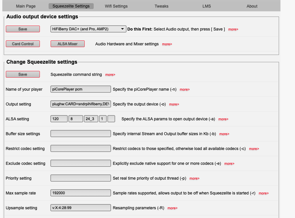

If you are going to use picoreplayer, these are the settings I use, if not then no sound.

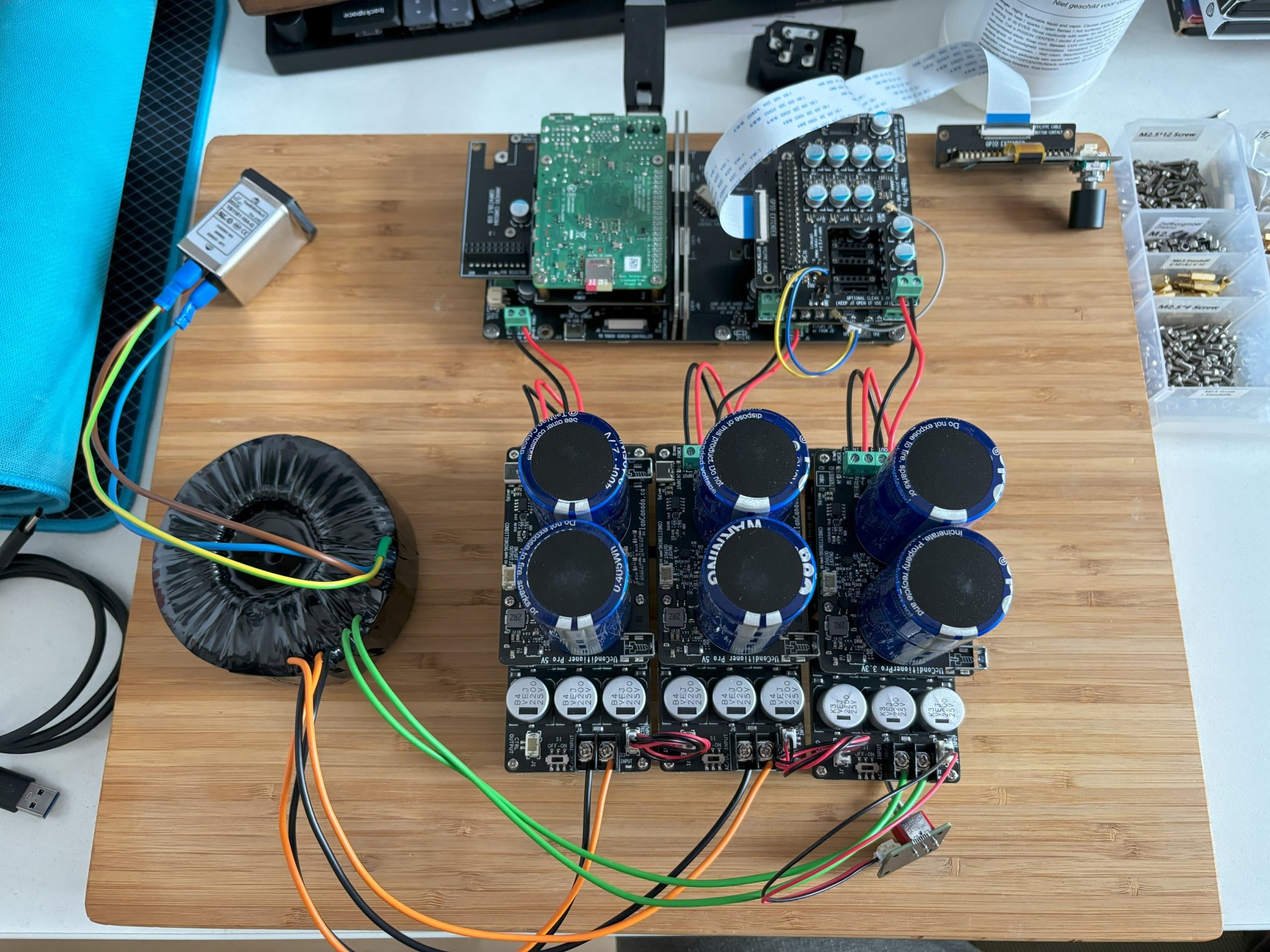

I just finished my test setup, but the master/slave switch setup doesn't seem to work.
The photo shows the switch on J4 of the 3.3V LinearPi MkII, that was a mistake and it's in the J3 of the left 5V LinearPi MkII.
When I flip the switch, only the left 5V LinearPi MkII turns on and with that the Rasperry Pi.
But the other two LinearPi MkII's do not switch on.
The documentation is a bit vague here.
When just using two LinearPi MkII's it mentions to hook up J1 to J4, add the switch to J3 and that's it.
But under J. Application Notes, nr. 3 "How to group LinearPi MkIIs together" it says to do the same, but for a bigger group
..connect the Master control output to the Slave control input between LinearPi
MkIIs as a chain. Please use the on/off logic of the master LinearPi MkII to control the whole power supply
group.
Does that mean, in my case, I need to hook connect J1 of the left to J4 of the right LinearPi MkII?
Technically that doesn't make sense to me. Why in a configuration of more than two LinearPi MkII's would that be needed?
If what I think is correct, of course.
Hopefully someone has an answer to this, because I don't just want to hook up wires everywhere.
The documentation can be very vague at times. The English isn't the best, but the explaining is worse at times.

Look at the pcm1794 datasheet page 13. You must use 22/24 Mhz clocks....
