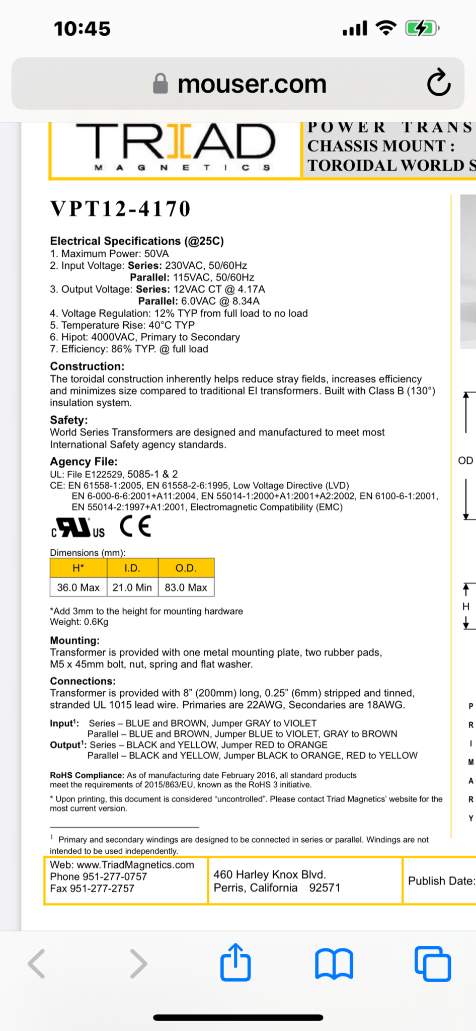

In a LinearPi 5V + UcConditionerPro 5V configuration, how would you recommend powering the LinearPi?
Is it necessary to use another Linear Source for power supply or can an SMPS source be used that does not change the final result?
I have doubts about the most effective way to power this configuration since my network is 220V AC.
I use a transformer and use the AC input option and works well
