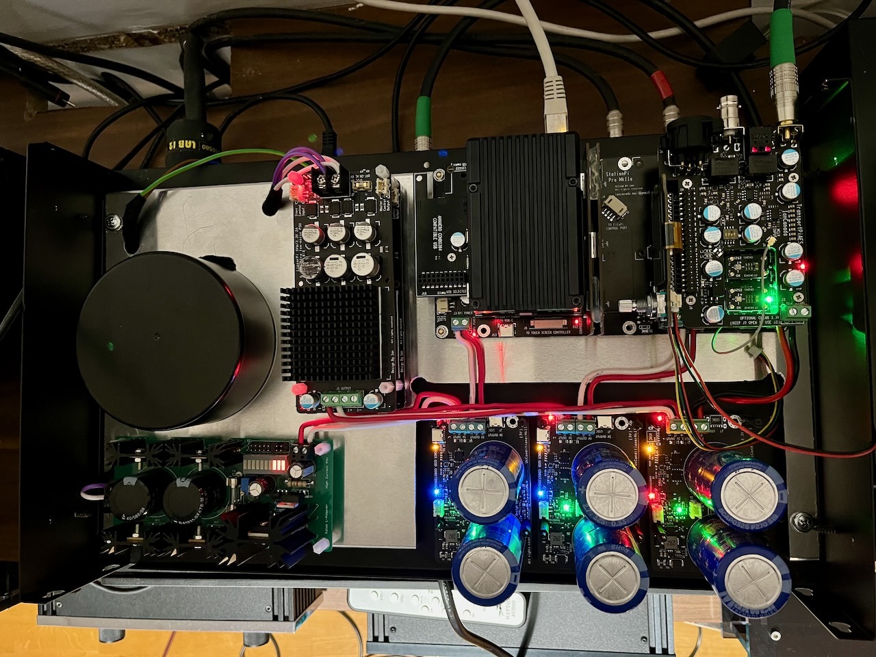

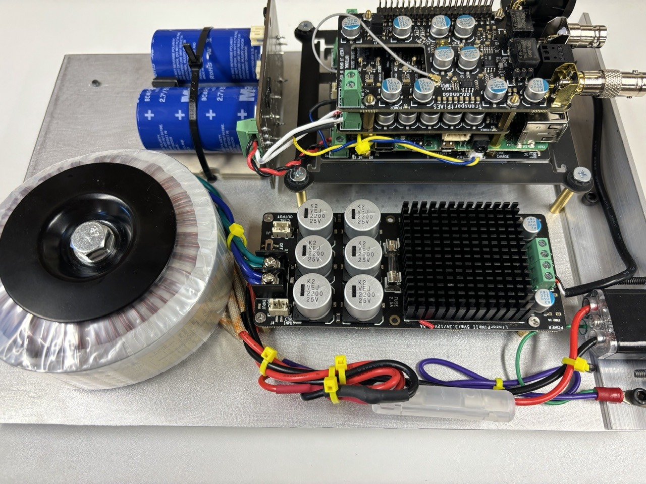

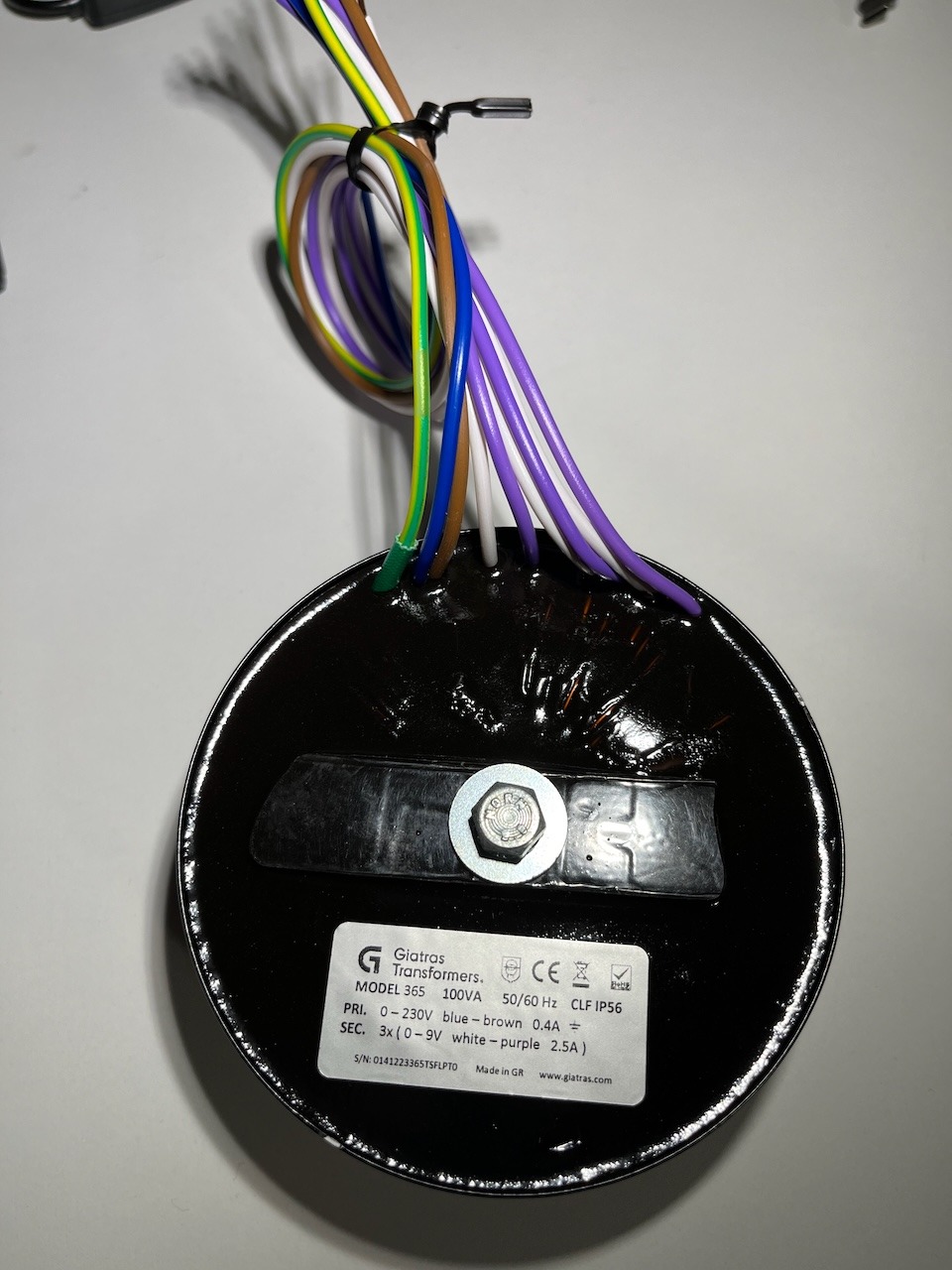

I use an AC transformer (3x9V), dipped in resin and shielded with a metal can. The transformer powers my 2xLinearPi and 1xSalas, which in turn power 3 UCconditioners, one UCconditioner (5V) powering the StationPiPro dirty side, one UCconditioner (5V) powering the StationPiPro clean side and one UCconditioner (3.3V) powering the FifoPi Q7 clean side.
Hi @pkonstantinidis
Once again, you build looks really neat🙂
Do you also have a UcConditioner after your Salas power supply and what does that power in your stack?
Is the Salas PSU the Ultrabib 1.3 version and what current limit CCS have you set?🙂
Regards Mikkel
Reactions: andersos
