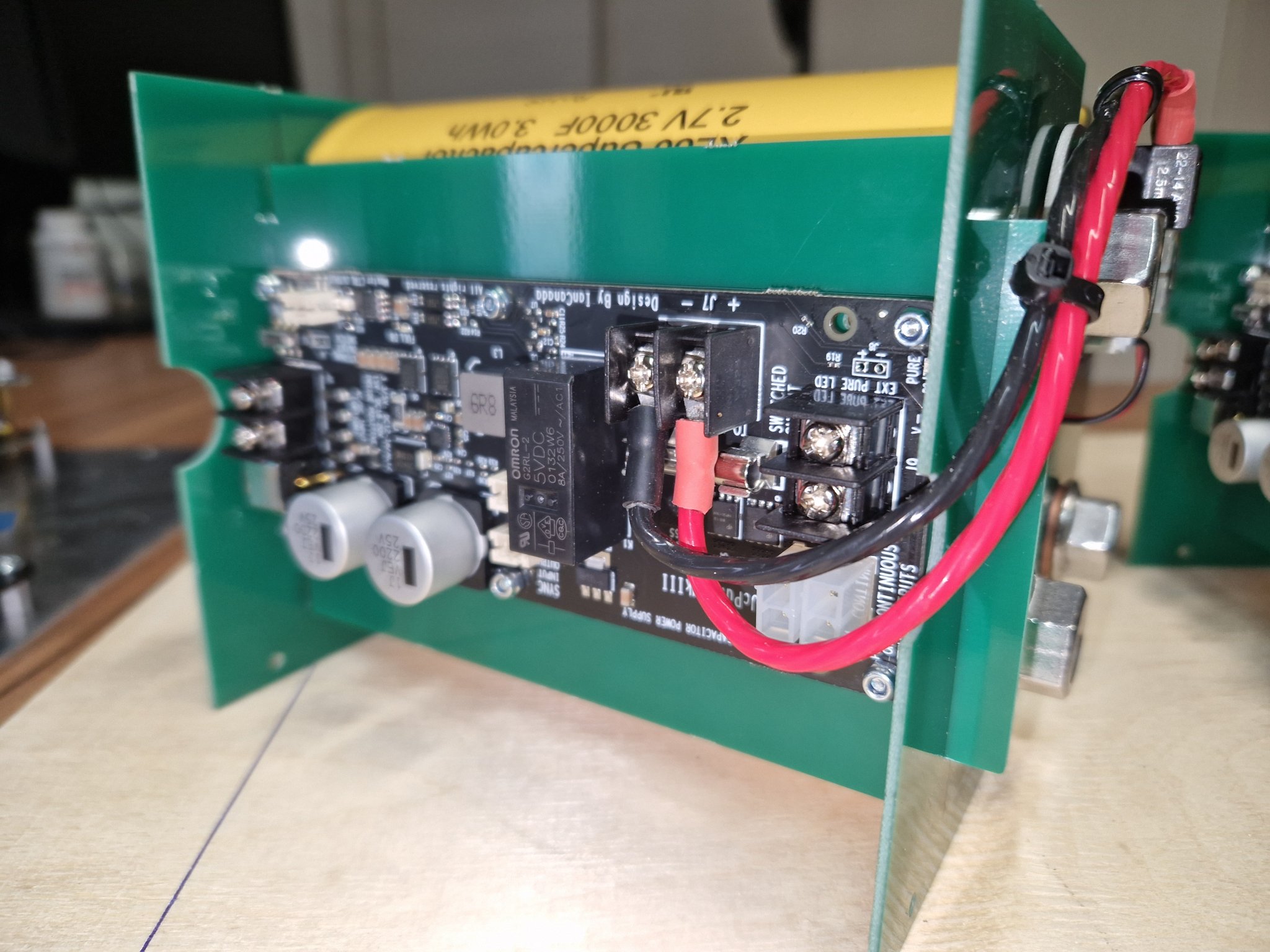

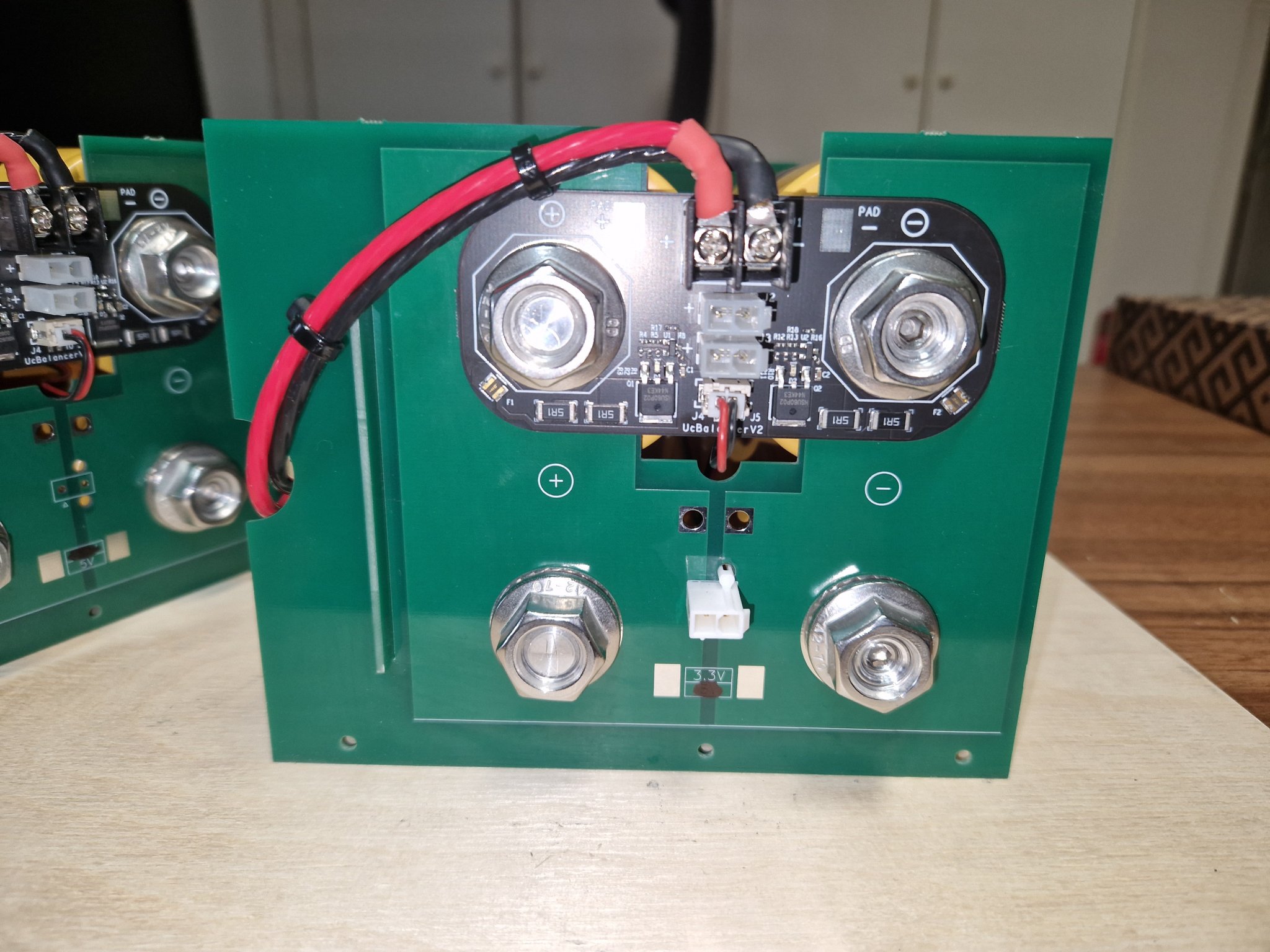

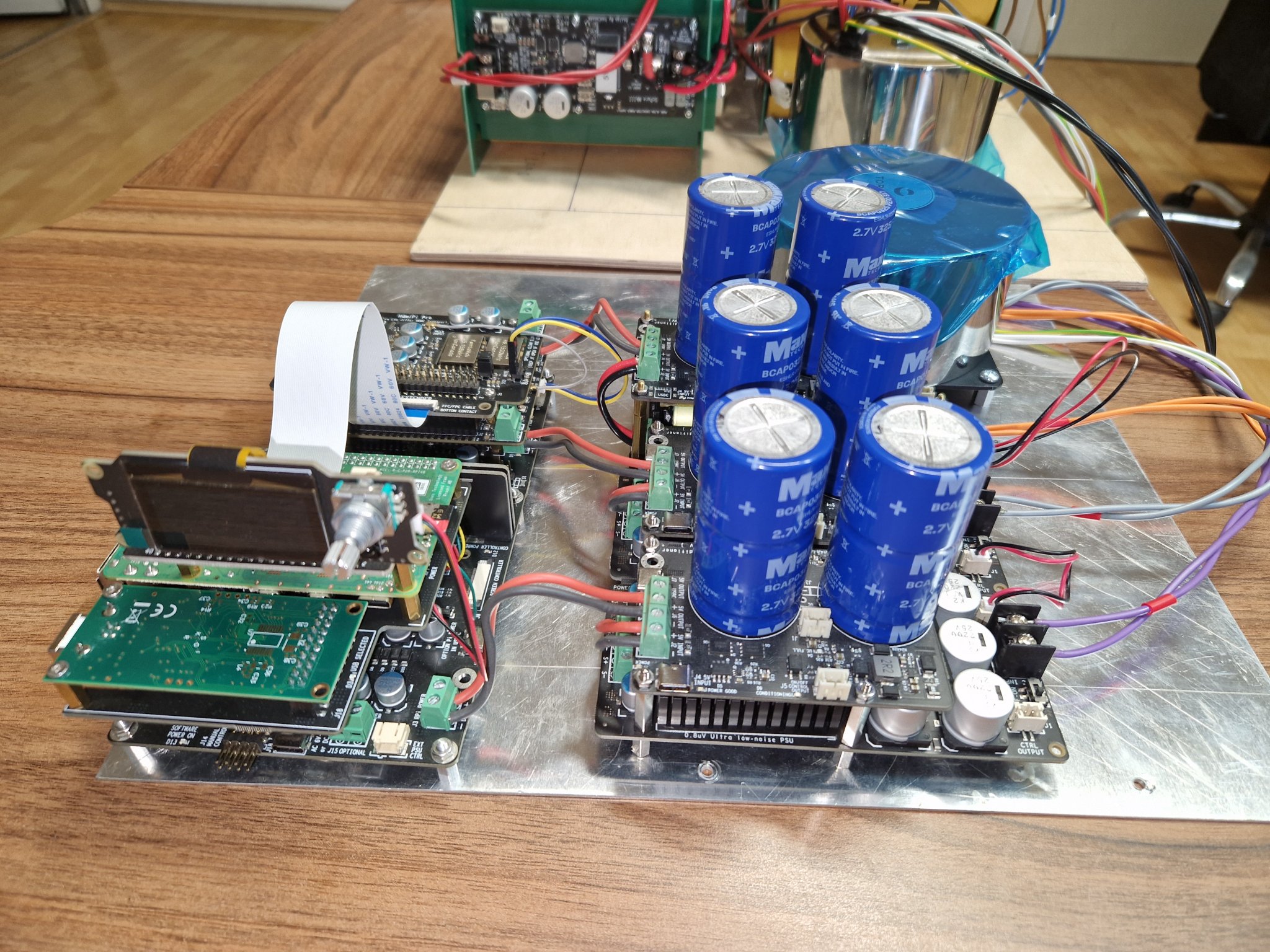

If one is so concerned about ESR the green connectors are just not that good. In the attachment you can see one of the supercaps i am using which has M5 screw terminals constructed in such a way that it is almost impossible to create a subpar connection.
The DDDAC designer spend a lot of time creating a lower noise level with his idea of regulation than what the good old fashioned Tent shunts have done so far. But i don't think now we should all confirm that those shunts are noisy. Probably there is more noise being introduced by just randomly positioning boards on a chipwood board.
I used my first Nec supercap for audio 4 decades ago and i have see the improvements that have been made since then. Have used different kind of batteries too.

Can't help to share a picture.
The customized transformers are great. Better than what I expected.
Based on my test, 20-20KHz +/- 0.3dB
This new fully finished transformer I/V has a lot of design considerations and it sounds amazing.
Runs in pure passive mode, no need any additional power supply. Really worth the it.

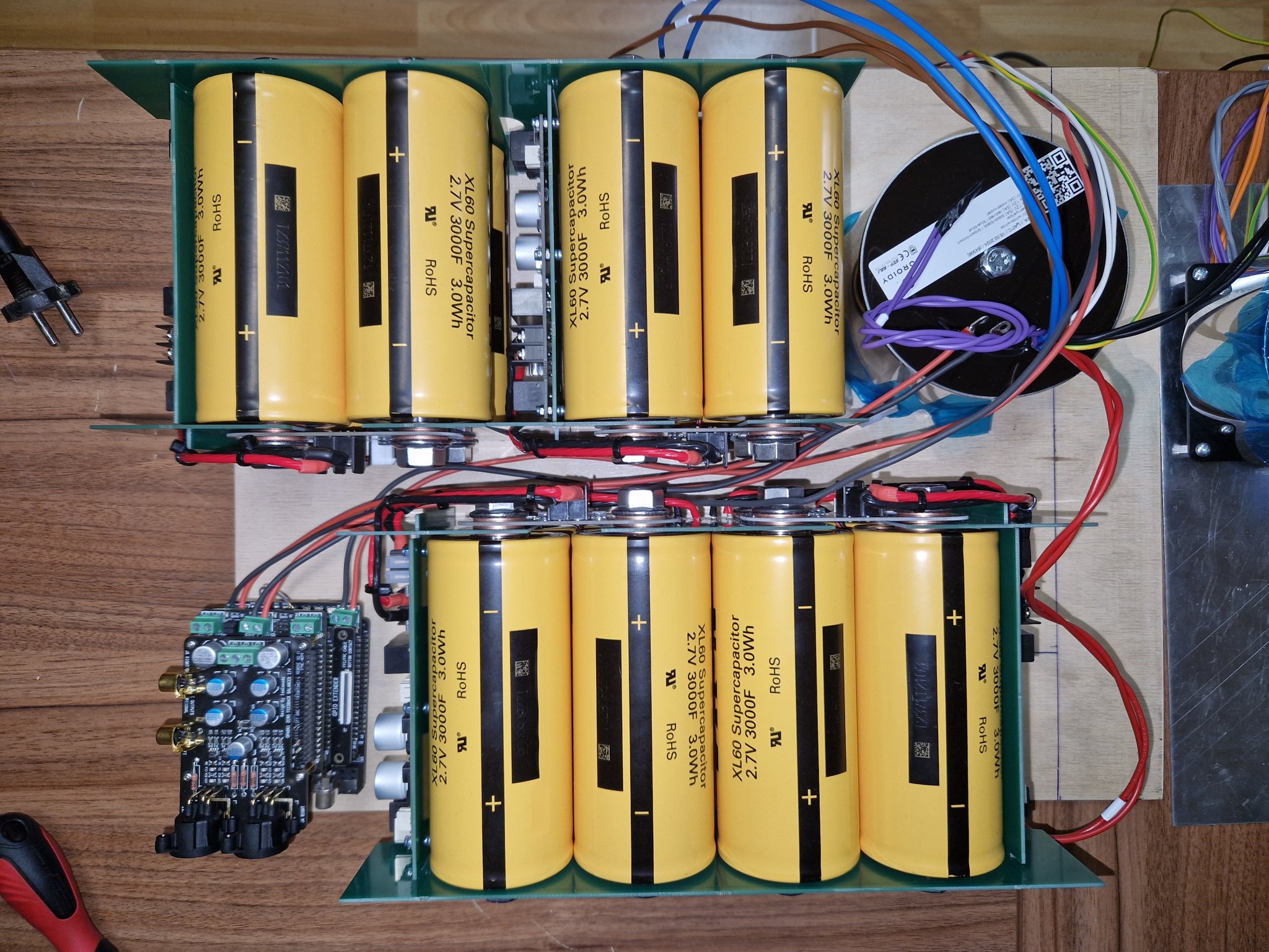

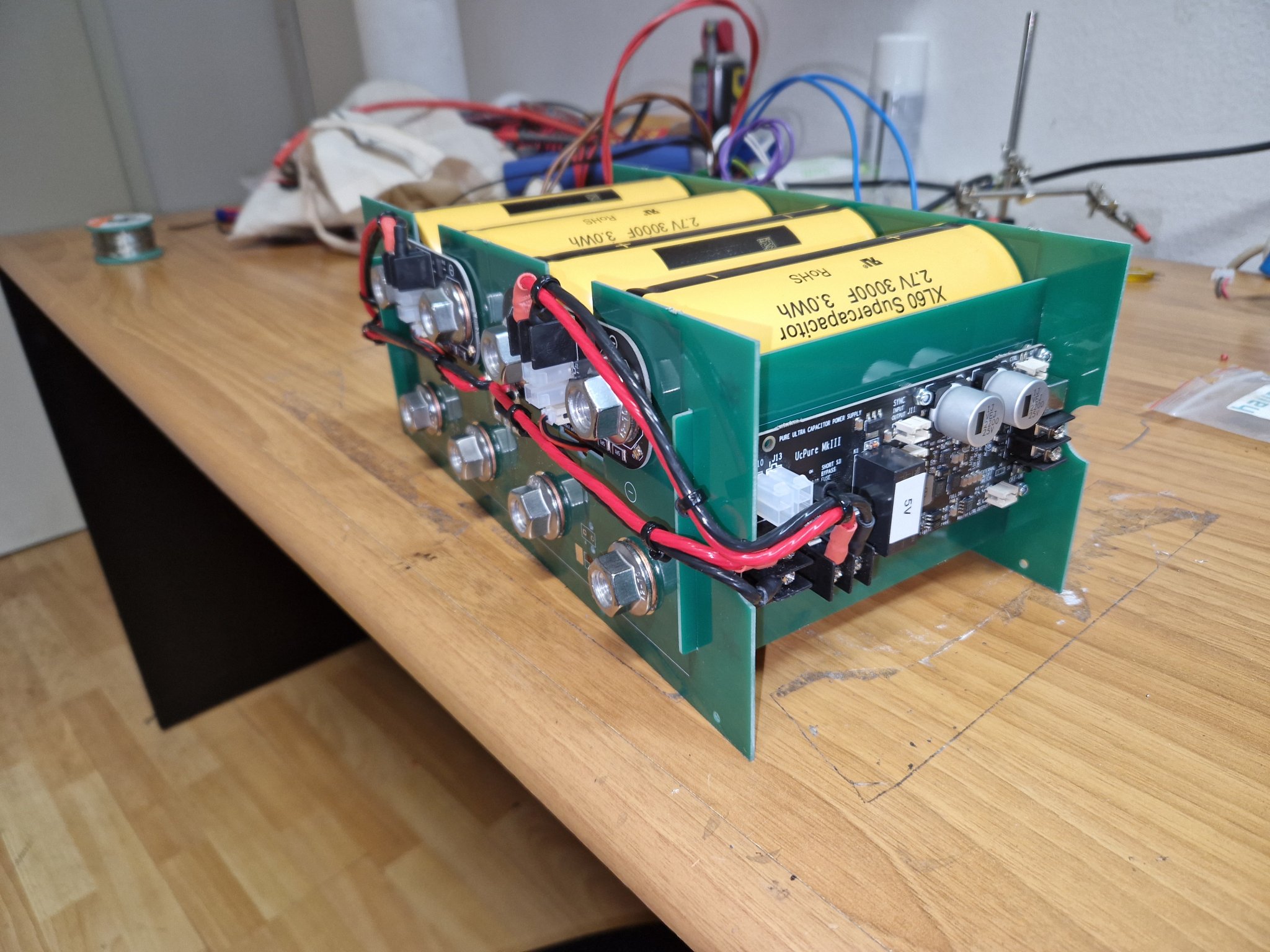

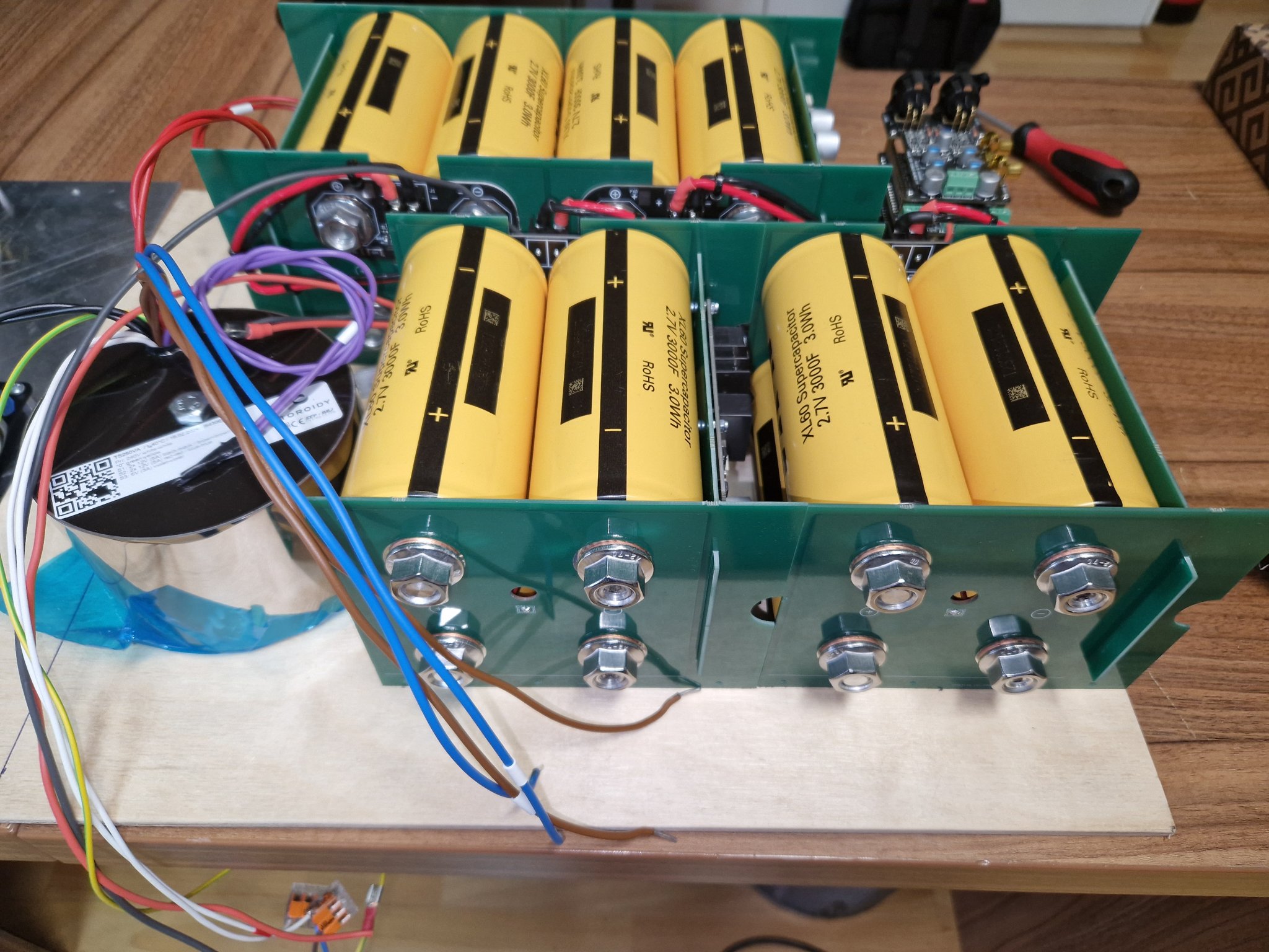

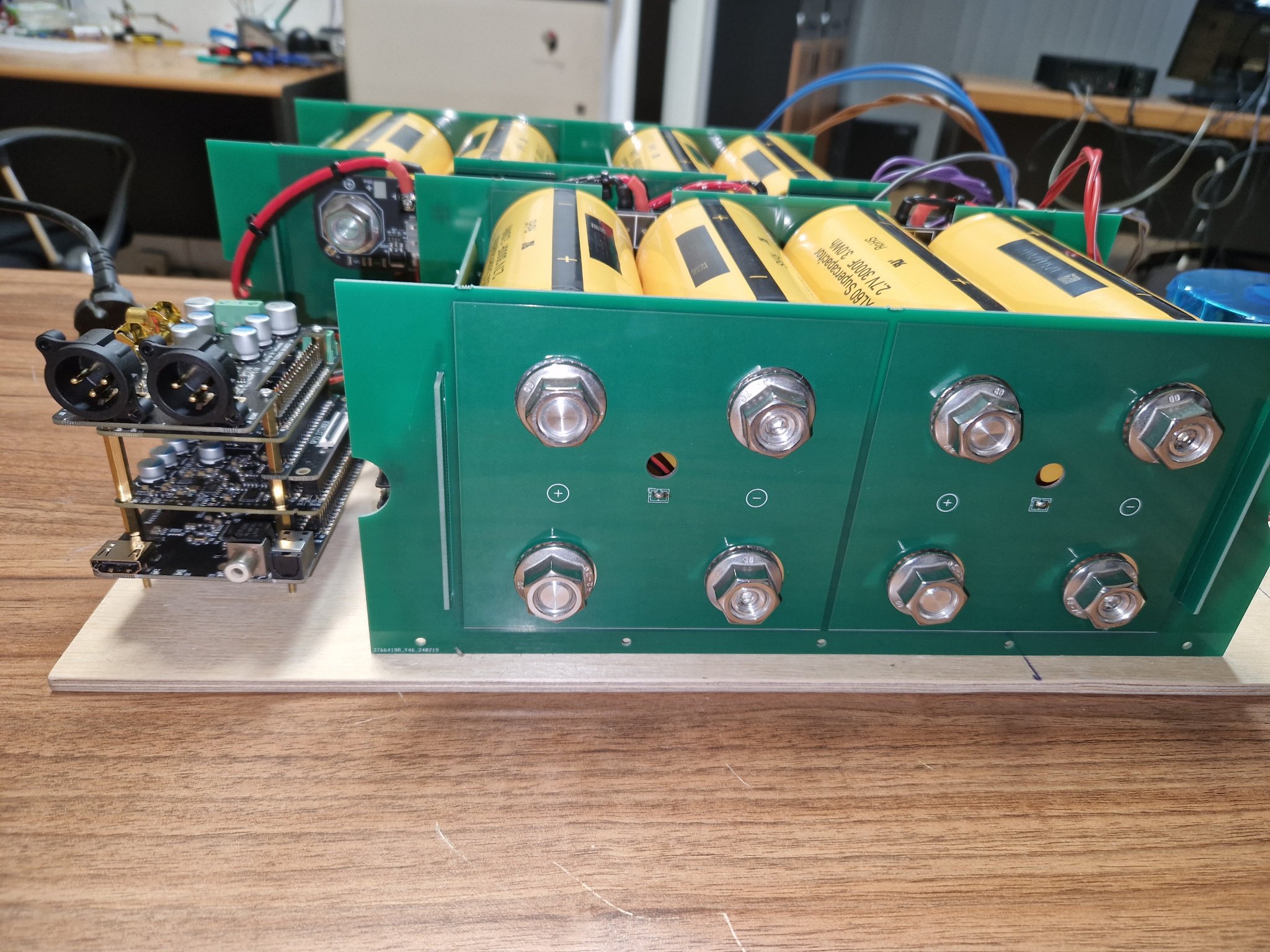

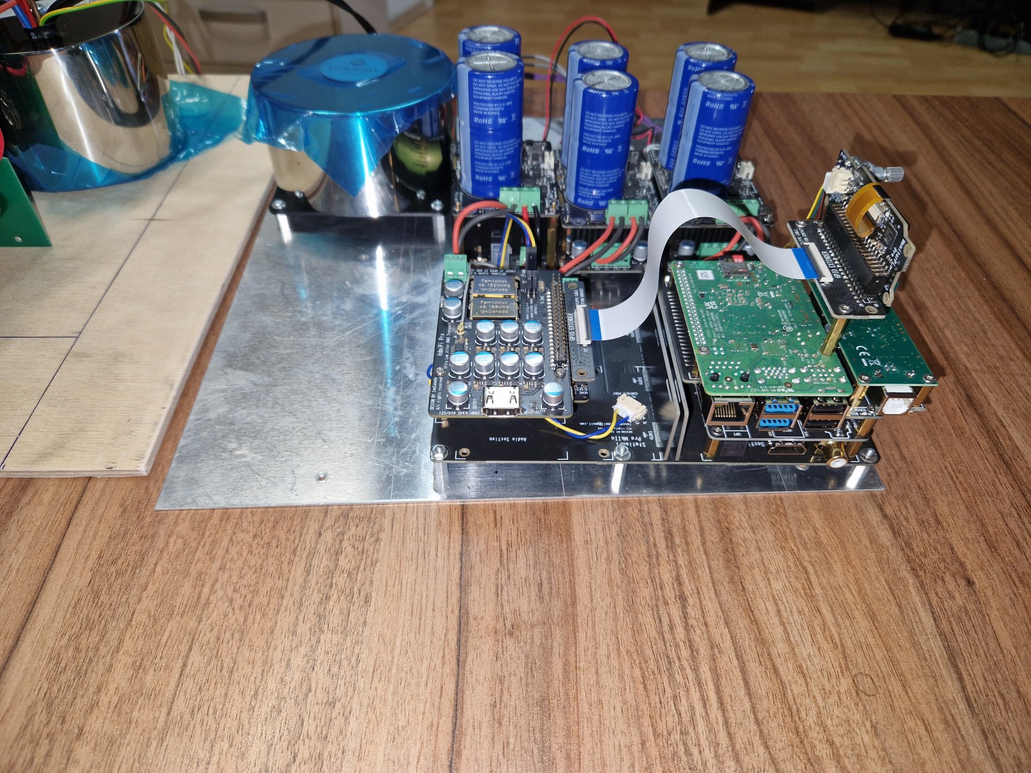

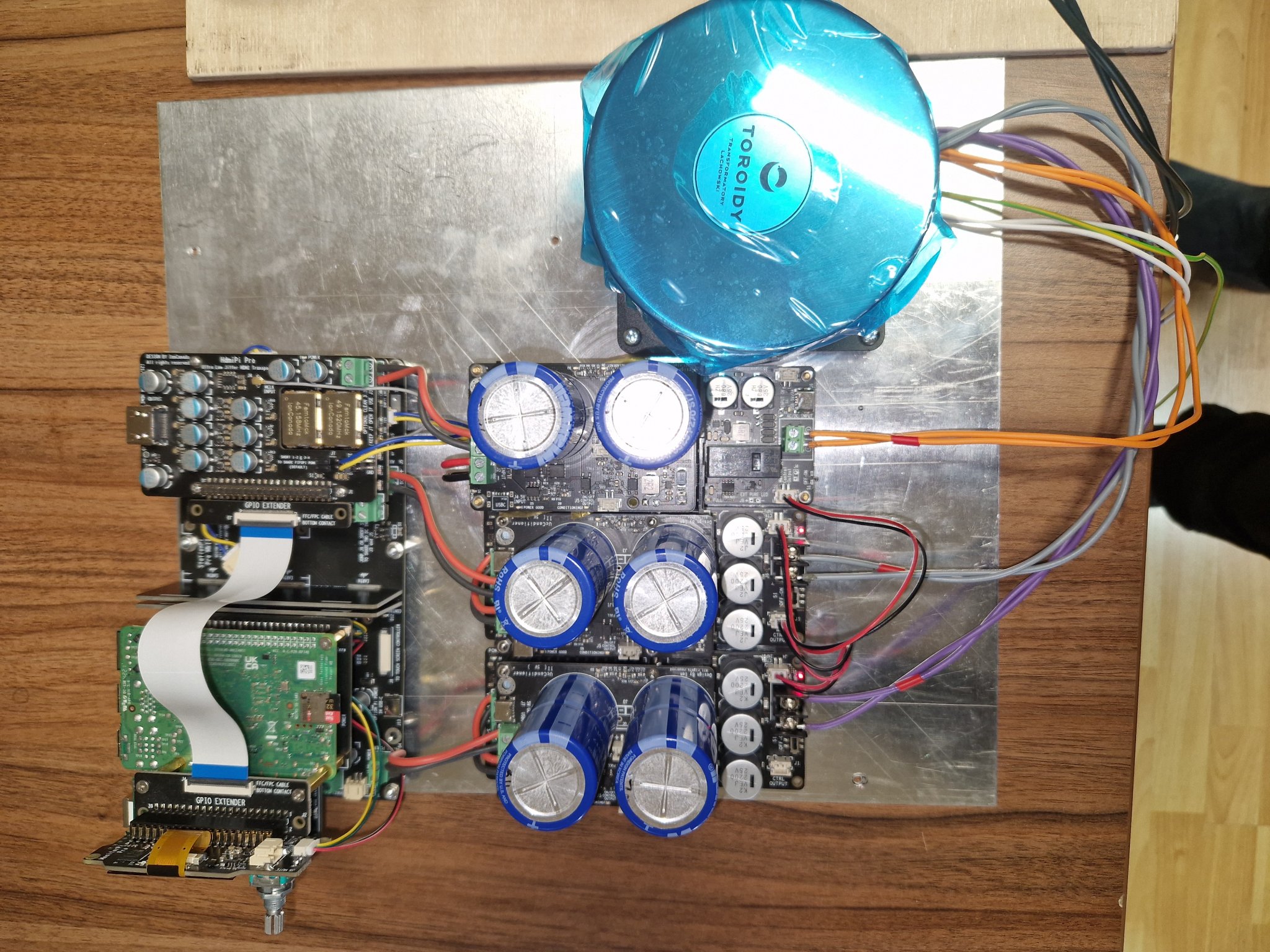

Just teaser 🙂
4x3000F 3.3V XO/DAC
4x3000F 5V FIFO
8x3000F +-5V
Custom PCB for Supercapacitors
I may have some spare PCB if anyone is interested!
Custom Toroidy transformers
Pure madness

I think you've been frugal on the power supplies... 🤣Just teaser 🙂
