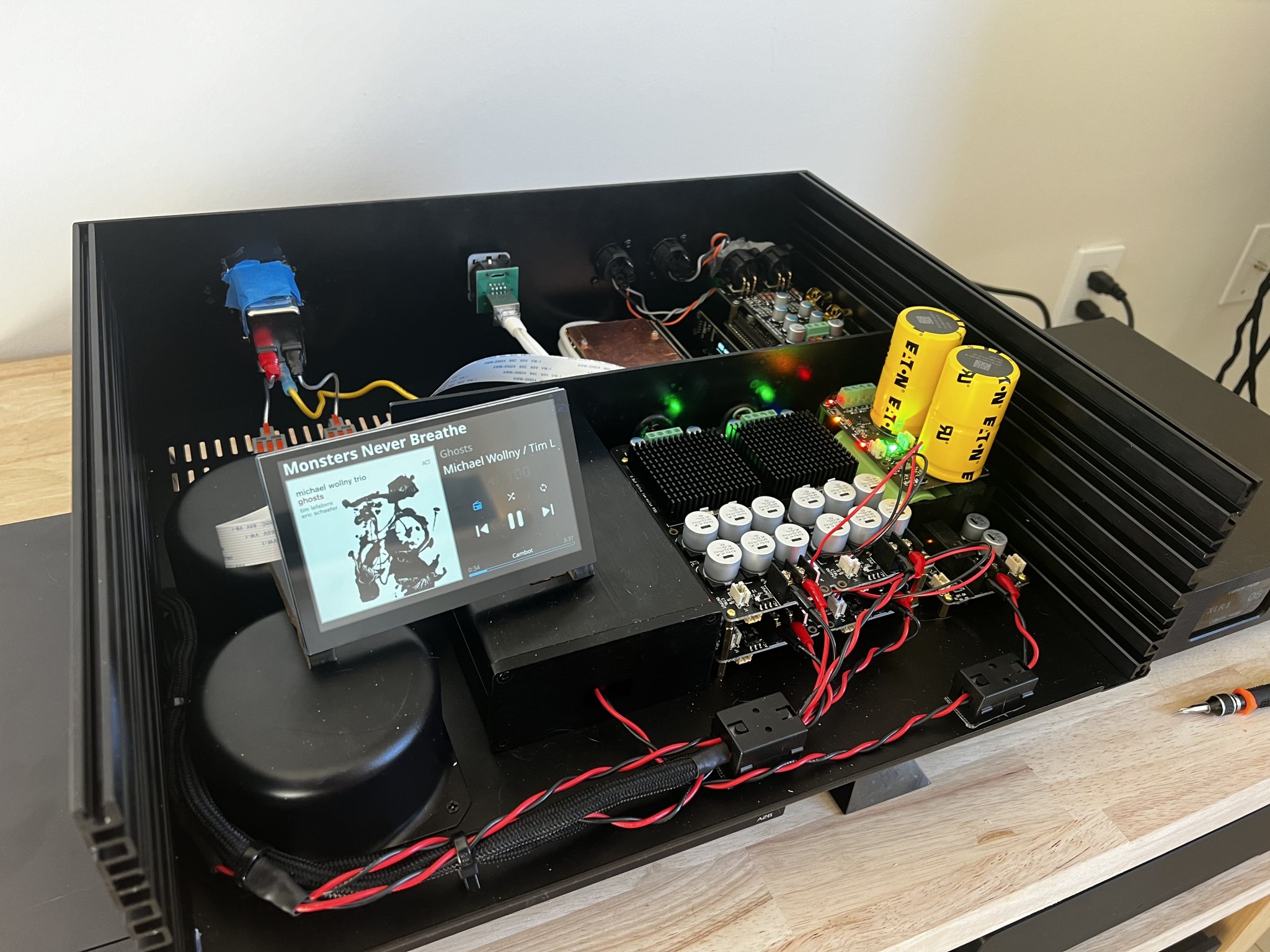

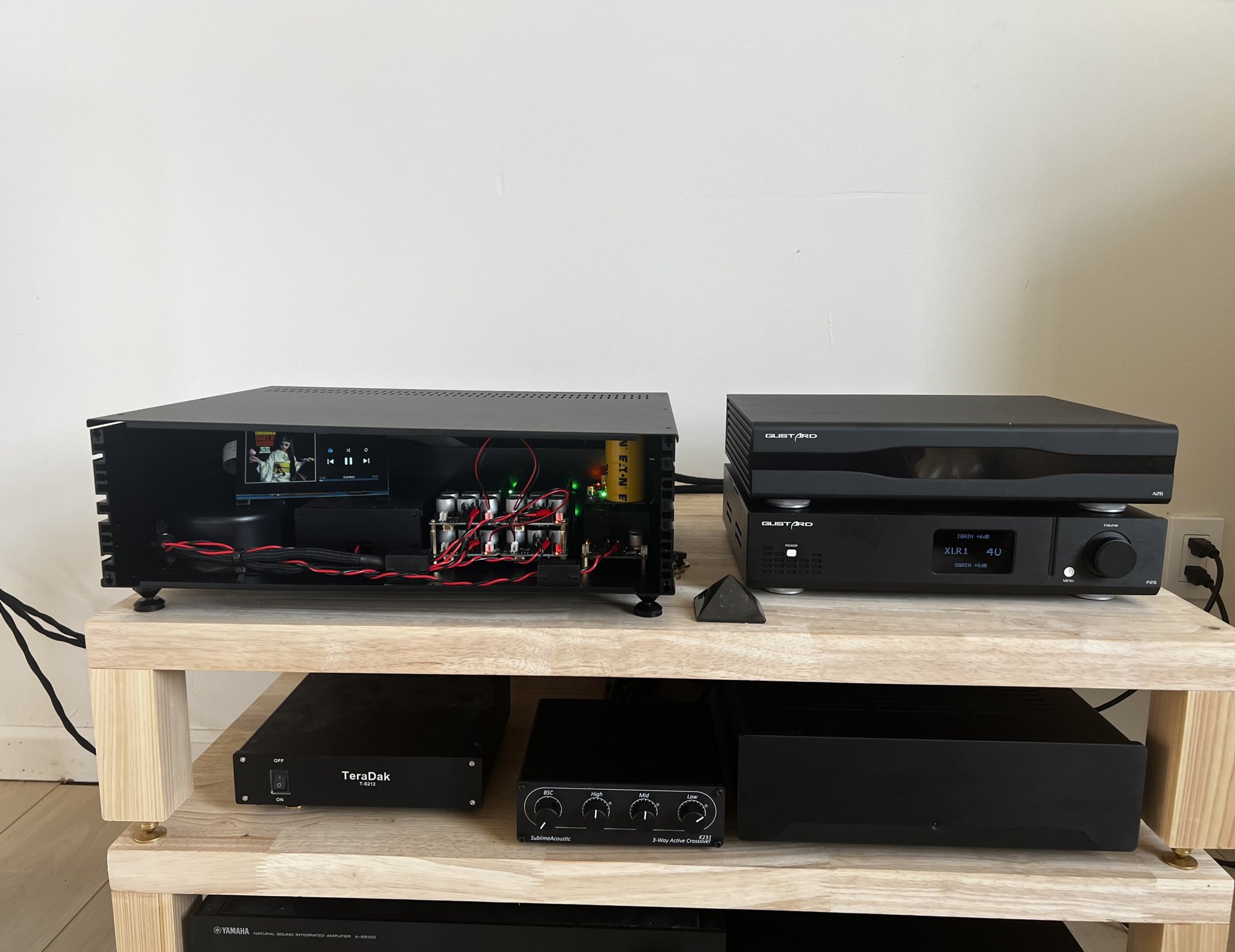

Just a little update.
Been burning my build in for the past 3days. Sound just keeps getting better and better.
I’m using the Audiophonics Dac hat, upsampling to 384k, true sync mode with the AS338 clocks.
For PCM playback, I’m a bit of a technically accurate audiophile, I so listening now with the Linear Fast Roll-Off filter for good frequency extension, sharp roll-off, minimal ultrasonic imaging, and linear phase (best temporal performance without phase shift).
It has surpassed my Gustard A26 in pcm SQ.
Because the Dac has no NOS mode testing DSD I feel won’t be fair fight.
Next is to finish up the face plate and flush mount the 5in screen.
Huge thanks to you all! Successful build for a complete newb!

@camrector Very nice build, clean layout. Congrats! Had a similar experience with Gustard A26. Actually sold it now 🙂

@Spacejack thanks man!!
I was hoping that this dac/streamer at least was on par with the A26. It has for sure surpassed it.
I was building the Ian Canada for a secondary system and now it looks like it’s staying in the main one lol.

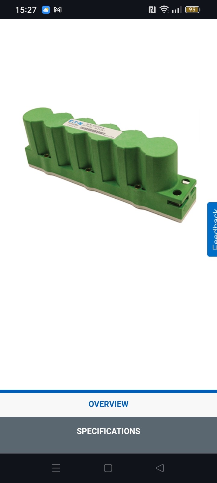

If one is so concerned about ESR the green connectors are just not that good. In the attachment you can see one of the supercaps i am using which has M5 screw terminals constructed in such a way that it is almost impossible to create a subpar connection.
